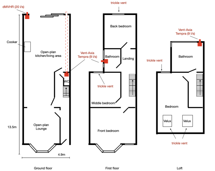

Thanks very much for the reply. That's very helpful feedback. That's what I feared re first floor. For dMEV, do you mean to have these instead the dMVHRs but in the same locations? Without heat recovery, I'm concerned that I'm going to be unhappy letting all that energy go to waste. Do you have suggestions for other dMVHR units that I should look at? I have seen the BSK ZEPHYR and alike, and they are more silent, although I was not convinced that the 70 seconds on/off was something that was going to work in my case, and I assume that this won't solve the issue with ventilation on the first floor... In the meantime, I'll give it another go at seeing if I would be able to fit ducts for a centralised MVHR system since we are lifting the floorboards on the first floor anyway. Thanks again!
Hi everyone, I'm John. I've been reading the forum for a while, but this is my first post. We moved into our victorian mid-terrace house a couple of years ago and we are doing some renovations now (side return and loft conversion; floor plans below). As part of the renovation, we are doing some work that affects ventilation (category of measure according to Appr. Doc. F volume 1 of building regs): - Removing external chimney (major) - Insulating a suspended ground floor (major) - Replacing more than 30% of the total existing windows (major) - Installing internal wall insulation to less than 50% of the external wall area (minor) - Loft conversion (minor) This is likely to result in a significant decrease of the ventilation levels in the dwelling that I am hoping to address using dMVHRs. We do not have loft or ceiling/wall space left for a central MVHR system, I'm afraid. The kitchen will have an extractor fan for the cooker with air recirculation. At the moment I am considering installing the following dMVHR units: - Vent-Axia Tempra (9 l/s; 15 l/s boost; unbalanced) - loft bathroom - Vent-Axia Tempra (9 l/s; 15 l/s boost; unbalanced) - first floor bathroom - Vent-Axia Tempra (9 l/s; 15 l/s boost; unbalanced) - ground floor cloakroom - TBC (any suggestions for specific models?) (~20 l/s; 60 l/s boost; unbalanced) - open plan kitchen living area on ground floor These should satisfy building regulations' minimum ventilation levels for the whole dwelling in terms of: - minimum extraction ventilation for wet rooms - 4 rooms: 37 l/s - total area: ~42 l/s Since we are changing the windows, I am also installing background ventilators (trickle vents) as follows: - no trickle vents in loft bathroom - no trickle vents in first floor bathroom - no trickle vents in ground floor - no trickle vents in first floor front room - trickle vents in first floor middle room - trickle vents in first floor back room - trickle vents in loft bedroom (velux windows and Juliet balcony) I am trying to ensure that all rooms will have adequate ventilation. The windows towards the front of the house though have a particular shape that will benefit from not having trickle vents (this would be a real eyesore). So I would prefer to avoid installing these. It would be great to get feedback on what people think about this and whether I should be implementing other approaches to ensure a correct level of ventilation. In particular: 1. Is the dMVHR in the kitchen going to be enough to provide ventilation to the whole ground floor? 2. Do I need to add a trickle vent to the non-bay-window in the first-floor front room? If so, what equivalent area mm2? 3. Any other suggestions for things that I should be considering? Thanks very much in advance for the feedback. Cheers, John
