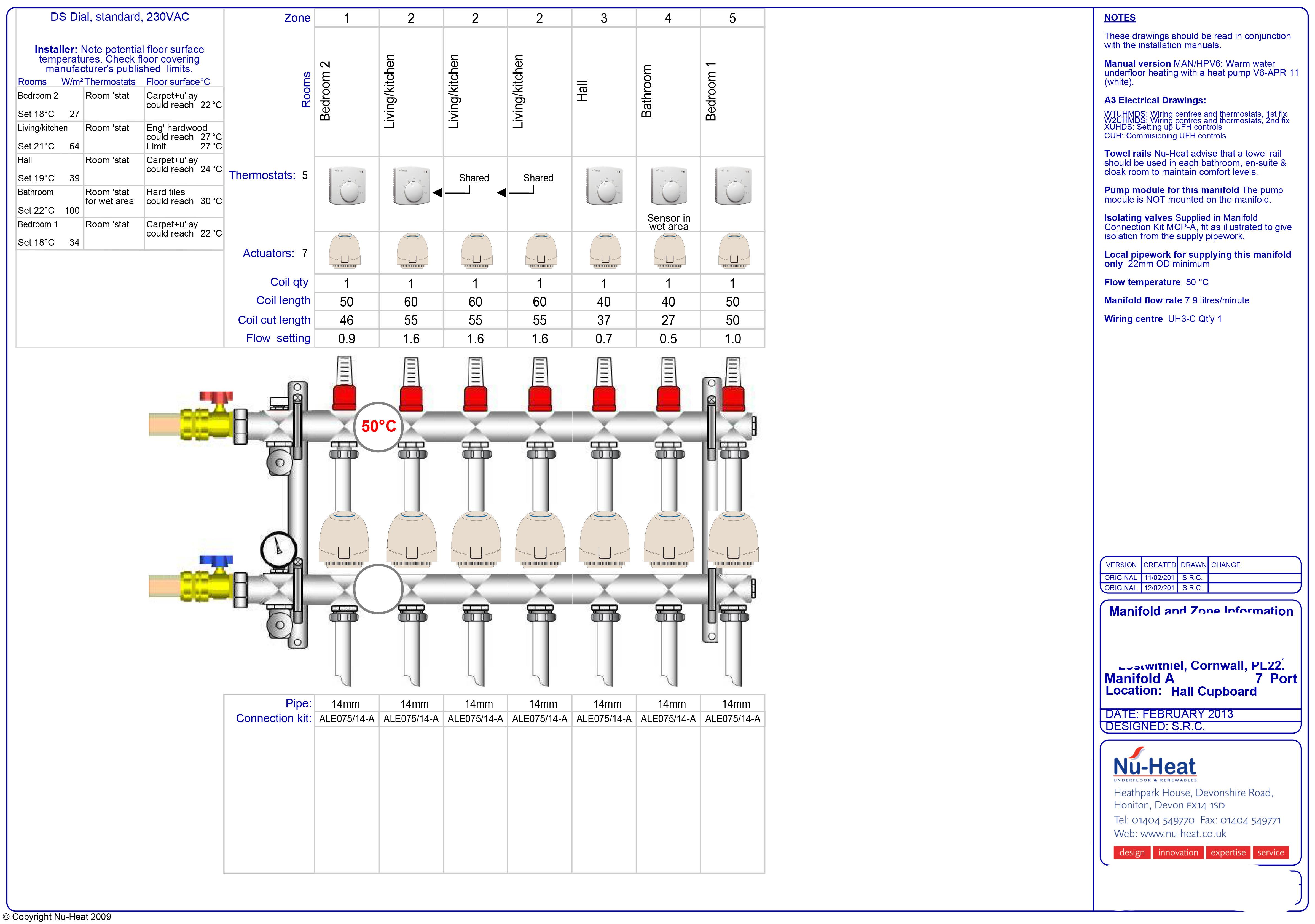

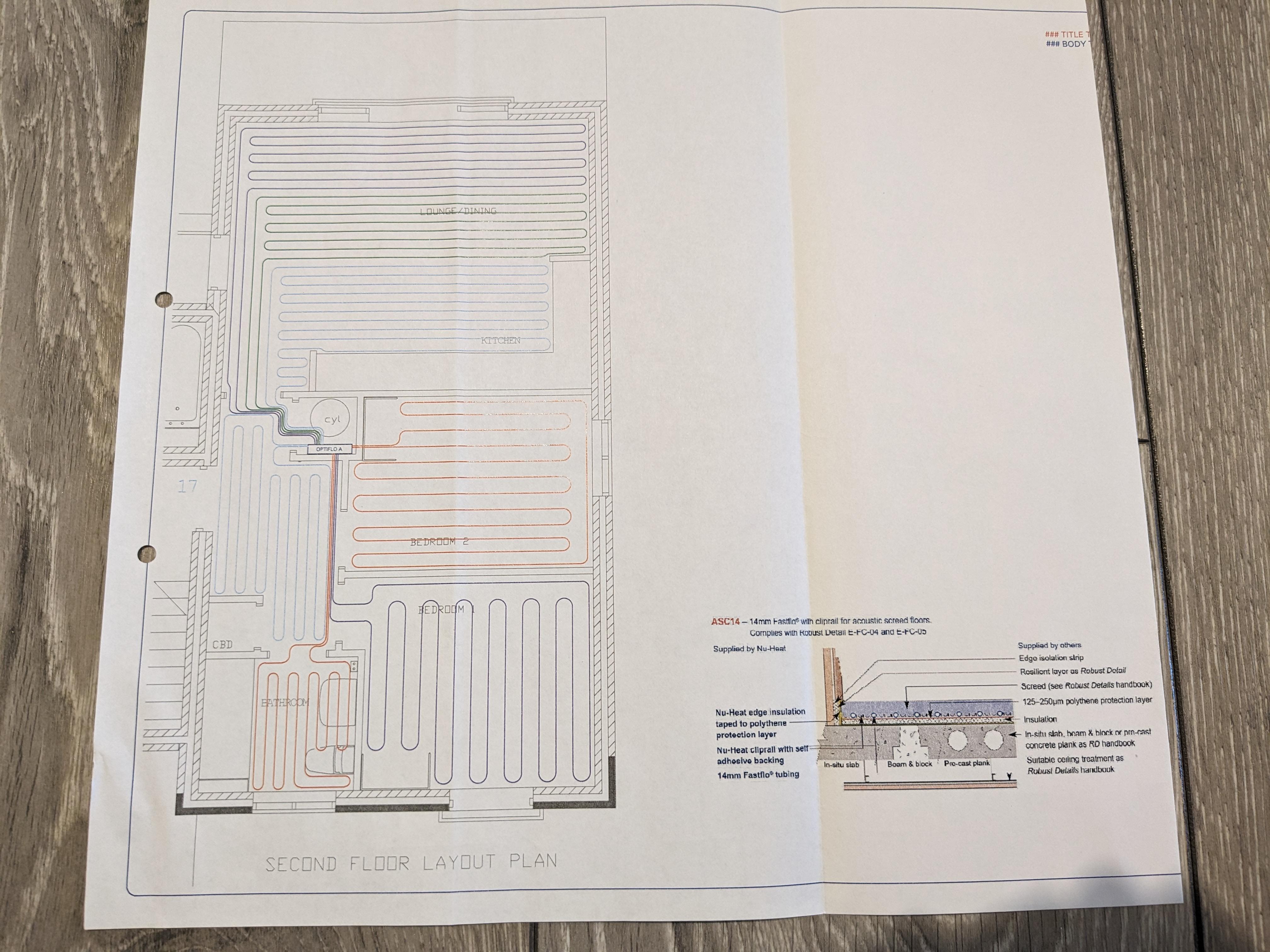

New Member

  1. That's what I thought when they said that. I said I've read in most references to underfloor heating, low and slow. We have laminate throughout the flat. Has a thin foam underlay. Though the floor isn't exactly flat, so may be a gap of a few mm every so often.

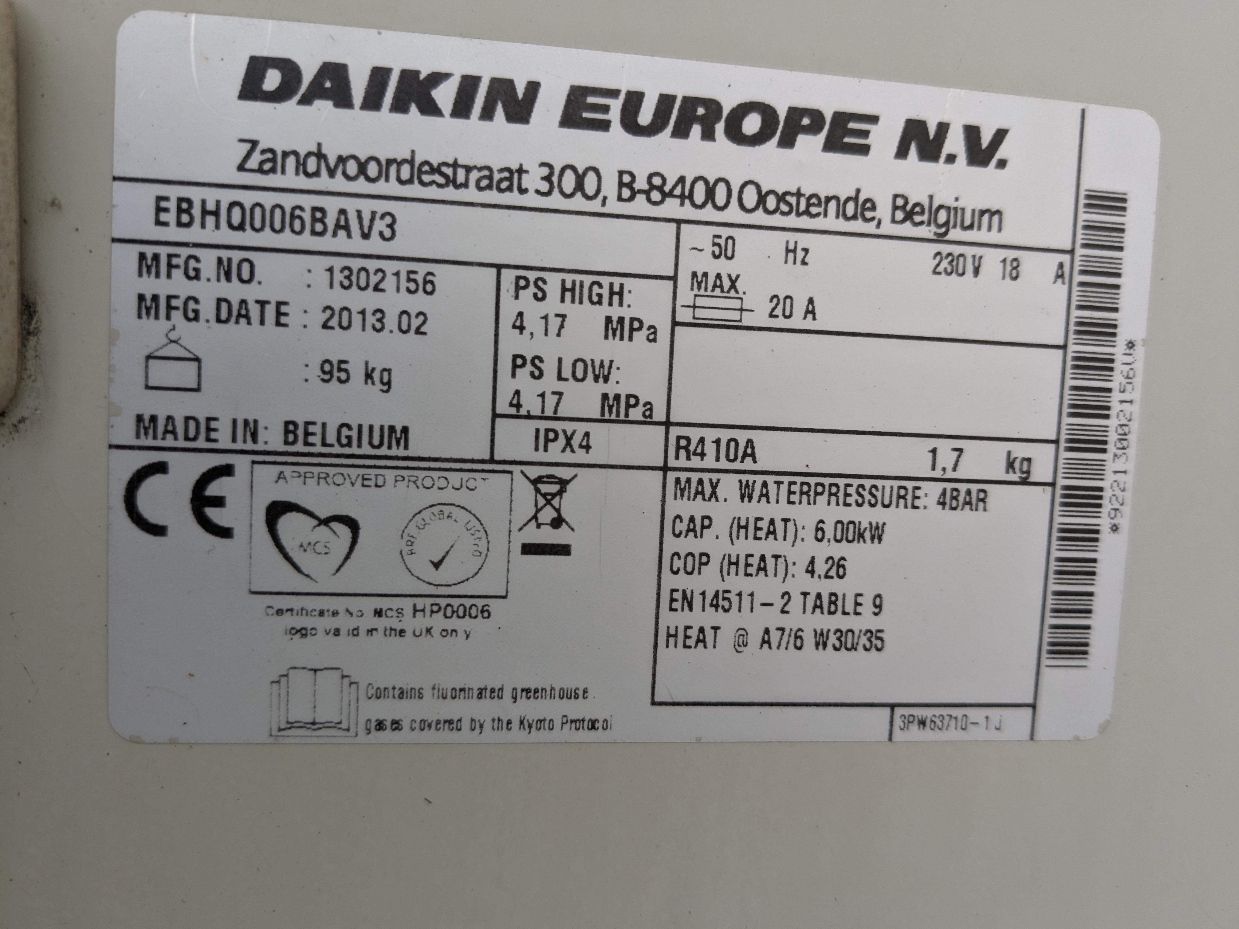

  2. @JohnMo I have tried before with leaving the system on for 24hrs, even at a lower temperature, it never seems to increase in temperature in the rooms. I rang nuheat (who designed the system) earlier and they told me the system is designed to have a flow of 50c for the heat loss? lol Im at a loss let alone heat. @Iceverge is working, compressor symbols are displayed on the control panel and heats the water and the manifold is hot. I don't think these units have back up heats, only internal to the water tank when it does the sanitise process. It tends to go on for 10 mins and then turn off for about 5 and then back on. Would this this be classed as fast cycling?
  3. @JohnMo Would making 1 big zone mean getting rid of all the thermostats and just having 1? Or still have the separate ones but if any call for heat they open all zones? @joth No Idea if it has an inverter. I have attached the details of the ASHP below. Ive got one loop in the hall always on now, but guessing this isn't enough? Thanks for the replies.
