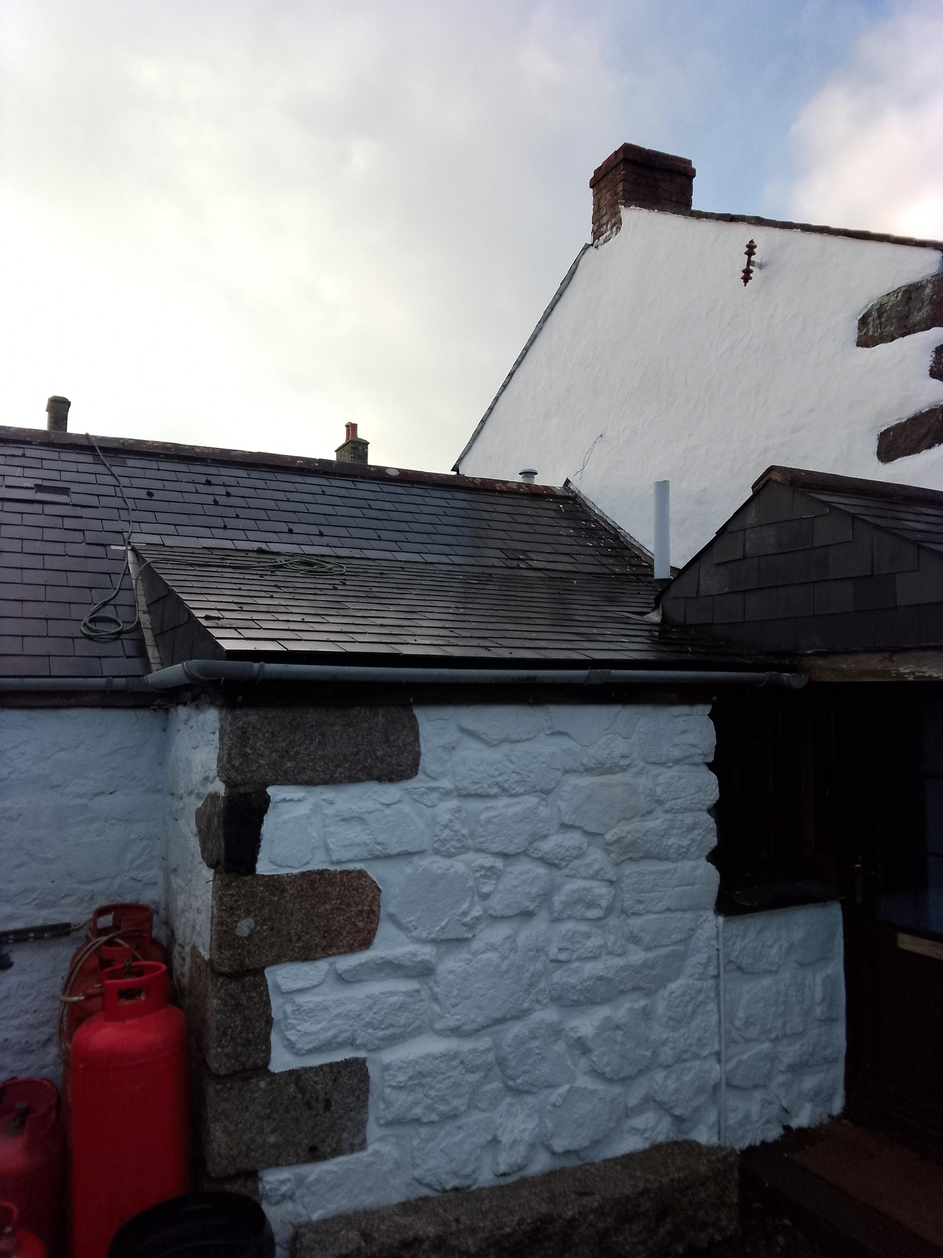

  1. Having just fitted a GRP deck in a boat I am aware of the cost, the roof is 16 sq m. Ply £100, GRP poss about £250. Battens would have to be screwed through the GRP, lots of holes to seal. At least with membrane I can use nail sealing tape, plus the cross battening will make a difference. I am more interested in finding any experience of the permavent products I linked.
  2. So is there any significant problem with the idea to put DPC strips under each row of tiles, end to end, 400mm same as the tiles? As well as rectifying the membrane, battens and eaves detailing. 16 deg is well under the recommended pitch.

  7. Yes, well versed in GRP from boatbuilding, in fact I have most of the materials to hand, but you'll appreciate I want to retain the tiles. The white stone wall is full of water. Tight membrane, water has probably blown or crept up under the tiles, and sat against the battens and come through nail holes. Possibly pooled on the membrane at the bottom as well, see when I strip it. The 400x200 tiles, now unobtainable but I can cut four from a 600 x 600 thrutone which is a good match assuming I don't break too many. Otherwise I'll use 400x250 over the whole lower section, or even a spanish slate.
