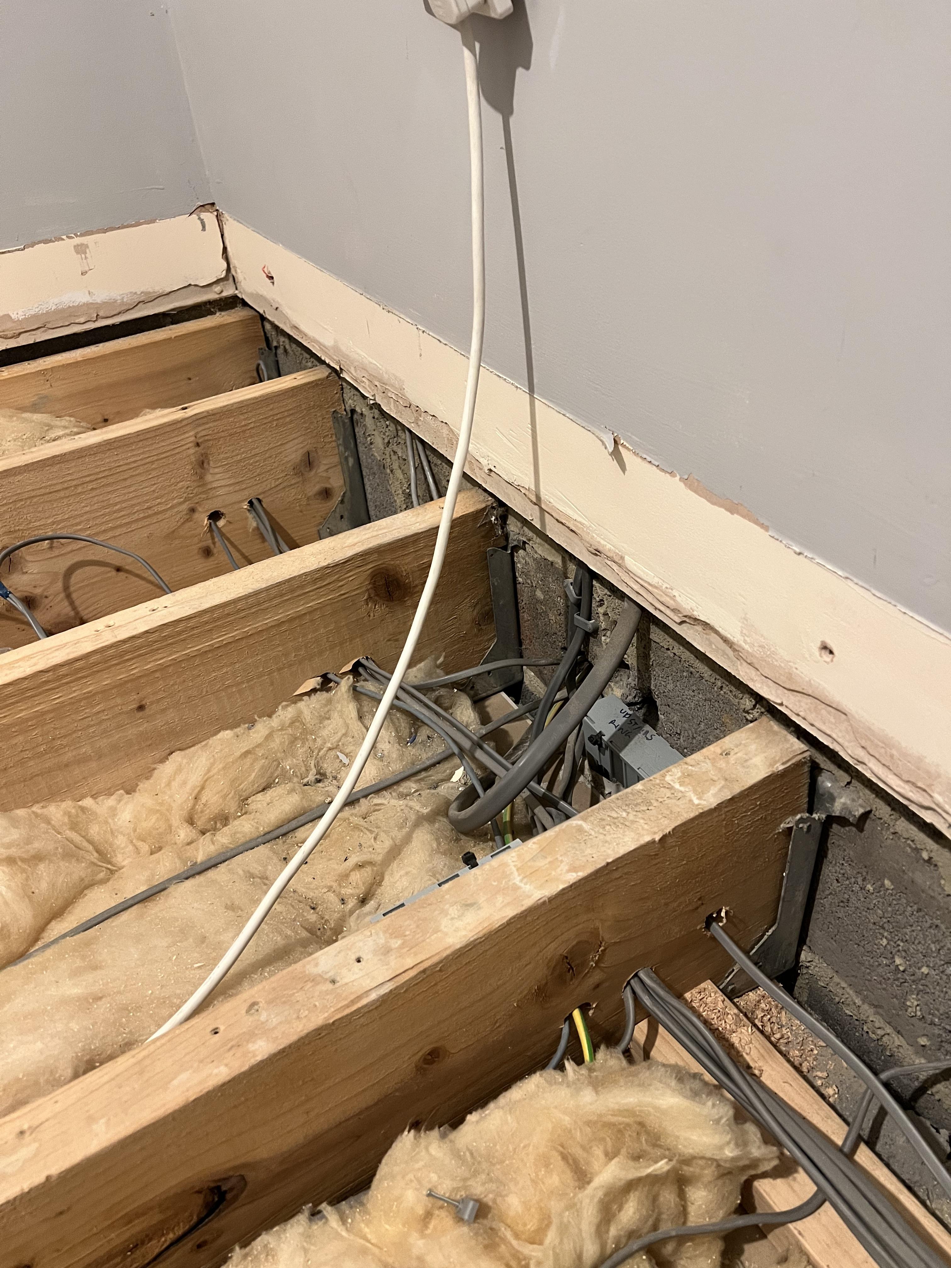

New Member
New Member (2/5)

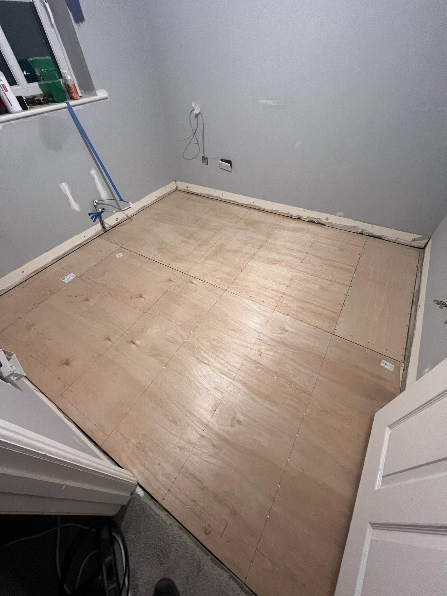

2

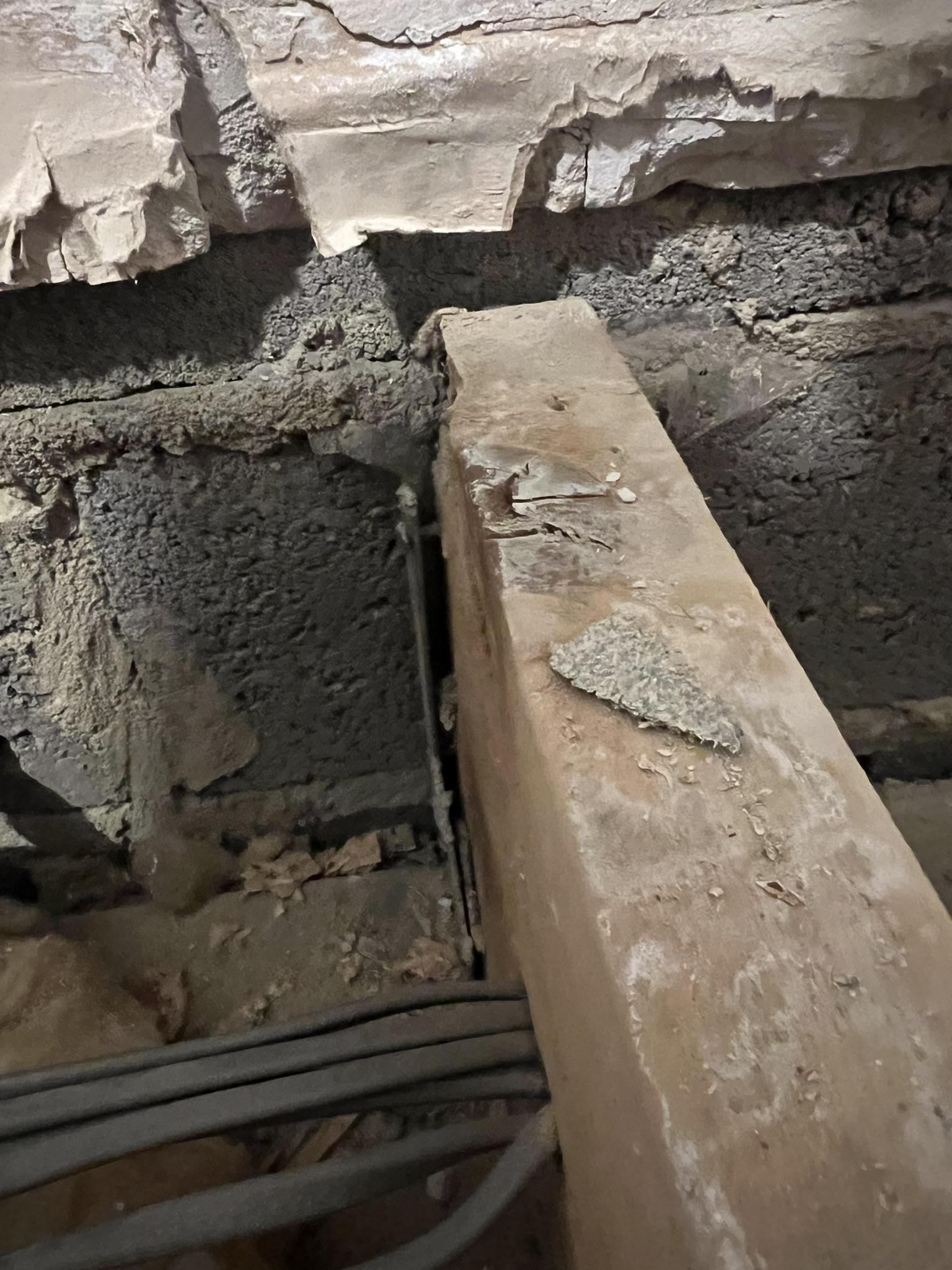

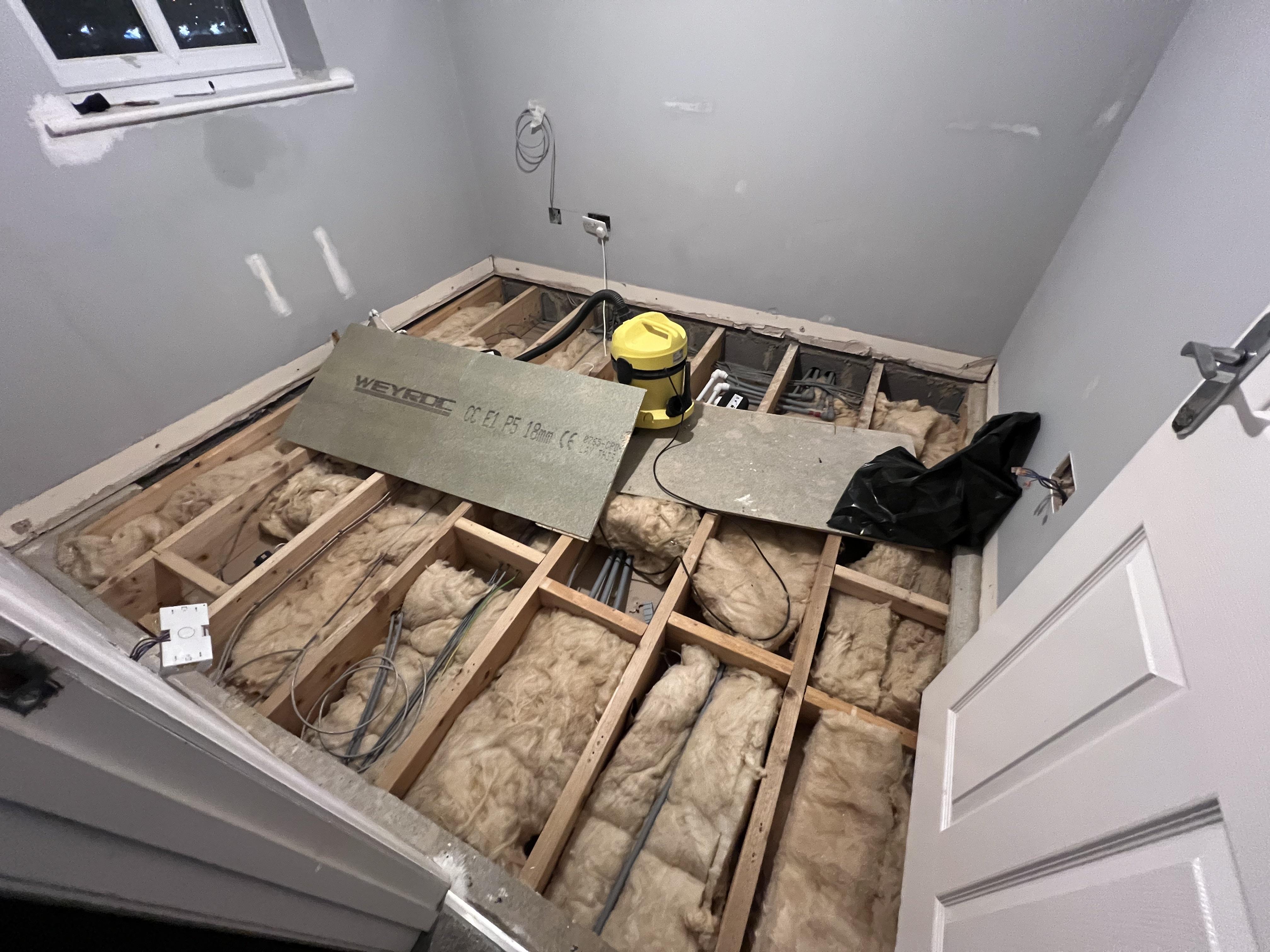

  1. Got it done earlier in January, happy with the result, feels solid. For future, I'd plan out sheets better to get a row of noggins in line down all joints.
