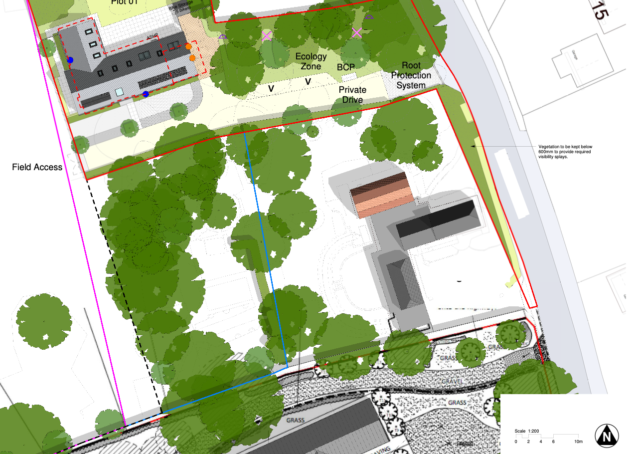

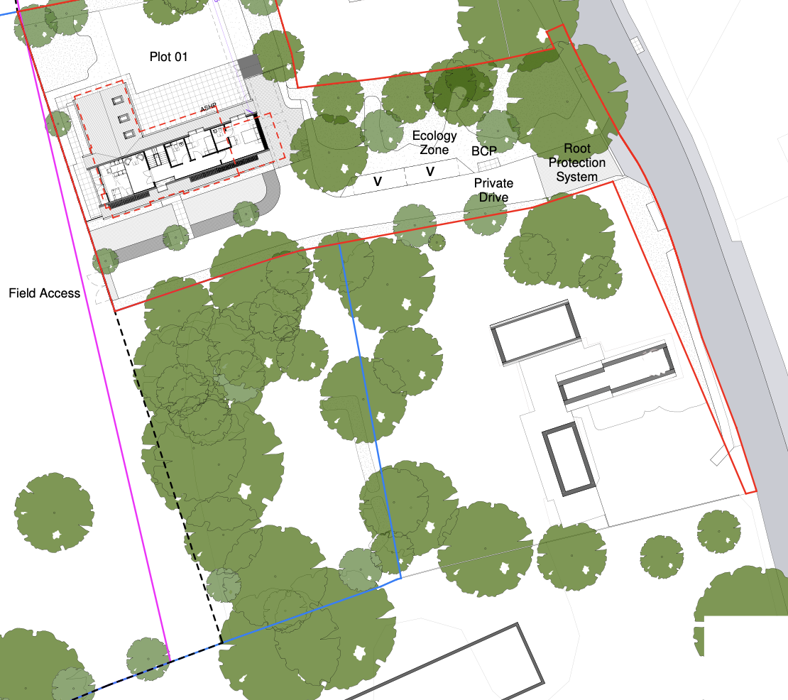

Ah, apologies, yes the Purple and red dotted lines are previous applications.
Purple is the village boundary - I do own this land, however currently it's unbuild-upon-able. red dotted is the previous application, yes. Architect thought it a good idea to highlight the change in dimensions so as to 'prove' that we've taken into account previous comments.

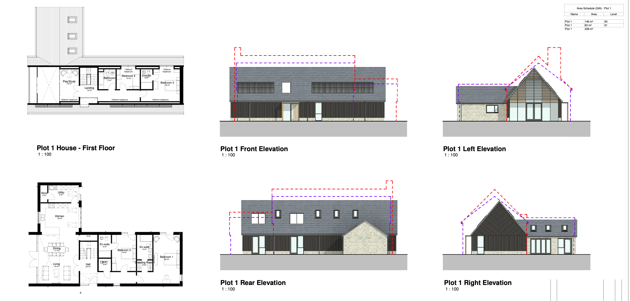

Hasn't been knocked back... yet. About midway through the supposed 8 week determination cycle. But I anticipate an extension will be requested. I'll attach a couple of screenshots to this post. Thanks Joe, I've attached a couple of screenshots that show the design proposal / the siting concerning the listed building (Which is the large 3 pronged building in the centre of the image / the proximity of the neighbours approved building to the south. When you say it's easier going to appeal than applying for planning permission, does this mean you can skip the planning process entirely??
