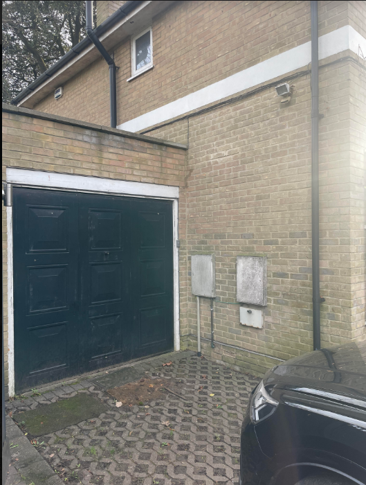

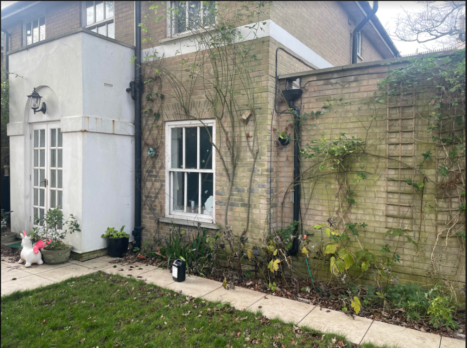

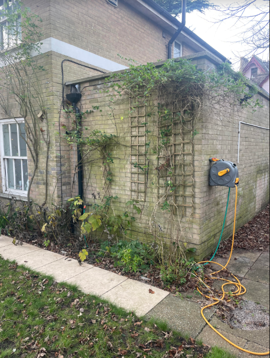

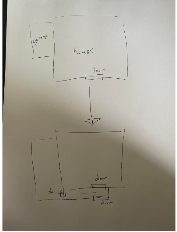

thank you for your reply. apologies for the late response - got caught up in the festive period. hope everyone had a lovely christmas! It is a lime tree. measured today and circumference is c.270cm so diameter should be roughly 86cm. The garage is currently 2.6m x 5.4m and the closest point to tree is 3m away exactly. we would increase the width by 90-120cm if possible Clay ground Ive attached some more images showing the front and back of the garage (note the tials are 60cm for reference). the distance from garage to edge of house is 2.3m. based on this then i think the maximum length is around 7m (60cm backwards and 2m forward - although it would mean either making the meter readers internal or moving them) and then however much we can extend sideways from current 2.6m (so perhaps 3.8m? ie 2 tiles). this would mean moving our current shed and a pretty small space for entrance next to tree...giving a grand total of around 26.6 footprint (and smaller internal space). so perhaps just under the desired size. really it does seem that a two floor would probably be much better choice size wise i suppose the question is it seems would the roots present an issue to the foundation needed for this if perhaps a front wrap around porch extension is not a feasible idea then perhaps the entrance can come from a small conservatory extension which can serve as the entrance into the side extension? ie grandma would need to enter via side gate, walk down garden and enter via conservatory? this way still connected to main house so shouldnt cause issues? -
