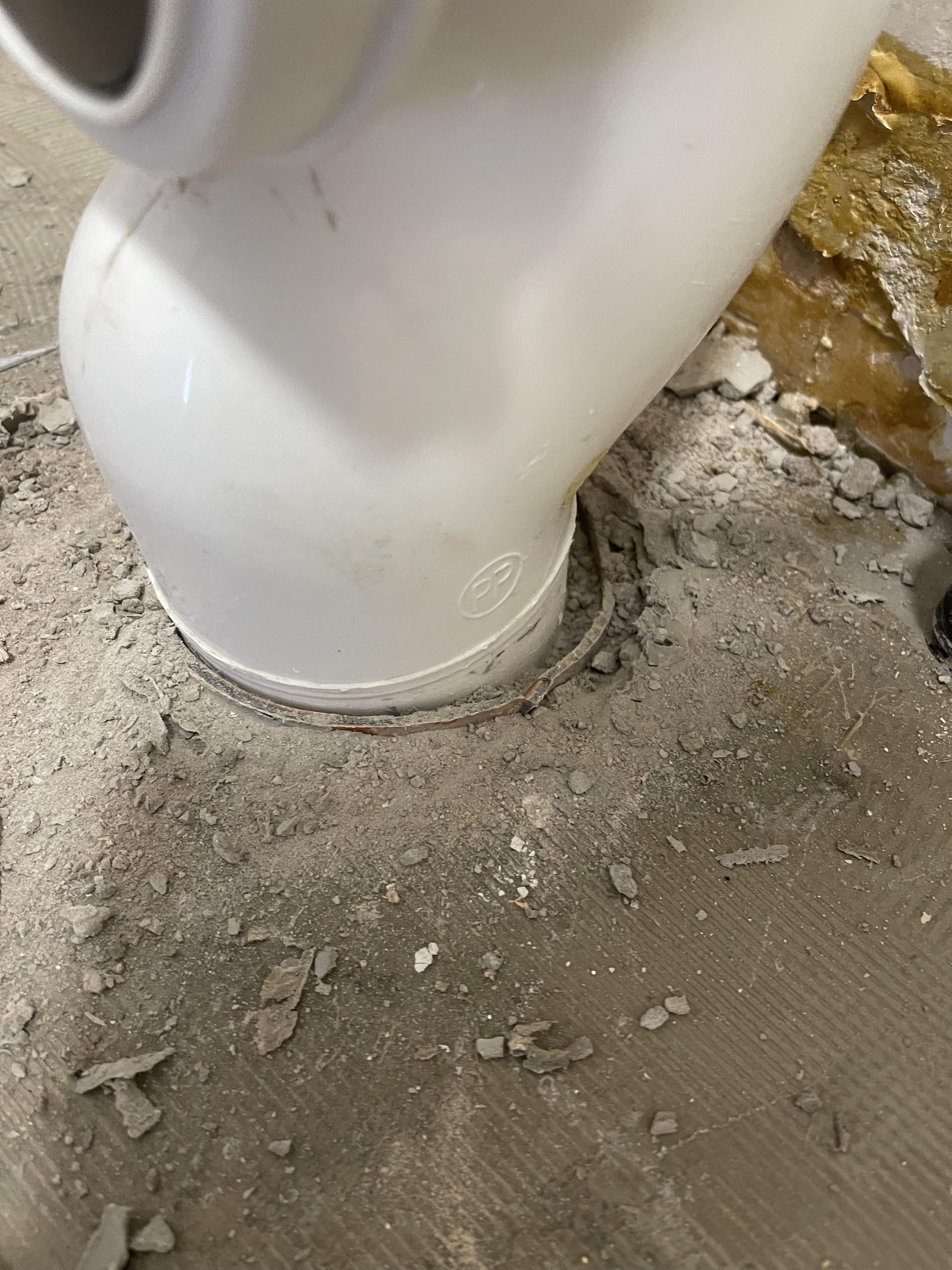

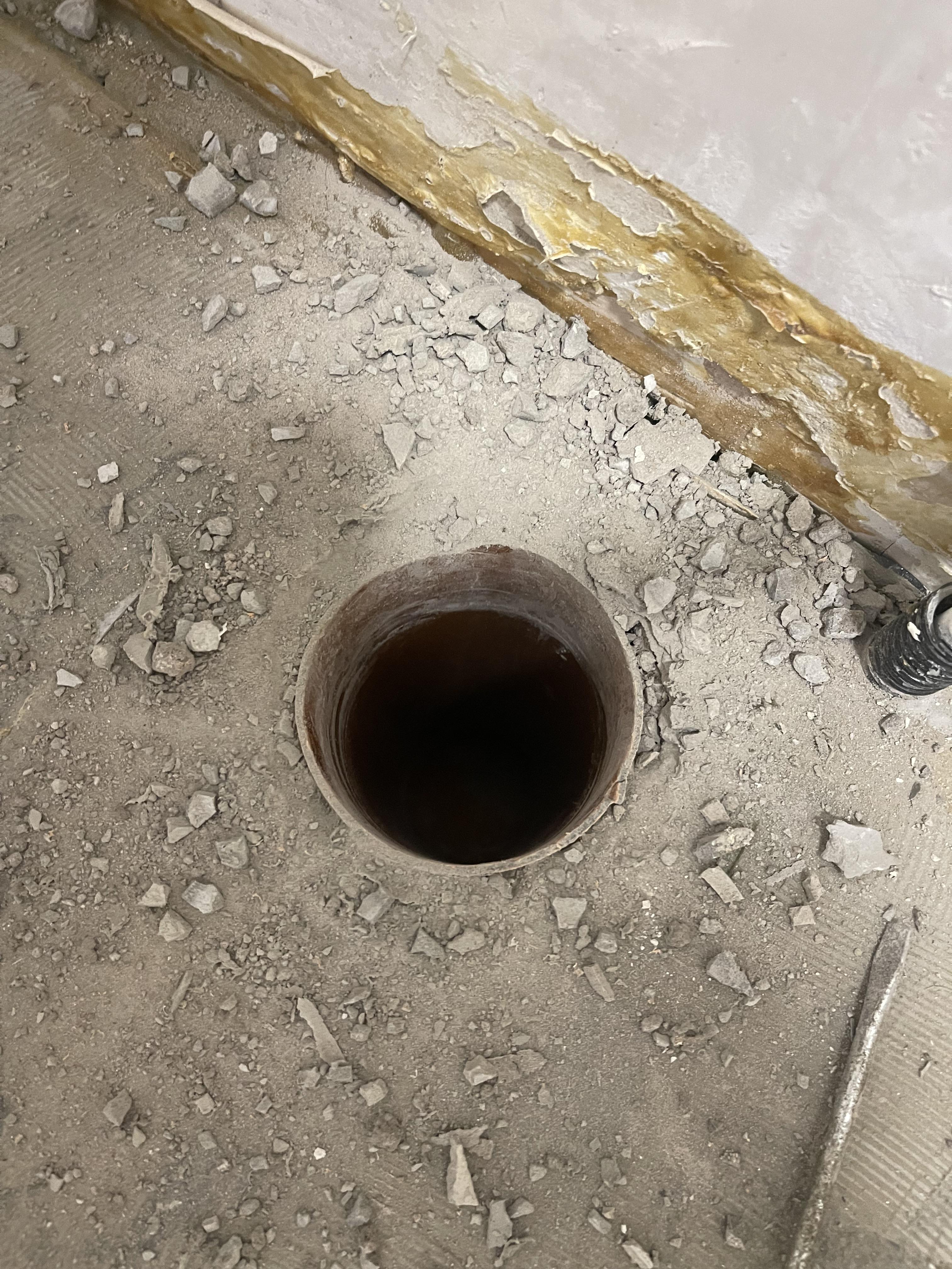

  2. It’s started to budge thankfully. As I suspected, there was screed or concrete jamming it between the soil pipe. Next question, what pipe is best suited to replace it with to install and close coupled wc? edit: And out it pops.
  3. Thanks so much for the reply. I have tried applying brute force and ignorance and it doesn’t budge so I am left wondering if the self leveling compound used on the floor may be preventing it from coming out? Should I try and chip away at the surroundings of the pipe? (updated photo provided)

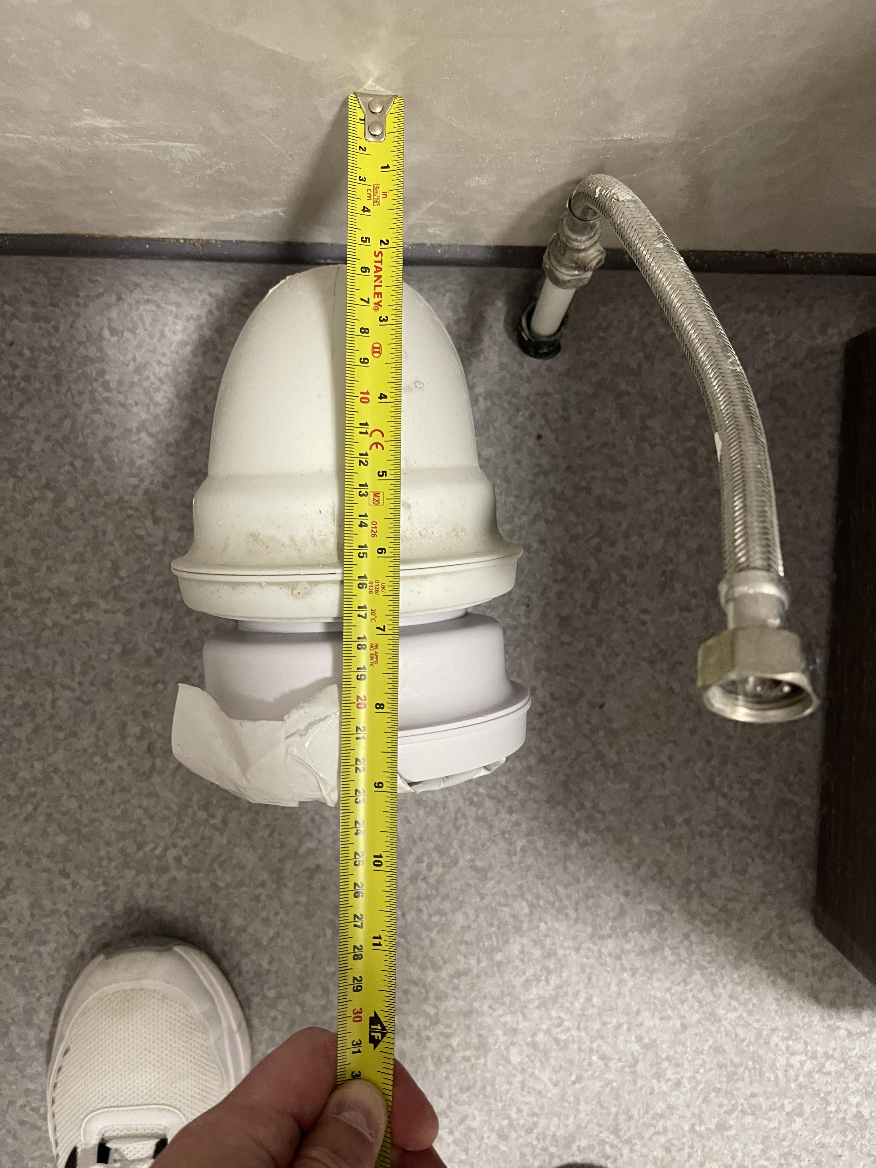

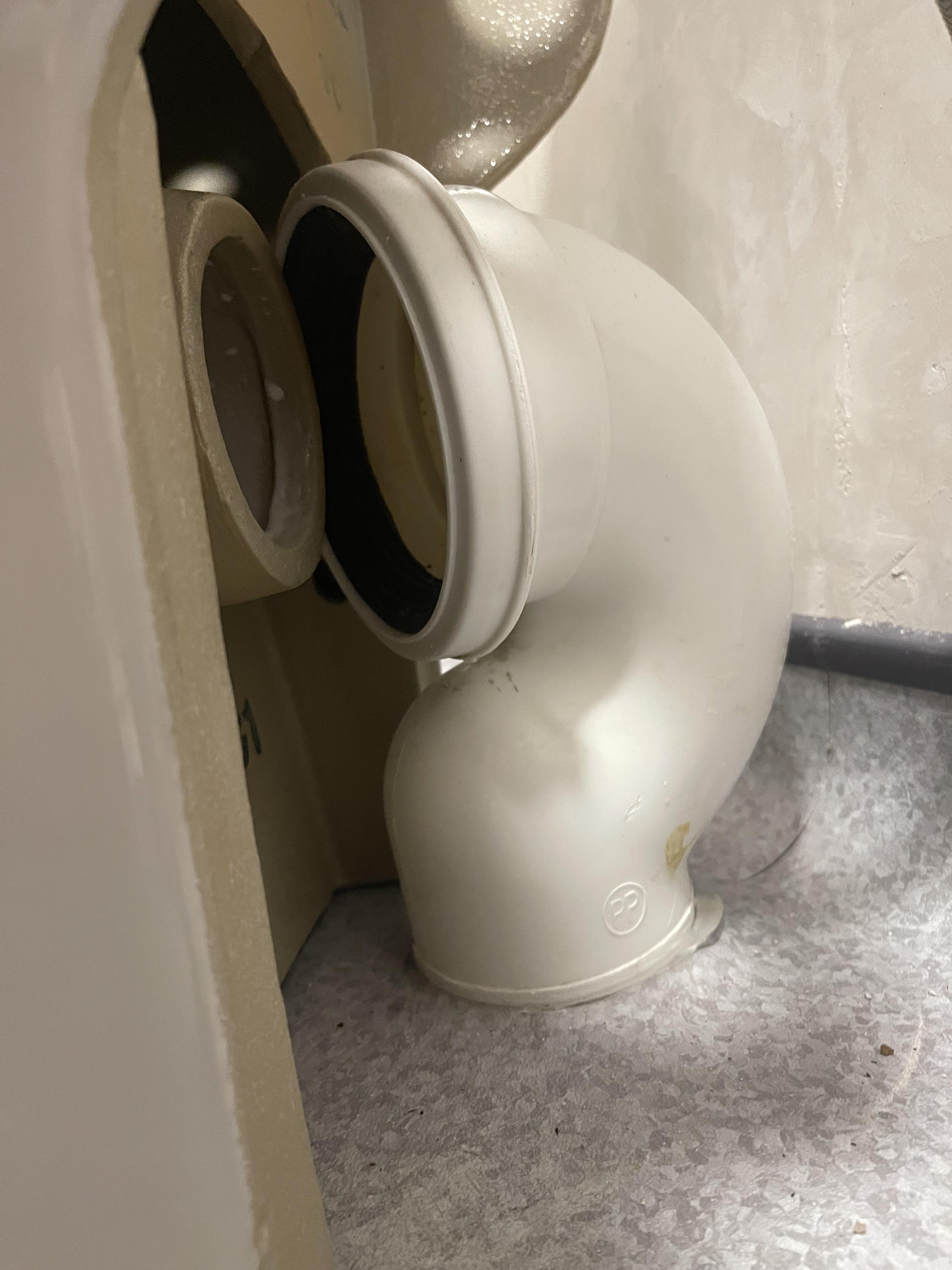

  4. Hey all, New here and I hope you don't mind me asking for some help right away? I am replacing a toilet but have hit an issue relating to the soil pipe. The toilet I removed was a an open backed toilet whose cistern sat further back from the pan. The toilet I purchased is a close coupled wc whose cistern sits flush with the pan. The previous toilet made use of an offset connector pipe for reasons that can be seen in the pictures supplied - the soil pipe sits lower than the toilet outlet. Unfortunately I cannot remove the Swann neck and this is not for the want of trying either. I guess it is stuck in either due to the floor concrete and/or the self-levelling compound. I assume that I must use an open backed toilet again and an off-set connector pipe? I note that toilets have various different measurements from the soil outlet to the back to the cistern. Given the measurement I supply in the picture, is there a certain wc I require? I wish for the cistern to sit tight against the wall. Apologies if these questions appear silly to some.
