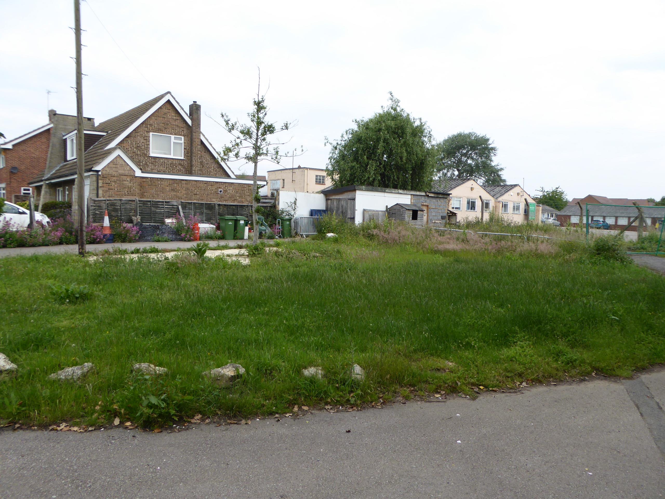

Whilst waiting for the plot purchase to move forward I am still undecided on the build method of a 130 sqare metre bungalow, although I am tending to favour either timber frame, or SIPs, or a hybrid of the two. Anyway, I saw an advert for this lightweight pile system on the back of a magazine which piqued my interest: https://www.shire-uk.com/product/shire-quickbase/ Although apparently more expensive than the traditional concrete it does seem to have a number of advantages, one of which is a degree of adjustability to meet the frame manufacturer's stringent criteria on levels. It seems to me that it should also provide a predictability of cost, provided the required topographical survey is done. Apparently the insulated floor slabs need covering with timber sheets if UFH is to be installed and they are even strong enough to be used for a garage, so no more lying on a cold floor! A brick outer skin can be accommodated, though this obviously has an effect on the structural calculations. The depth of excavation is only 600mm and is only required where the beams sit, so potentially much less muck to cart away, and therefore less disruption on the single track cul-de-sac where the plot is. It seems an attractive idea to me, but I welcome any comments .
Thank you all for your responses. The Planning Permission's 3 year period expires in February 2020 and development has not yet started. The reason for the delay is that although I agreed to buy the plot in September last year a very small part of it belongs to the Government, so the seller is trying to buy that piece, because it is key to the viability of the site. I did raise a topic last year about this scenario, but we are no further forward, due to problems at the Government Property Office. The seller's plan was to start the development by putting in a small stretch of footing, but the problem I see with that is he will still have to comply with the condition about a contamination assessment, as well as the one about getting the external materials approved. However, apparently he has now been told by his architect that the PP could be extended, although having had a quick look on the internet there seem to be a lot of "ifs" and "buts" attached to that approach. In any event, I do not wish to use the approved plans, so if the seller is compelled to reapply, we need to come to an arrangement, because I will have to engage a professional to draw up plans for submission, which will take several weeks/months and cost a pretty penny no doubt. Obviously I don't want to spend a lot of money unless the plot is "in the bag". Since writing the original post I have spoken to three different companies about a contamination assessment, all of whom were substantially more expensive that the one I mentioned. However, it did seem that a Phase 1 desk study would be sufficiently detailed enough to act as a pre-purchase report, although probably not enough to satisfy the local council.
I have found a local plot, with Planning Permission, and agreed a price with the seller. However, one of the conditions imposed by Milton Keynes Council (MKC) is: "Prior to any development taking place, the developer shall carry out an assessment of ground conditions to determine the liklihood of any ground, groundwater or gas contamination of the site." It then goes on to explain that any remedial work will have to be approved by MKC and carried out to their written satisfaction. I have received a quotation to carry out such an assessment, which would be in two parts. The first phase consists of a site walkover and desk study, and this costs £700 plus VAT. In the quotation, the following comment is made: "As the site was a residential garden, it may only require the Phase 1 report. However, there seems to be an electrical sub-station close by, so may need soil testing and risk assessment". I assume the inference is that there may be underground electricy cables, although I need to ask what triggers the requirement for the additional tests. This extra testing would cost another £1,000, plus VAT, so potentially £2,040 in total. The seller has not complied with this condition, as far as I am aware, so my question is: should this be done before I sign on the dotted line? Is the ground surveyor's report likely to be full of caveats, bearing in mind the acid test is when the groundwork contractors actually start work.
