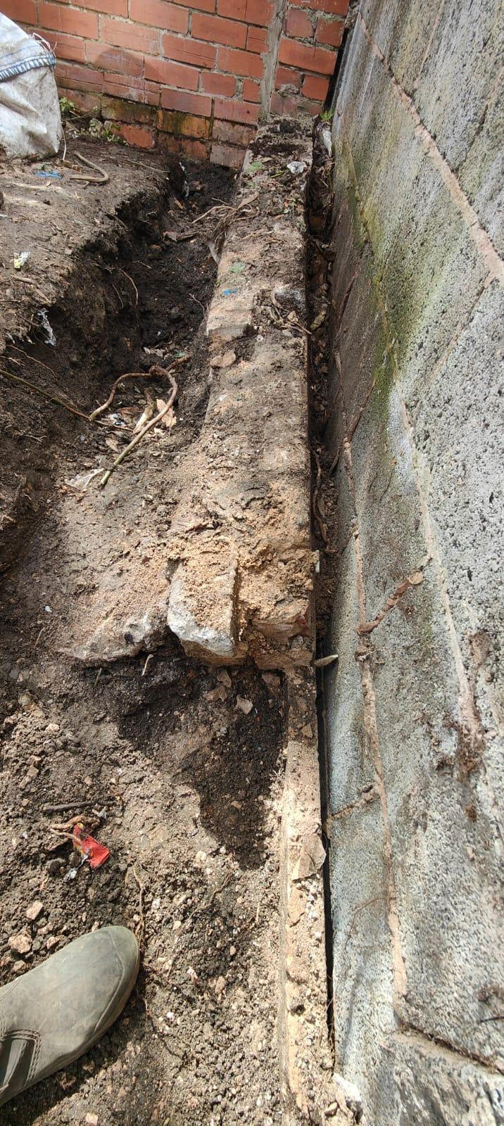

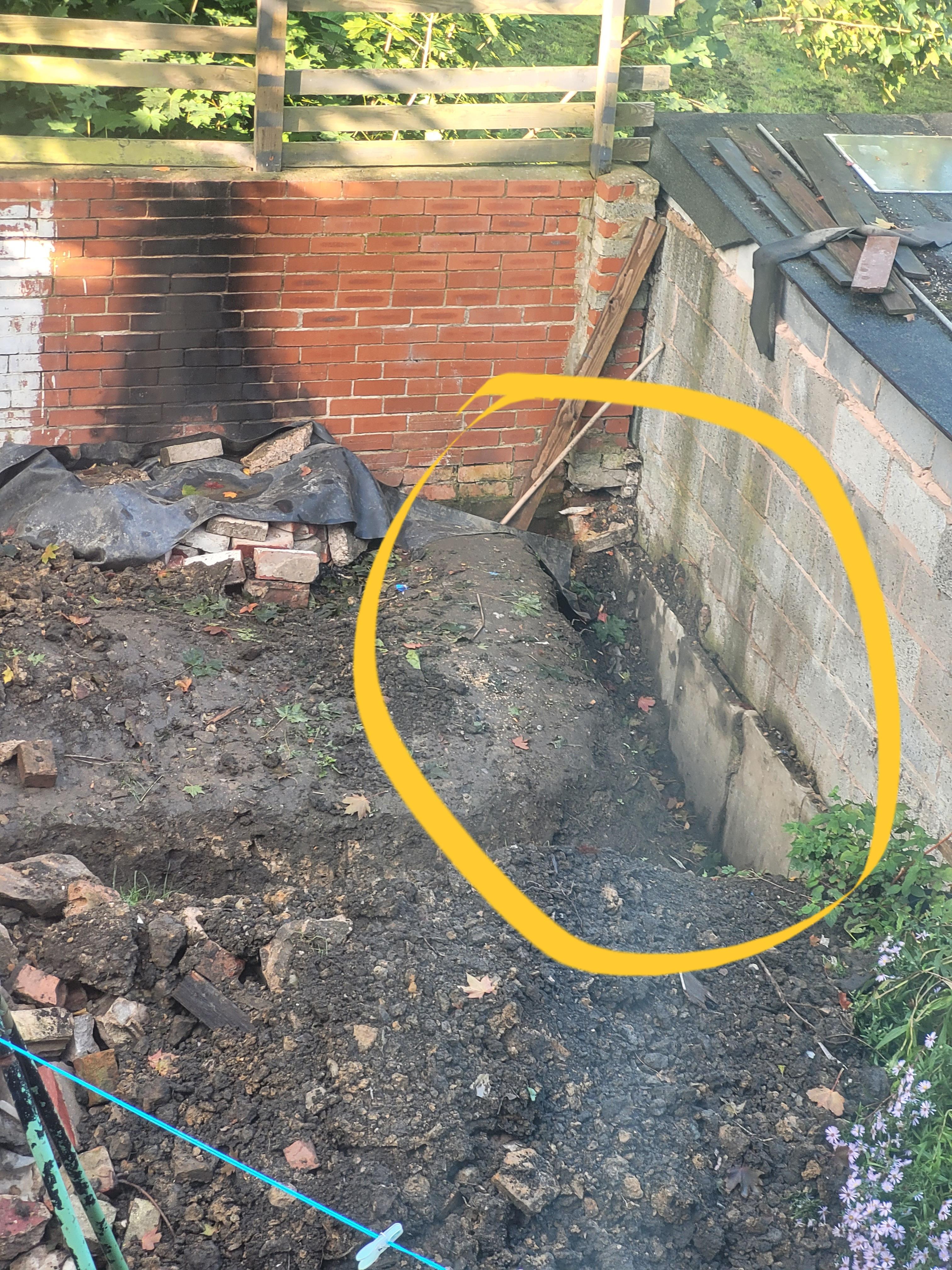

  1. Bump on reply
  2. I dug out in front of bricks in order to see how deep the foundations goes. And on the left hand side this is roughly 5 bricks under the ground but as the garden is on a slope, so the right hand side where the neighbours wall is must be at least 10 bricks down if the person who build the wall did it properly. My plan is to take this wall down to blelow ground level and make this wall into the back of the outershed with breeze/concrete blocks.
  3. I dig in front of it to see how deep the foundations of this wall goes. It is roughly 4 bricks down before I hit concrete
  4. Is it possible to go half way down vs all the way to the foundations level? Also what do you mean my undermining that rear brick as I am taking that out and going about a foot below the foundation to build it back up again. Lastly I've uploaded that 2nd pic.
  5. Yeah my only worry is as its soil underneath, how far is the ideal footing. Also I know it's a outershed but don't want to do the work twice had have issues later on down the road.
