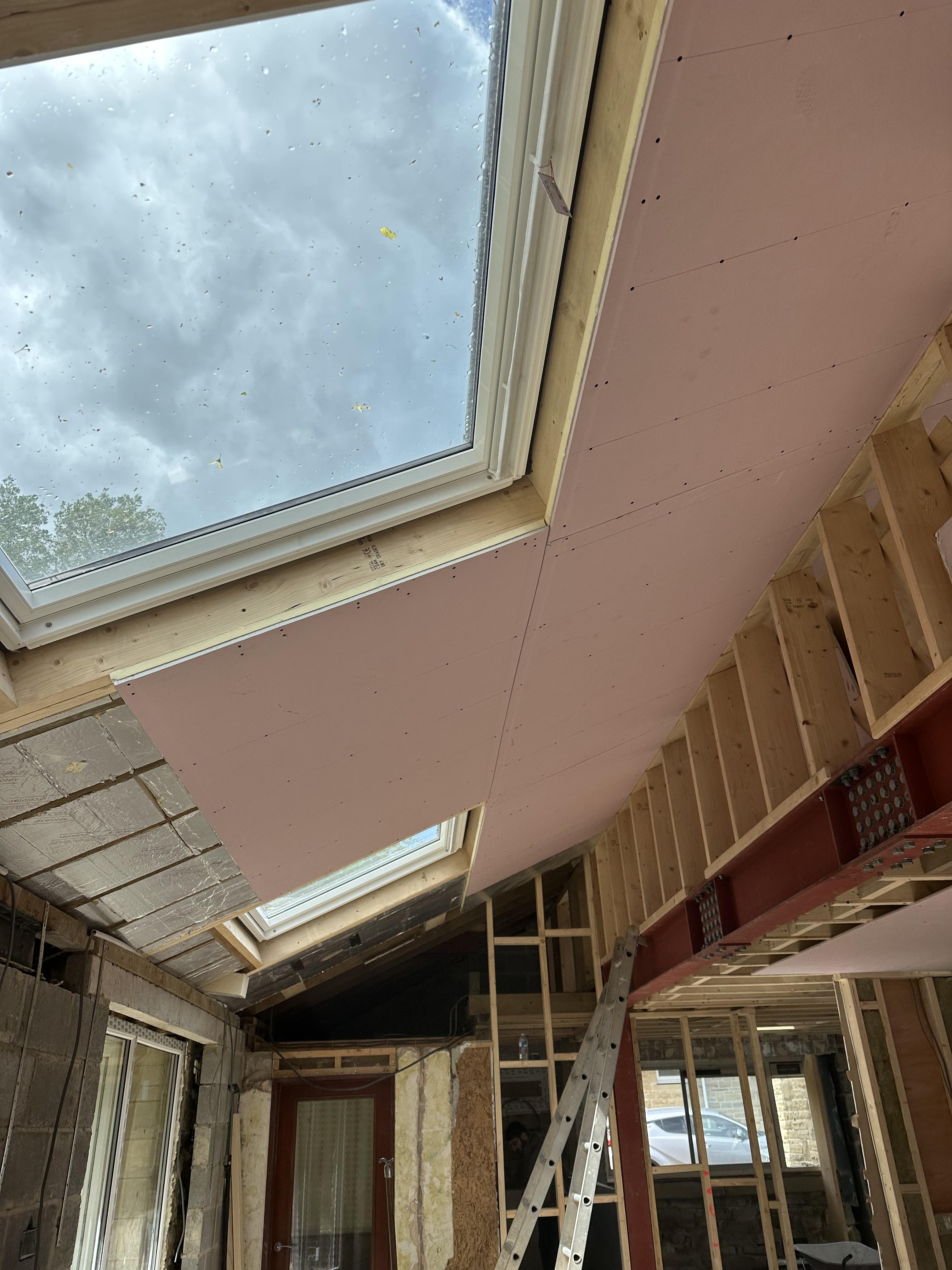

Cocopop17's Achievements

  2. The length of the beam is 7.3m long so needed splicing to be able to get it into the building. We originally took a wall out that supported the rafters mid span so had to install the beam and structural wall anyway to support the rafters again. The half vaulted ceiling was an after thought.
  3. Thanks for the reply Mark. There is the same setup on the opposite side. A steel beam with a Structural stud wall supporting the roof. The stud wall supports are Approx 1m from the ridge of the roof on each side. Does this mean the rotation is less likely to occur? I have requested it in writing.
