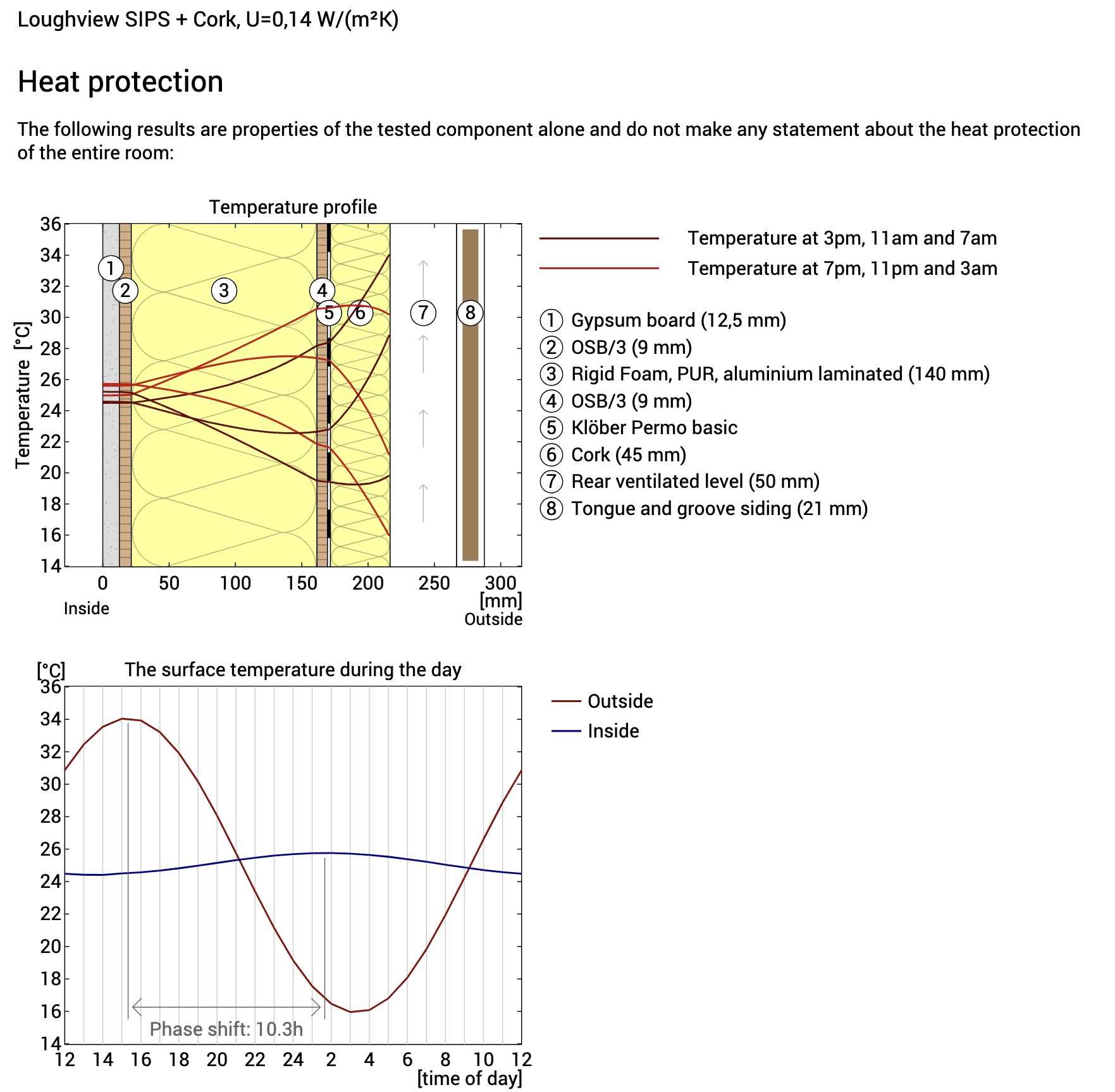

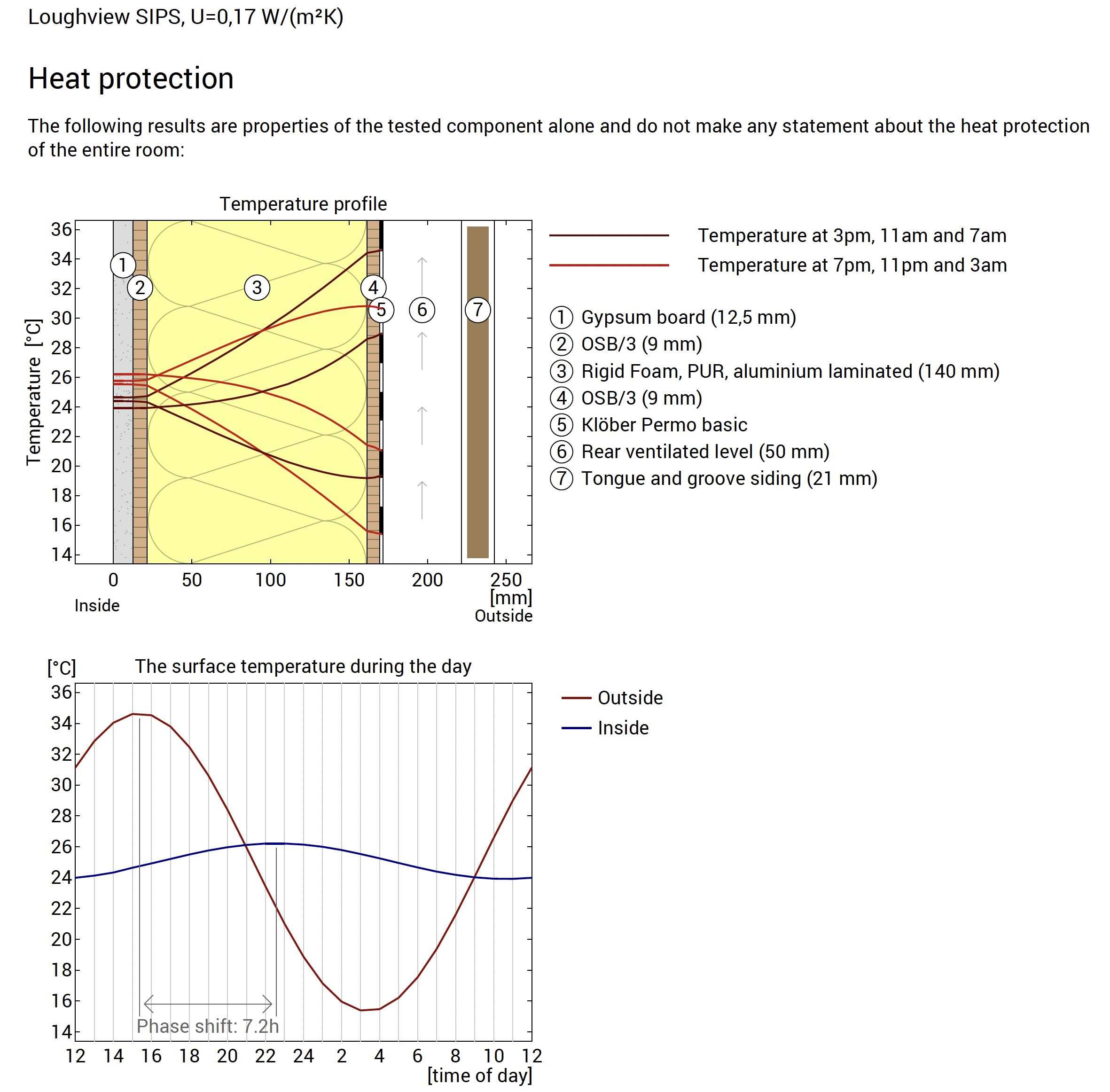

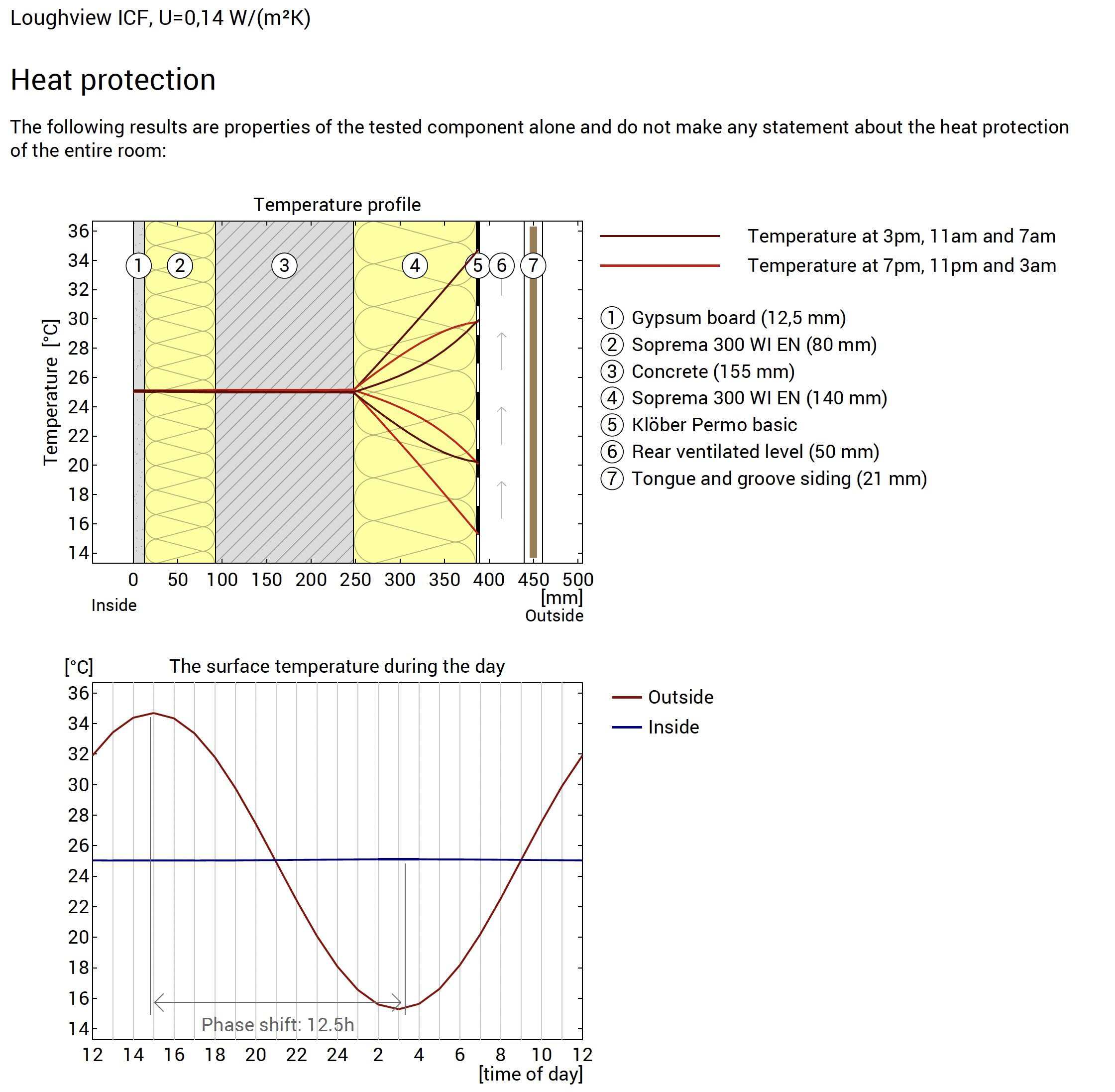

Hello I've progressed a house design using ICF, but got concerned at all the detailing so that various things could be installed - from boxed/hidden blinds to fixing of heavy items - and this made me consider SIPS as an alternative. My gut feeling that having density/mass in a build was a good thermal buffer and then reading through various items on BuildHub I found out about decrement and then UBAKUS so I inserted various build profiles to see what the results came out based on a base SIPS option i've seen and then adding 45mm of cork to the outside and finally an ICF build up I like. The benefit of SIPS over ICF now looks to be on the increase I'd get on the internal floor area, with a fixed external allowance, as well as ease of future fixings for what looks to be a marginal benefit due to the difference between the increased phase shift that ICF gives when I look at the temperature difference on the inside surface. Have I got this roughly right or is there a better way to look at this? I have included screenshots of the output from the software for the 3 main scenarios i've considered.
