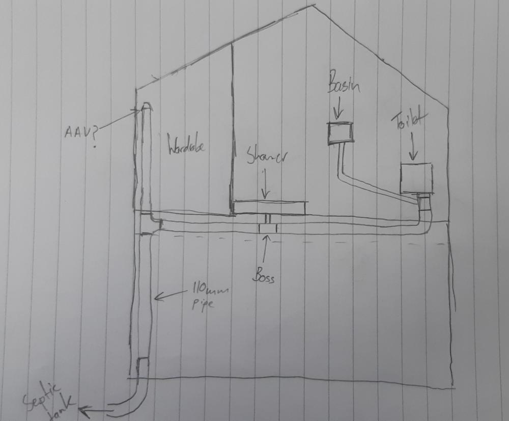

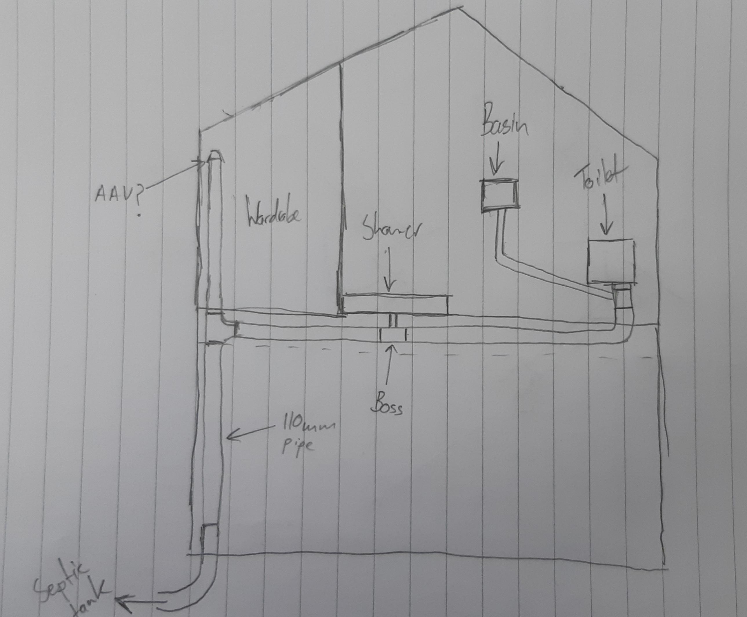

  5. Hello! About to start plumbing the ensuite in the extension and I'd like to get your thoughts on my current plan. Haven't done much of this before, so I wouldn't be surprised if I'm going to try and do something wrong or if there is a better/simpler way of doing it. Apologies for the rough sketch but hopefully shows the gist of it. Ensuite with toilet, basin and shower. I'm thinking of running the basin to the toilet in 32mm and then toilet runs 110mm pipe between the joists to the front elevation of the house before dropping to the rest bend. Was going to use some builders band to support the pipe as it runs between the joists. Bits I'm unsure about are: - Is the T joint for the 'horizontal' 110mm to the vertical okay? Or is this too sharp? - My current plan is to run the shower waste into the 110 pipe using a solvent weld boss using 40mm pipe. Is this okay to do into a horizontal pipe? Not really sure how else I could do it - Can I use an AAV in the wardrobe rather than running a vent pipe through the roof? The architect had put down a vent pipe, but I was hoping I could maybe get away with an AAV. There is already an SVP in the bathroom in the house (the bathroom joins the main line between the house and the septic tank further 'upstream' - dont know if that makes a difference), so it is vented somewhere - Is there a better way of supporting the 110mm pipe? What do you think? Anything you'd change/avoid? Cheers
