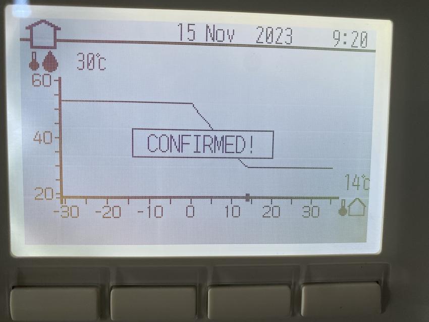

  4. Sorry to show my ignorance again on Weather Compensation. If I enter the weather compensation 1st screen there are two options with the LHS being presumably for "View" and the RHS for "Edit" However if you select "View" there is a provision for adjustment of the lower temperature with horizontal arrows. What is the purpose of this adjustment? The settings bear no resemblance to those achieved by adjusting the High and Low settings from the "Edit" screen

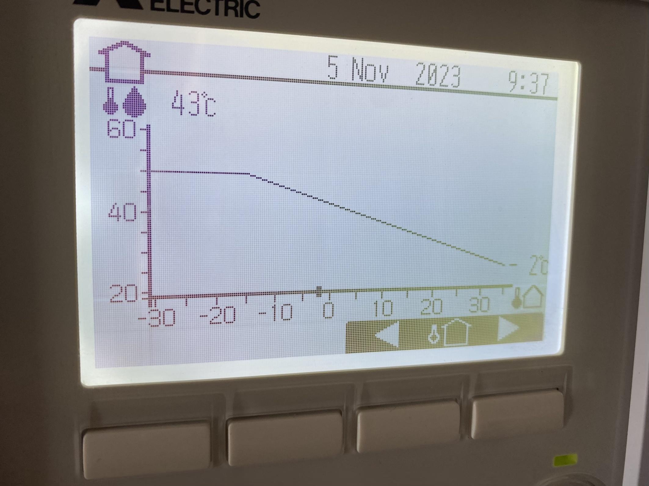

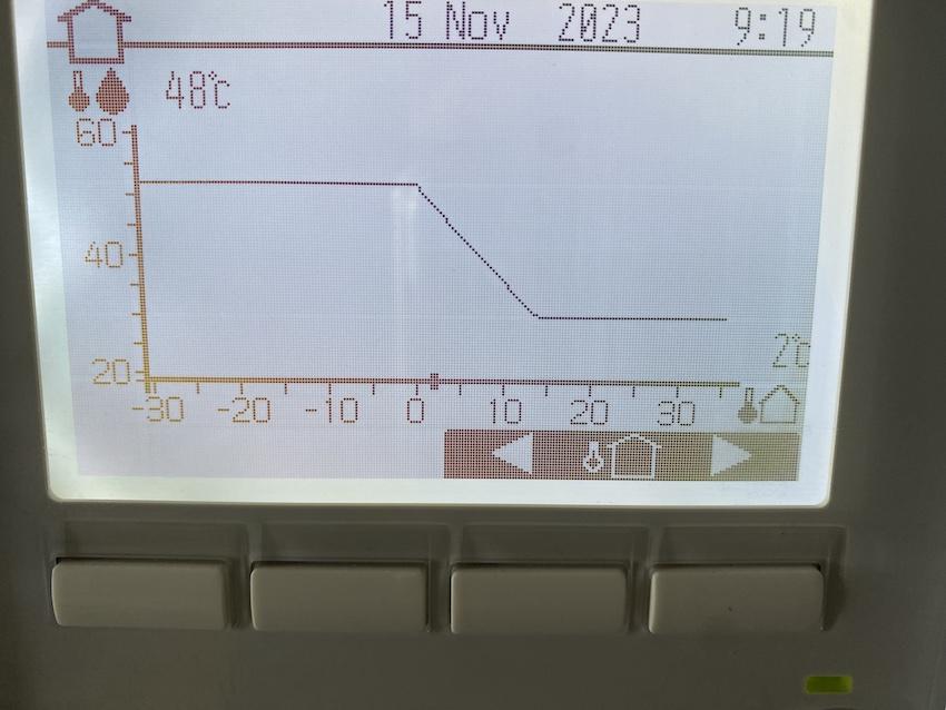

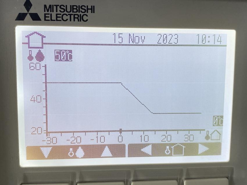

  7. Night temperatures are going down so I am trying Weather Compensation, but not promising results so far. I have looked at YouTube videos but the display and available controls on my unit are not the same and I can only change the lower temperature and most times it returns to -32! Photo attached. What am I doing wrong, please?

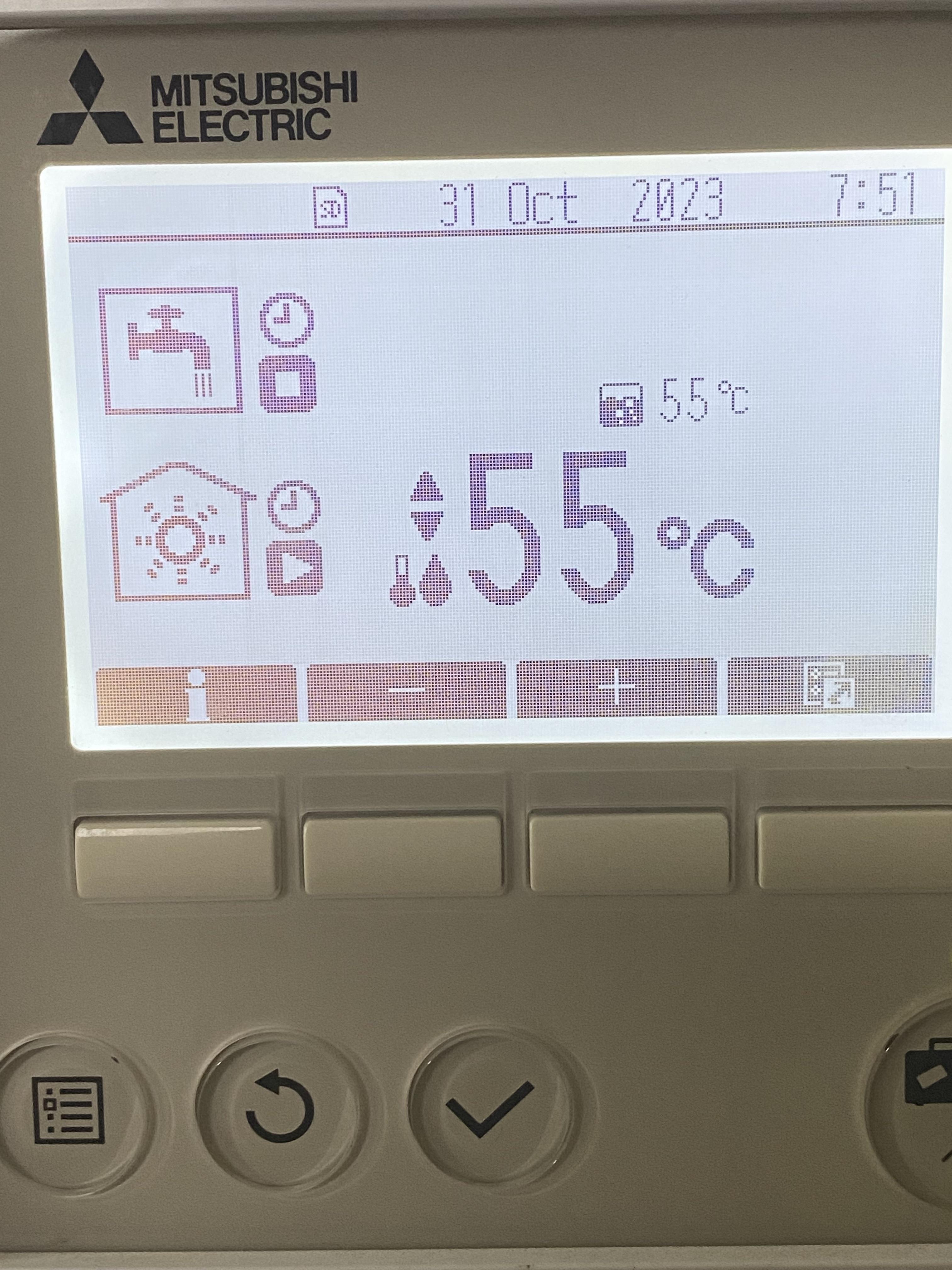

  12. Thank you very much for all the responses. However, it makes me realise that I just took so much for granted with the contractor that insalled the ASHP. For example, as I recall, the system was left with what is now clear, was a 55C target flow temperature and I (wrongly) understood that the buffer tank was being controlled at that temperature. Consequently the radiators were heated at 55C as opposed to the circa 65-70C from the old gas boiler. There was no Mitso room thermostat and the Tado Smart TRV's seemed to do a good job in controlling individual room temperatures. I feel rather sceptical that I will get sufficient heat with a radiator flow temperature of 35to 40 although I recognise that using compensation may deal with this. Equally, I can't see how a Mitso remote controller can work with the multiple Tado Smart TRV's other than setting it at a higher temperature than I would ever need in e.g. the lounge. I would appreciate comments on the above before posting separately on DHW, but I would just make it clear that I recognise the need for timing DHW heat input at a different time to space heating. At the moment, I have DHW heating times of 04:30 to 6:00 and 14:30 to 17:30 and will see how that works
  13. I have a Mitsubishi ASHP (PUHZ-SW120YHA) plus Hydrobox (EHSC-VM20UK) installed by one contractor and a DHW tank installed by another, at a later date. The DHW tank was completed in June and foolishly, I did not check both heating and DHW working together. I do not have a Mitsubishi room thermostat, but have Tado Smart thermostats on almost all radiators. I am including a photo of the FTC5 panel. I hope that the small tank temperature icon to the right of the tap, is reading the DHW tank temperature, although there is a small difference to the actual tank thermometer reading. What I am uncertain about is the “Target temperature” setting. Before installation of the DHW tank this was set at 55C and it maintained the buffer tank at this set temperature This target temperature has three options: Target Flow; Target Room and Compensation Curve, I.e. Which of these settings must I select to control the temperature in the buffer tank? (“Target Flow” seems to be the only one that allows me to set a temperature of, say 55C) The Mel Cloud app confuses things further by showing a set “Set temperature” of 22C and a “Room temperature” of 24C. How can the system possibly know the room temperature with out a Mitsubishi room 'stat? If I try to increase this setting, it just changes it to some figure around the 22C
