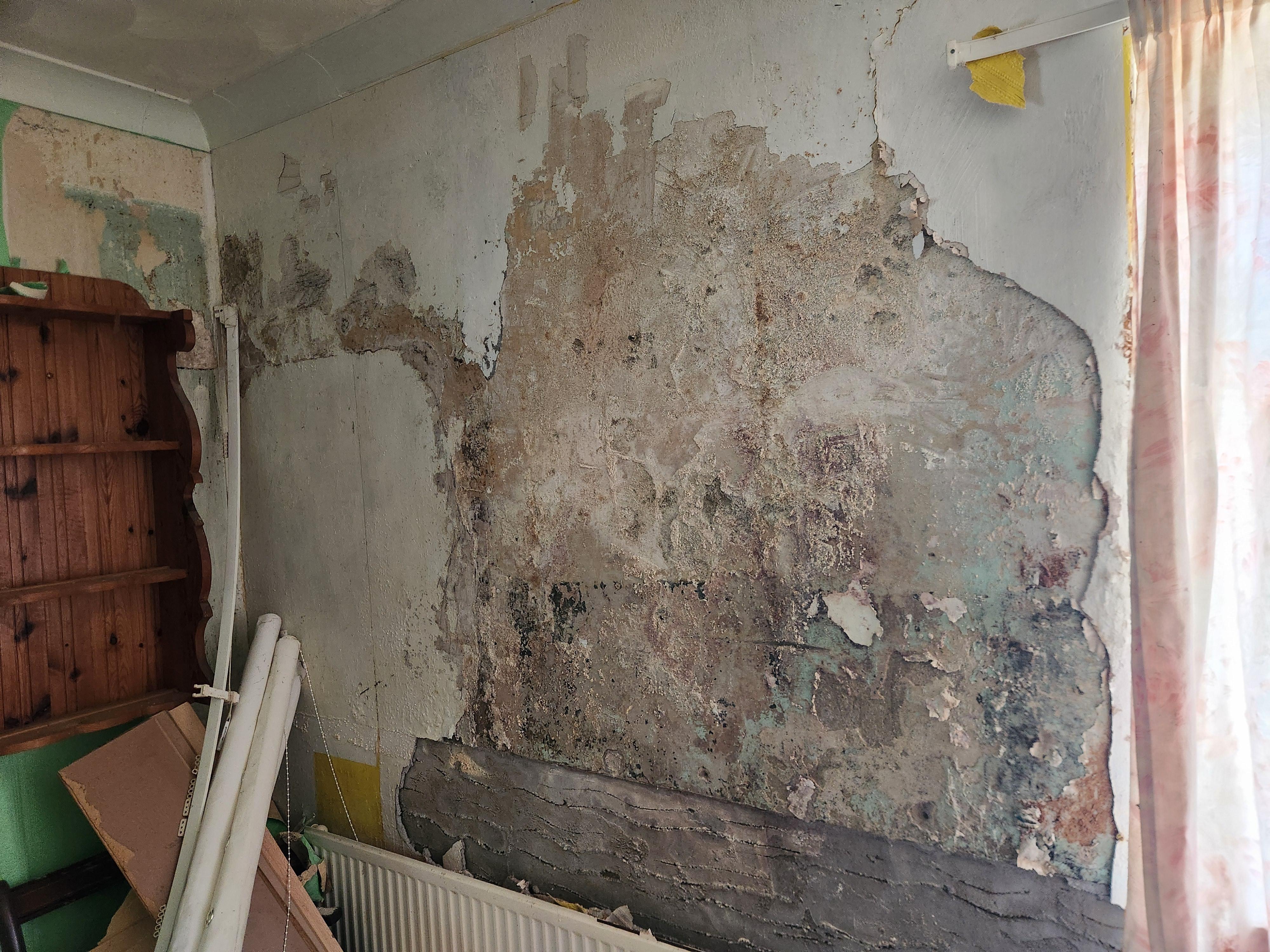

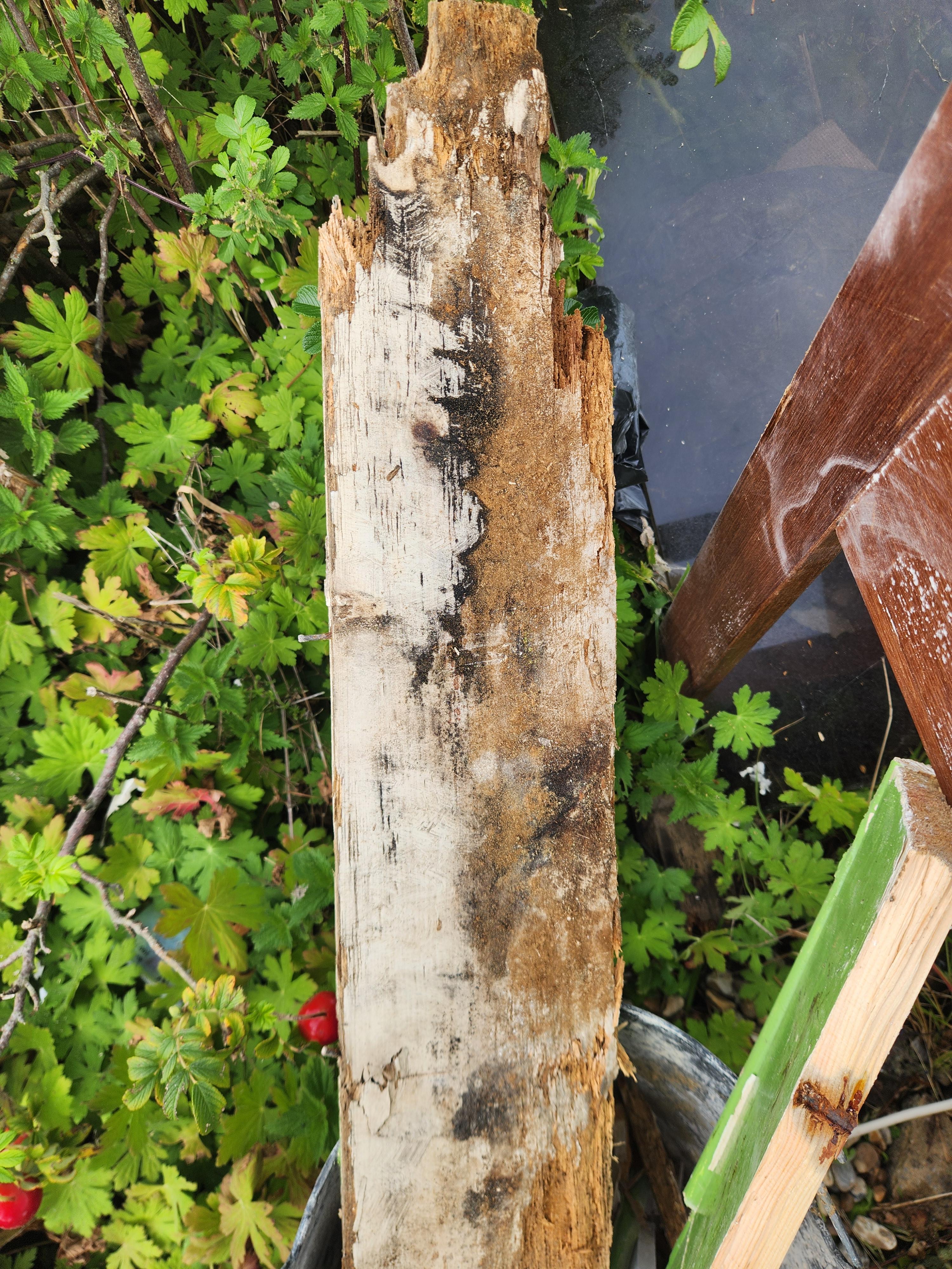

Thanks for the info Mike. I hadn't thought about the potential for the arte to contain asbestos, so that's a good shout for sure. I've been wearing a mask for the majority of the time & have been leaving the windows open as its very dusty! I'll look into purchasing some tests. Yep that makes sense regarding insulation, at the moment the property has an EPC rating of F... So it needs looking into for sure!
Skirting boards seem damp and have lost their strength but the floorboards are still in solid condition and don't show any obvious defects ( to my unprofessional eye).

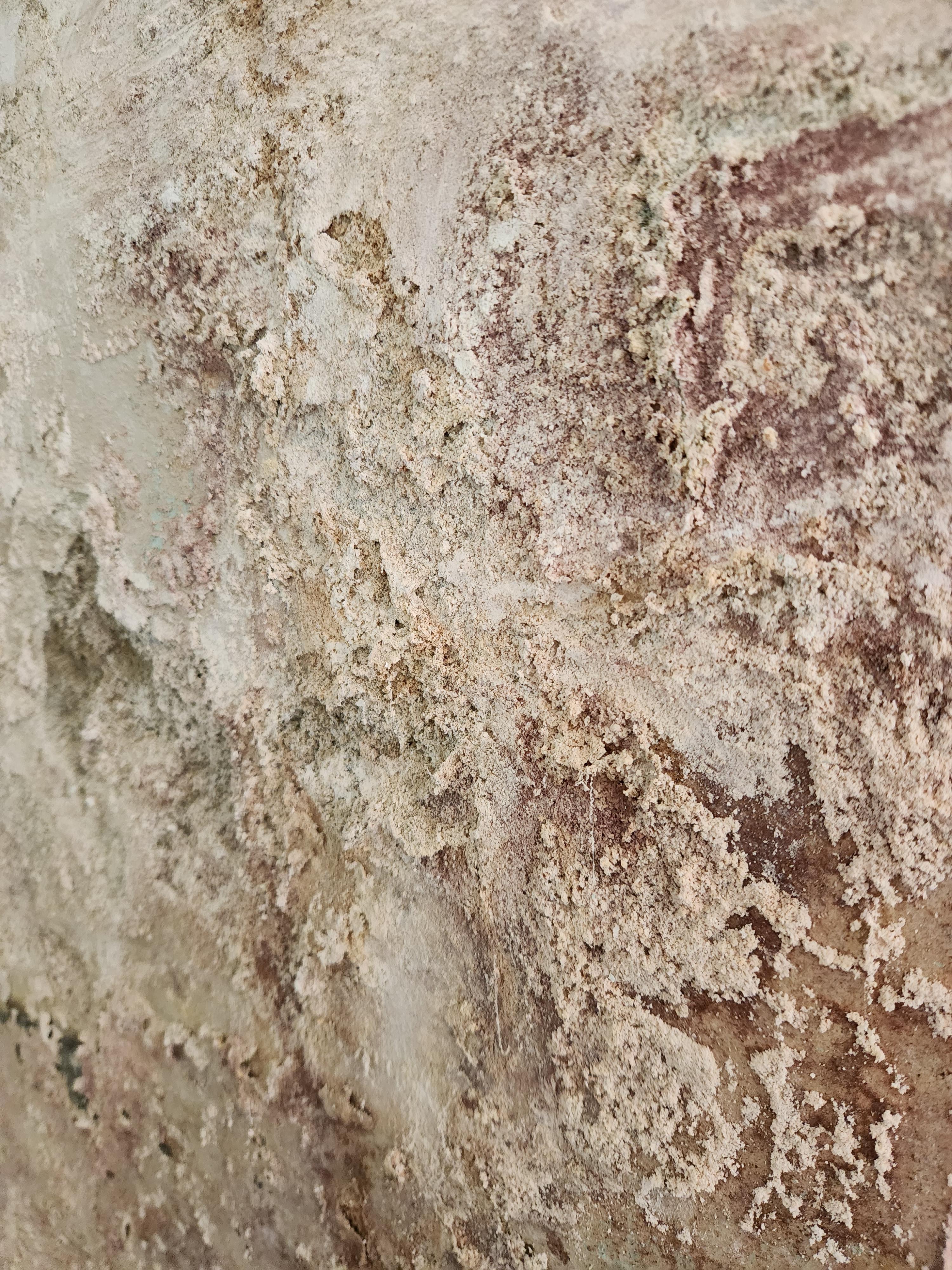

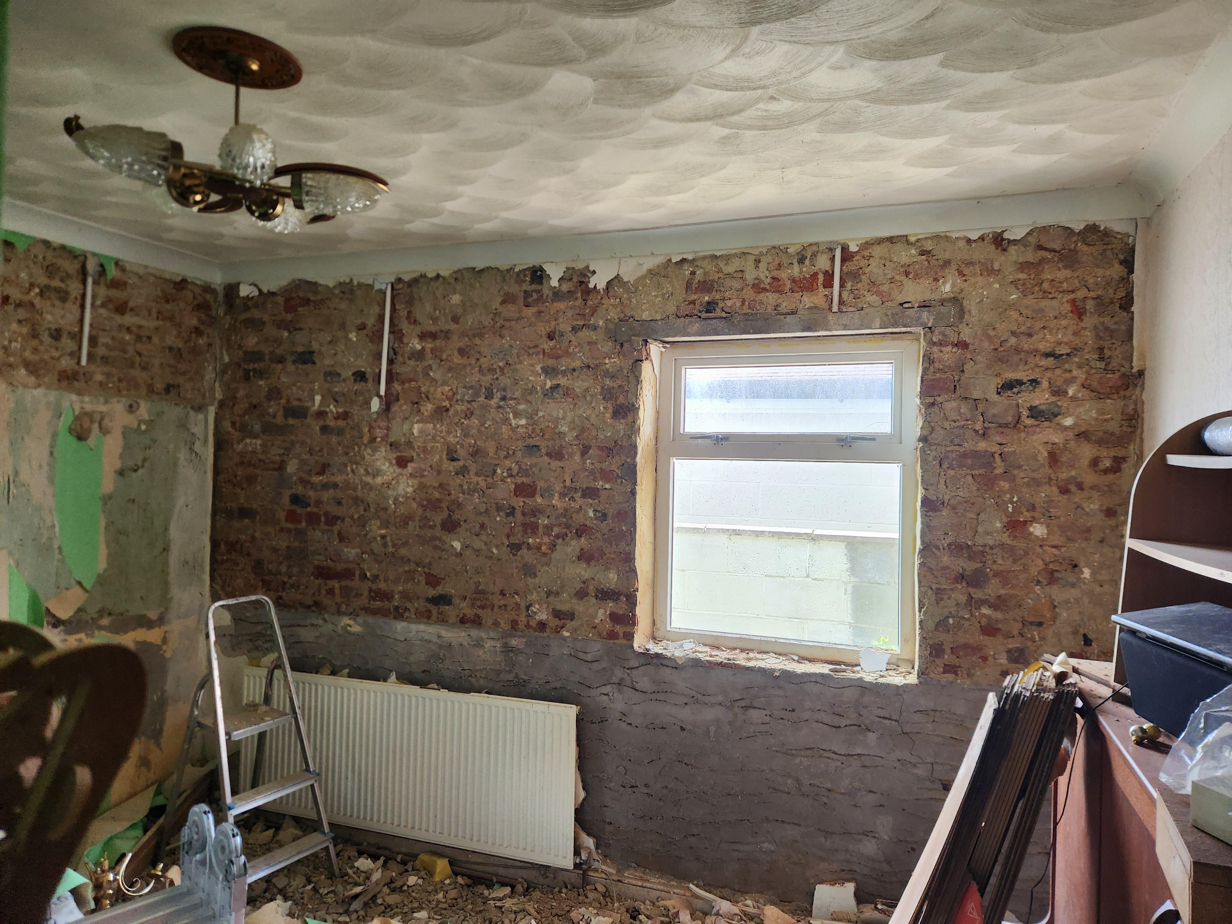

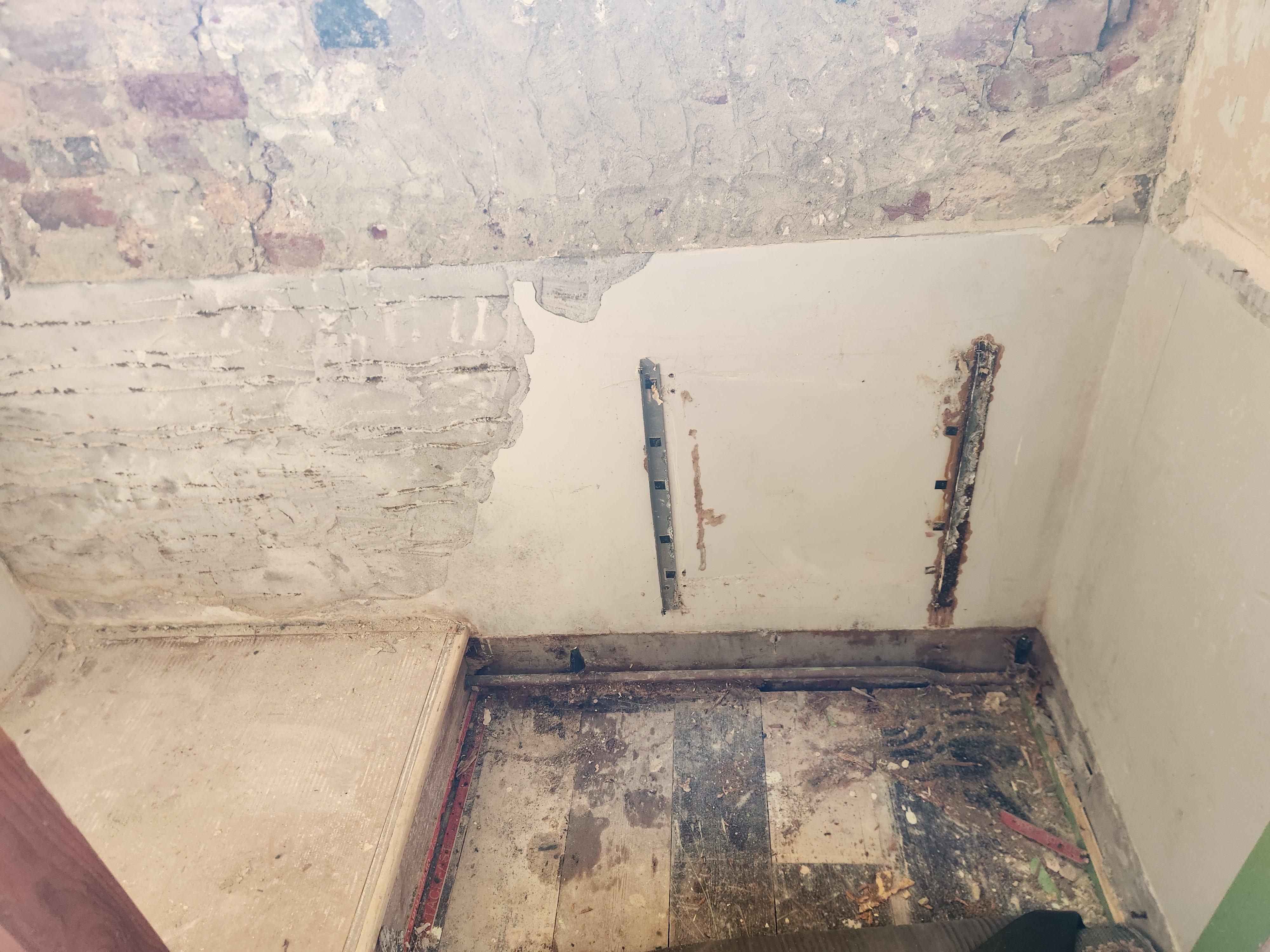

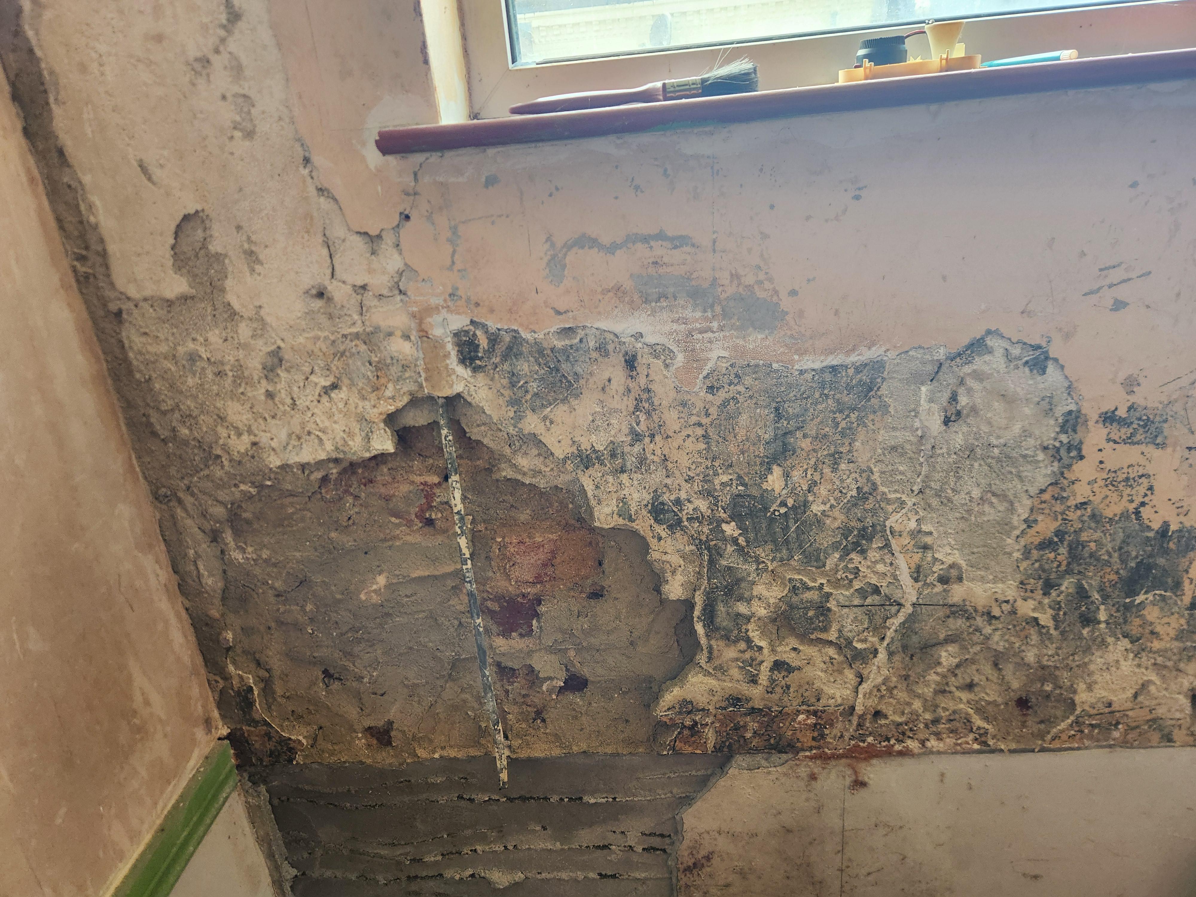

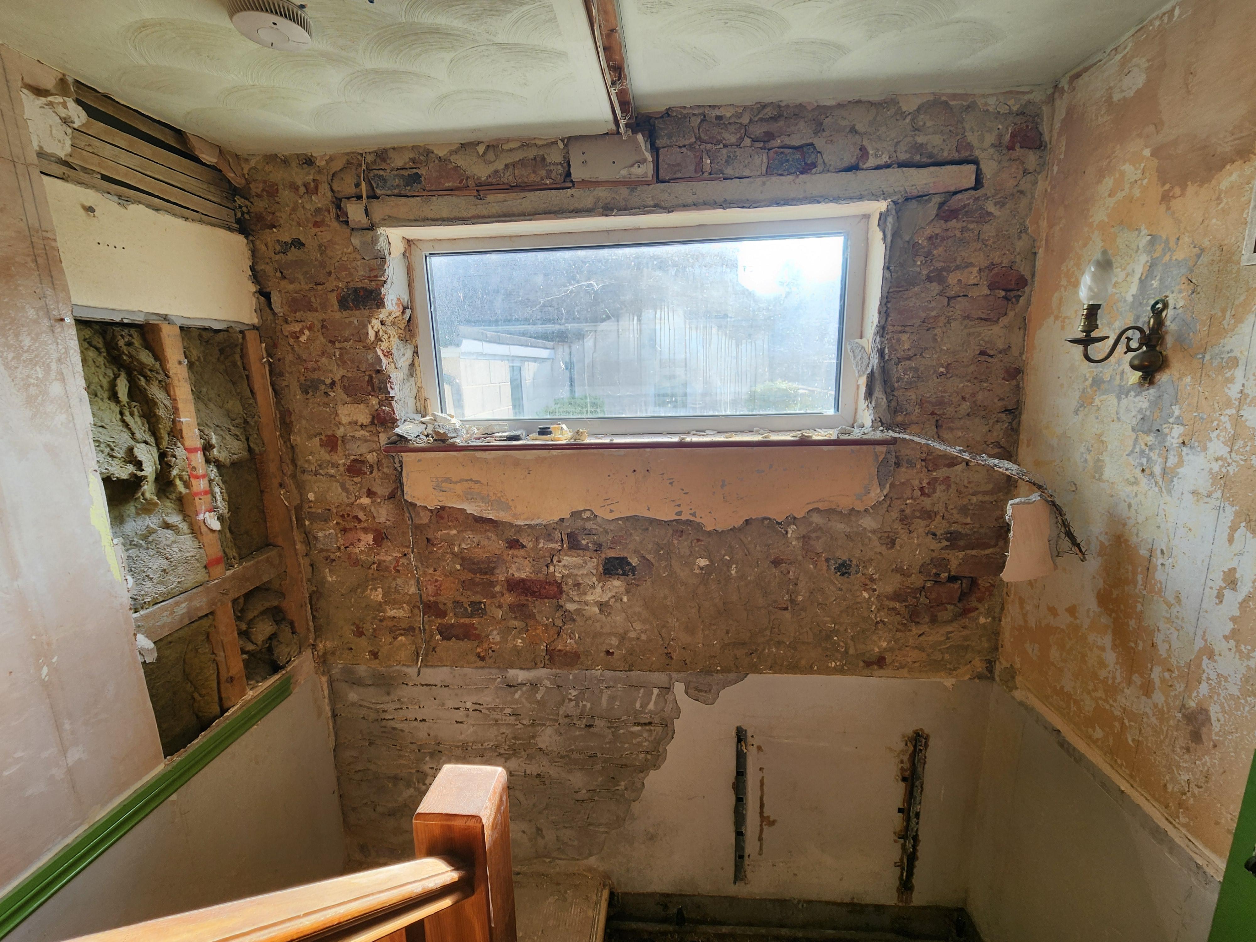

I've recently purchased a property which hasn't been lived in for 2 years. There is a lot of damp on a couple of walls so I called a building surveyor to inspect, he got a builder round and they both suspect that I have dry rot in a number of rooms around the house 🫤 this was in the plaster. I would be very grateful on some advice. I have removed all the plaster on a couple of the affected walls and it's now back to brick ( See photos ). What would you recommend for remedial action? The builder suggested back to brick, injecting / spraying permaguard treatment all over the affected walls then using black jack over the full surface of the wall and then dry lining afterwards with plasterboard and roofing timber. They suggested concreting all the floors but I assume this will be costly and I'm not sure if it's worthy as the damp seems very localised. If I replaced floor boards and joists within one meter and treated all connecting wood with permaguard, do you suspect this to be sufficient? Over the next few days I will rip up all the carpet and inspect the flooring to see if its been affected in the main room. It has been advised to remove all the flooring and joists and fill with concrete, however the condition of the flooring underneath hadnt been seen. I've read online about anything 1 meter from the last sighting of dry rot, so I'm edging towards just replacing nearby floorboards which could have been affected. I believe the cause is due to water ingress through cracks in the render & poor guttering. Thanks for any advice.
