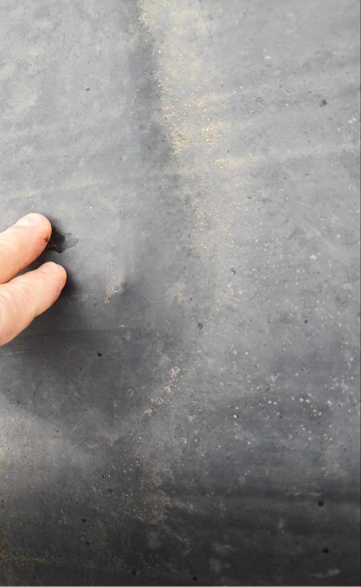

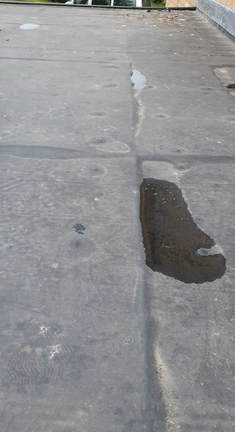

  3. I think they said it was 150mm celotex
  4. Hi Kelvin Many thanks for replying. As far as I know the insulation is 150mm celotex. They said it's then held in place with metal discs and the membrane put on top. I said it feels like it's plywood on top. They then changed their story and said its a thin layer of plywood on top. They told me at the time of installation that I had a 10 year warranty but when they inspected it the other day its only a 5 year warranty now. And typically my luck I can't find the paperwork.

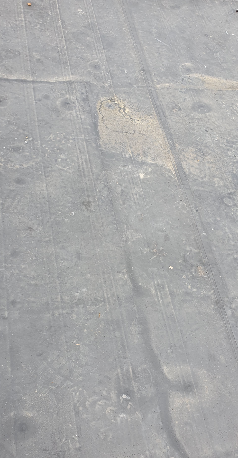

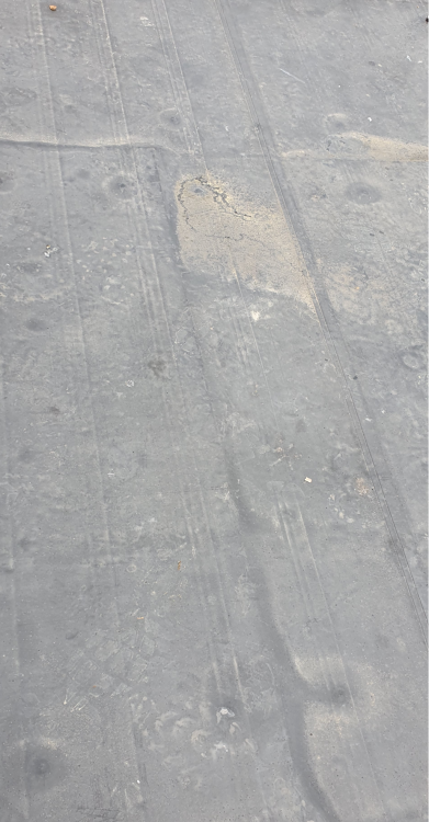

  5. Hello, my name is Michael, this is my first posting on here and I hope someone out there can help me. My problem is a flat roof I had installed about 6 years ago over my daughters bedroom and bathroom (single storey). I had to call a roofing company to quote on another project that involved a flat roof. The man that came to quote told me that the flat roof over my daughters bedroom/bathroom had de-lamented and I should get it looked at. So i called the company that installed the flat roof and they came and took a look and said to me is it leaking? I said no but its de-laminated. They said what is does de-laminated mean, as they had never heard of that term. They inspected the roof and said there’s nothing wrong with it. I said the plywood/insulation is moving in places, and showed them by pushing it up and down. They said that’s my fault for walking on it. Also, you can see the screw heads popping up from under the membrane and parts of the membrane are bulging out. They said that’s normal and are refusing to fix it. I have attached some pictures. Any help/advice would be much appreciated. Many thanks
