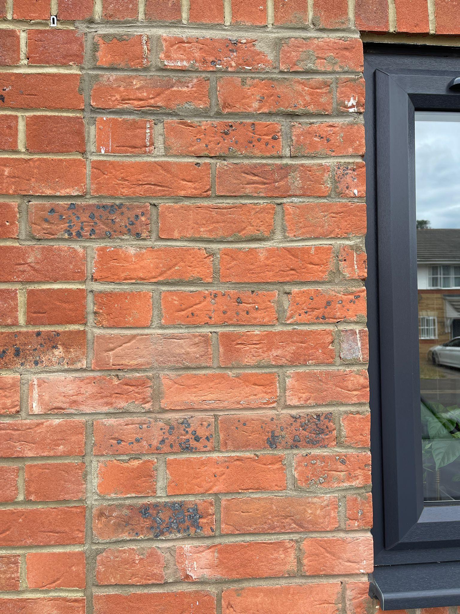

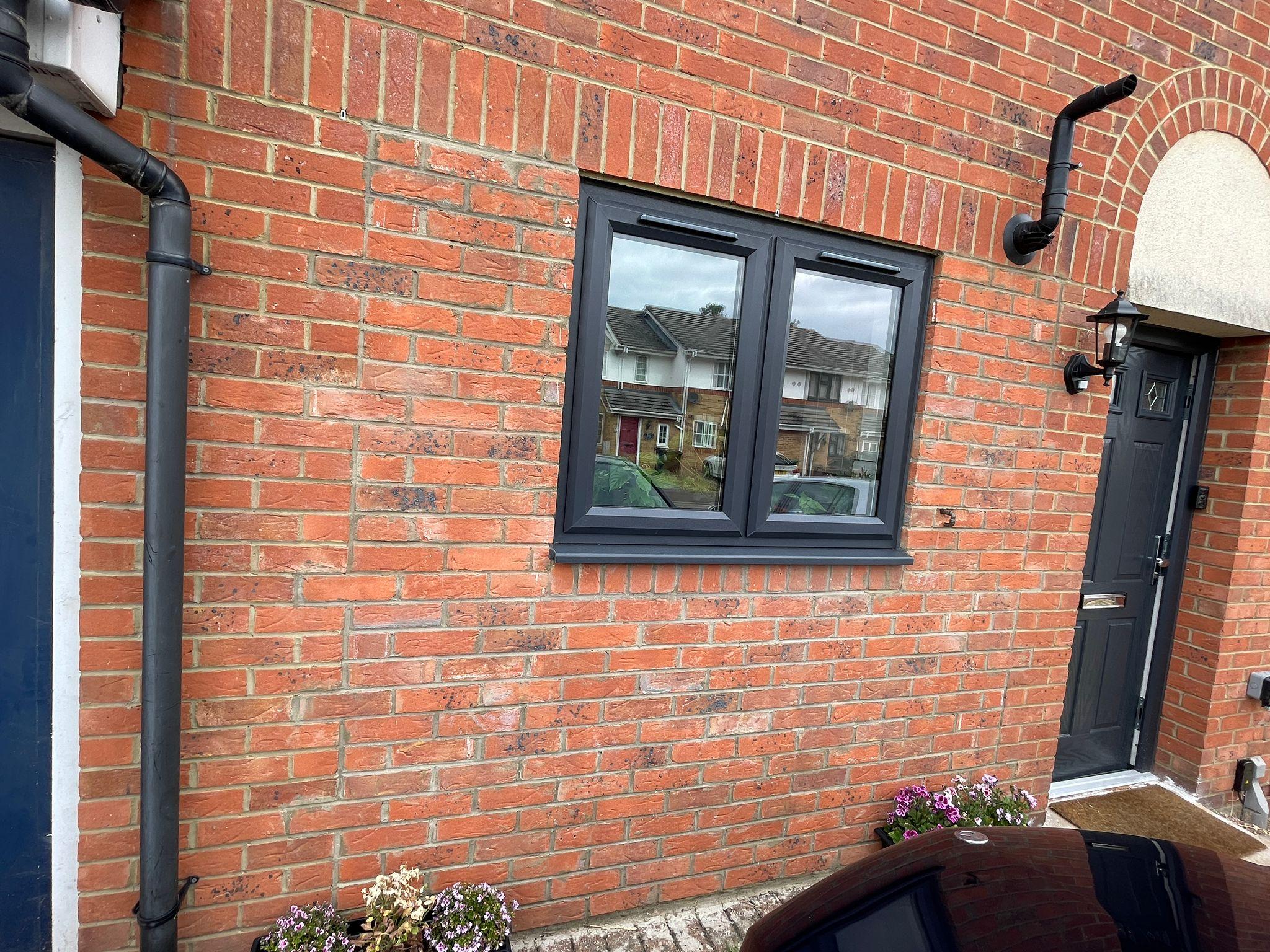

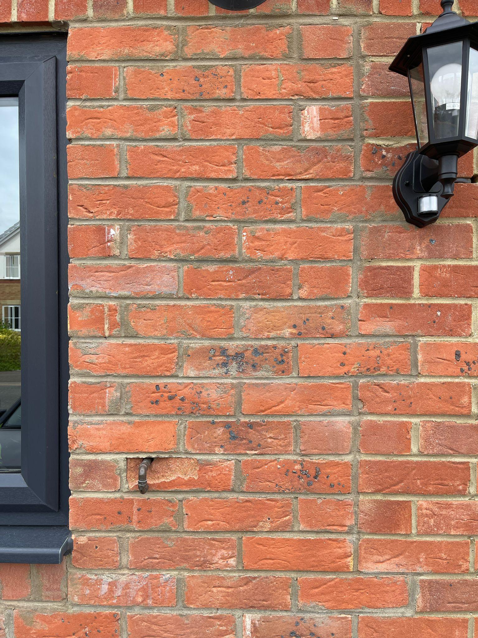

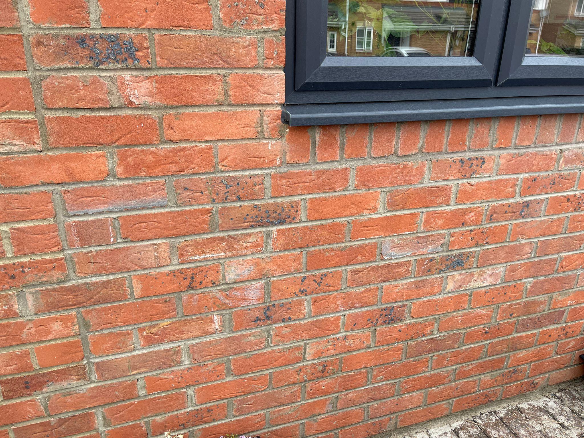

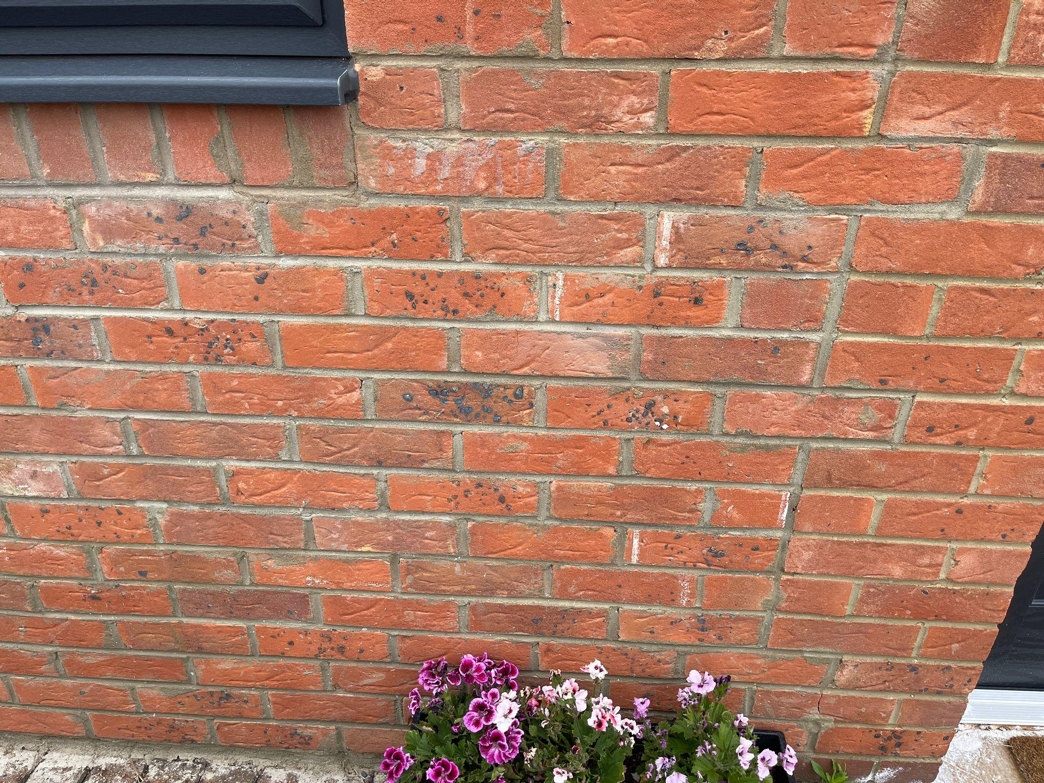

  6. Hi guys, I have a kitchen which used to be a garage and the wall that has been put up looks like a cowboy who hated the job has done it. I just want to make it look presentable and more aesthetically pleasing. As you can see on the photos there is mortar everywhere which could technically be cleaned off but some bricks look like the mortar is filling chips to the corners of the bricks. My intention was to use a wire brush and scrape the thicker bits off and then use brick acid to take the remainder and existing thin layers off, then to use a colour matched brick filler to fill some spots in. I've realised that it is not so easily done as it is hard work as the mortar doesn't come off that easy and I end up rubbing the bricks making them whitish washed out colour which I also do not want. I don't think a regular household pressure washer would do the job either. I am relatively competent and somewhat of a handy man, so I would be grateful if I could get some advise how to get excess mortar off the bricks and make it look presentable without having to be a professional brick restoration expert. I would pay someone to do it as well if the price is reasonable, the property is in Barking IG11.
