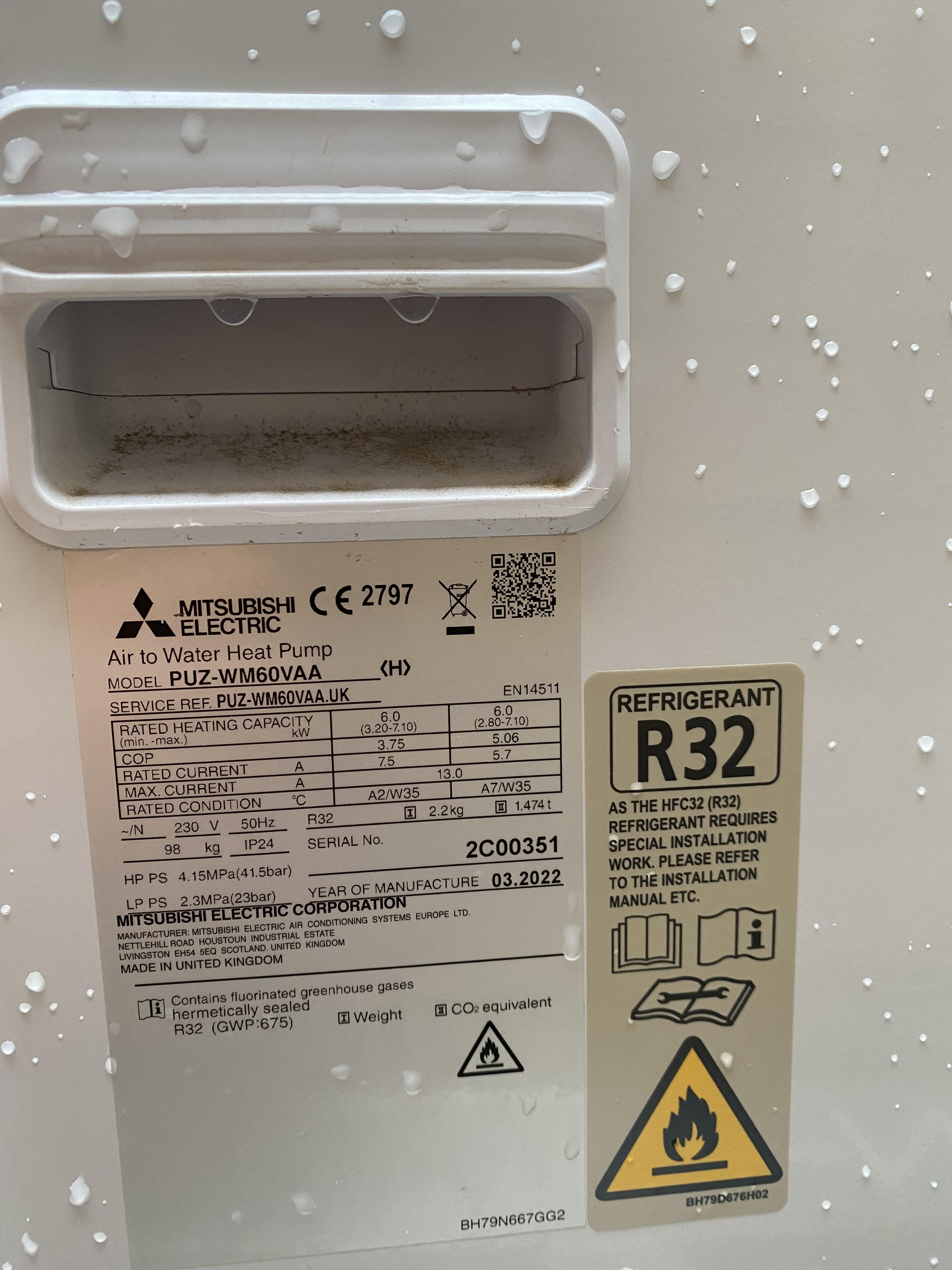

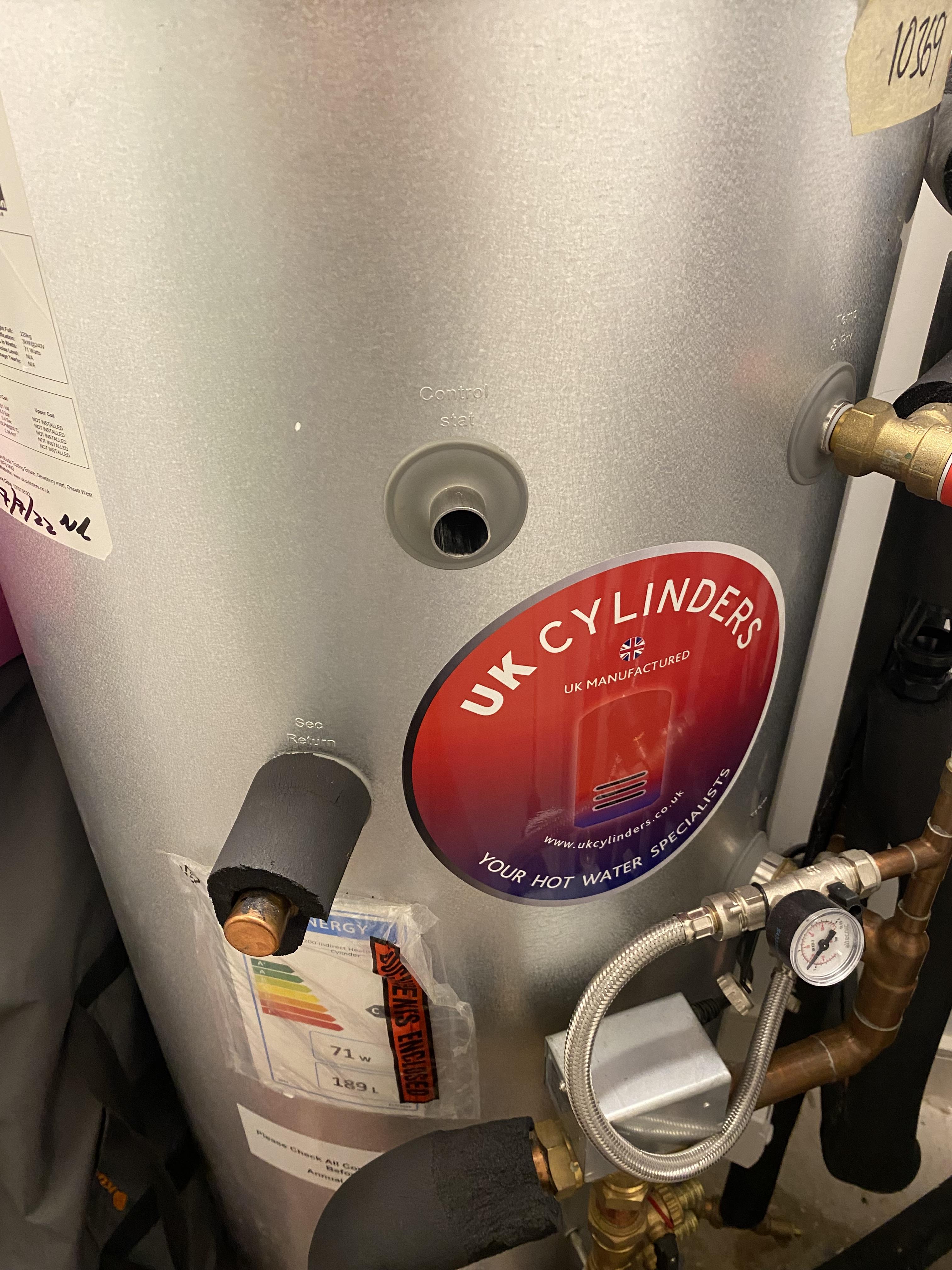

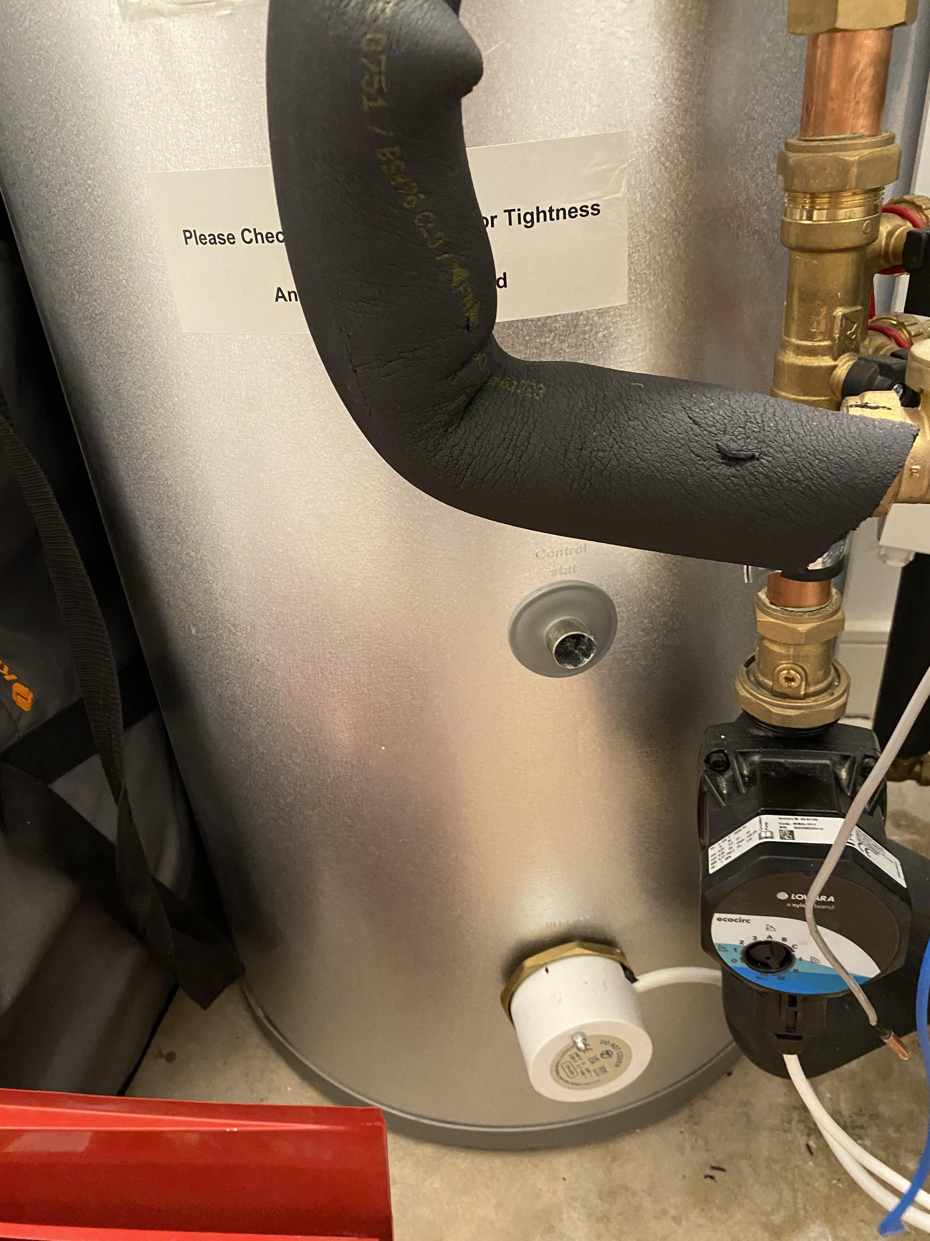

  5. Hi thank you for reply. Grey box is not even connected hence why I believe there is no temperature on the screen. Can you advise where this should be connected on FTC control board? Hanging cables are thermistors/sensors. These are THW 1,2,5. THW 5 has two coming out of control board. I believe these should be inserted into spaces on the tank. See picture, I am unsure if both in the same space or in two separated places. First pic is top of the tank and second is bottom. Do you know where these would go? Droops on ASHAP pic are rain so nothing to worry. I agree this is set up messy and was like this from day one. As it is not my house I keep asking but people dont take any notice so I try and sort it myself. thank you for your help and would appreciate more thoughts on above. Ps. Looking at above video with water setting, I have found out from comments that actually this type of Mitsubishi pump R32 only heats water to 48 degree after which immersion kicks in if you want it hotter. Apparently system calculate what would be quicker and most efficient way to get to temp above 48.

  7. Pump is on max speed. Does it also need to be changed on controller in installer settings? Its on speed 3 but can go up to 5

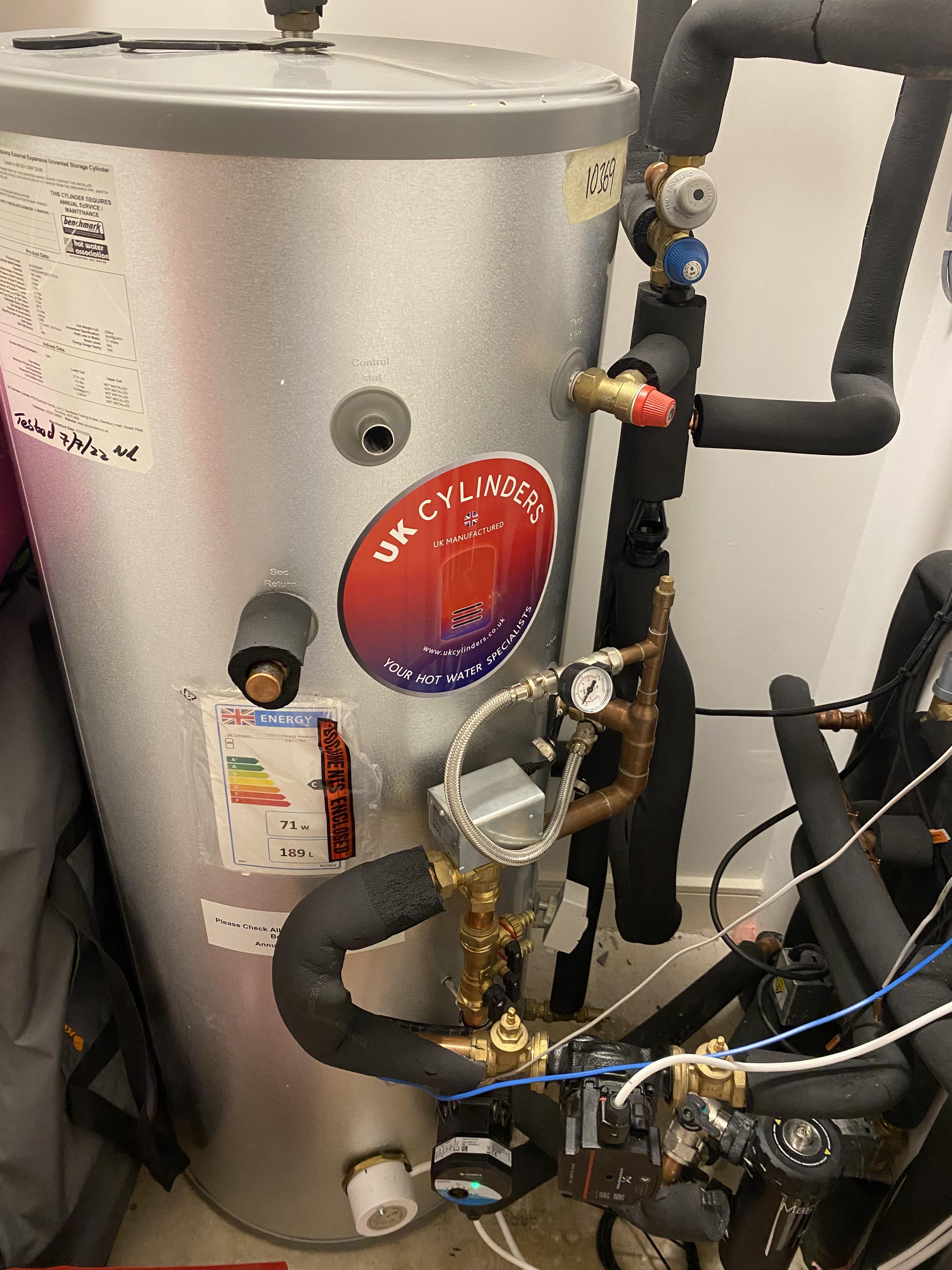

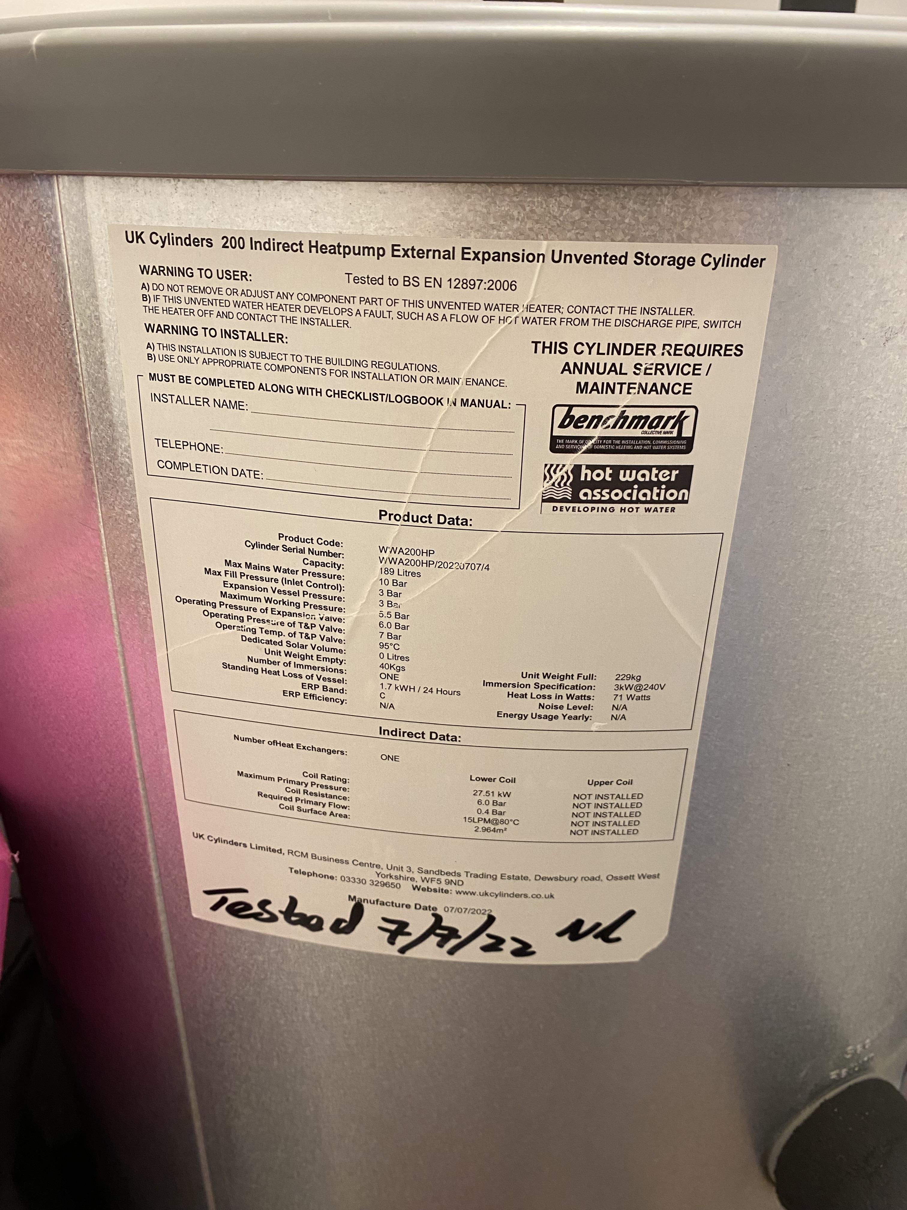

  8. This is my water cylinder. I have similar setting as on video. I wanted to ask about sensor he is talking about. Where does it need to be with size of my tank? Same as his at the bottom? As mine seems to be at the top. I will post picture of the pump in next post.

  10. Hi. Thanks for the reply. Main issue was wiring. Guy was able to sort things out to the point that heating has started working. Sensors THW 1,2 and 5 connected to the board but nowhere else. Not sure how system could know how hot water was in the tank. Temp is set in 55 as this was installer recommendation. I will decrease this to 50 and se what will happen.
  11. So Installer came and straight away stated issue with wiring. Further, temp sensor for tank was not even connected. Now I have hot water. I can see pump working, however immersion seem to be kicking in on the end of the cycle. Not sure if this is ok, water set to be heated to 55 degrees. Heating seems to be working ok at the moment.
