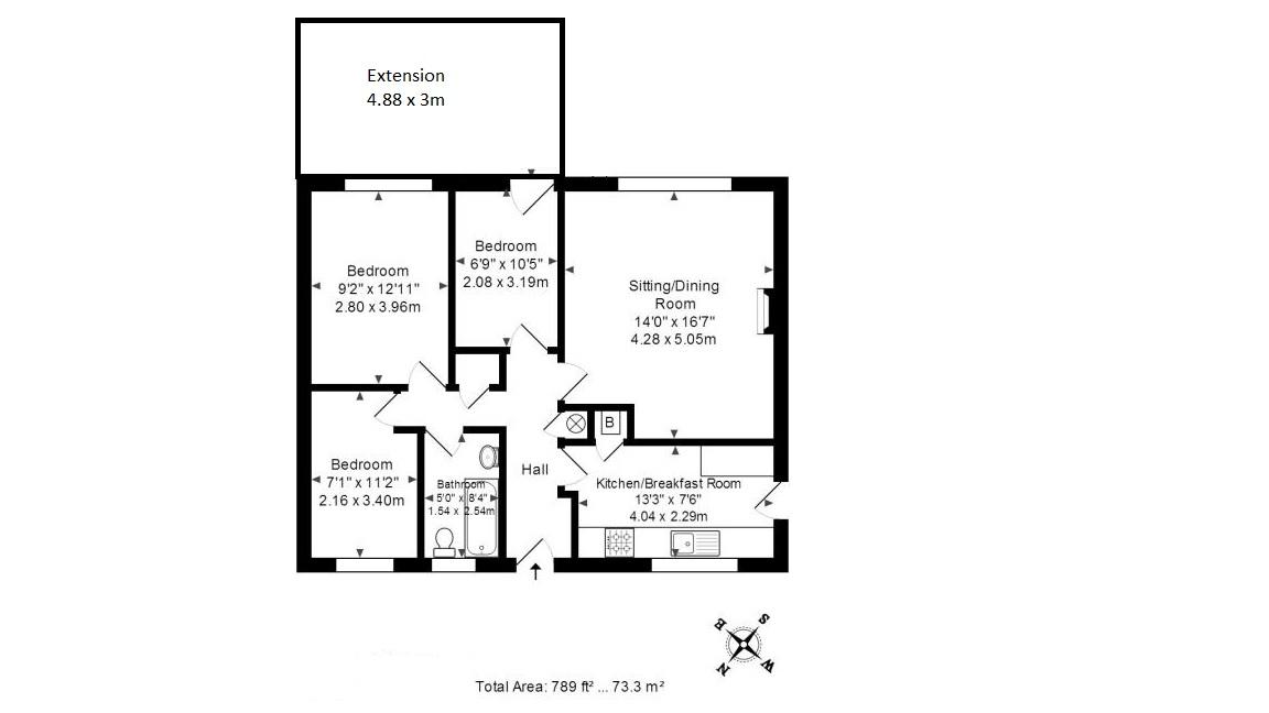

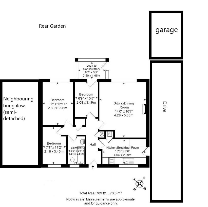

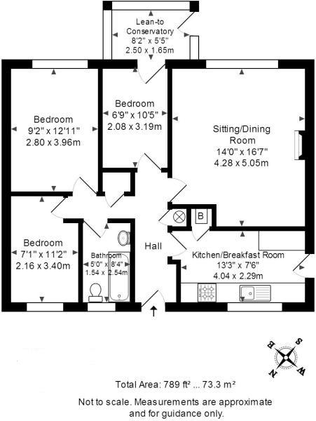

  1. Is the existing bungalow on the right and the garage the taller building to the rear, in your example?

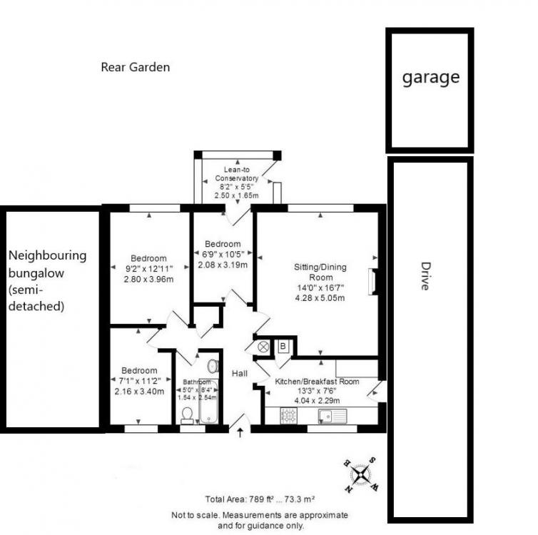

  5. Most of the bungalows around here are like that, I presume that the middle bedroom was originally a dining room? I have attached a plot layout. The drive is to the right of the property and to the right of our drive is next doors drive, so going out the side is not an option. It's a semi-detached bungalow, so going left isn't possible either. There's a fair sized front garden, but no precedent of planning being granted to the front of any local properties.
