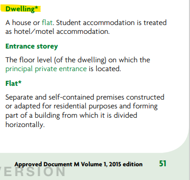

  5. Hello, I have planning permission to convert a detached outbuilding into a small 'ANNEX' (not a 'dwelling'). The annex is just for visiting relatives and will have one bedroom and a small ensuite bathroom. No kitchen and will not be self-contained in relation to the main house . I want to design the bathroom and wish to know the minimum size I can make it. Can anyone help with which 'Part M applies? Here are the options: Volume 1 - Dwellings Volume 2 - Buildings other than dwellings Or Part M doesn't apply? The regs give the following definition of a dwelling.... our annex is not a 'house or flat'.... Any ideas greatly received, thanks

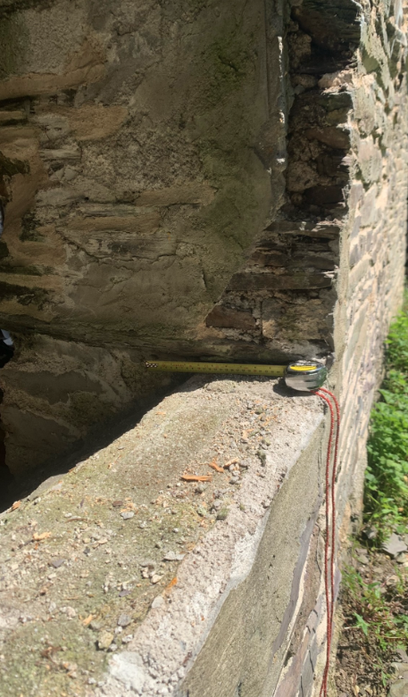

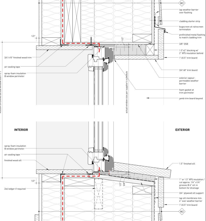

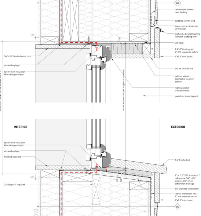

  6. Thanks jfb, re. existing cills, do you mean angled down immediately from the base of the window? Or fell off due to a lack of suitable fixings :)? Shall I mock up a drawing as the joiner describes and submit to BC? Ideally I want to reference some sort of best-practice guideline. But as mentioned can’t find anything for old barn conversions. I want to get it right first time as some of the other works have taken a bit of, er, discussion. (This has always been down to differences in heritage/modern techniques)
  7. Hello, I'm starting drawings for full plans approval to install windows on my small barn conversion. Walls are solid 'rubble masonry' with lime mortar (pic below). The original windows (Crittall type) were just nailed into masonry and mortared around. I can't seem to find a suitable detail for solid walls. The book I bought is all for modern construction with double skinned walls, cavity closers, air tightness tape etc. I've had wooden casement windows built and want to install the units onto large slate cills. The window joiner said just put a strip of DPC beneath the cill and secure using wedges, fasteners, expanding foam etc. The wall should be able to breathe (lime mortar) so I don't see what the DPC adds. Can anyone recommend a publication/source for windows in barn conversions? Basically like the attached drawing but for solid walls Thanks everyone

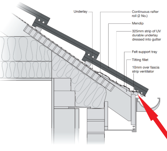

  8. but how does that work in the diagram, a continuous ‘tilting fillet’ would block the over fascia vent? I assumed with an over fascia vent you’d use individual wedges at each rafter and a felt support tray. (that’s what I was planning to do :)) Thanks everyone for the input
  9. Hello, I'm doing a small barn conversion and am working on the eaves detail. This blog post from LABC appears good, but when studied the diagram makes no sense (to me :)). Tilt fillet or proprietary eaves ventilator? | LABC The LABC blog states "The tiles shouldn’t be just rested on the fascia board as that is not what it is for, it’s bad practice, and makes replacement fascia work harder." However the diagram shows exactly this, all be it resting on a ventilator strip (secured to the fascia). All the examples I can see online (Tyvek technical manual, NHBC 7.2.19 etc) show the first course resting on the fascia. If a slate can't rest on the fascia then what is done? add a lower batten a few mm above the fascia? LABC are not responding and looks like someone else has asked this in the comments Thanks
