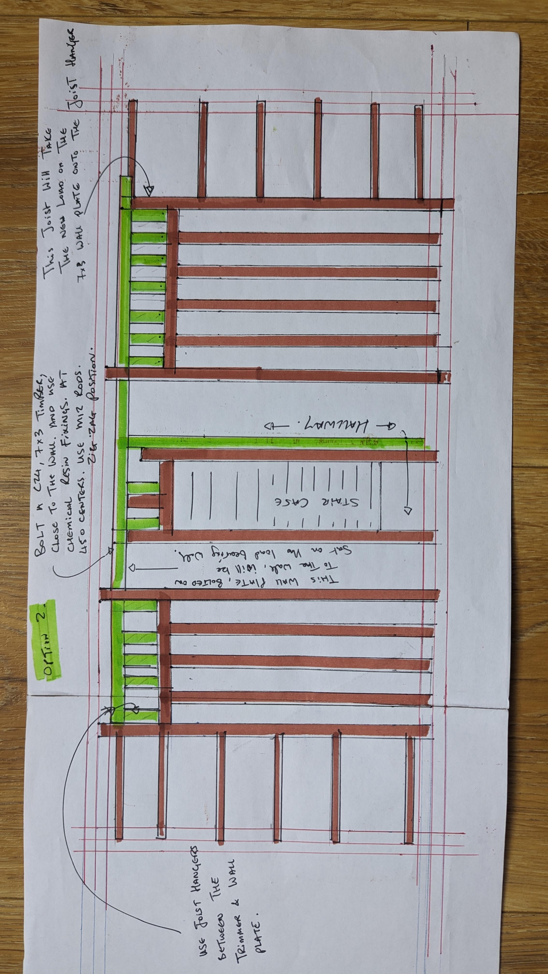

Hi all, hope everyone’s doing good! 👋 Just thought I’d give you all a quick update — I’ve doubled up the trimmer section by the stairs for extra reinforcement, and I’m planning to add a side joist hanger for extra support, highlight in green (fingers crossed I’ve done it right 😅). The red section in the pic will be triple-joisted (7x9 inch) — one end going into the wall and the other sitting on a joist hanger. Hopefully I’m on the right track here too 😳😂👍🏻 Stay safe everyone, and stay blessed! 🦸🏻♂️ -

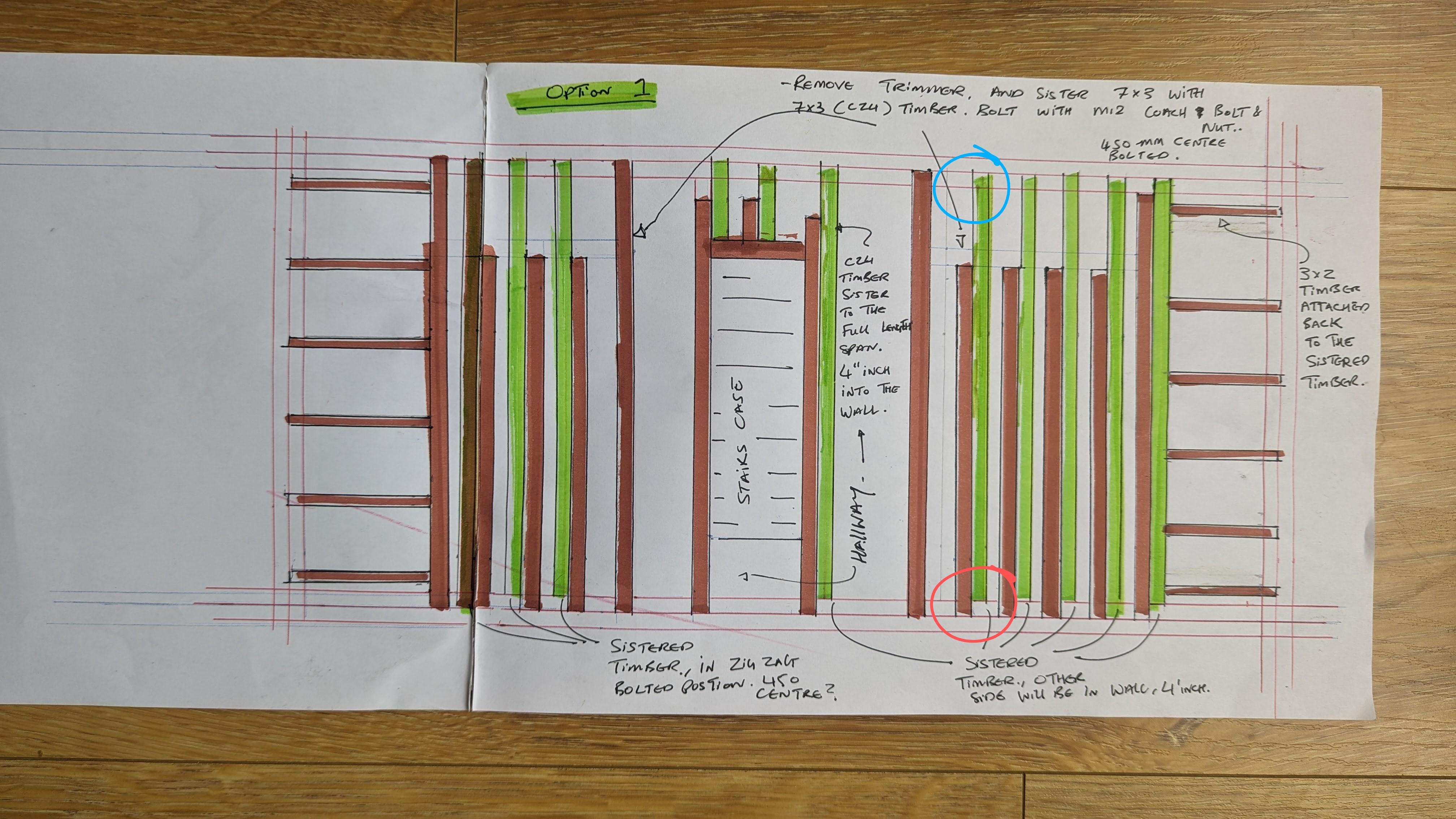

Hello, I really appreciate your response. I can obtain a new full-length timber and wall-to-wall on both sides while sistering. I can double it, and it's feasible since I started early today on the walls, having opened them up from my side. I've done this very carefully, and quite a bit of dust came out, haha.😁😅 So, in theory, I can sister the old joist to create a '6 x 7' inch joist (C24 graded) using nuts and M12 carriage bolts. However, the new joist will be an 8 x 3, trimmed down to a 7 x 3 timber to match the original 7 x 3 timber. Since the new timber is smaller than the original, it makes sense to match them closely for like for likeness. I hope this information is helpful. Thanks, Moeen. -

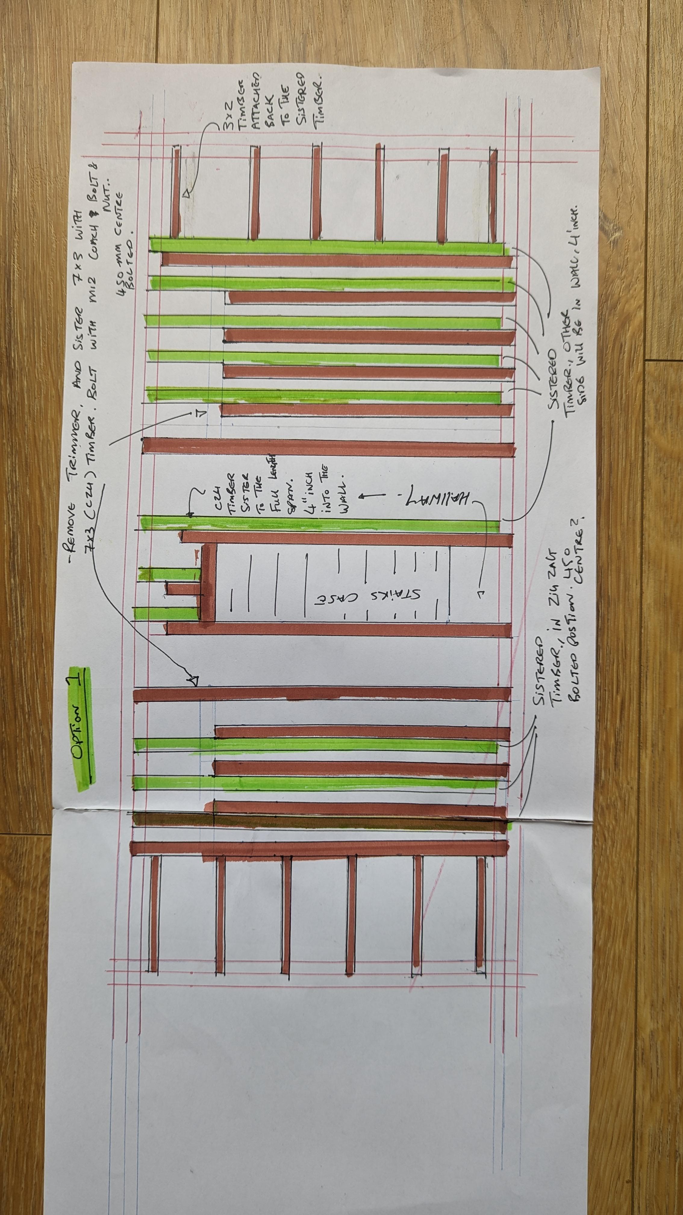

Hi temp, I had to rewrite this again, as I'm not computer literate. Lol The joist that is 7 inches from the wall is currently being supported by an acro prop, and there is no wall beneath it. On the other hand, the joist that is 9 inches from the wall is supported by a wall that is load-bearing, which extends all the way down to the cellar. I've attached a picture to clarify this. As you can see, the stack and chimney breast have been completely removed. The area where the joists are located was previously supported by a 'U' shaped chimney breast, which then split into two chimney breasts leading down to the cellar. In the picture, highlighted in red, you can see that the joist spans 5 meters in length—one end is anchored in the wall while the other end is not. The end that is not anchored is 7 inches away from the wall. Conversely, the joist highlighted in yellow is on a load-bearing wall, but it is 9 inches away from the wall. I apologize if I am going into too much detail; I just want to ensure everything is clear and straightforward. I hope this information is helpful, as I've done my best to explain it clearly. Thanks, Moeen. -

Hi George, Thanks for getting back to me. Hope you are well. I understand what you are saying. Could it be possible to remove the trimmer completely, whilst it's safely acro proped up to support the original 7*3 timbers. Put a full size 7*3 (c24) timber sistered next to the original 7*3 timber. So intentionally it becomes a one sized joist. I know the 7*3 (c24) timber will be in oneside in the wall whilst the original 7*3 timber will be in the other side of wall. I know, I won't be able to put a full size 7*3 (c24) timber in wall to wall because I will to start to hit a both parties wall. And I know that not a good idea..... ( I have uploaded a 'option 1 floor layout plan' highlighted in red and blue, to show the new timber goes into the wall, whilst the original timber goes into the other side of the wall.) I'm sorry if I'm asking a complicated question. I know this is over kill, but I want to know for the sake of peace and mind, will it be structurally safely and sound? Thanks, Moz.🧗💫 -

Hi George. Thanks for the reply. The floor is completely solid. The question is what if I was to sister the joists and remove the trimmer completely. As seen on the pictures on option 1, floor plan. -

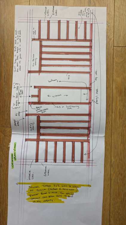

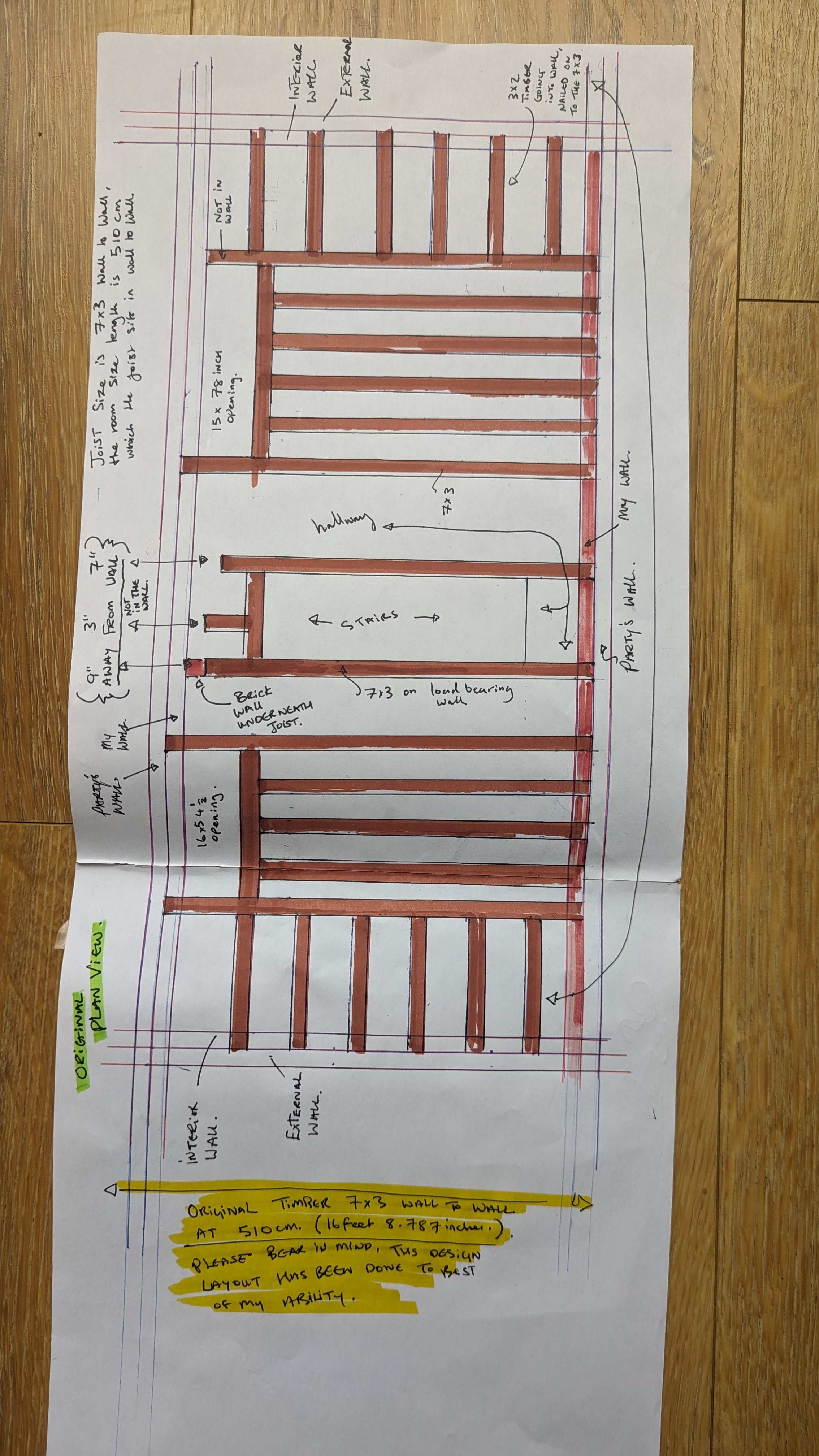

Hi all. I've been currently renovating my house. Anyway, I have now removed the chimney breast walls from top to bottom to gain more room size from the attic, bedrooms to the living rooms and kitchen. I am now left in the bedrooms with exposed joists, which are 7x3 timbers and 5 metres long span. The joist runs in a trimmer fashion and then they are connected to the joists which are running wall to wall. However, one of joists running wall to wall is not directly in the wall. This can be seen on the pictures uploaded and drawn floor plan as this help for a better understanding. However my question is, I want to cover up the gap, but what is the proper way of securing it up and structurally having it ''passed'' off. I haven't got the building inspector involved in this, but I want to do the job securely right and mostly for the sake of peace of mind. I have drawn 3 plans up. 1 plan is the original floor plan and the 2 are the options are which to consider on what direction I need to go. I was kind of hoping to avoid the idea of using joist hangers as I am not really keen on them. Unless someone can correct me on them if they are any good. I have an idea on how to cover up the joists, but I need everyone's input. I hope this information is clear. If you need more pictures please let me know. Thanks, Mozzer.
The chimney is on its own. It is not connected to the next door neighbor's what do ever. I have uploaded a picture of the removed chimney wall from the top.
Hi, as you can see on the 'original floor plan' picture. The floor is held up on a trimmer, while the trimmer is connected to the other timbers which are connected in wall to wall.
Hi all. I'm new here, so please go easy on me. I've been currently renovating my house and I'm a bit of a DIYist so to say. Anyway, I have now removed the chimney breast walls from top to bottom to gain more room size from the attic, bedrooms to the living rooms and kitchen. I am now left in the bedrooms with exposed joists, which are 7x3 timbers and 5 metres long span. The joist runs in a trimmer fashion and then they are connected to the joists which are running wall to wall. However, one of joists running wall to wall is not directly in the wall. This can be seen on the pictures uploaded and drawn floor plan as this help for a better understanding. However my question is, I want to cover up the gap, but what is the proper way of securing it up and structurally having it ''passed'' off. I haven't got the building inspector involved in this, but I want to do the job securely right and mostly for the sake of peace of mind. I have drawn 3 plans up. 1 plan is the original floor plan and the 2 are the options are which to consider on what direction I need to go. I was kind of hoping to avoid the idea of using joist hangers as I am not really keen on them. Unless someone can correct me on them if they are any good. I have an idea on how to cover up the joists, but I need everyone's input. I hope this information is clear. If you need more pictures please let me know. Thanks, Mozzer.
