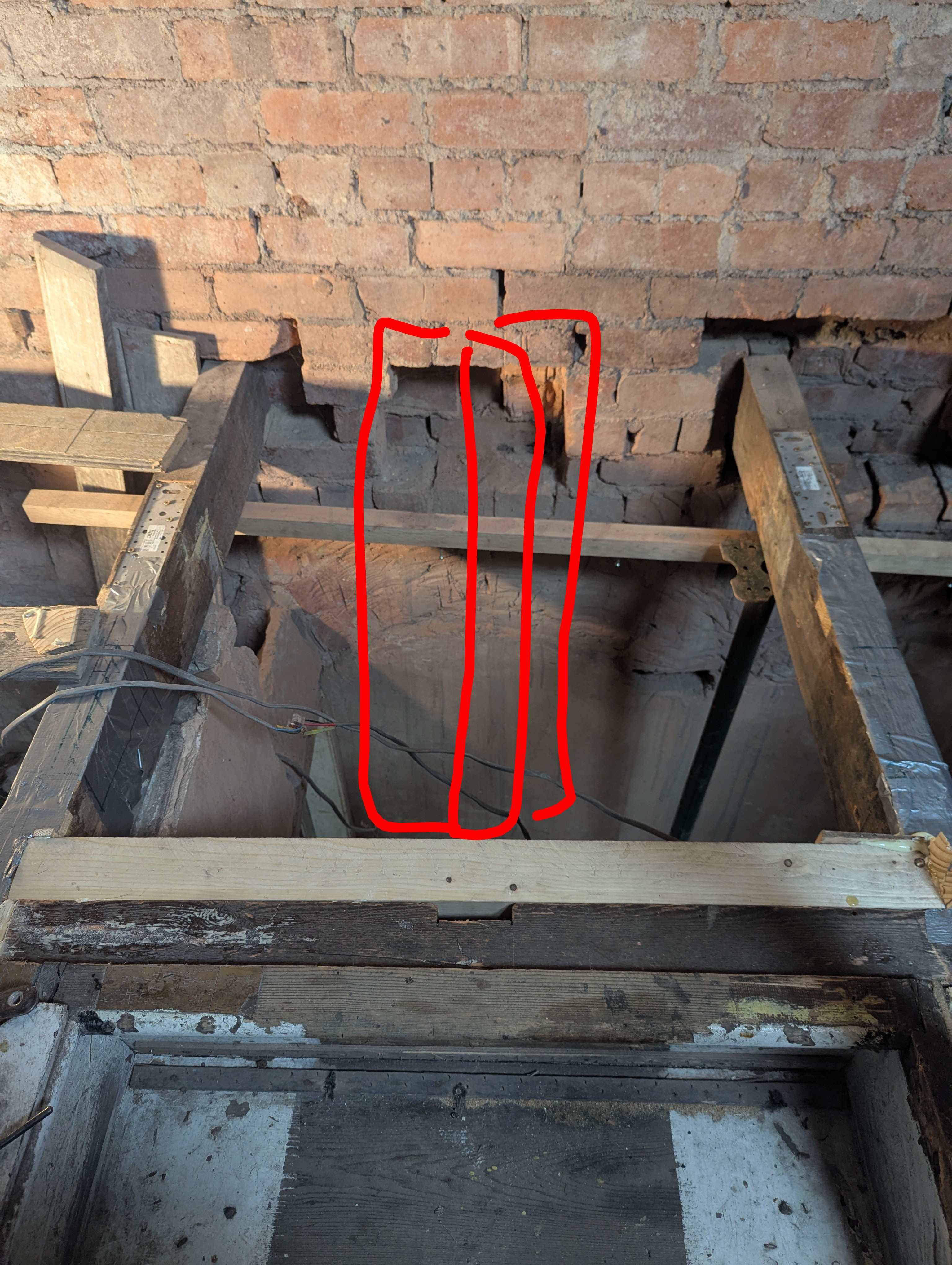

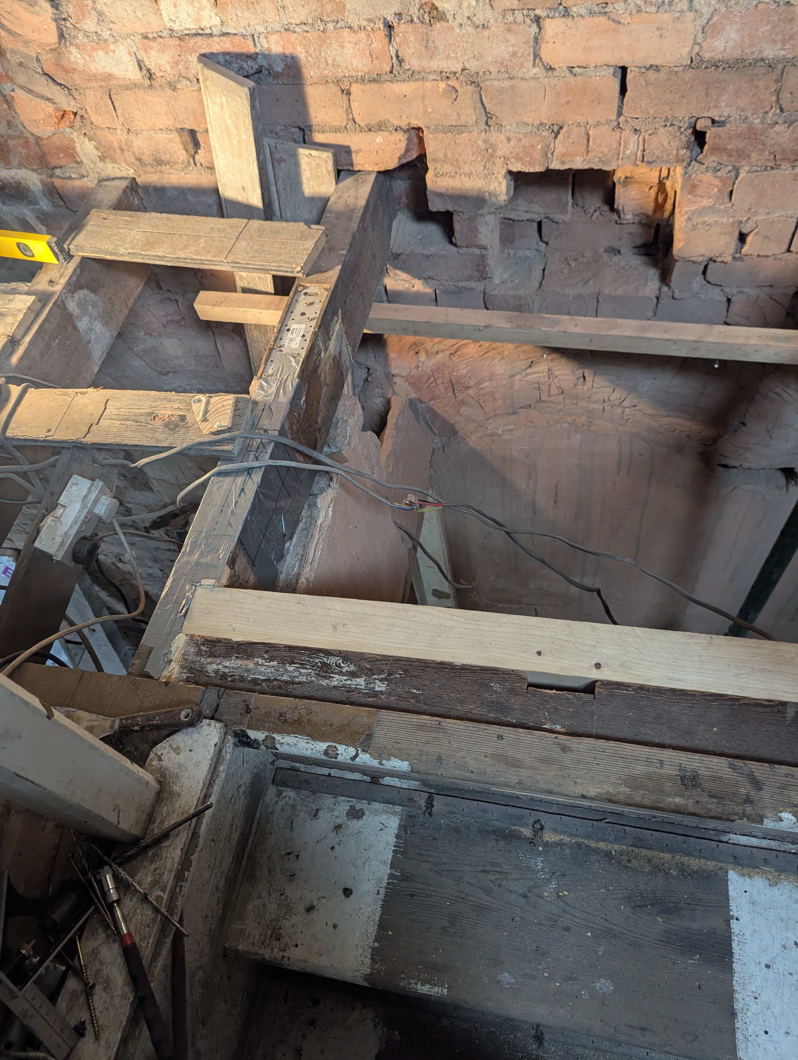

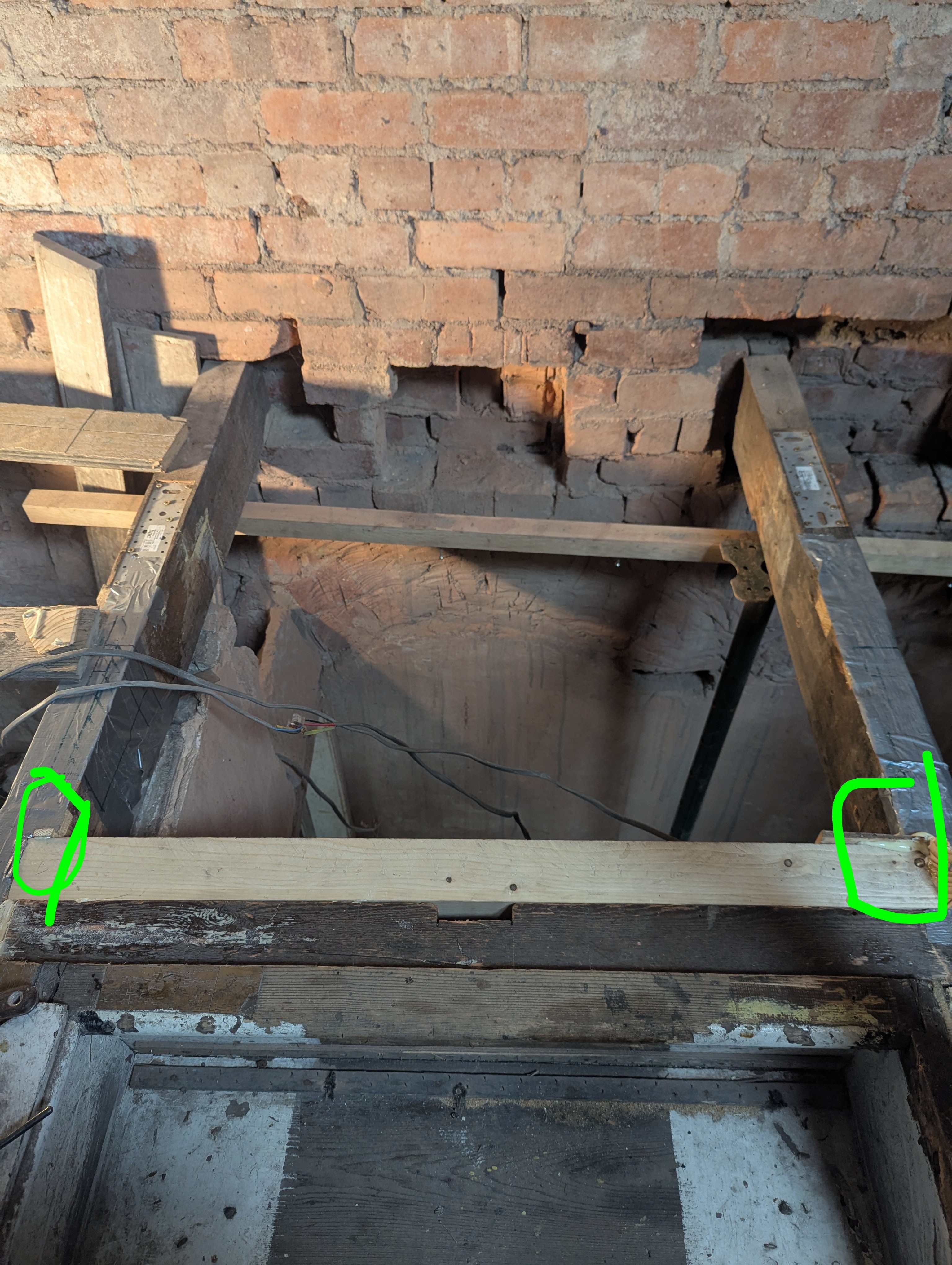

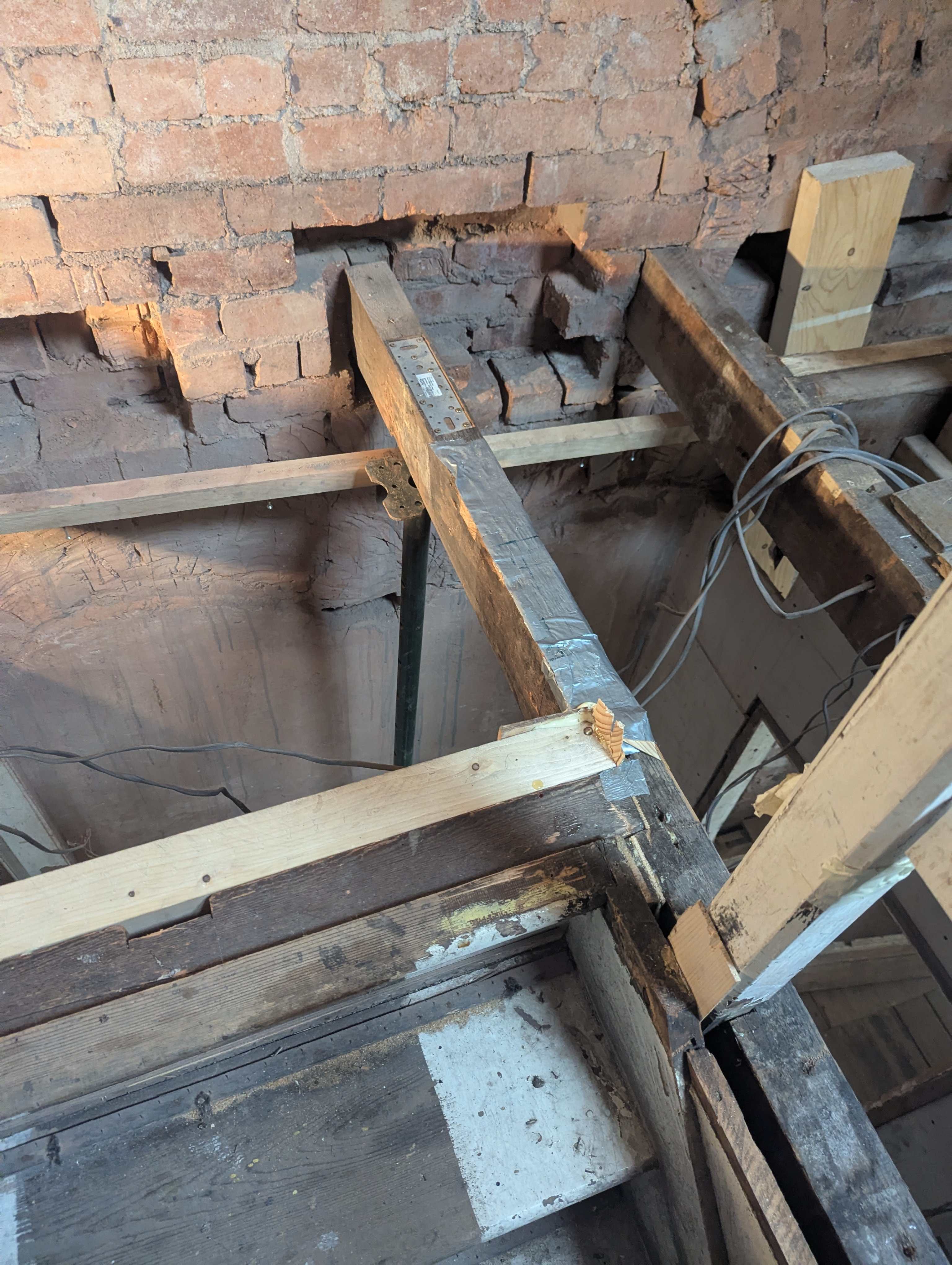

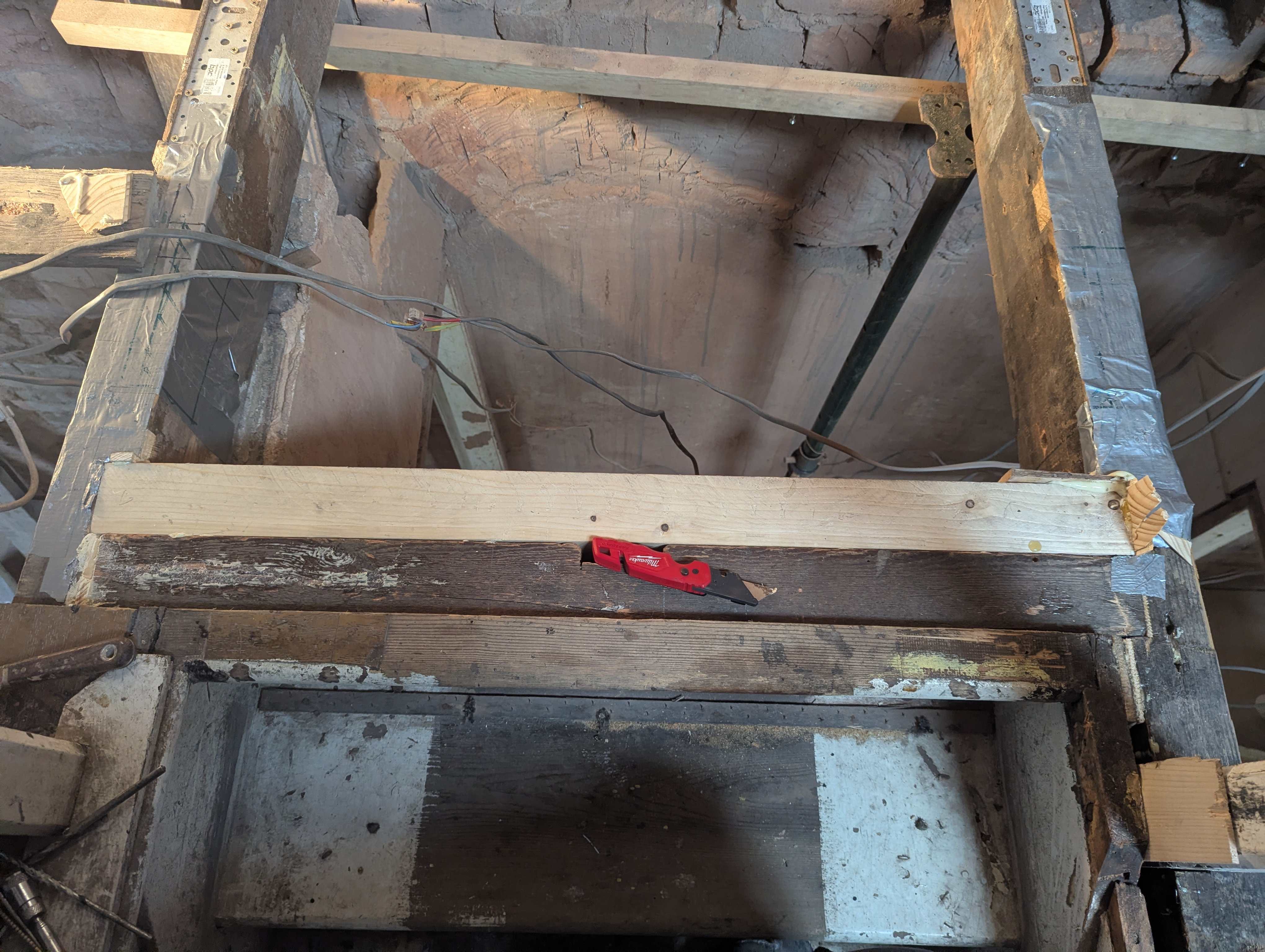

Hi all, hope everyone’s doing good! 👋 Just thought I’d give you all a quick update — I’ve doubled up the trimmer section by the stairs for extra reinforcement, and I’m planning to add a side joist hanger for extra support, highlight in green (fingers crossed I’ve done it right 😅). The red section in the pic will be triple-joisted (7x9 inch) — one end going into the wall and the other sitting on a joist hanger. Hopefully I’m on the right track here too 😳😂👍🏻 Stay safe everyone, and stay blessed! 🦸🏻♂️ -

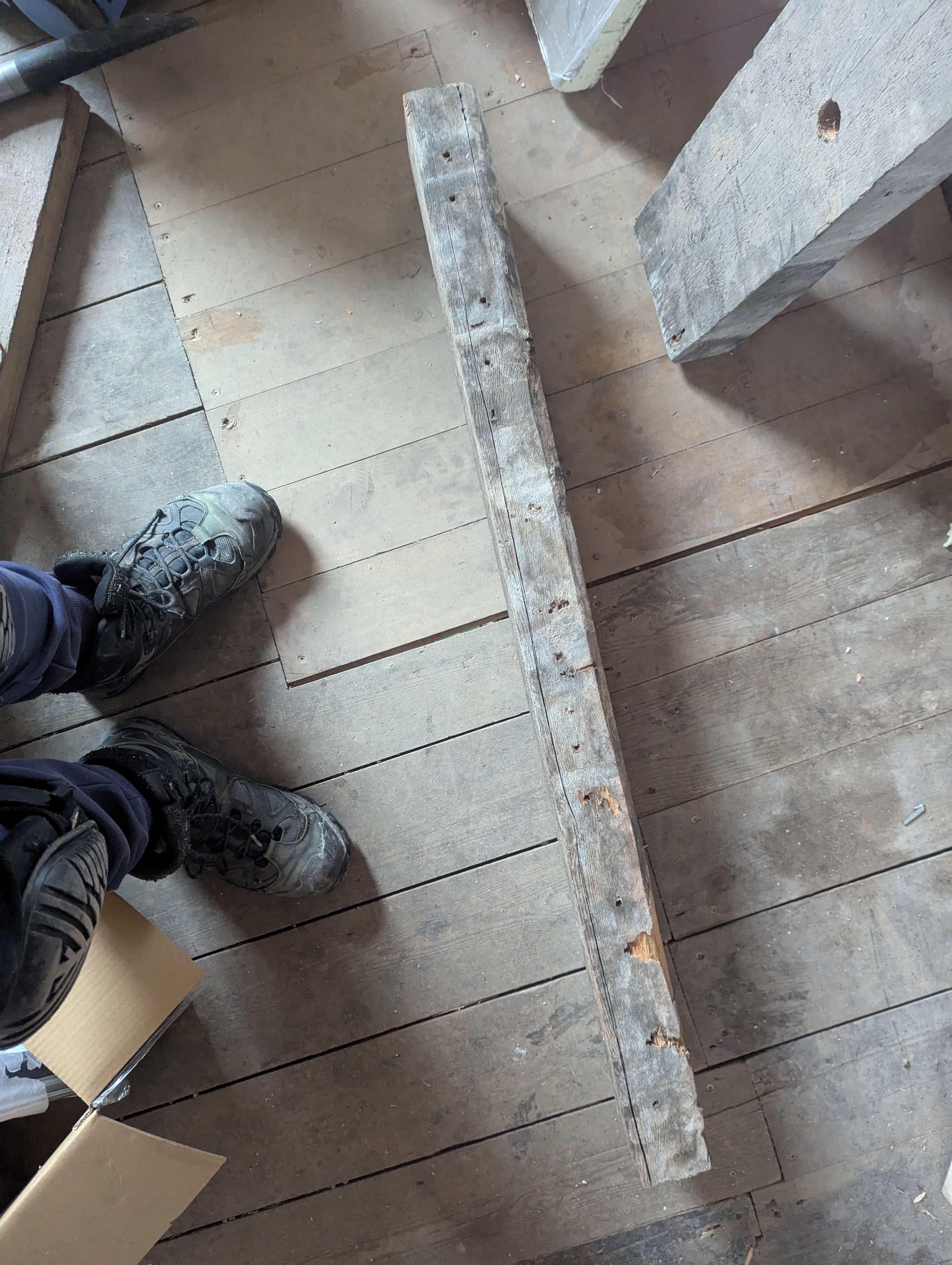

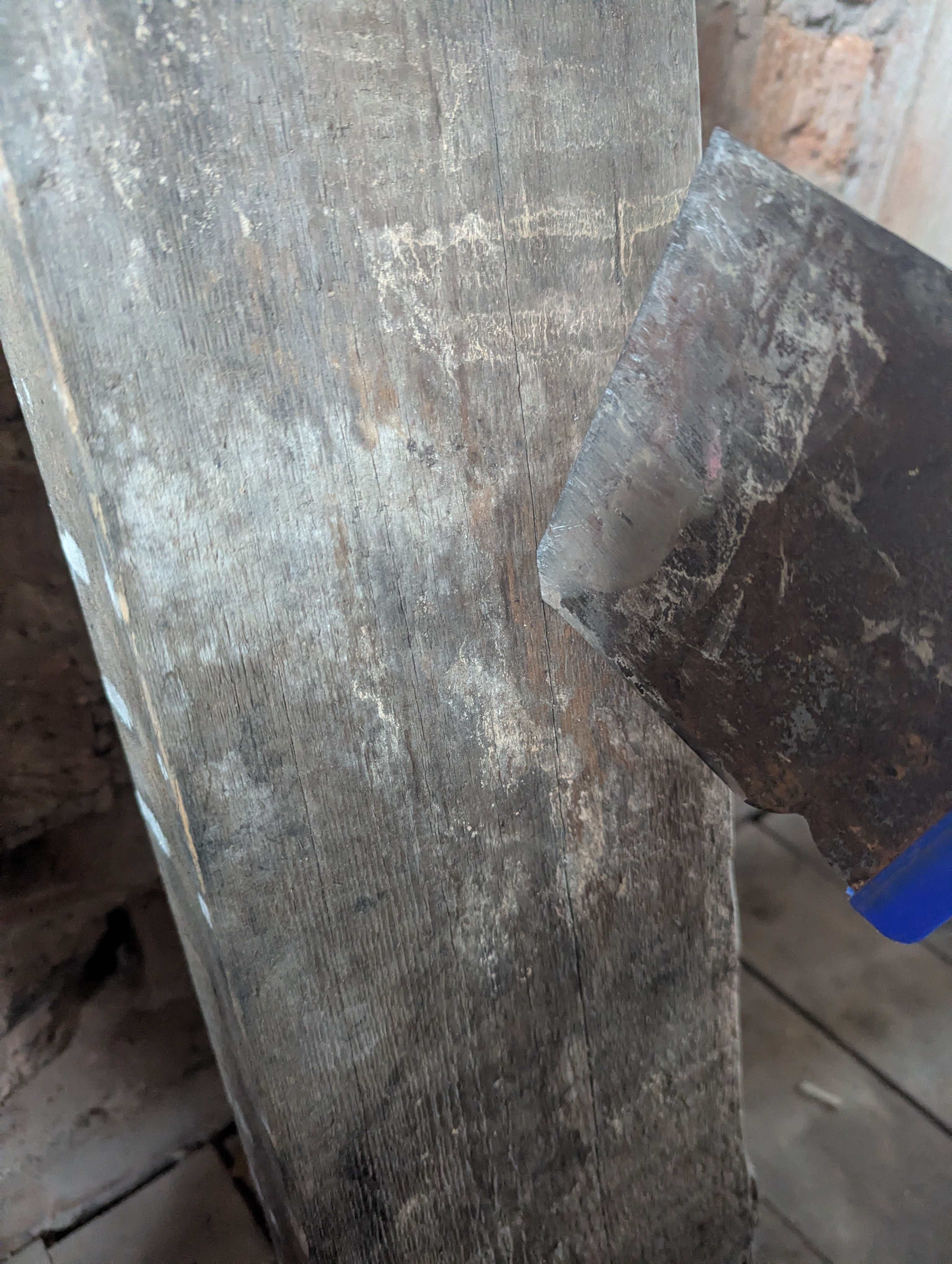

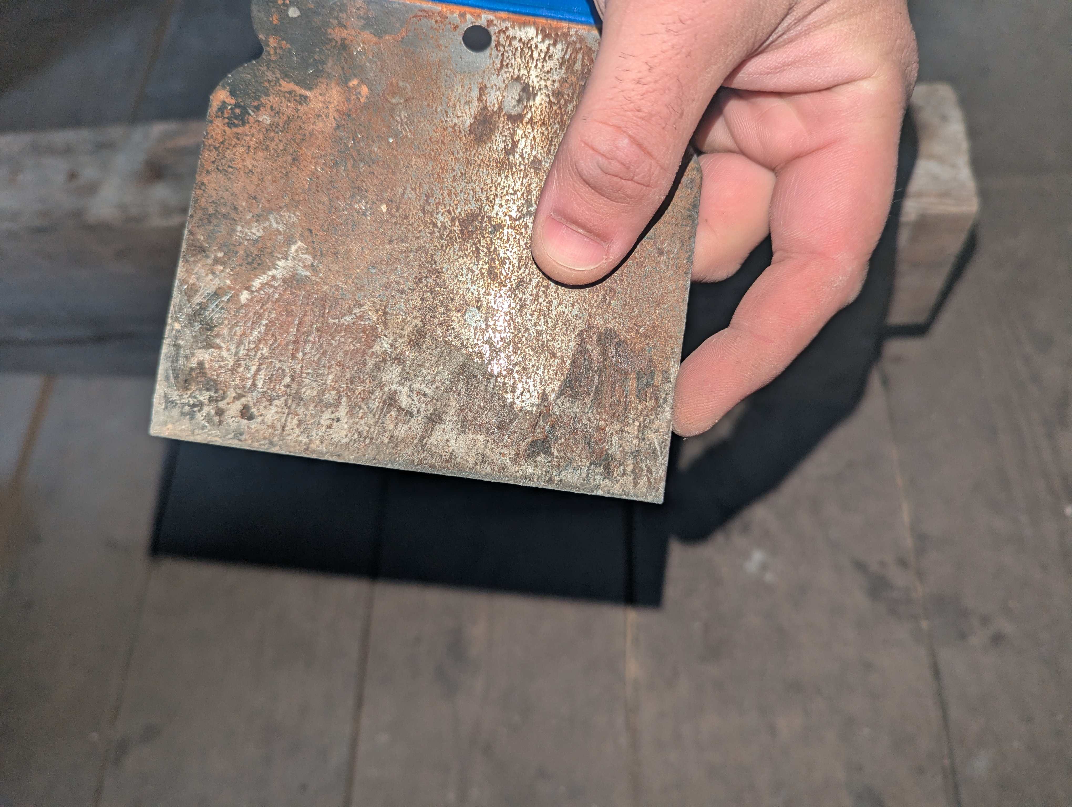

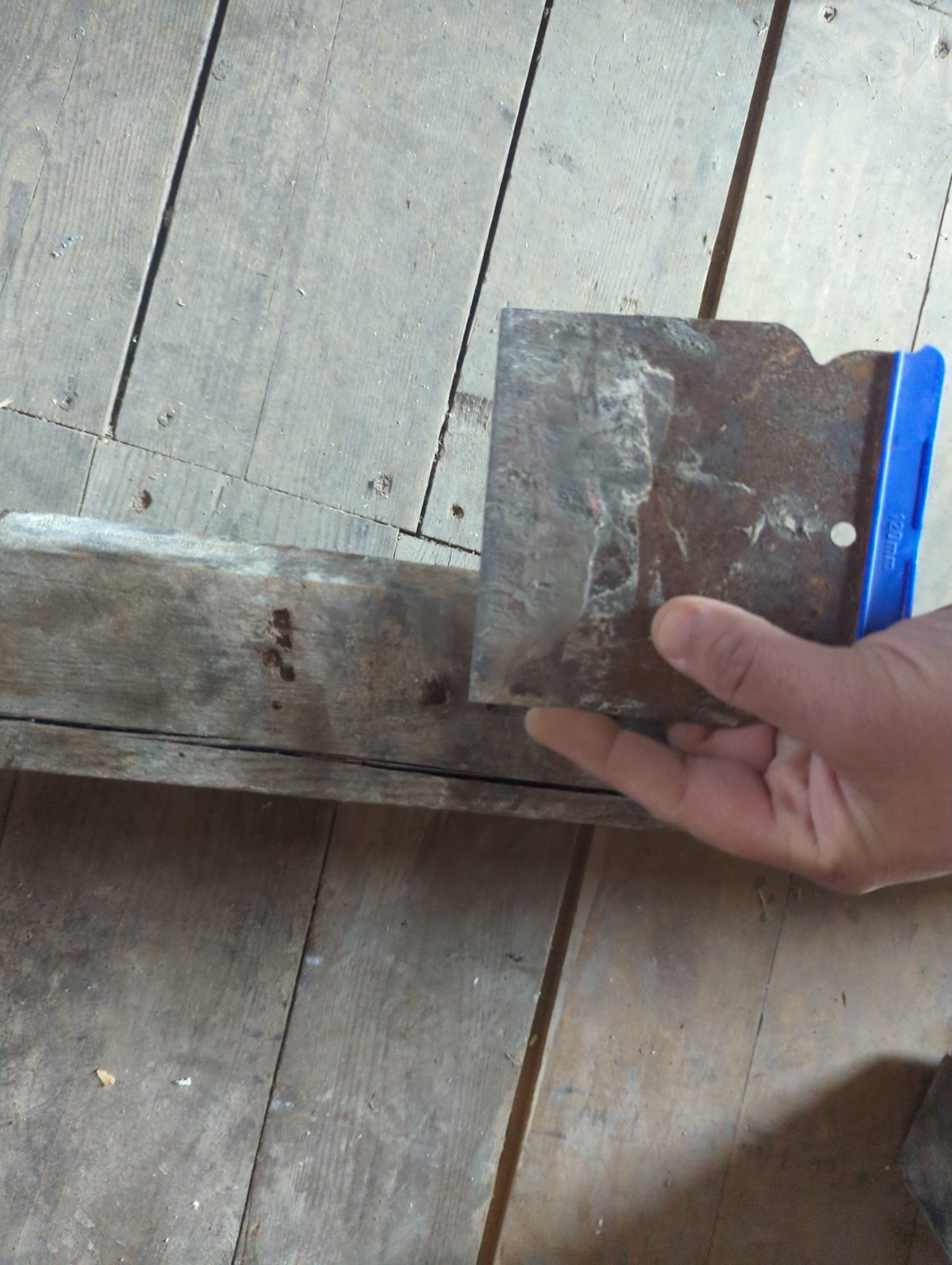

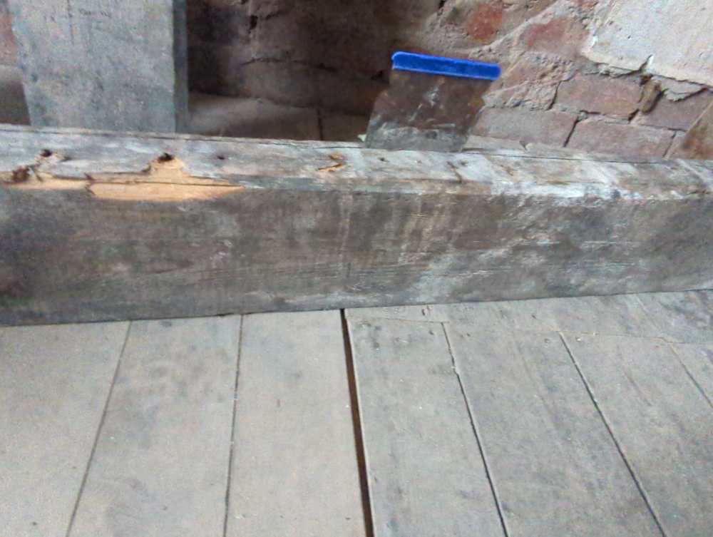

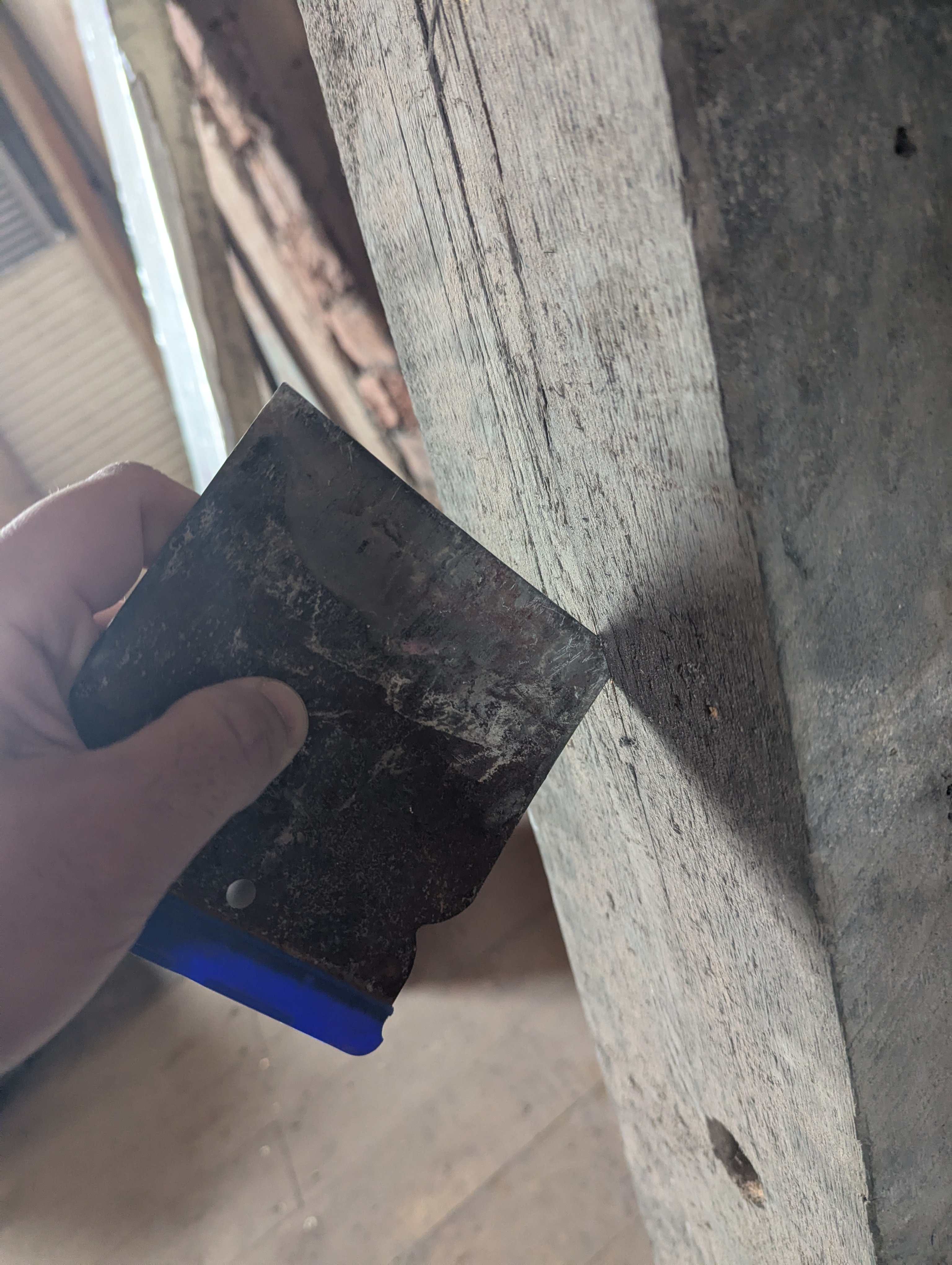

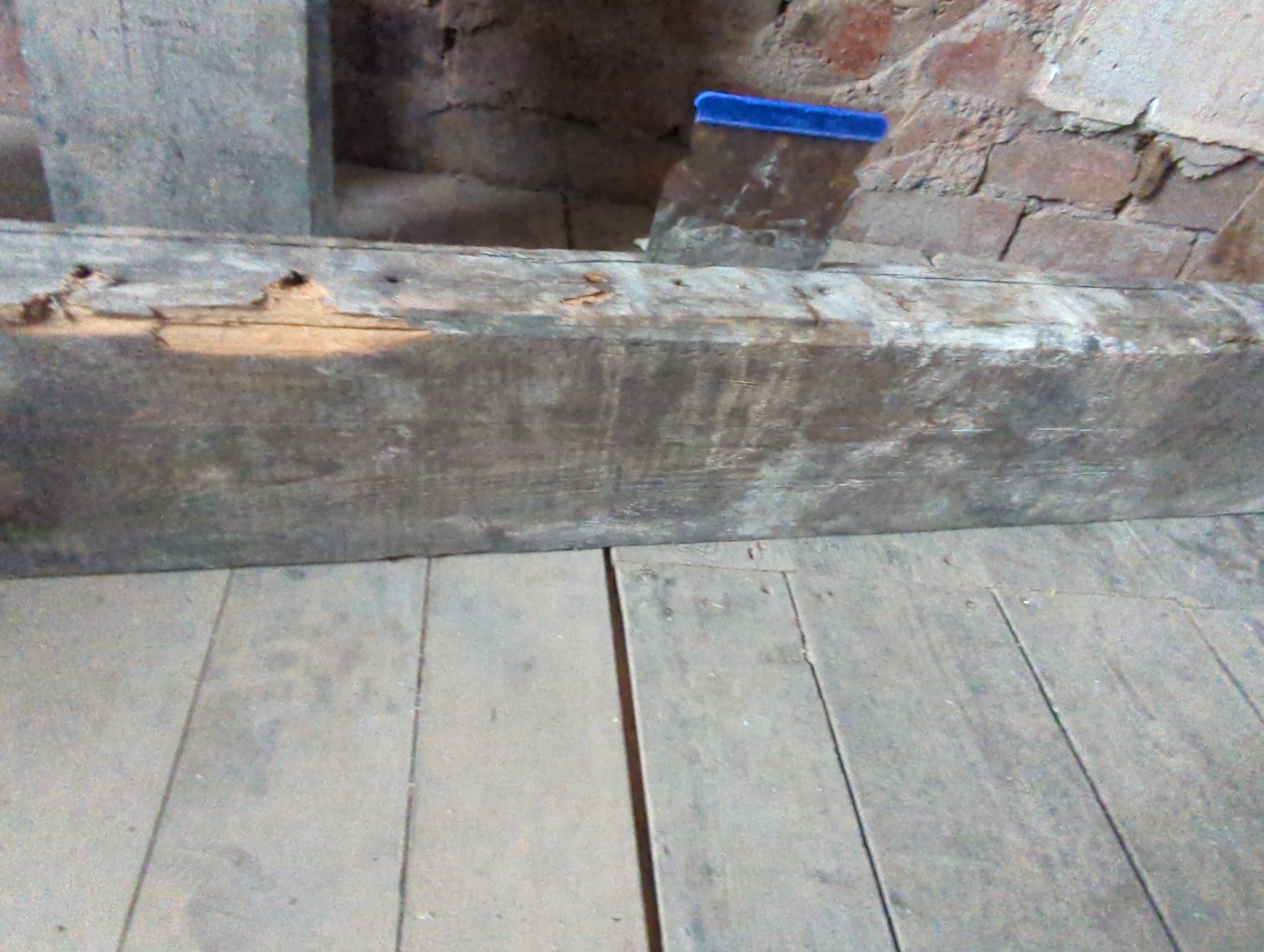

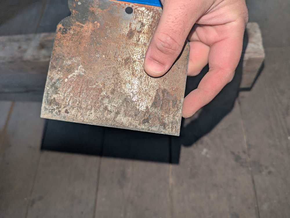

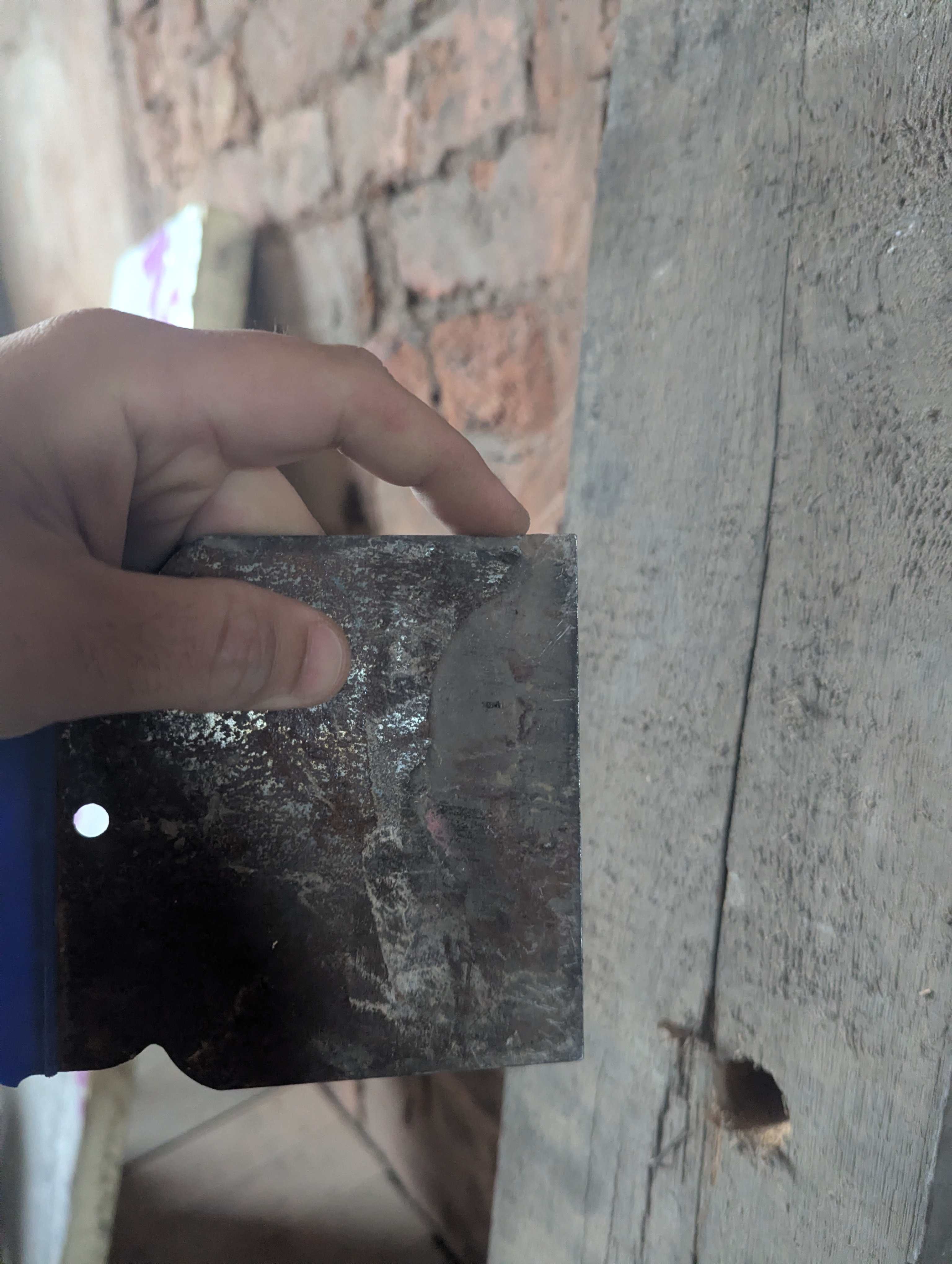

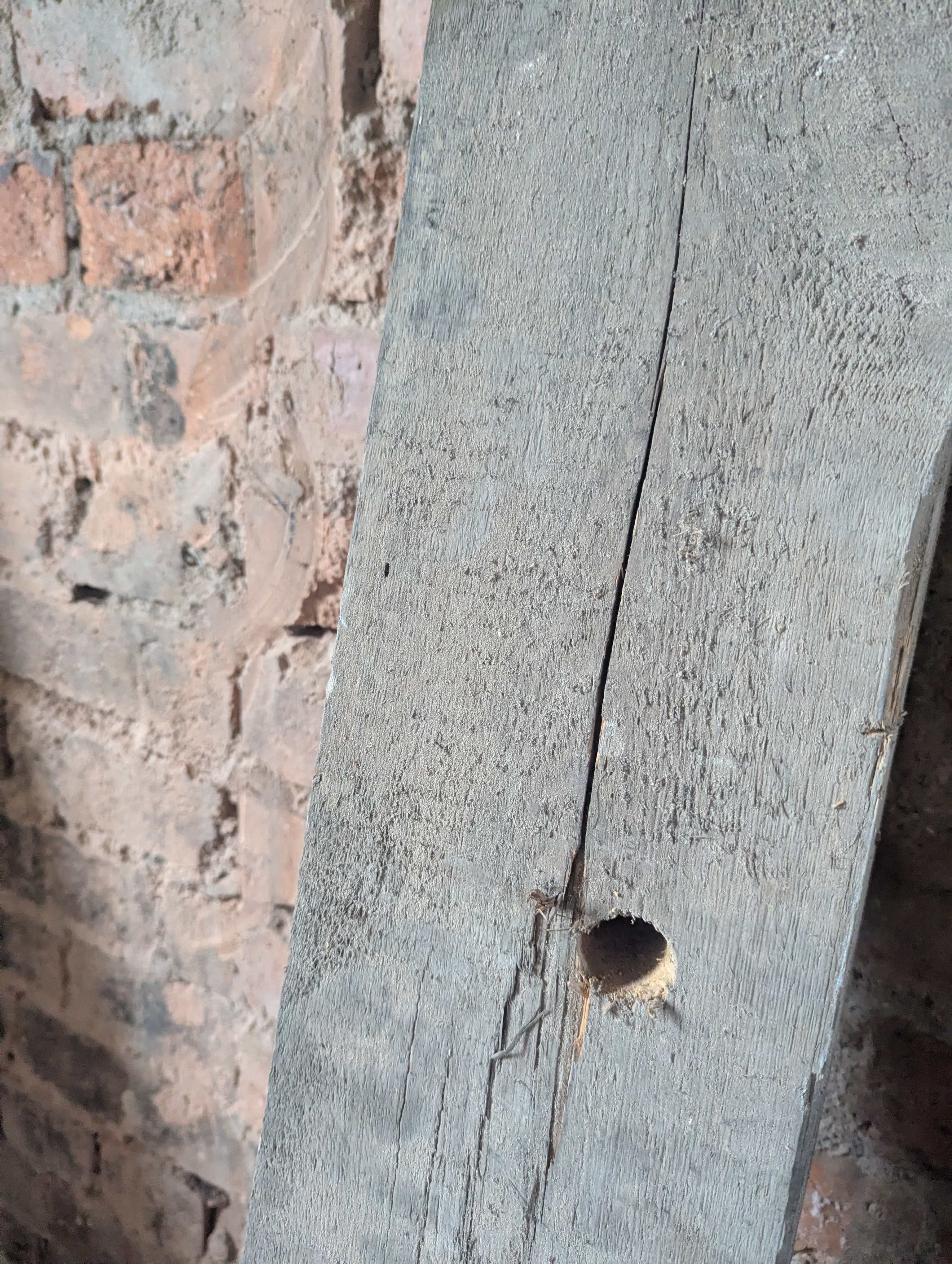

Hi all, I have taken pictures of the split and cracks of 2 joist timbers (7x3), and I have used a scraper as depth on how deep it is . One of the joists varies to 5 mm to 10mm in split and cracks. The other joist varies to 5 mm to 20mm in split and cracks. What do you guys think, can I use it for a joist section? Thanks you. -

Hi all, I can send some photos tomorrow. The timbers have around a 1-inch (ish) split along the side — it varies a bit in and out — but these joists have held up for over 100 years without any real issues. My main concern is whether it’s still safe to reuse them for structural purposes as floor joists. What do you guys think? Thanks, Moe -

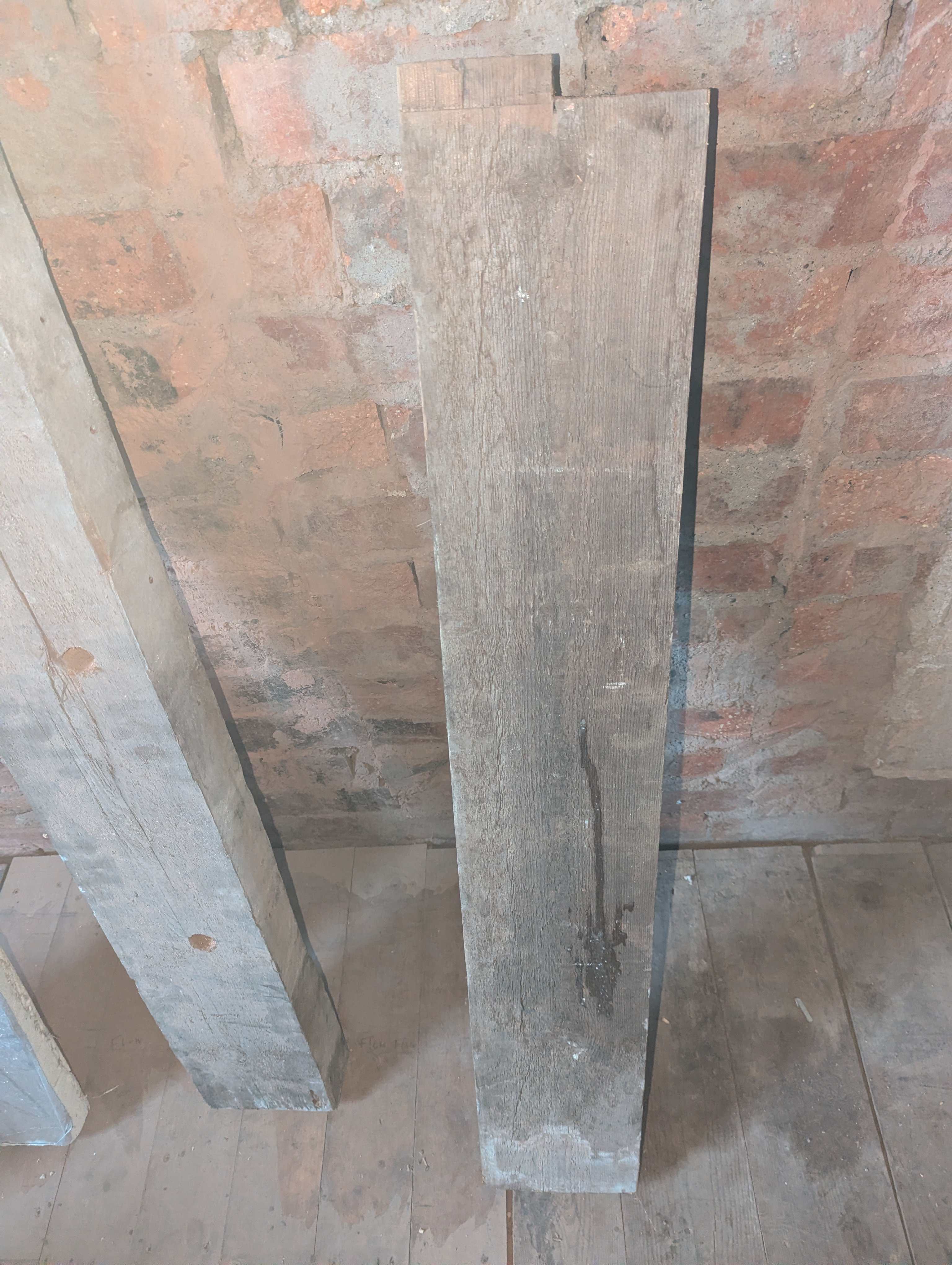

Hi all, Sorry I’ve been a bit quiet lately — been juggling the property work and a full-time job (send help 😅). I’ll be uploading some pics soon, just haven’t had a spare minute to breathe yet! Quick question though — can I reuse the old brown joists? They’ve got a few cracks and splits inside and out, and I’m not sure if they’re still solid or simply put new ones in. What do you guys think? Cheers, Moe. -
