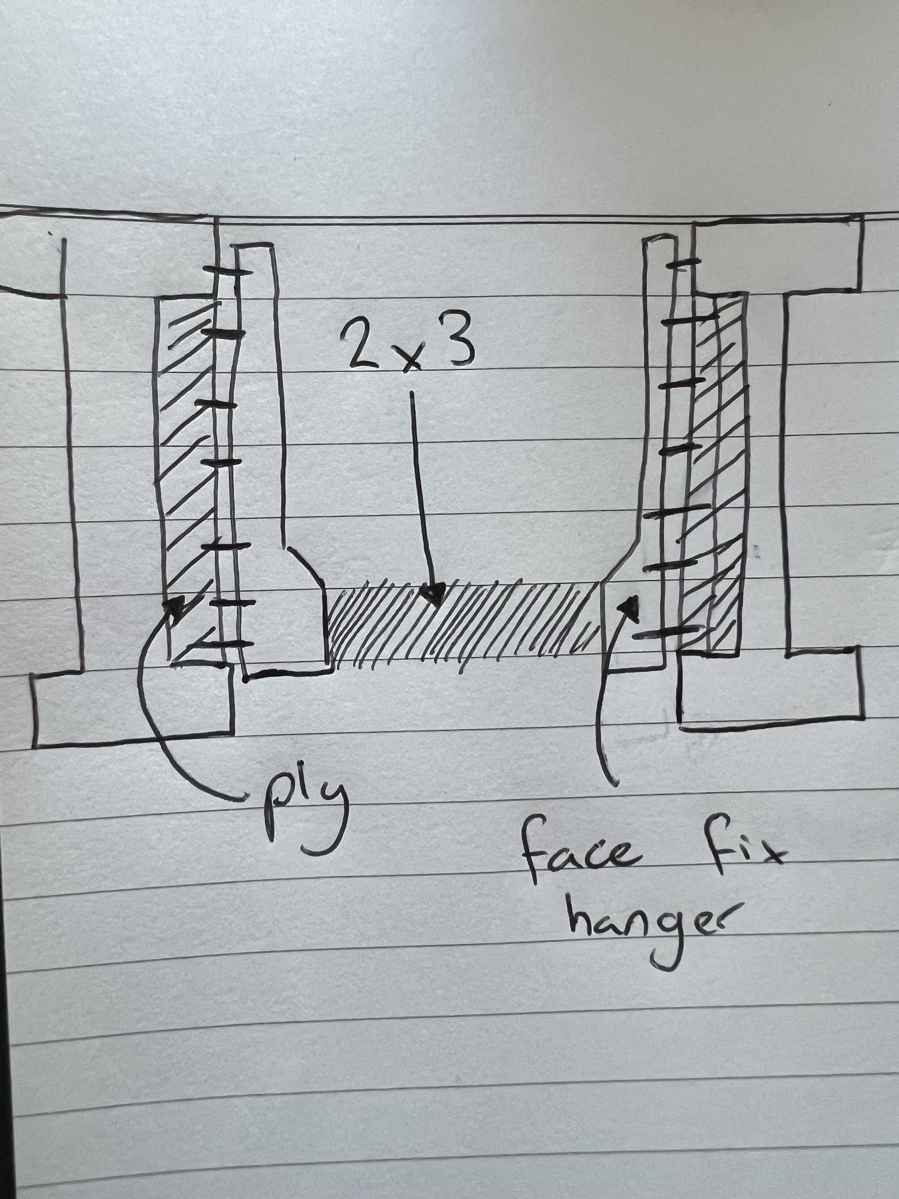

  2. Cheers for the diagram, I agree I probably would get away with screwing into the bottom flange but I’m reluctant to do so just on the basis that it’s strongly advised against… ultimately damaging/splitting/cracking a joist is a huge problem I don’t want to encounter. I like both those ideas, keeps it relatively simple. Another approach I was considering was screwing some plywood to the inside of the OSB and then using a face fix joist hanger to run a 2x3 joist between:

  5. Sure that’s doable, but a dropped ceiling made of wooden studs, a 30kg extractor fan & plasterboard weighs a lot more than just ordinary plasterboard. I’ve heard about padding the OSB web with some plywoood & screwing through that with a joist hanger to hold a perpendicular joist… anyone any experience with doing that?
  6. Hi everyone! I’m wanting to build a dropped ceiling out of a wooden frame and attach to existing ceiling joists. However the ceiling joists are engineered I joists (with OSB web) and I’m struggling to identify the best way to hang the dropped ceiling from these. I understand attaching directly to the bottom flange is a big NO when it comes to I joists, does anyone have any suggestions of how to hang from these joists? Cheers
