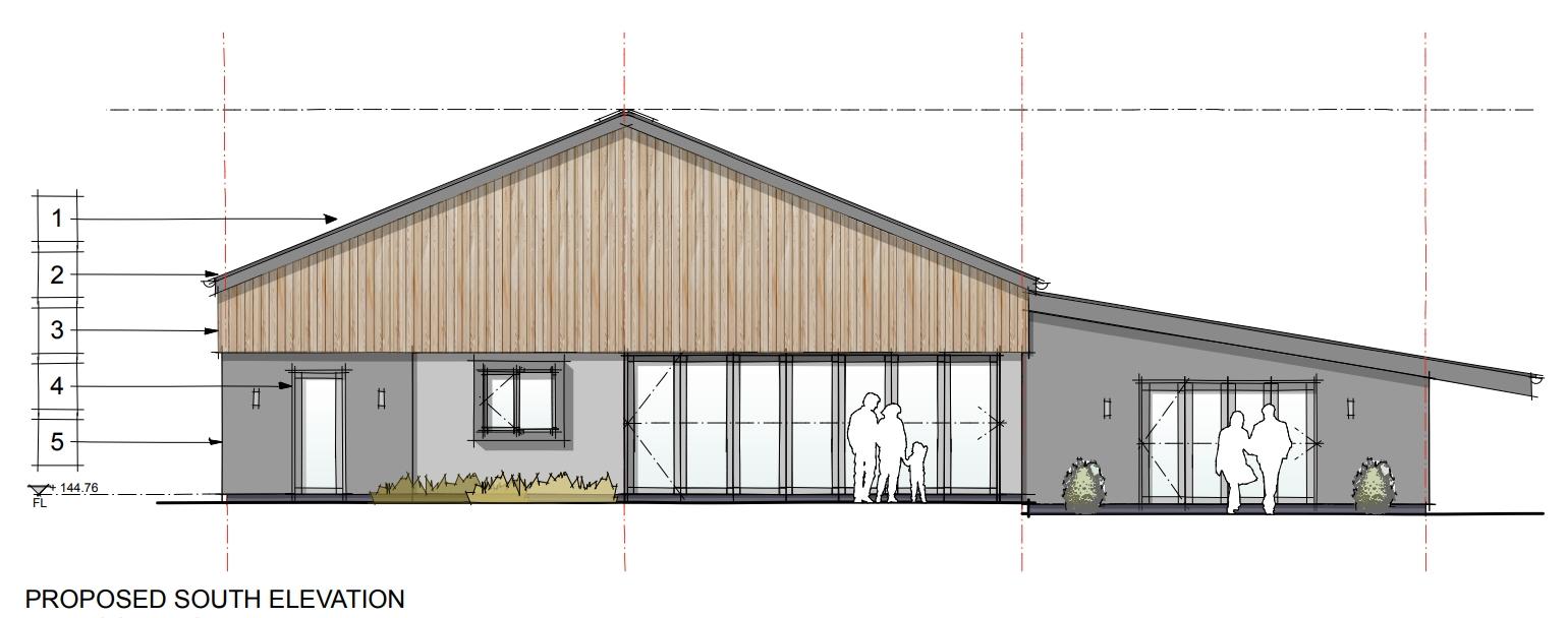

Hi, we're planning a large barn conversion and I'd like some neutral advice on the energy system and heating. It's about 400sqm and going through the calcs on aspect, location etc, I think I need somewhere between 30-40kW to cover all energy needed throughout the year if we want to get it to zero ongoing cost. This would mean making much more than we needed, and assumes selling electricity back to eg Octopus for 15p and buying it for 30p when needed. But, the idea of heating a barn in winter with electric radiators.. isn't this mad?! The sums add up but the common sense rings alarm bells. I like the simplicity, low installation costs and controllability of electric radiators, and I don't want to have to have solid flooring for heat pumps to work effectively. An estimate for a 30kW system here is around £32k. It sounds like an air source heat pump added to this would double the price. It's currently single phase. It may be possible to connect up a nearby 3-phase supply. Advice please! Has this sort of scale PV been done for a single house? Many thanks, Dan Ref: This is the website I used to calc PV needed for X kWh: https://re.jrc.ec.europa.eu/pvg_tools/en/

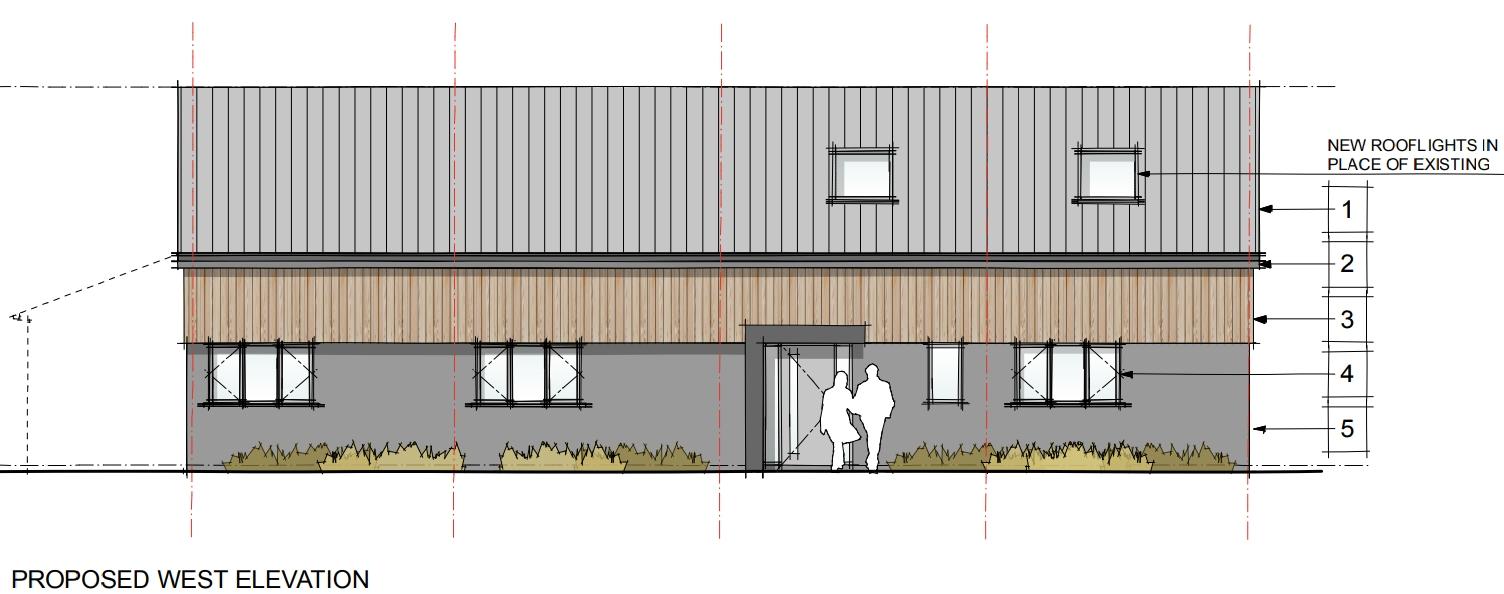

Hi everyone, we're hoping to convert a large (400sqm) barn into a house, with most of the work done by an experienced builder but I'll be helping where I can (experienced DIYer but need pointing in the right direction). The attached is the kind of thing we're aiming for.
