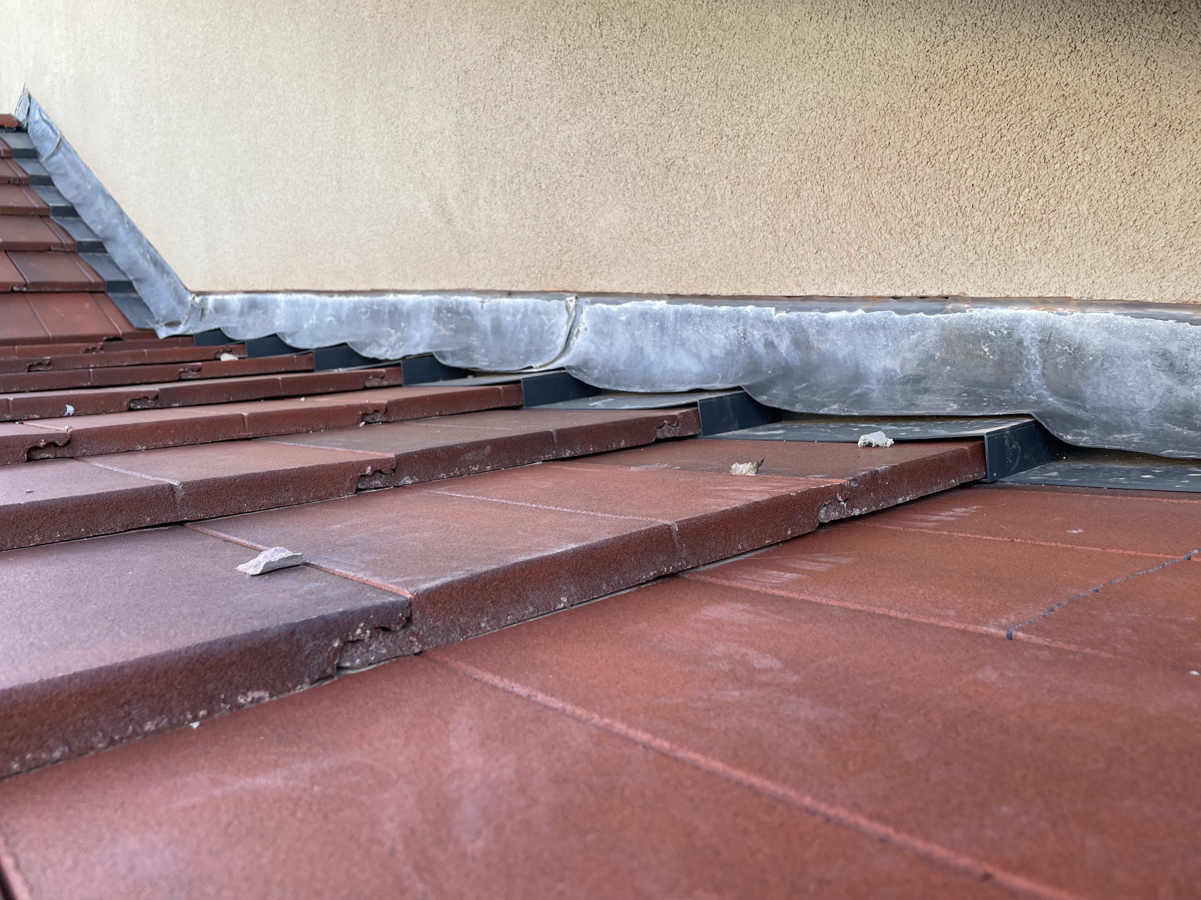

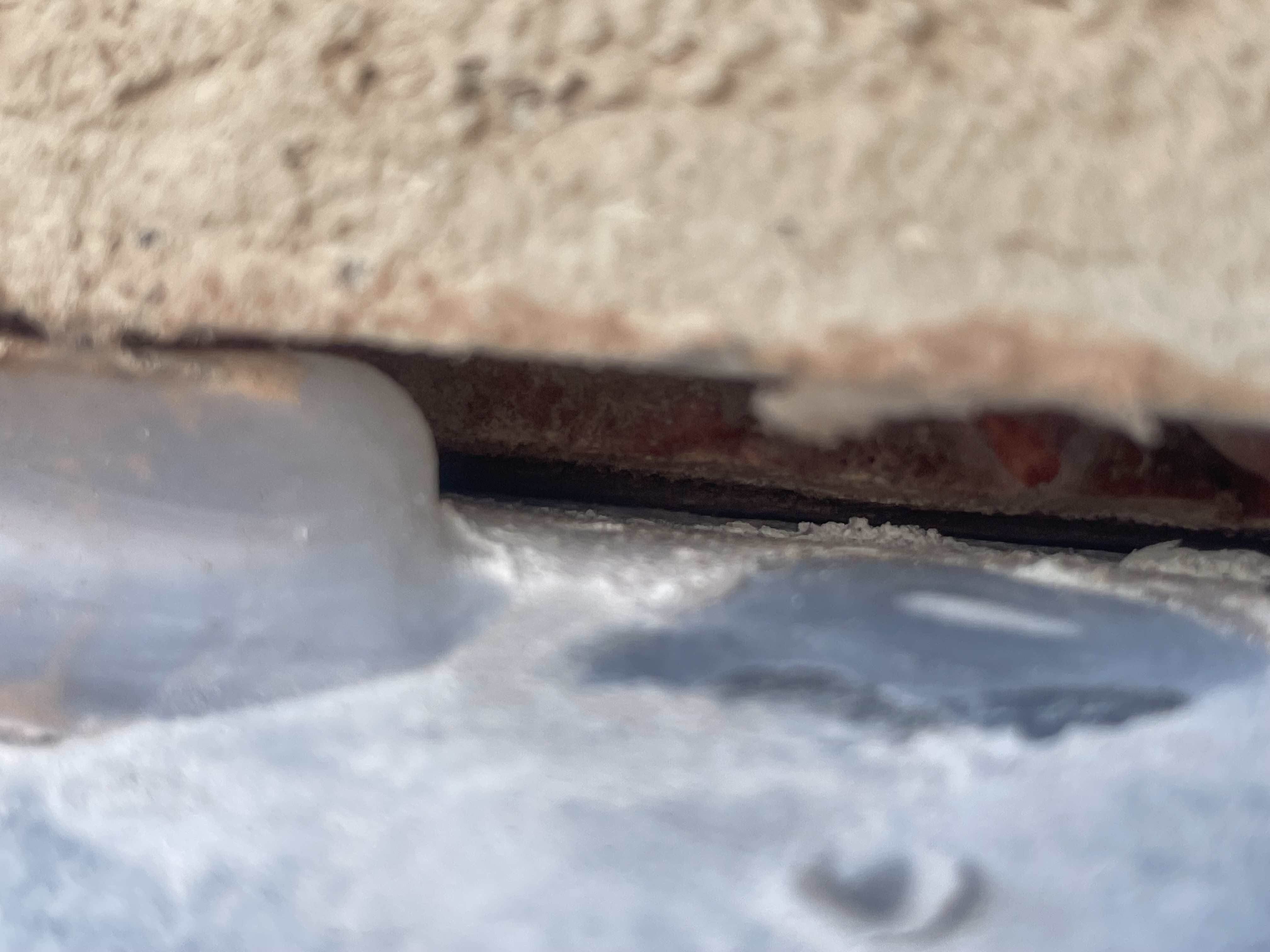

Hmm, yes it can get pretty windy / heavy rain is not unusual. So far no leaks and we’ve had some very heavy rain in the past few months
It is between 15-16 degrees and crest planum duo tiles which can go down to 15 degrees.
Thanks so much for your reply. BC officer is apparently happy with the builders explanation, but I’m not, and certainly not since taking a closer look today.

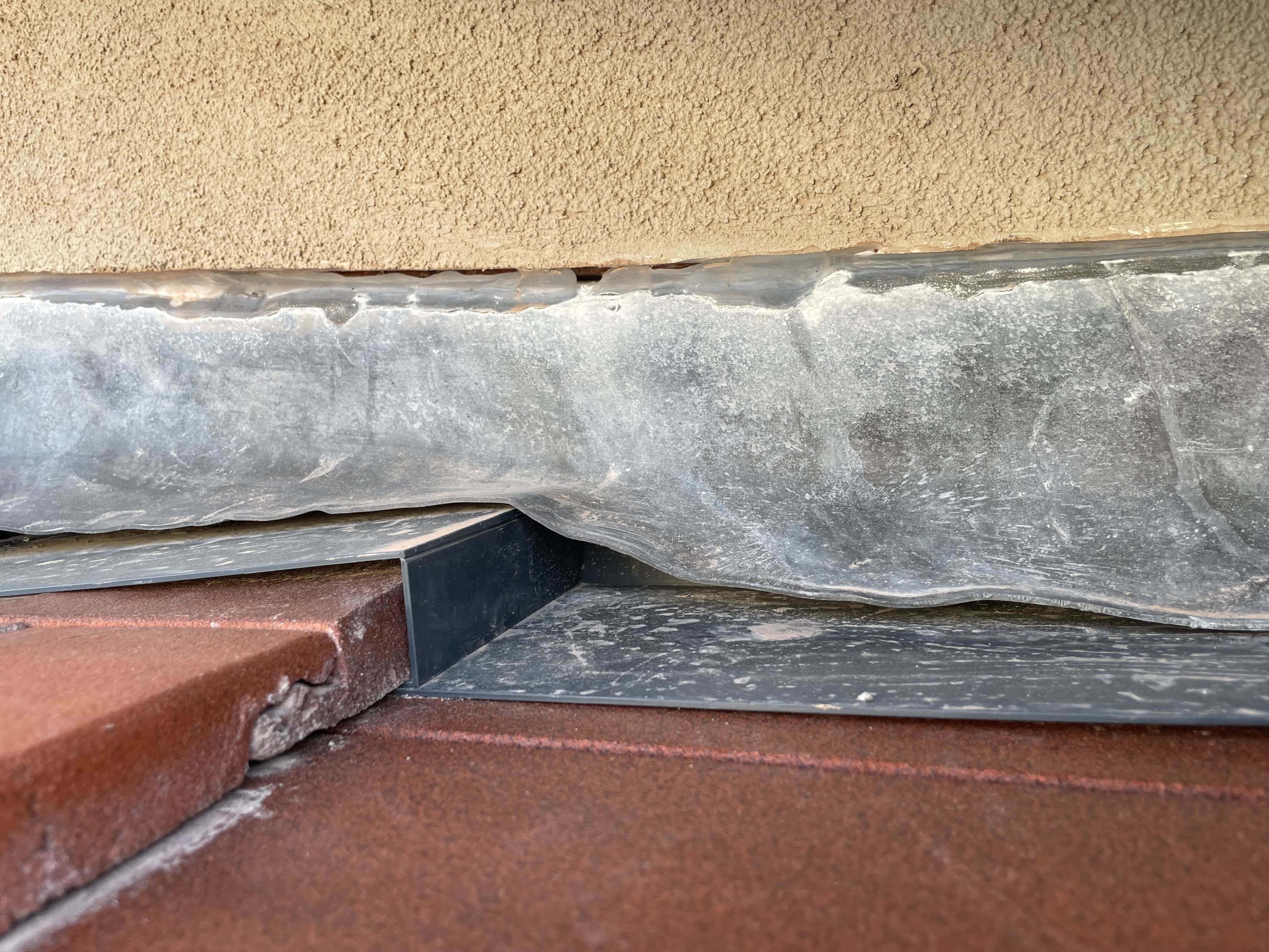

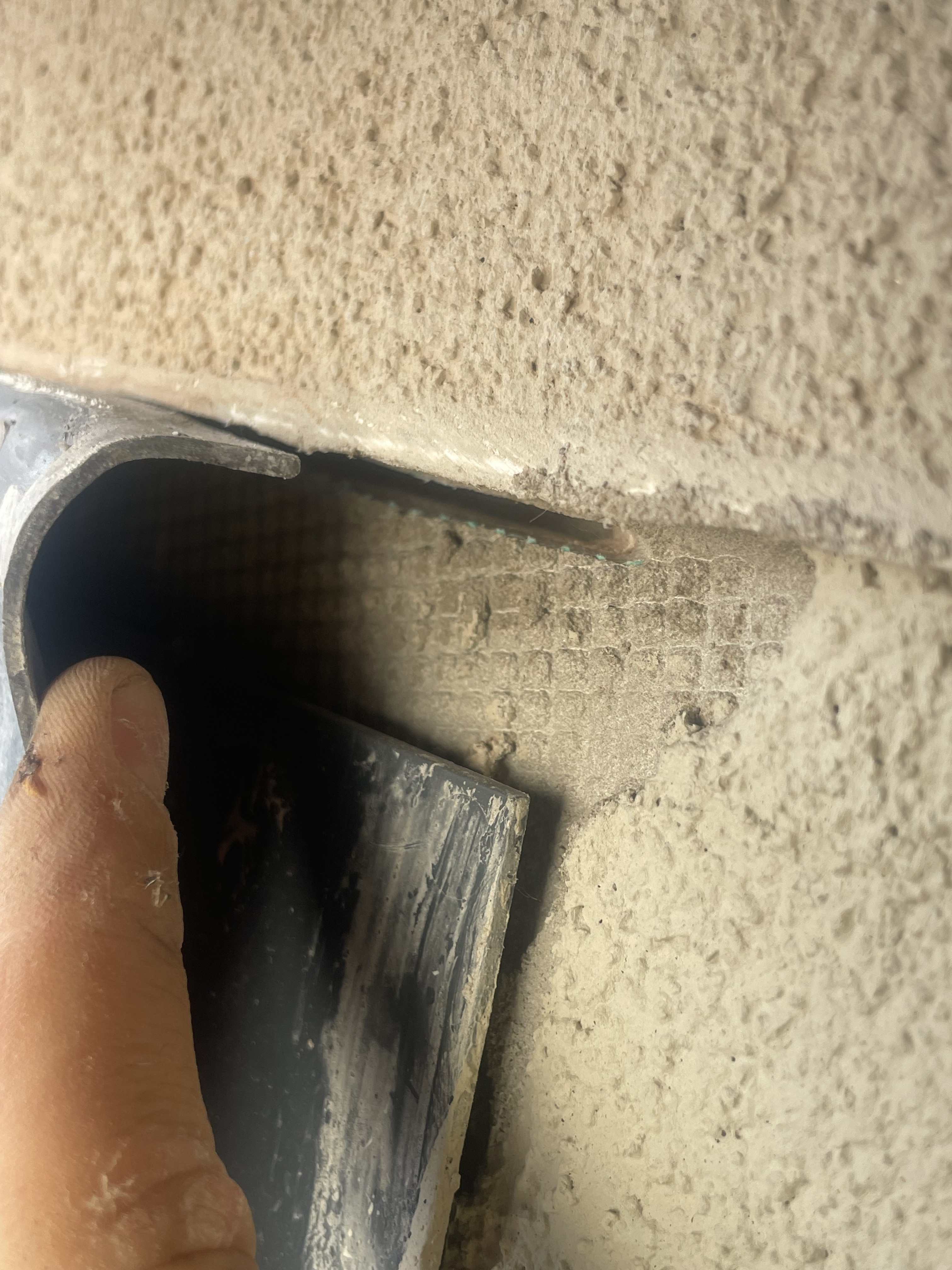

I’ve Recent had an extension and new roof structure. The final balance has not yet been paid and building control cert not yet issued. The builder says the lead work and sealant here is acceptable. BC initially raised it but the builder had apparently reassured him that lead sealant had been used inside the chase and the exterior silicone is just ‘decorative’. He says the lead does not need to be dressed over the tiles as the plaster soakers lap up underneath and up the vertical wall. I’ve removed some of the silicone and theres clearing nothing behind, the lead can be removed with ease. Is this acceptable? It looks terrible to me

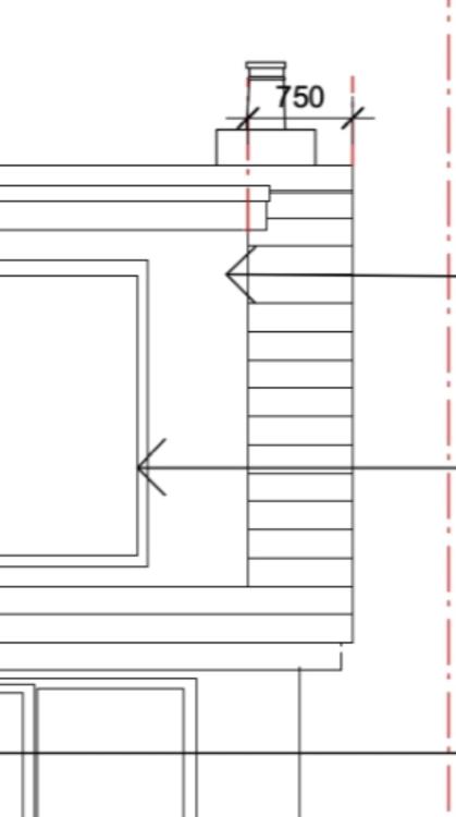

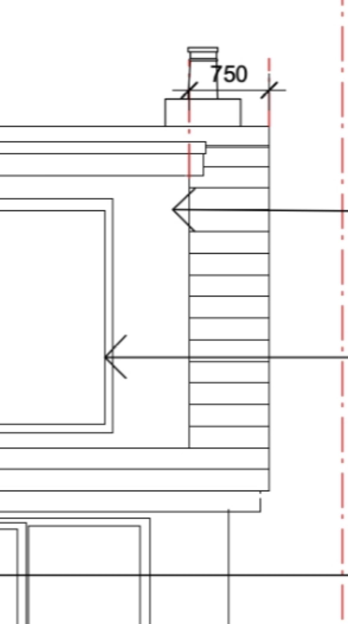

Correction, a 300mm ladder overhangs the gable, plus 100mm tile over hanging the end of the ladder. Dormer is therefore set in 350mm from the outside of the external skin on the gable wall -
I’m having a dormer loft extension at the moment and the existing roof structure includes a 400mm overhang with laddered rafters plus another 100mm tile overhang beyond this to the verge. The approved planning drawings indicate that the dormer cheek will sit 750mm from the verge, so taking into account the laddered rafter plus 100mm tile overhang, the dormer cheek was set to be 250mm in from the outside of the outer gable skin. The trimmers for the cheek have been formed, but my builder says that the 100mm tile overhang must be reduced to about 30-40mm once the roof is re-tiled, as we are having a continuous dry verge. Would this be an issue with planning? The cheek is still where it is meant to be, but the distance to the verge is reduced. I’ve asked if the 100mm overhang could be maintained and he says it can’t - any thoughts on whether this can be maintained once the roof is retiled? Thank you

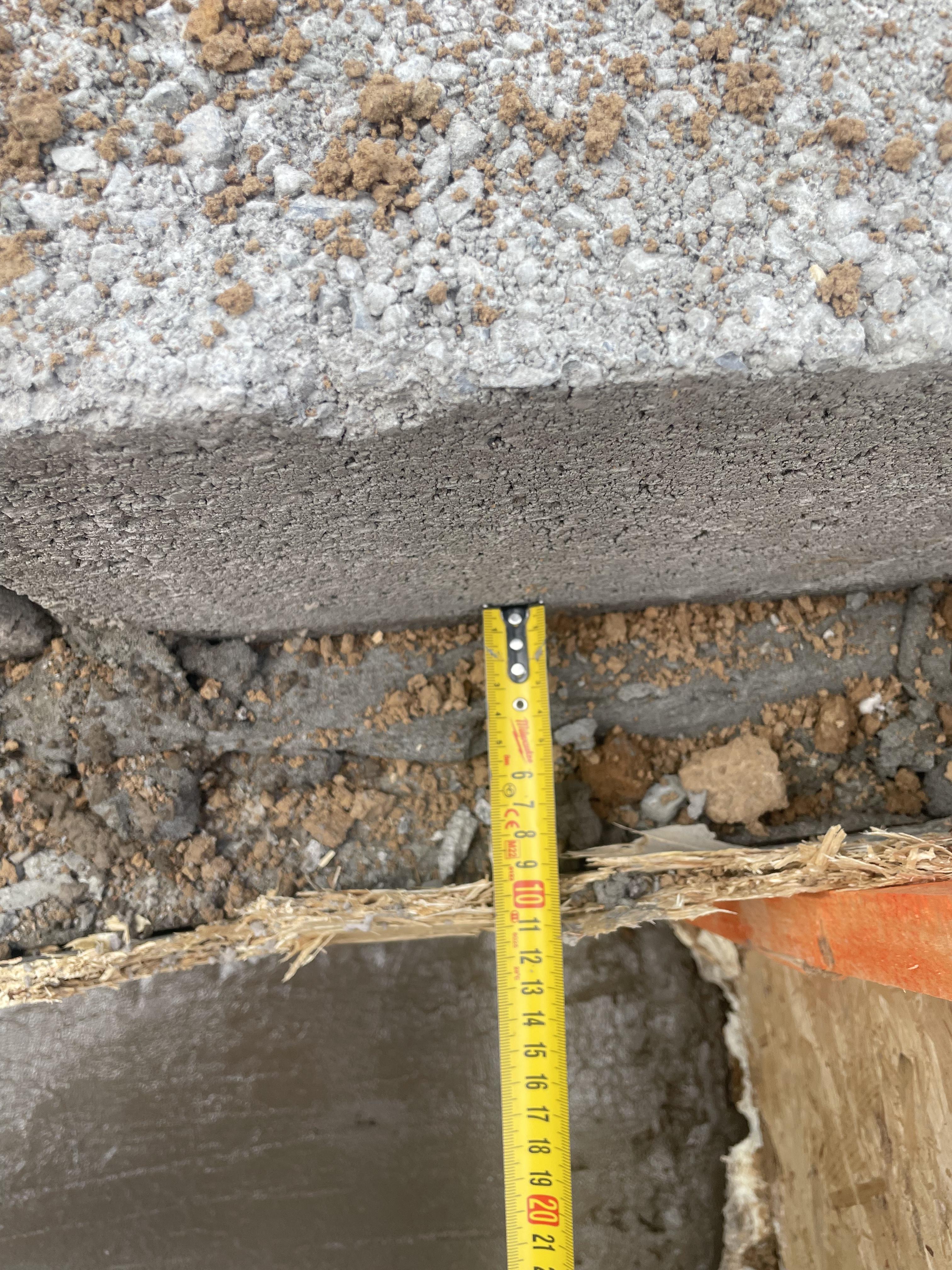

I would appreciate some insight on this. We are building a single story rear extension with a block and beam floor. There is a ground beam spanning the rear of the extension which has been meshed and encased in concrete. There is no foundation under this ground beam, it rests on a trench on one end, and a pad on the other. The external blockwork is not running straight along the beam, and as a result, on one end we only have 100mm of concrete encased beam left for the 150mm cavity and thermalite internal skin. The blockwork has been built square however the beam must not have been laid the same. I spoke with the builder after noticing it and he says it’s fine and the internal skin and 150mm cavity will be built off the block and beam that rests on this 100mm. Does this sound correct? unfortunately my building control drawings do not detail this.

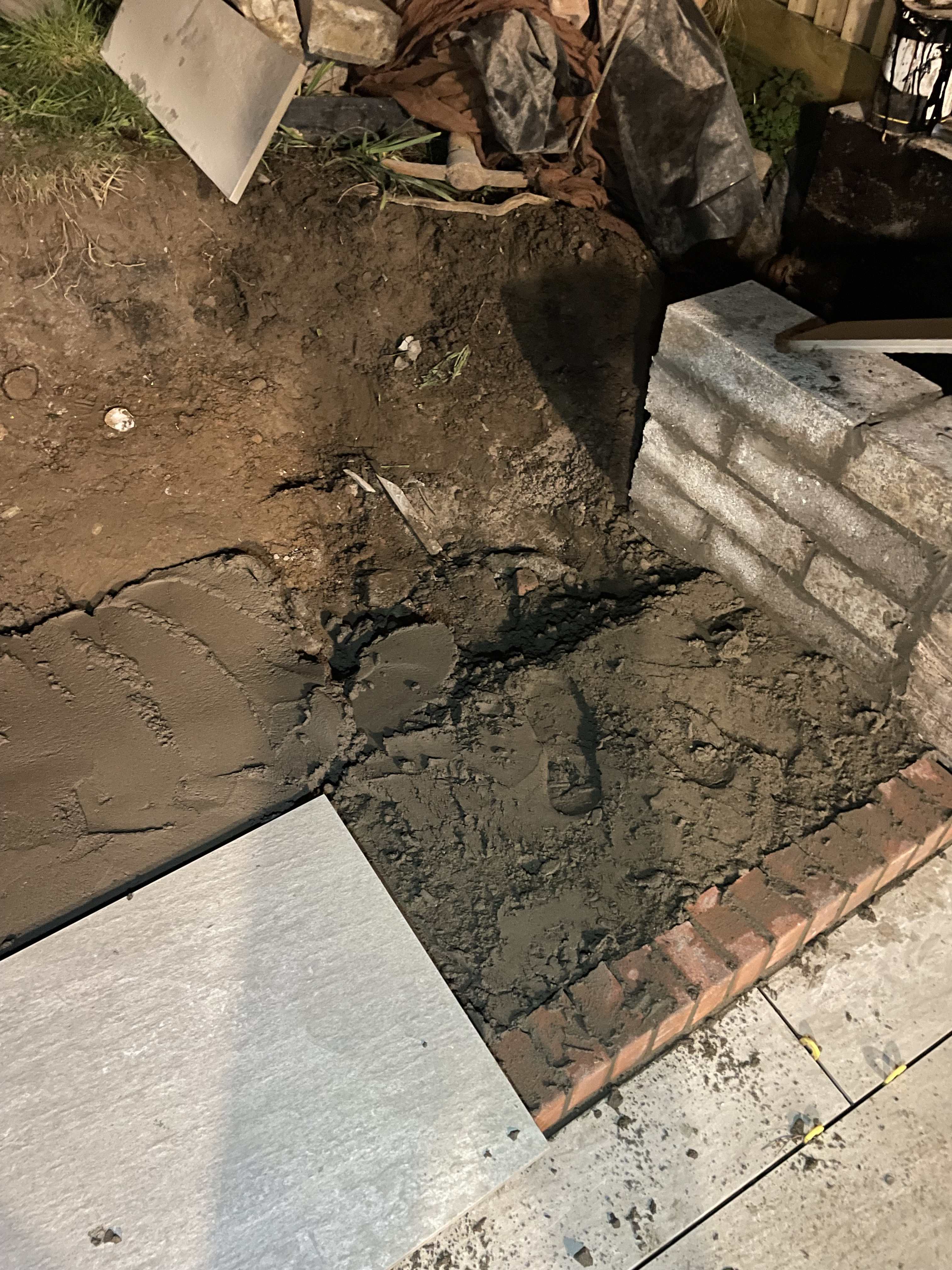

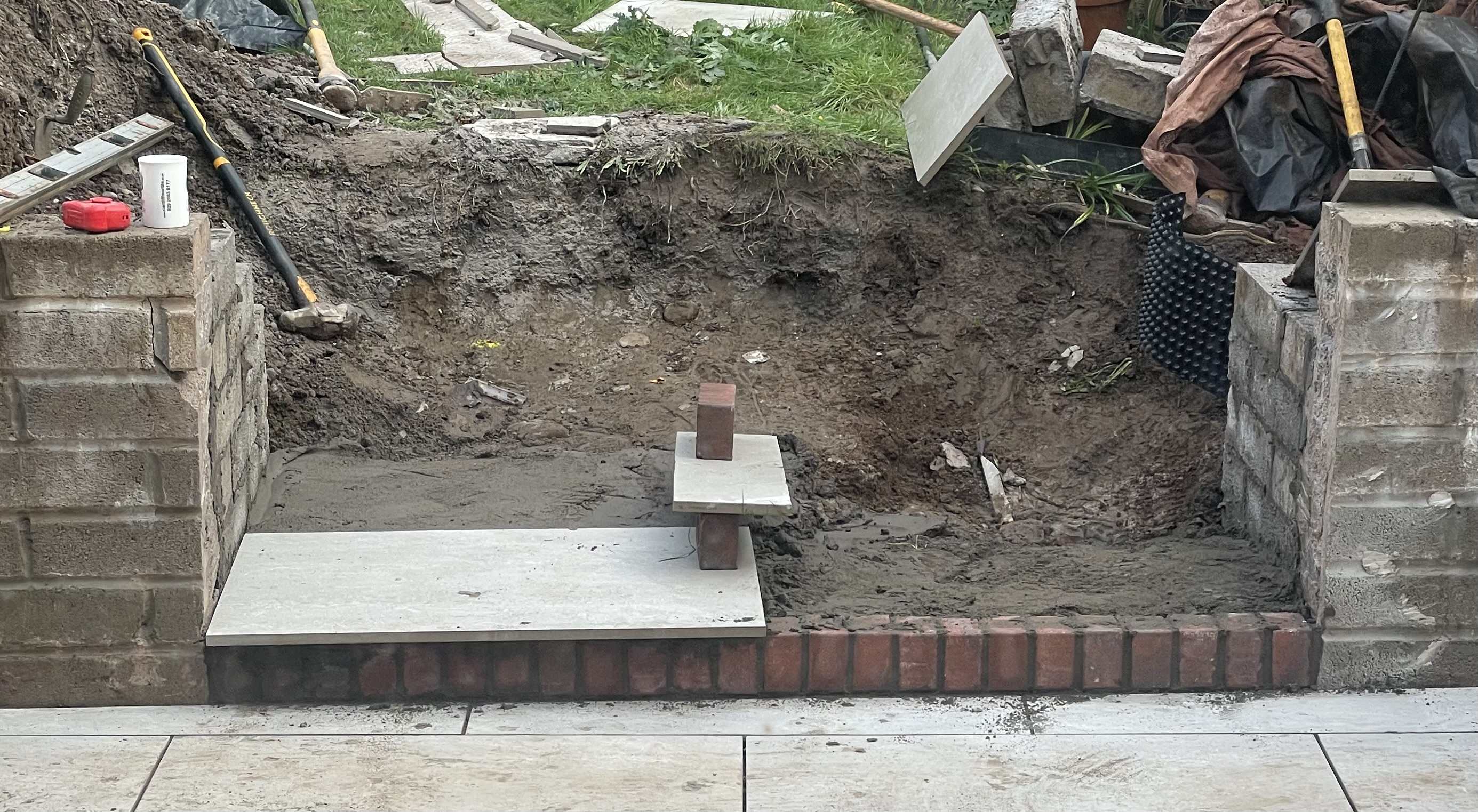

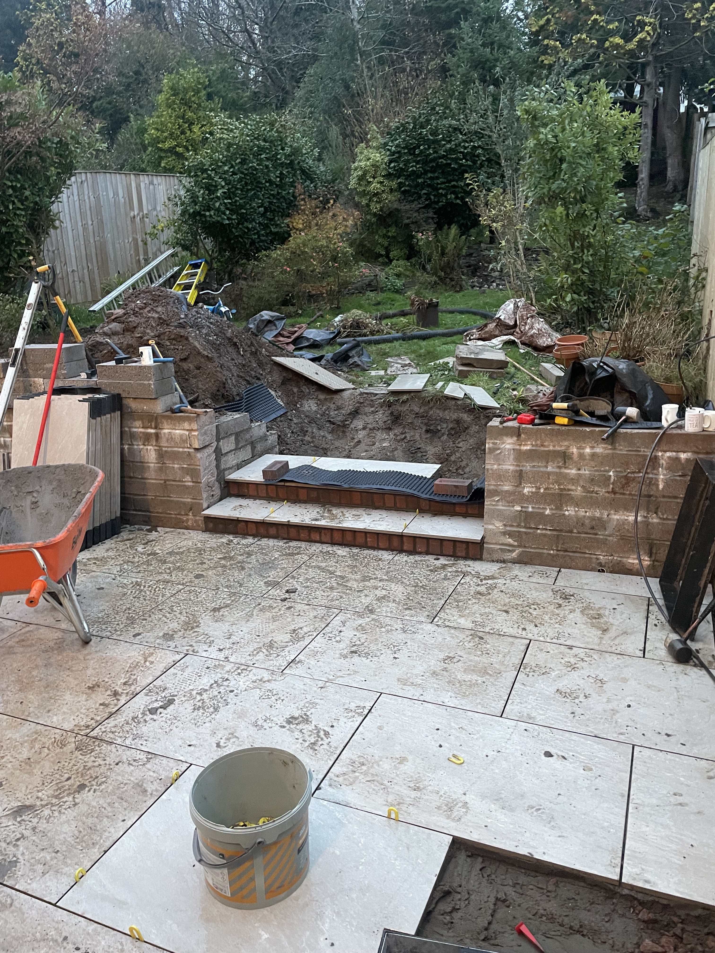

Thank you. I am concerned that with the render option, as this is a retaining wall (lawn), we would have problems down the line with water damage to the render
I require a new retaining wall in the garden, 0.6m above ground level and 18 metres in length including a few slight bends. The current plan is to build from blocks and then clad with some form of stone cladding. Whilst in London I came across this and wondered whether it could work as an alternative, avoiding the need to clad, and offering integrated seating into the design. I imagine it would be easy to power wash and I wouldn't need to worry about damaging any cladding adhesive with this option. I have called around a few pre-cast concrete suppliers and none seem to be able to offer this. Does anyone have any suggestions on where I could look into this further? Am I crazy to think this might work out cheaper than building with blocks, cladding, and then sorting an integrated seating option? Any ideas welcome Thanks Adam
