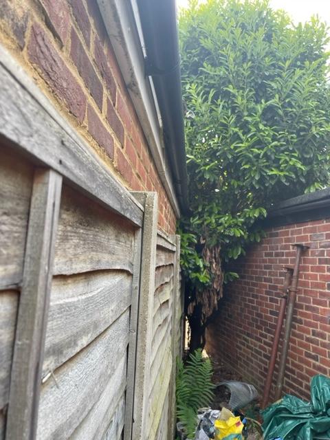

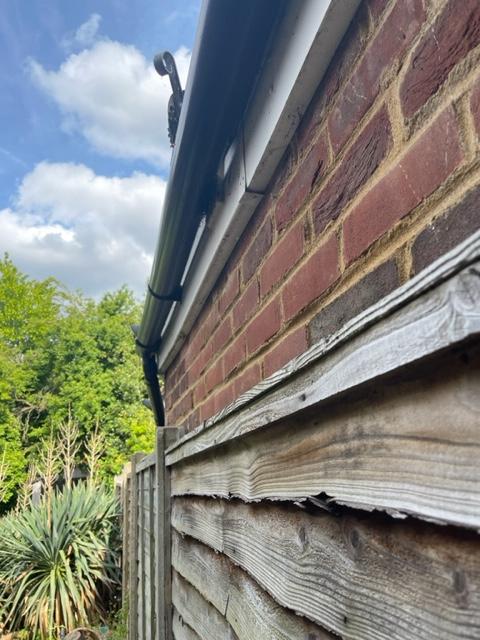

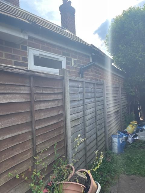

Hi Adsibob Thanks for a prompt response and advise. Ideally I would like to cover the whole area as I have no use of it at all and I do have 1 m wide side access on the other side. I will wait for the planning for department response as you have suggested. I might have to arrange party wall agreement anyway which they are not likely to agree. Any other advice on this challenge would be very much appreciated. Thanks. -
Hi All I am looking forward to start a 3 sided 115m2 ground floor extension next month (STPP). Construction will be by a builder friend and project management by myself. Ground floor plans attached here to give you a flavour. The planning decision is due in couple of weeks. The next door neighbour has a mirrored property and has done the similar extension around 7 years ago (see the photos attached). They have objected to the plans on the basis that it will weaken their shallow garage foundations and roof, contravene party wall act (section 6), will restrict/prevent access to their guttering/roof etc., and couple of other minor points. We moved in the property in 2018 and applied a similar planning back in 2019 (kitchen was bit smaller and conservatory was staying) but the garage conversion was the same. That time, the neighbour only objected on the basis that natural light to their window would be blocked (as shown in photo). Their objection was rejected on that occasion as the window was not in a habitable room and planning was approved. However we didn't start the build straightaway and then COVID happened changing priorities. I am not sure what would be the planning department response to the objections this time. They may still approve it with some caveats and advisories or may ask to make some amendments. Will let you know when I have heard back from them. However I am more concerned around the neighbour. They have built their wall touching to the fence which has made part of their guttering actually overhanging on to our side. I would also like to do the same and build as close to the fence on my side but without any guttering as I can plan the roof to drain to the front or back. They are not going to like it and may create problems when the build starts. So trying to anticipate any legal or other challenges they might throw in to stall the build. Any advice on both the planning aspects and how to manage neighbour boundary issue would be much appreciated. I would like to do any homework as needed to prepare rather than just sitting tight until I hear back from Council. I would need plenty more advice when the build starts as this is a massive undertaking for me but let's get there first. Thanks in advance. Existing_Floor_Plan.pdf Proposed_Floor_Plan.pdf
