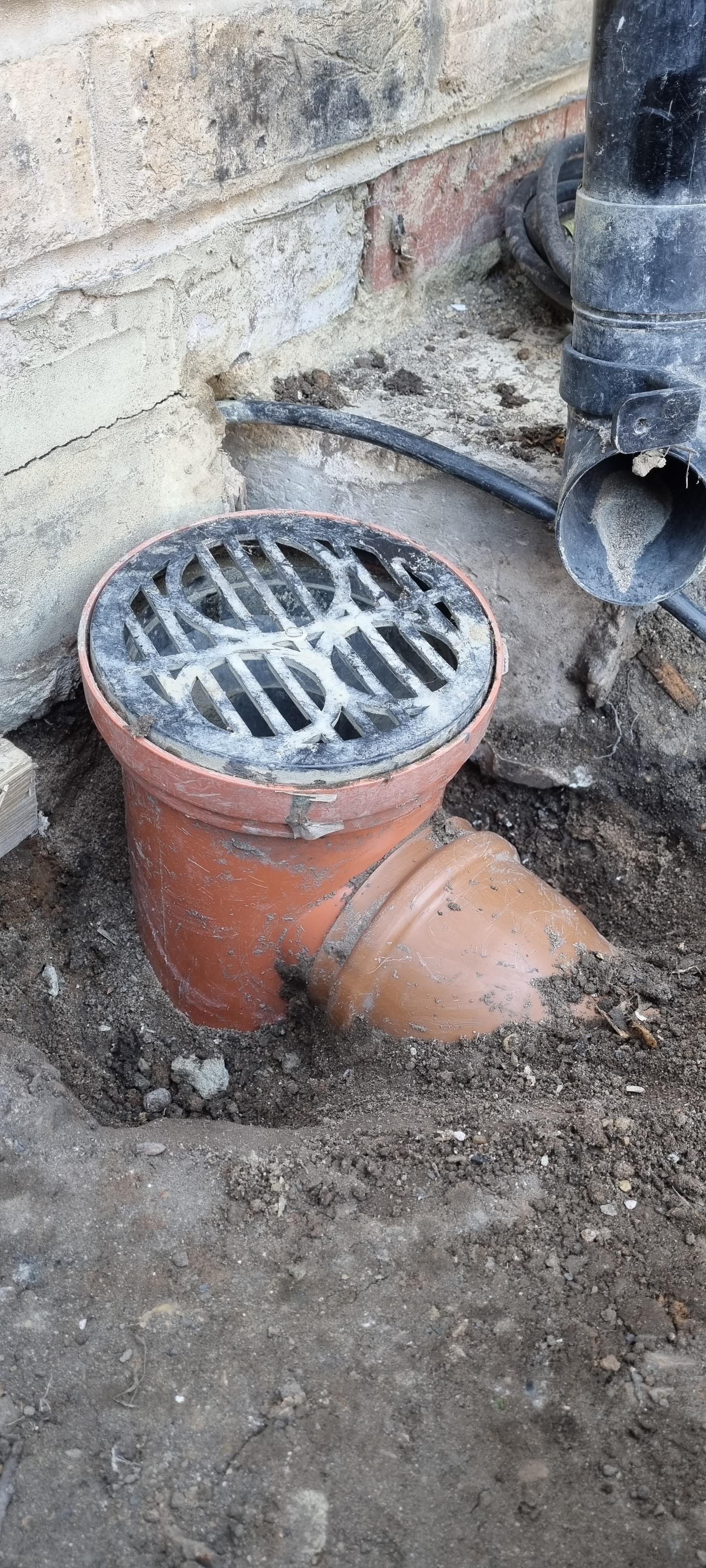

  1. I guess I'll have to remove the hopper in that case. Was really hoping to avoid digging out and changing pipes and was hoping for a way to convert the bottom of the aco into the hopper but hey ho. Probably for the best to give me more room for the DPC anyway.
  2. I've tried to dig around the hopper but I'm struggling to get it out to be honest. The hopper is sitting lower than I want my storm drains to be placed. Is there any adapter I could by which would divert the water from the bottom of the storm drain into the hopper?
  3. Yes and yes. So the hopper is connected to a 110mm pipe that connects into an inspection chamber elsewhere in my garden. I have taps further along the wall and I'm looking to add paving so wanted to fit storm drains along the wall and drain through hopper. But hopper placement is not ideal
  4. I want to run a storm drain across this wall. However a hopper has been put in the way. How can I work around it or replace it?
  5. Hi, I want to complete a storm drain in my back garden, however there is a hopper with a single connection there which is already connected to a 110mm pipe. I wanted to replace or then push it lower so I can use a bottom outlet adapted to 110mm fitting. What is my best option? Please advise, I am new to this and unfortunately I cannot afford to pay another builder to complete this work at the moment. I've attached some pictures. Thanks in advance
