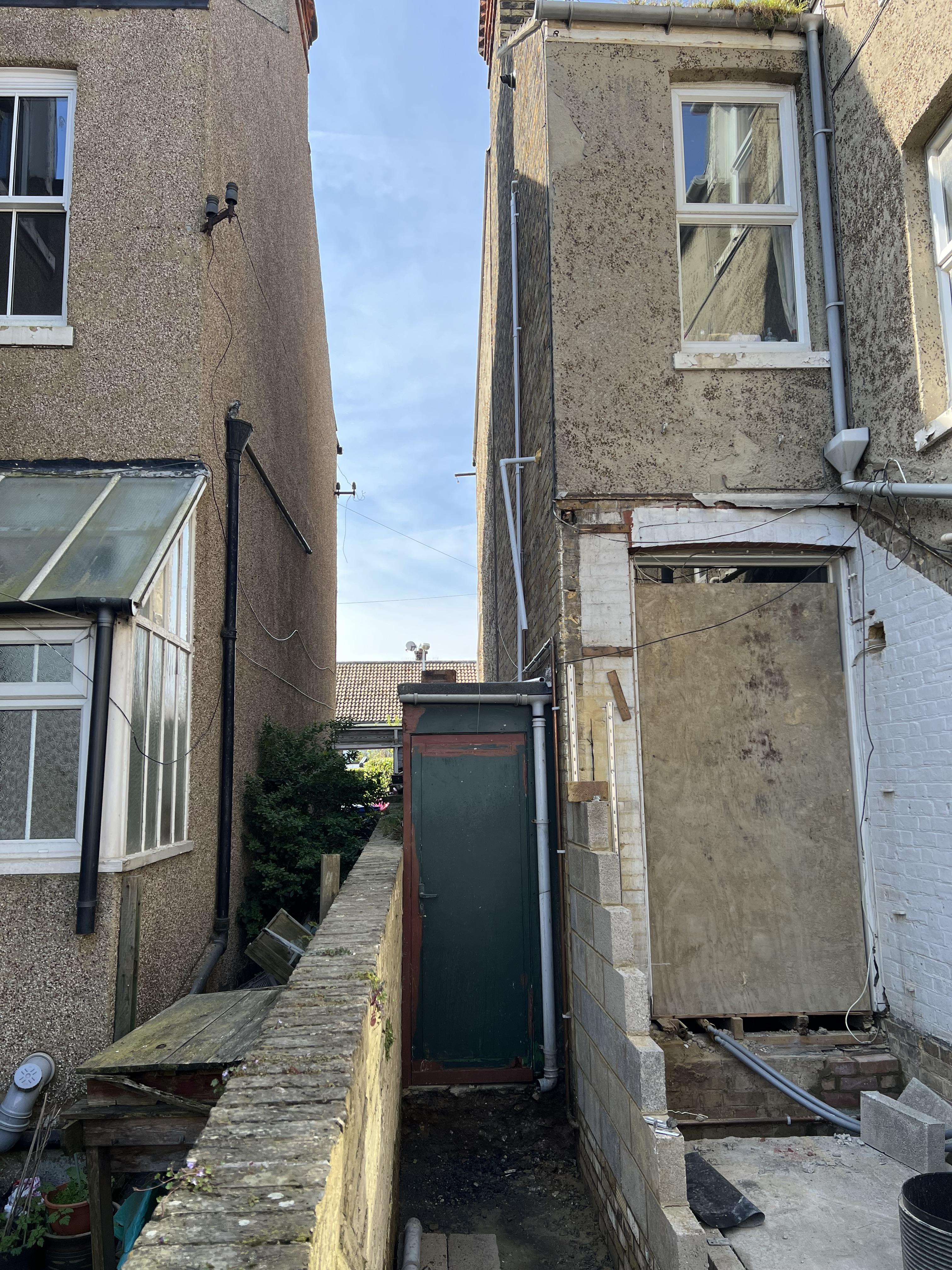

Wall is about 9-10 cm to left of where it should have ended if it was straight, after a length of 9.8 metres. -
How would you determine wall orientation….
Jimbo123 replied to Jimbo123's topic in Bricklaying, Blockwork & Mortar
I have about 9-10cm maybe more. -
Thanks Guys….. Canski - I have checked it that way, but I will move it away from the wall a little as you say. ProDave - thats what I thought, and amI have already checked that too. I paid extra for a measured survey of the house which shows the rear part in alignment too (also garden boundary wall is too ..Victorian builders !) So what accuracy should I expect ? -
If you had to build a new wall (the side of a new extension) out from a house that was a continuation in a straight line from the side wall of the house, how would you make sure that the wall was straight and perfectly aligned with the house’s side wall (which is also about 10m long). I am talking about alignment, so that when you look down the finished wall towards the house, the building line is completely straight along the house into the new wall. And what method would you use to do this if there was a 7’ shed in the way as in the picture. House wall in question is to right of shed door with waste pipe sticking out. New wall would come from right of shed door towards camera (the actual new and incorrectly laid blockwork is visible ). Waste pipe and gas pipes on this wall can be ignored as they were installed after new wall was laid incorrectly. Under these circumstances would you use a string line or laser line - can u describe how u would approach it ? And how difficult would it be to do this and what accuracy should I expect ? Should I expect a straight and perfectly aligned new wall ?

Having an extension built, and one of the sides (10m long) should have been a continuation of the building line of the house. The builders have completed the walls to about knee height, and at the end of this wall, it is 11cm out from where the corner should be (to be a true continuation of the side of the house). The wall opposite has also been built in the same way (apparent by sight as it is next to a straight boundary wall). The plans approved by Planning Authority which were given to the builders show the walls as straight continuous lines with the existing house. The plans showed the corner lay where an old inspection cover is located. They also showed where this inspection cover and chamber was to be relocated (2 metres away from this corner). The builders spoke about moving it or a lintel over the edge of it. But when the wall started to be built we were told that the corner of the wall ‘just misses it’. Now we have discovered it should have been over the edge of the inspection cover. Obviously the builders have moved the loctation of this corner to save a lot of trouble and money. - should the builder have consulted us ? - where do we stand with building control/planning ? - should we seek recompense as it appears the builders have gained considerably at our loss? or is it a fuss about nothing …..? The inspection chamber is for our drainage only - ie not subject to a ‘build-over’ process with local council
