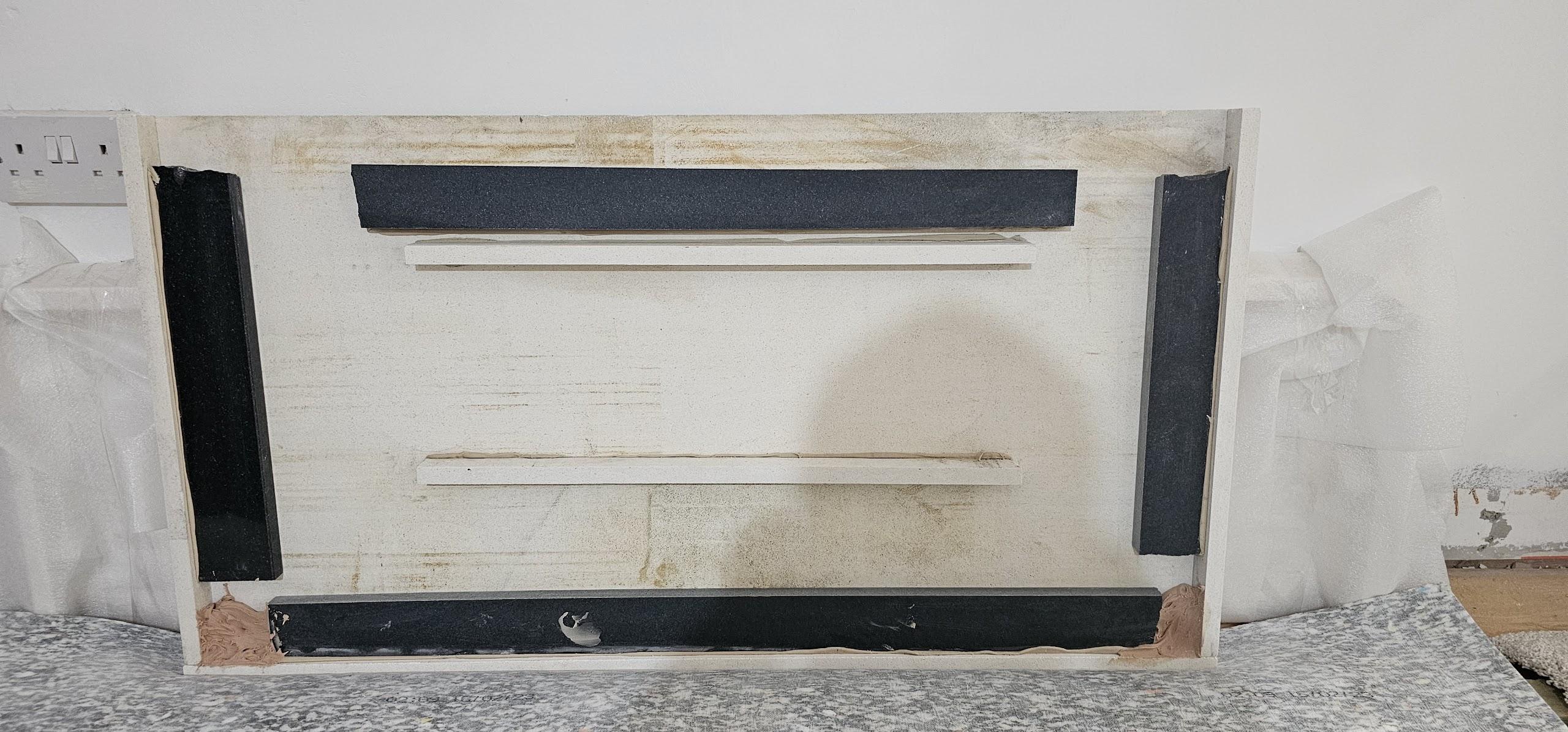

Well, after a long saga having our defective Aga stove replaced due to rust on the door i'm just getting around to making a start on this. Below is a pic of the underside of our boxed and lipped back hearth. I have a bag of Mapei Keraquick flexible addy and I was just wondering how exactly I should bed it down i.e. a full depth and complete bed OR maybe laid in some slightly higher ridges with some troughs between to allow the addy to spread out as the hearth is laid on top. Any pointers before I tackle this tomorrow would be great. I'm just applying 2 or 3 coats of SBR to the back throughout today, giving it time to dry between.

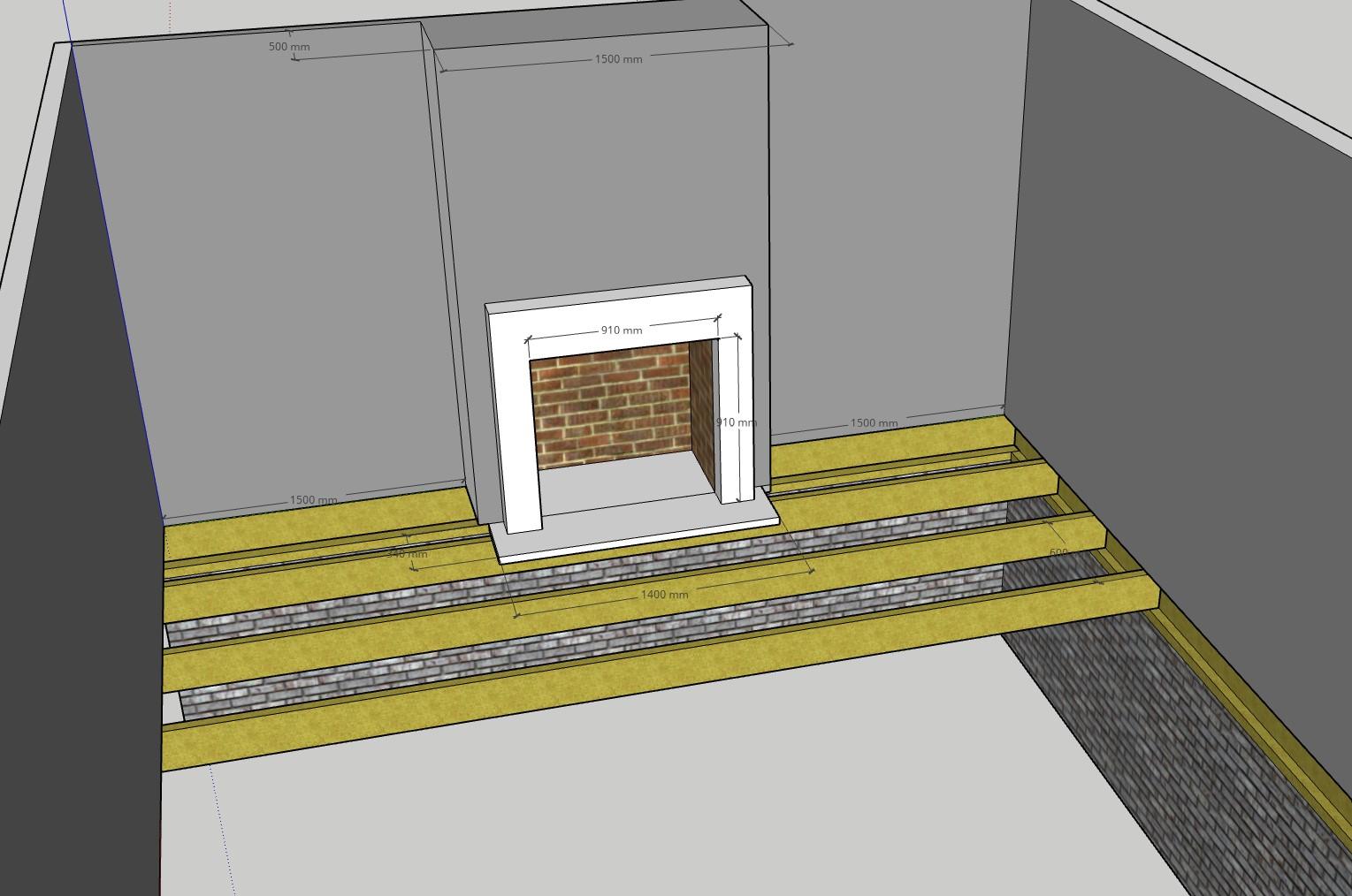

Overthinking....me? My wife would like that comment I think in this instance the hearth we have chosen has upstands on the underside such that there will be hollow areas that will need bedded down the fill the hollows. Thanks Tony. I hear you on the sealer and it was something that was on my radar. I'll go with that then. Cheers!

Great thanks. Would this be with or without the 6mm HardieBacker? Appreciate the thought Tony. The room will still have it's CH radiators as the primary heat source.
Hi folks, We are looking to install a balanced flue gas fire, this one in particular. This will be installed into a "false" chimney breast that I will construct and be housed within one of these chambers. The hearth and surround will be Agean Limestone and the issue I have is bedding down the hearth. Our floor is a suspended timber joist floor with 22mm tongue and groove chipboard. The joists run parrallel with the wall the fire will be sited against and there's about 5ft between floor level and the ground underneath. Ideal for running services in under there but not really possible to build up a solid base if there was only a couple of hundred mm under there. As chipboard is far from the best substrate my initial thoughts are to bed down some 6mm HardieBacker boards, cut to the exact size of the hearth, with a cement based flexible tile adhesive before screwing down. I could then bed the hearth onto this with the same adhesive (or sand/cement? not sure which would be best?). I would aim to strengthen the floor prior to starting any work by adding dwangs/noggins under the fireplace to aid minimising movement in that area, and screwing down. Any thoughts or advice on this approach would be greatly appreciated. Rough SkecthUp below minus any additional dwangs. Cheers

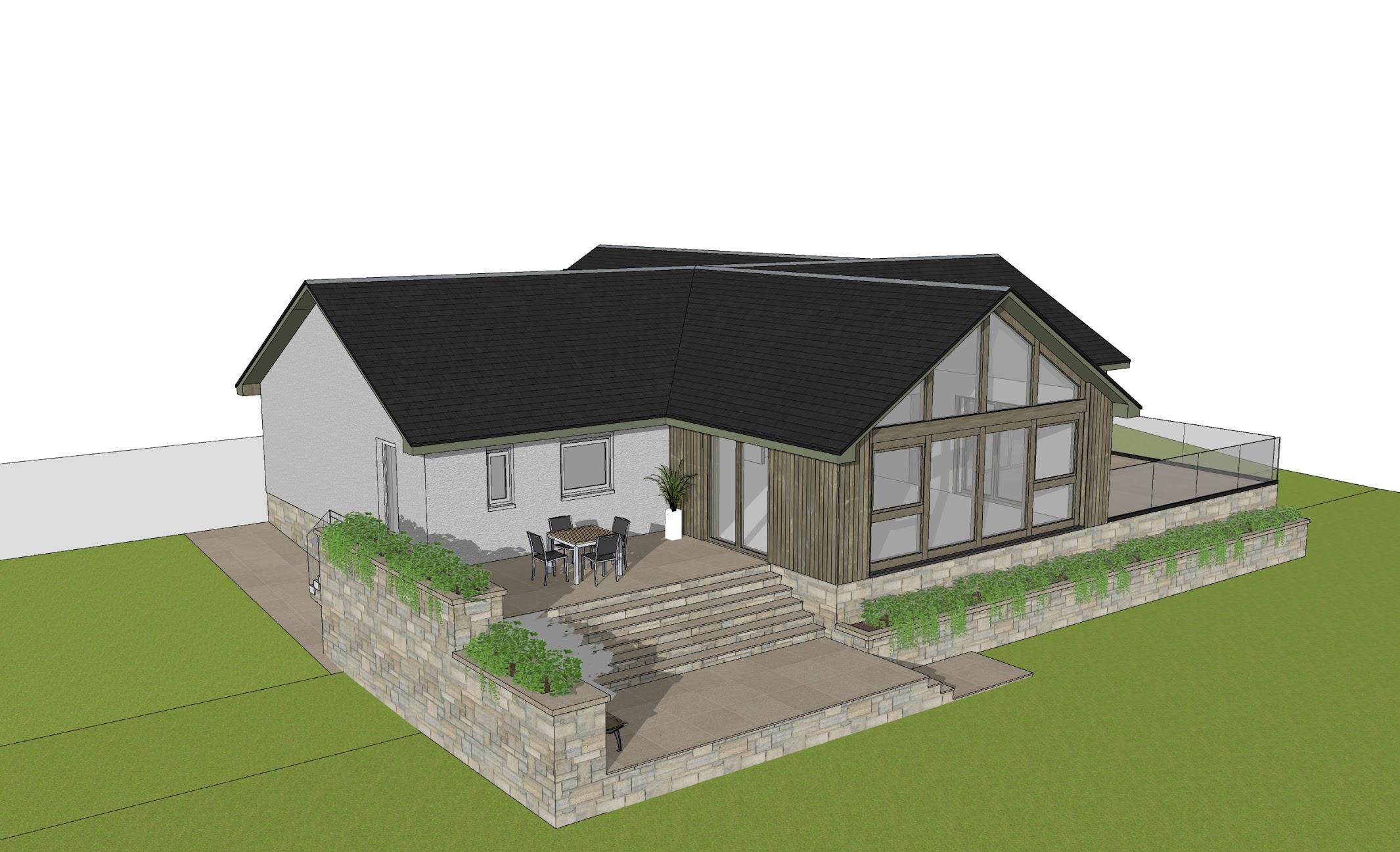

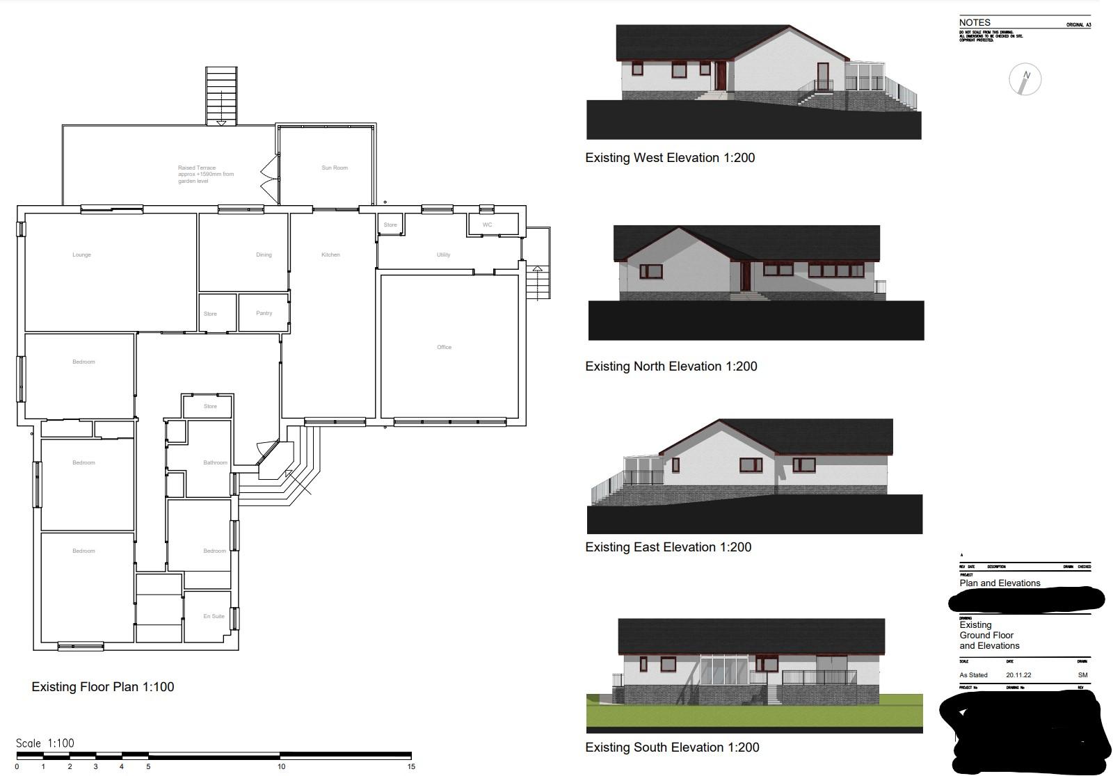

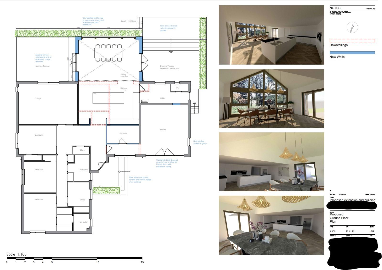

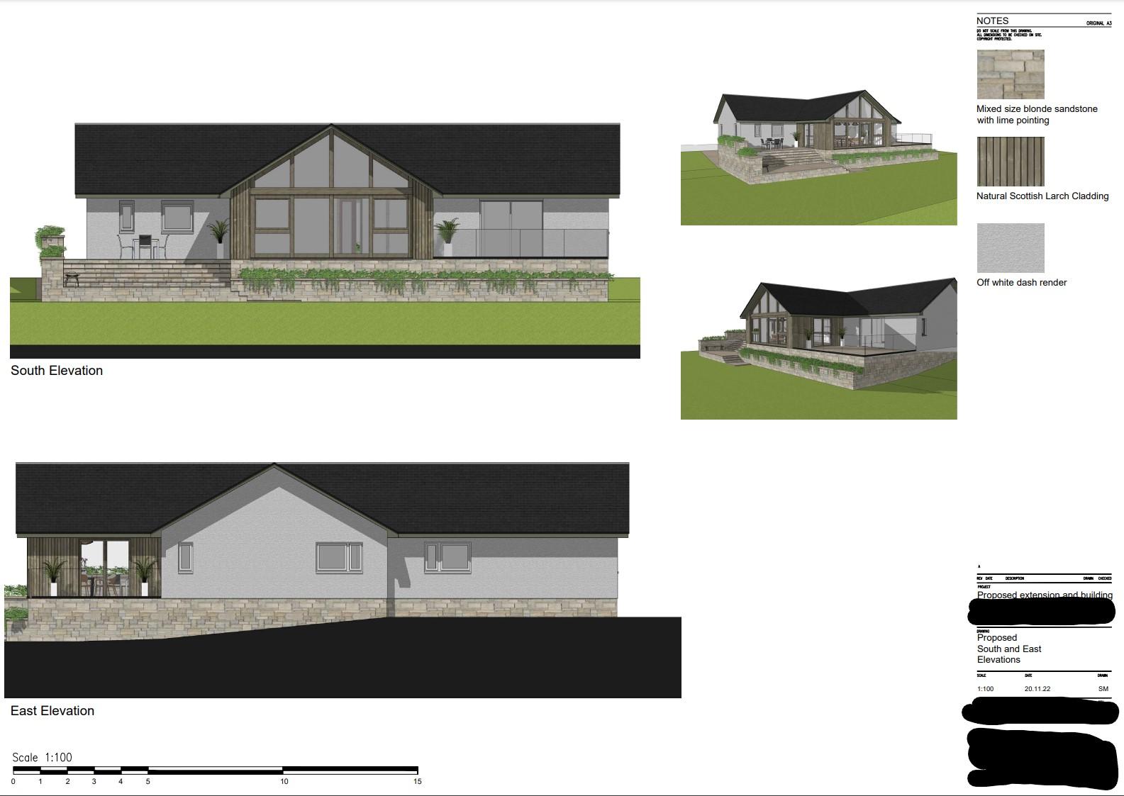

Hi all, Just a quick introduction. We bought this bungalow in the Glasgow area late last year and are working our way through renovating the entire property. The previous elderly owners had understandably let the place go somewhat and we've already uncovered a few surprises. I'm a sparky to trade and pretty handy at most stuff so will be carrying out as much of the renovations myself where possible; handing over to the pros where necessary. We have an extension proposal sitting with planning just now to extend out from the rear of the property to create a large kitchen dining area with glass gable, and also to convert what used to be the integral double garage at the front, into a master. The previous owner had previously converted this to a home office and built an external two storey double garage, but it doesn't flow well with the rest of the property. Some drawings attached below of existing and proposed alterations and one of our renders. Hoping to add to the forum where I can pick the brains of others when i'm stuck Cheers
