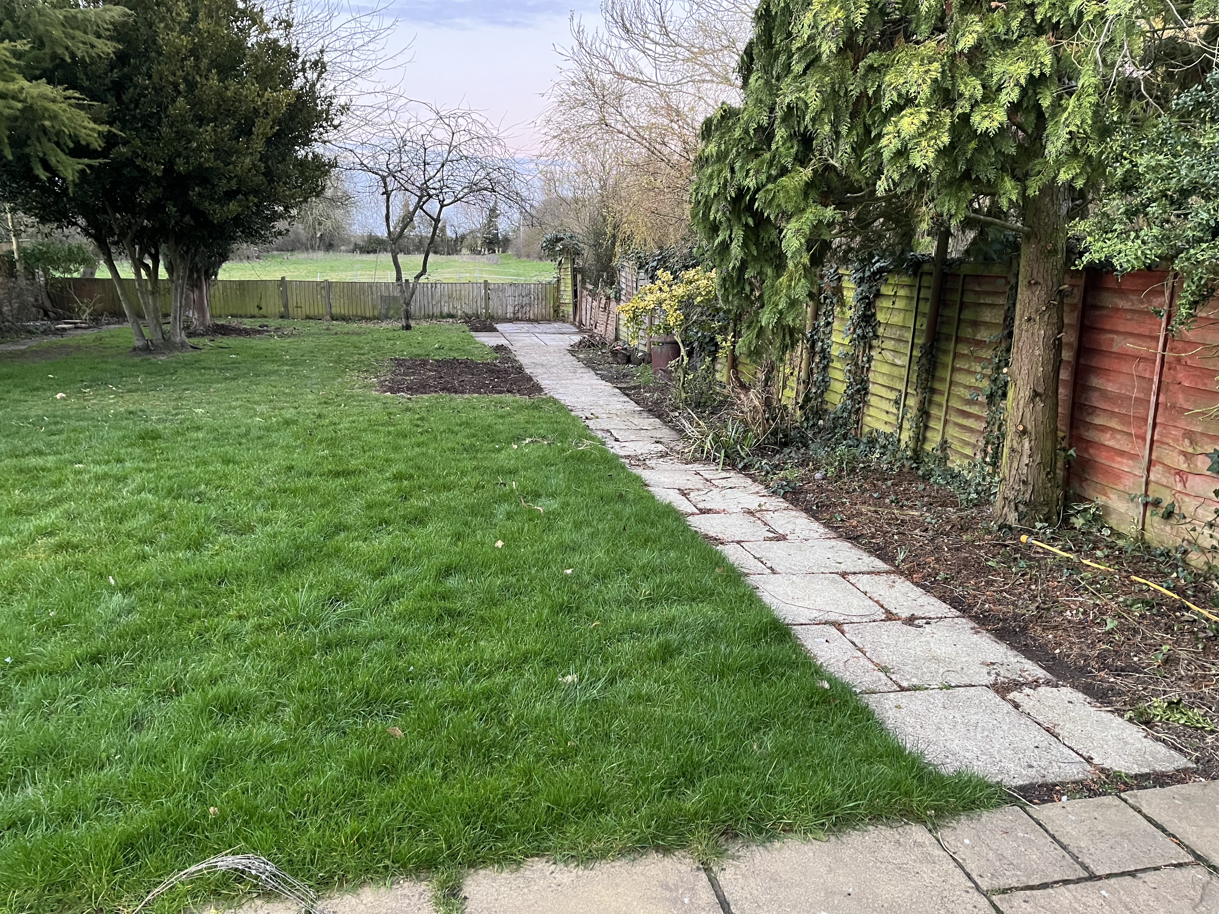

Personal Information

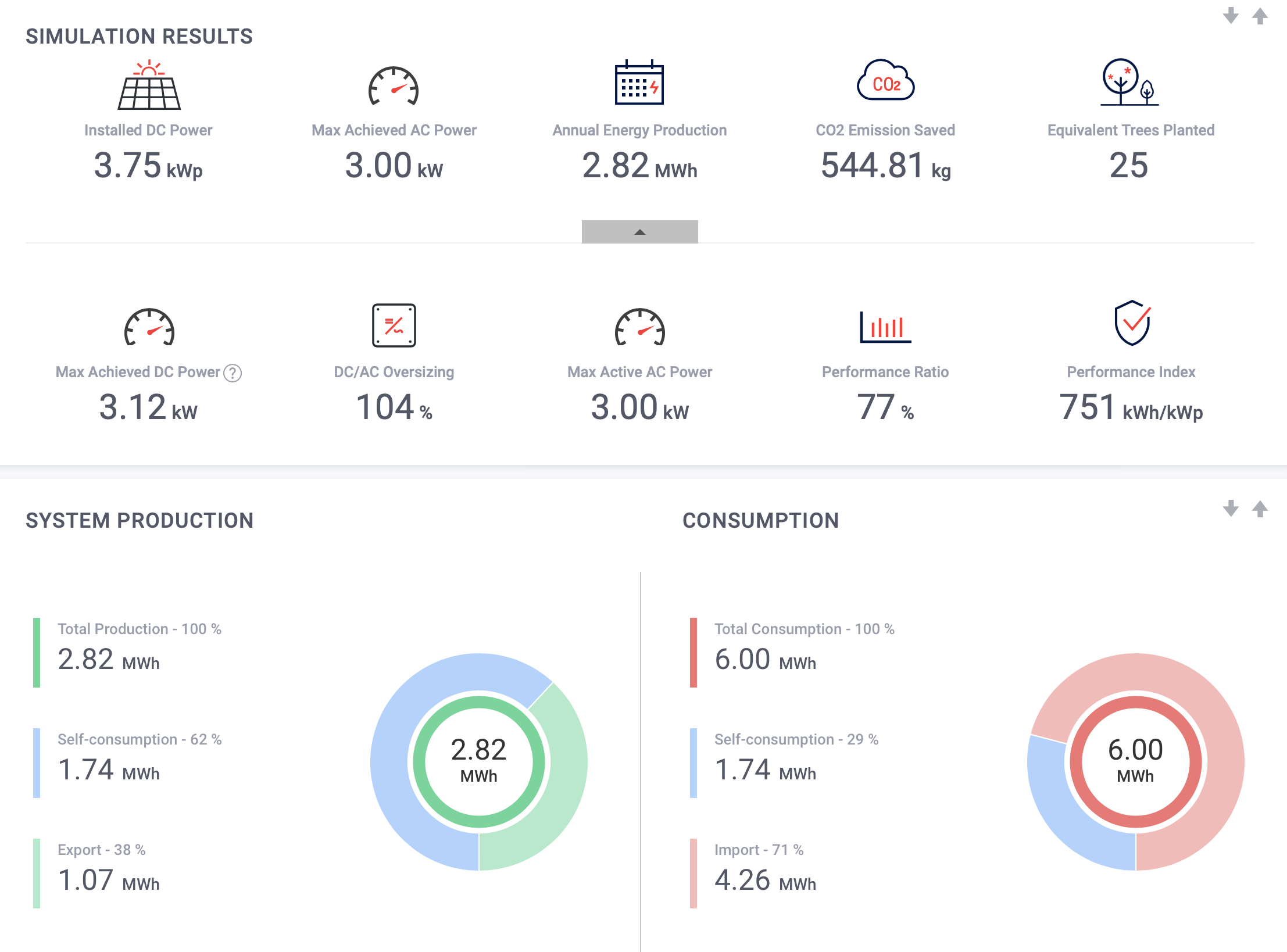

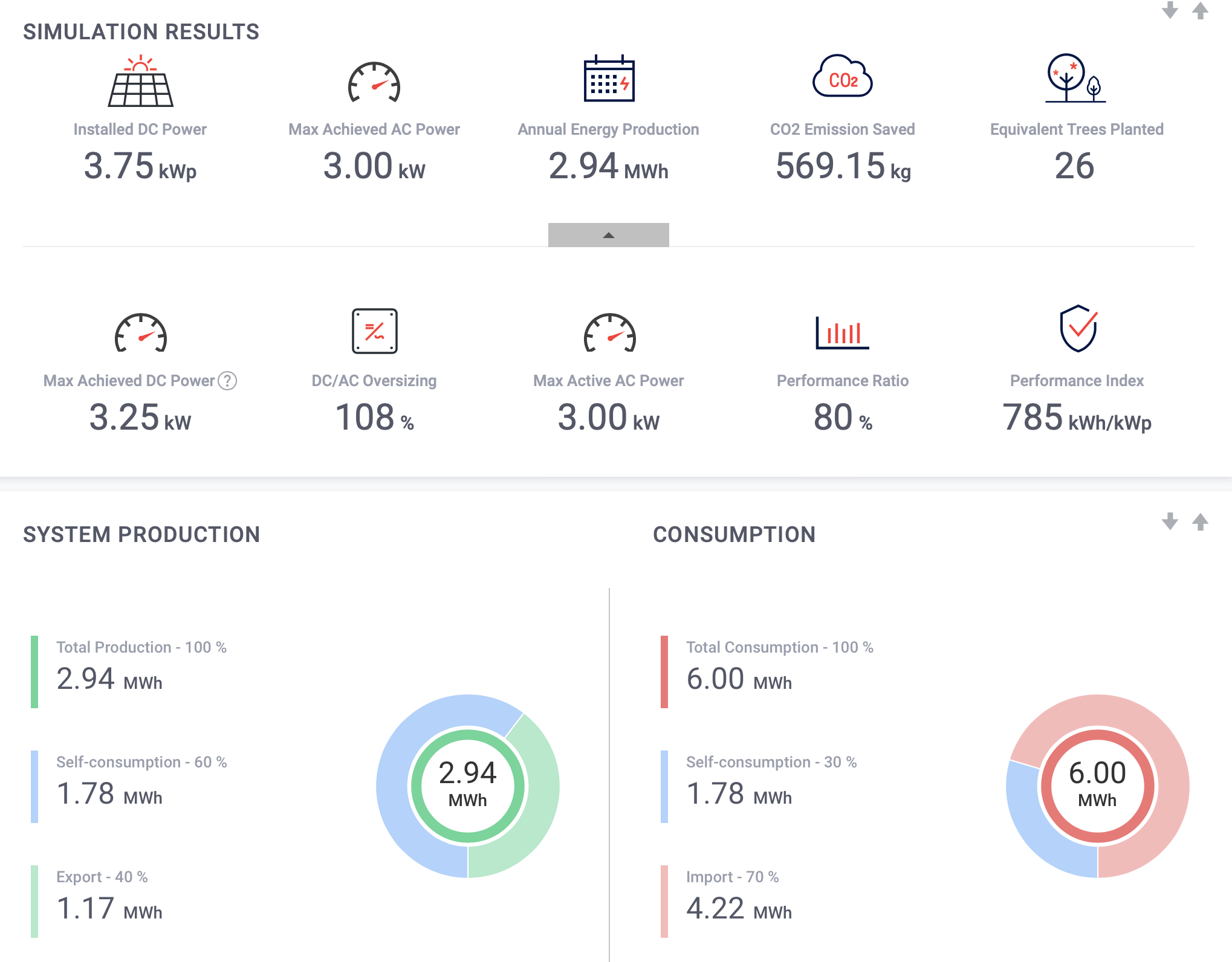

  1. 20° panels drop down the calculations for generation by about 80 kWh pa (self-consumption) but this might more than be made up for in less dirt on the panels.

  4. @NickfromwalesI started assuming that I was aiming for S facing and 30° tilt / pitch but the spacing required to not have 30 - 50 % of the panel in shade for half the year clearly indicated that E-W might be worth considering. Also the potential extra array on the house extension (if built) would be S facing. I have been playing with the SolarEdge designer on the website so given your thoughts I will look at trying some different tilt angles and see how that changes the numbers. There are some trees in both our garden and the neighbours so all of it is measured a certain amount against how many of those are accurately modelled or trimmed back (a couple will need to be removed for the garden room anyway).
