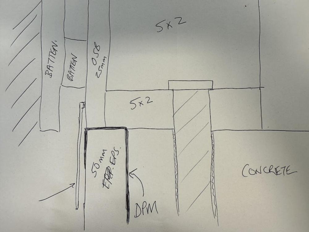

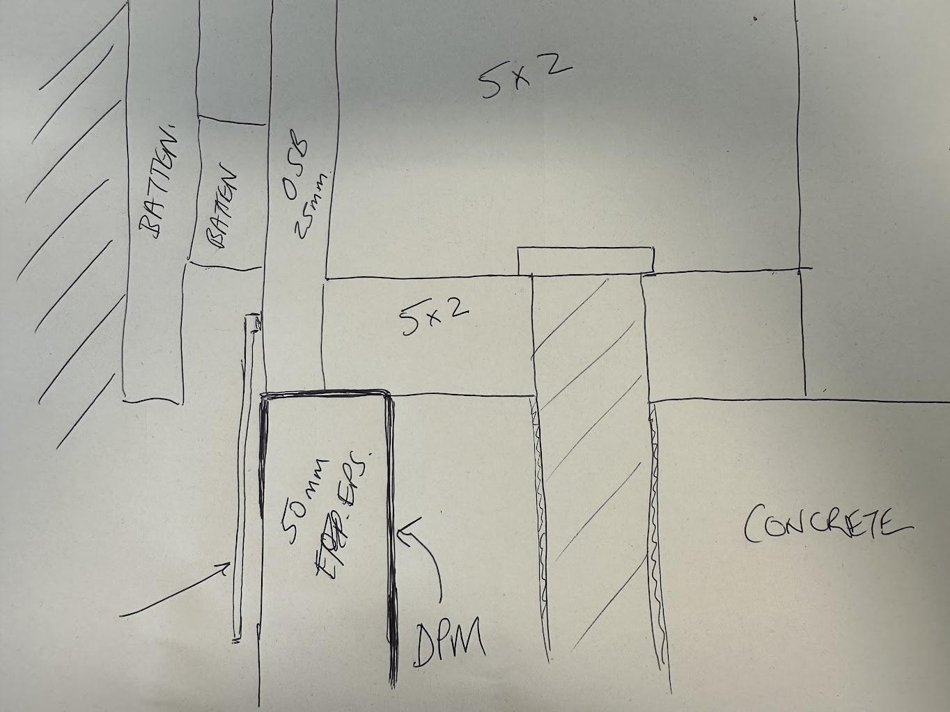

I was thinking.... as I'm going to have OSB + double battens and then cladding extending the depth of the walls, does that not give me wiggle room to bring the timbers more over onto the concrete? Even if it was by an extra 25mm, that would mean 100mm of the wall is over the concrete with only 25mm over the upstand. Any issues with that? I drew it out but missed out the OSB layer. -

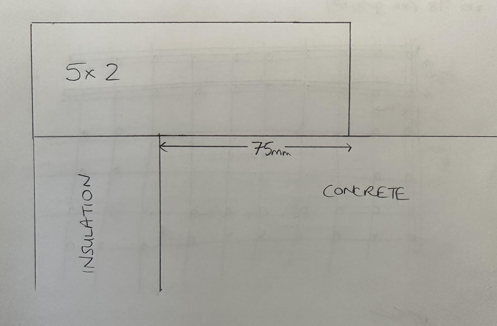

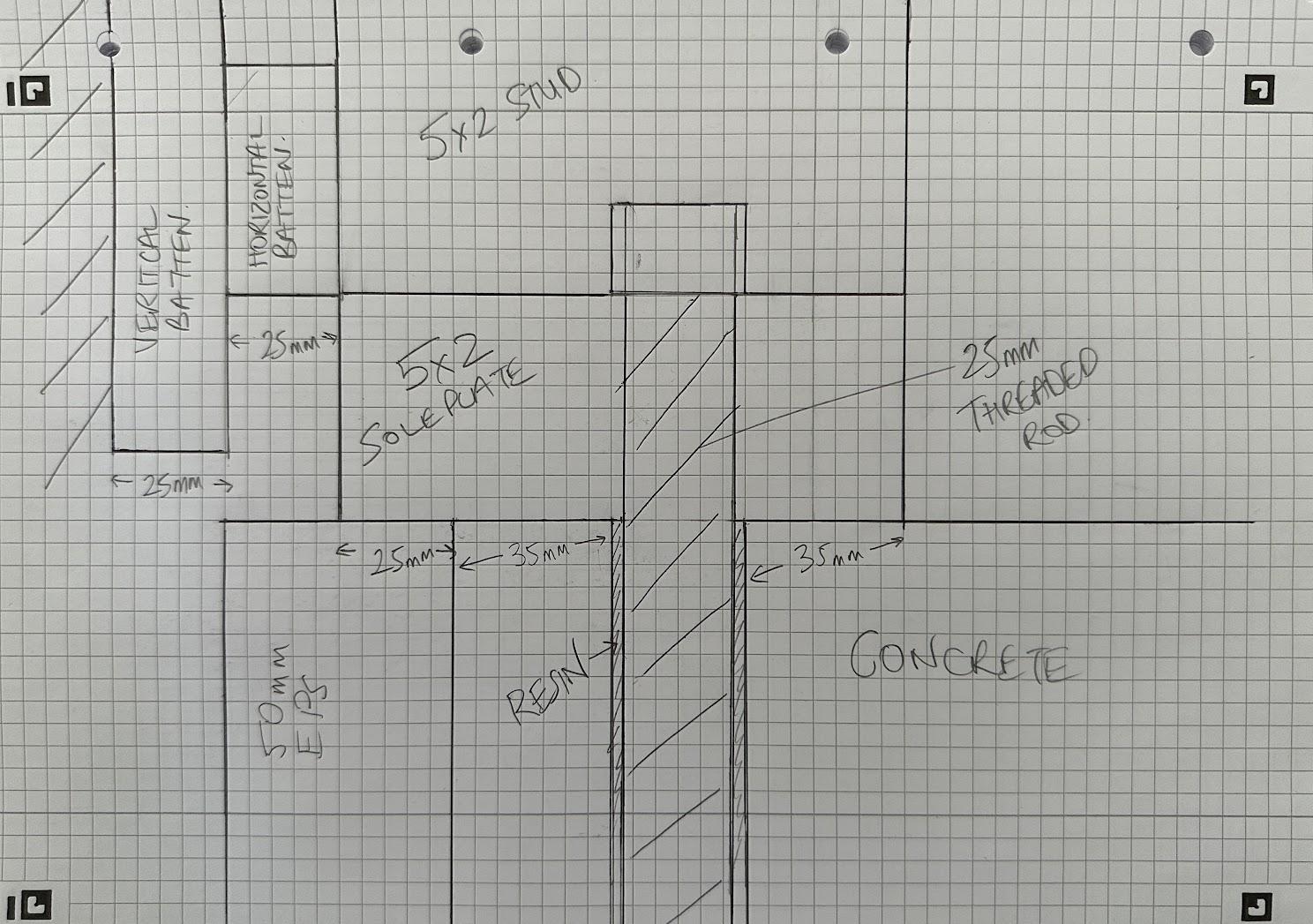

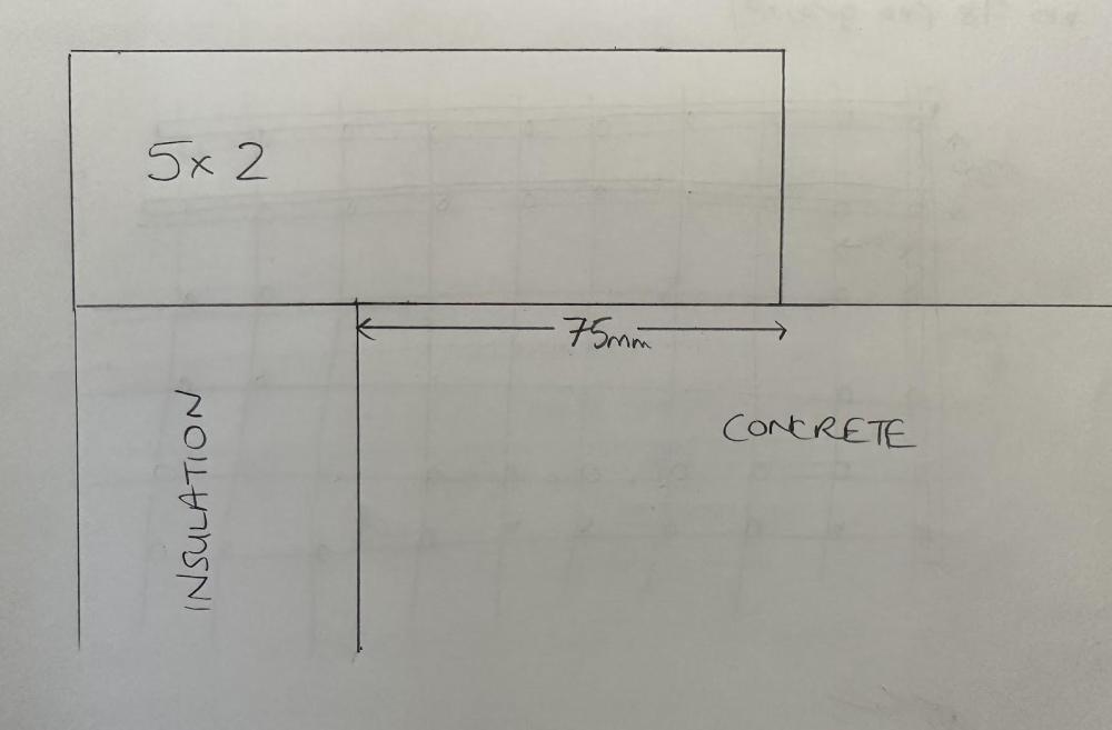

@Nickfromwales You say heat it 'somehow' - you feel it's not going to be easy to heat with anything 'above' the concrete? @saveasteading I'm definitely open to options when it comes to fixing the threaded bar/bolts - think I've seen the epoxy approach on Oakwood Garden Rooms. My concern in drilling once dry was that i'd be close to the edge of the concrete and don't want to cause it to 'blow out'. If I have 5x2 soleplate, 50mm is covering the upstand leaving 75mm over the concrete. Image below is to scale. Would aiming to fix the threaded bar, in the middle of that 75mm (approx 37mm in from the edge) be about right? And how deep does it need to go? I'll have to make sure I'm not hitting any rebar/mesh too -
