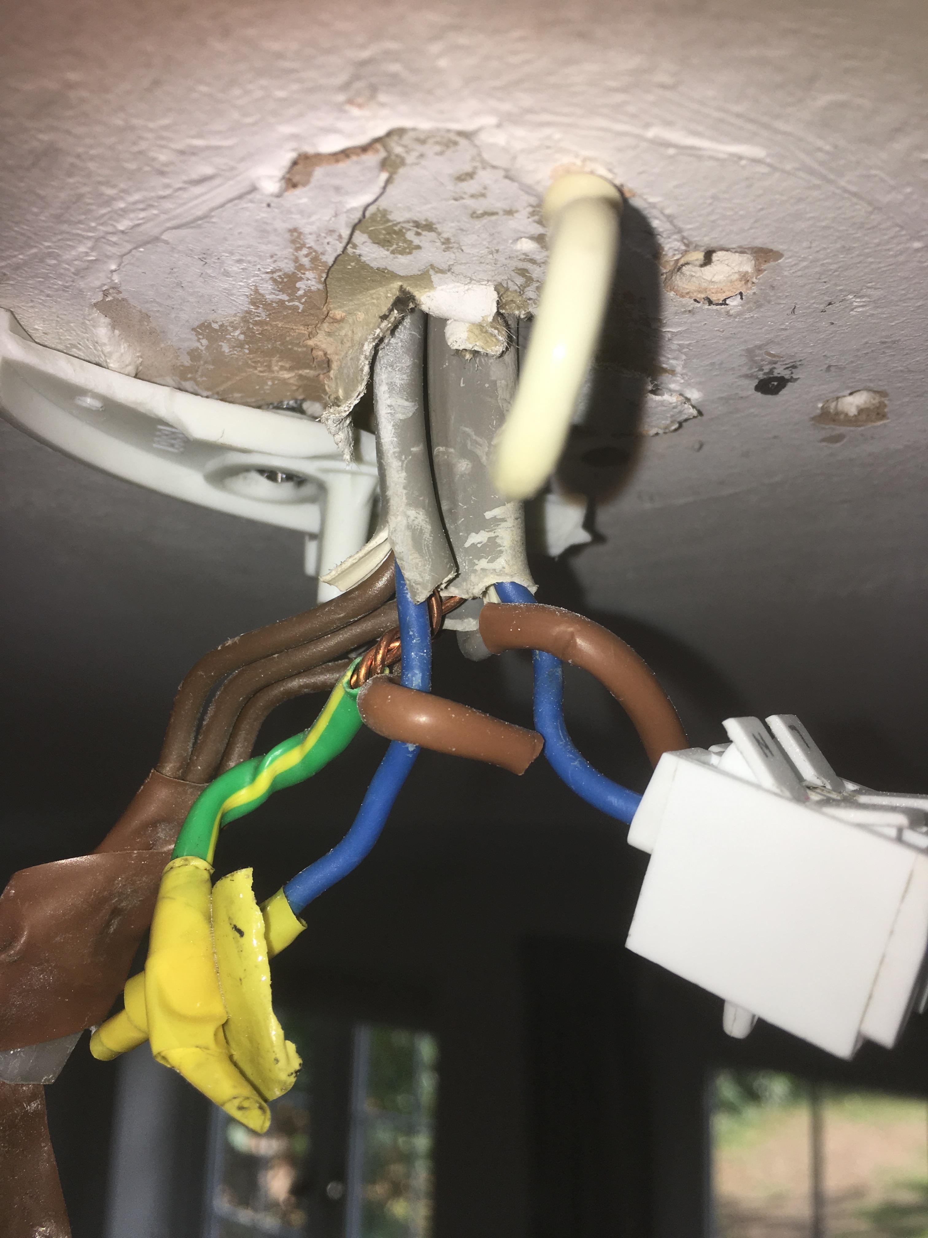

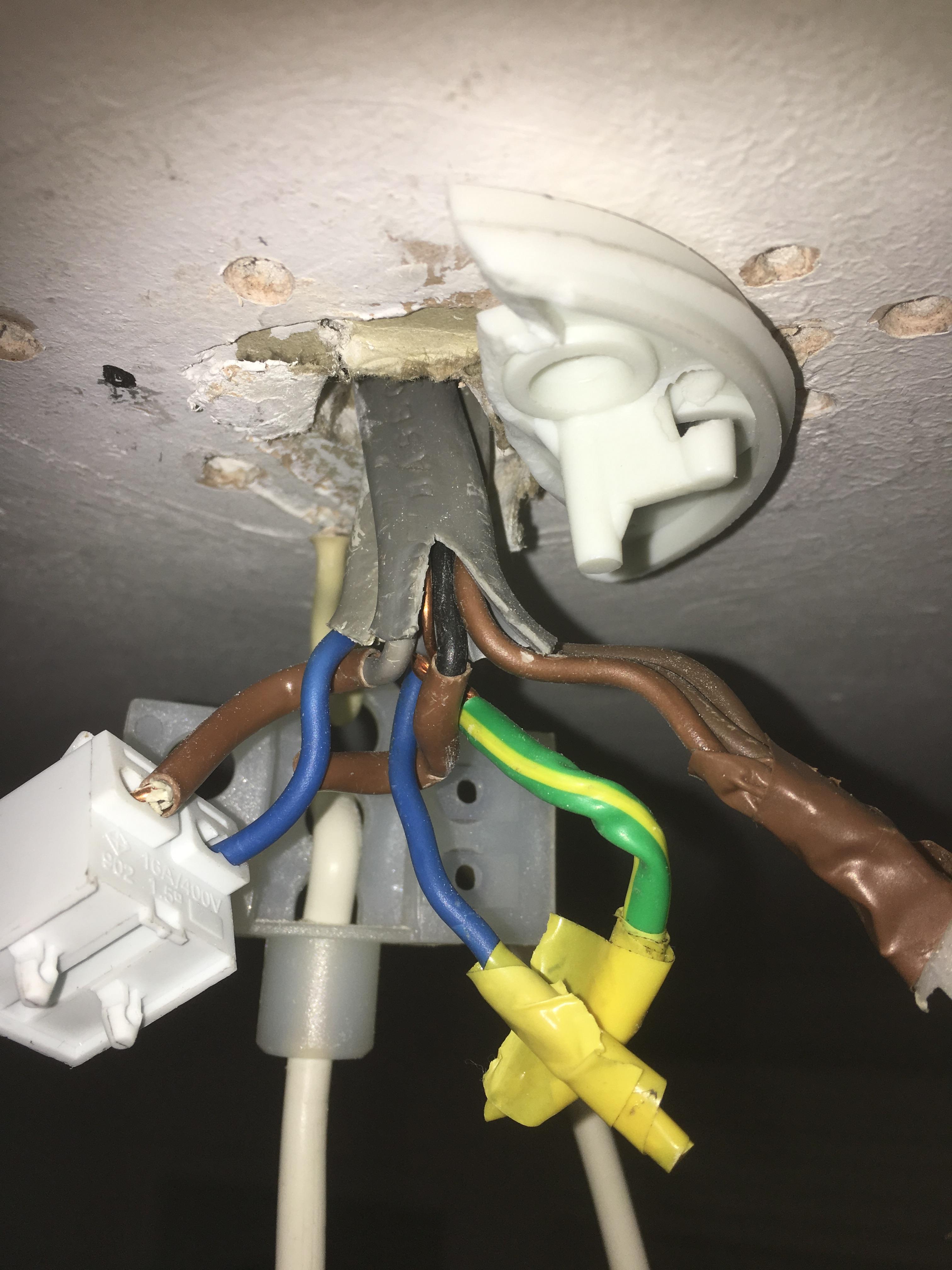

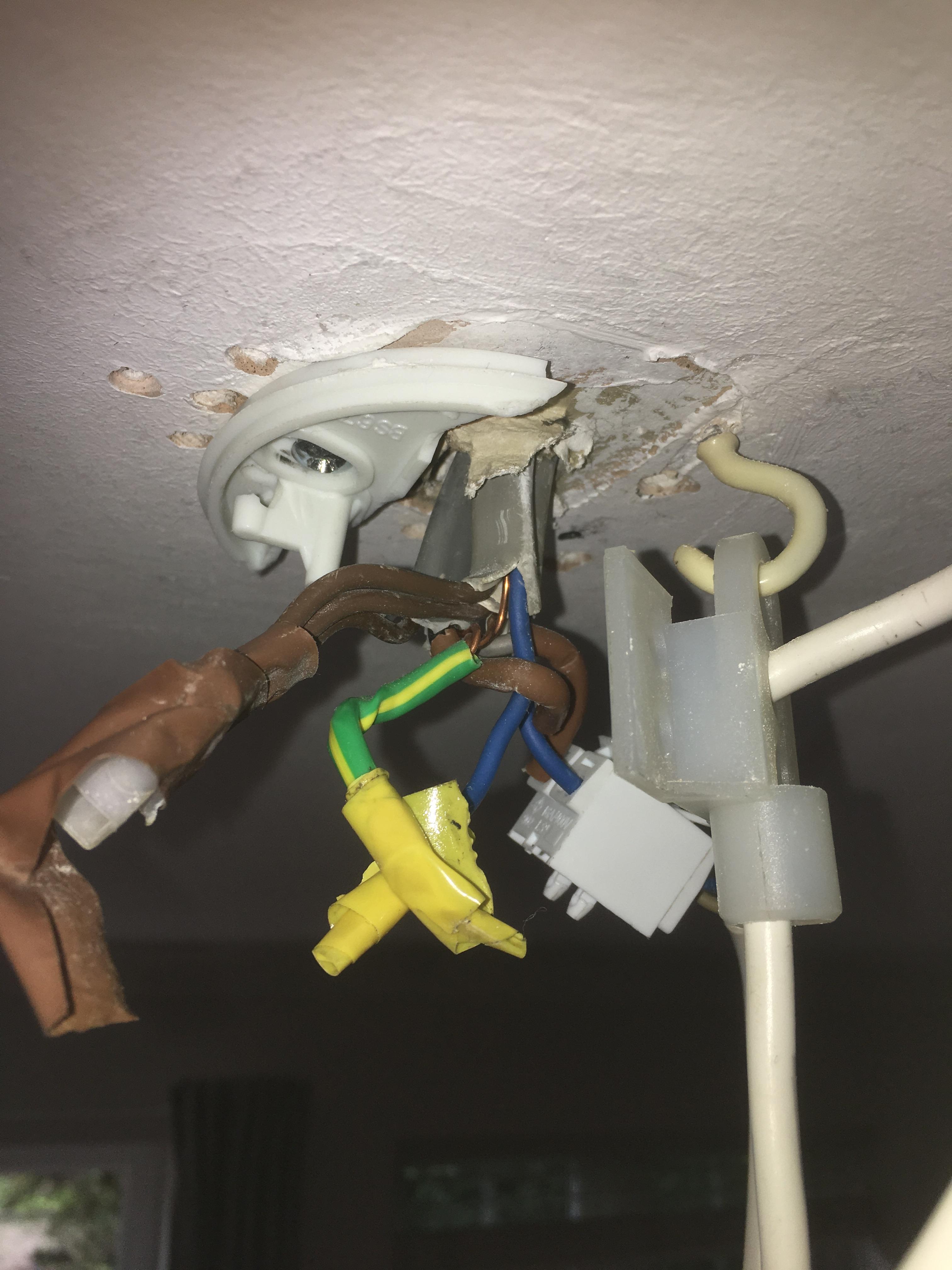

    Light not working
    To ProDave and everybody else who helped me here, thanks so much! All works a treat now and no more loose wires about! Wago connectors worked brilliantly! Open neutral it was indeed. Whats great is that I have also learnt something in the process.

    Light not working
    Hi all so for interest, this is what’s under the light fitting: 3 wires coming in from the ceiling: 1: - Live (terminates in terminal block) - Neutral, not connected to anything - earth, not Connected to anything.. 2: -Live (terminates in terminal block) - black wire with brown sheath (not connected to anything) - grey wire with brown sheath connected to live of light 3: - live (terminates in terminal block) - neutral connected to neutral of light - earth All three earth wires appear to be twisted together and sheathed into one. The switch for the light has two switches. One works the light with no problems and the other does nothing (was used to operate the fan) The only two wires I disconnected when taking the ceiling rose off was the neutral and earth from wire 1 above. See pics but not sure you can make out much from them.

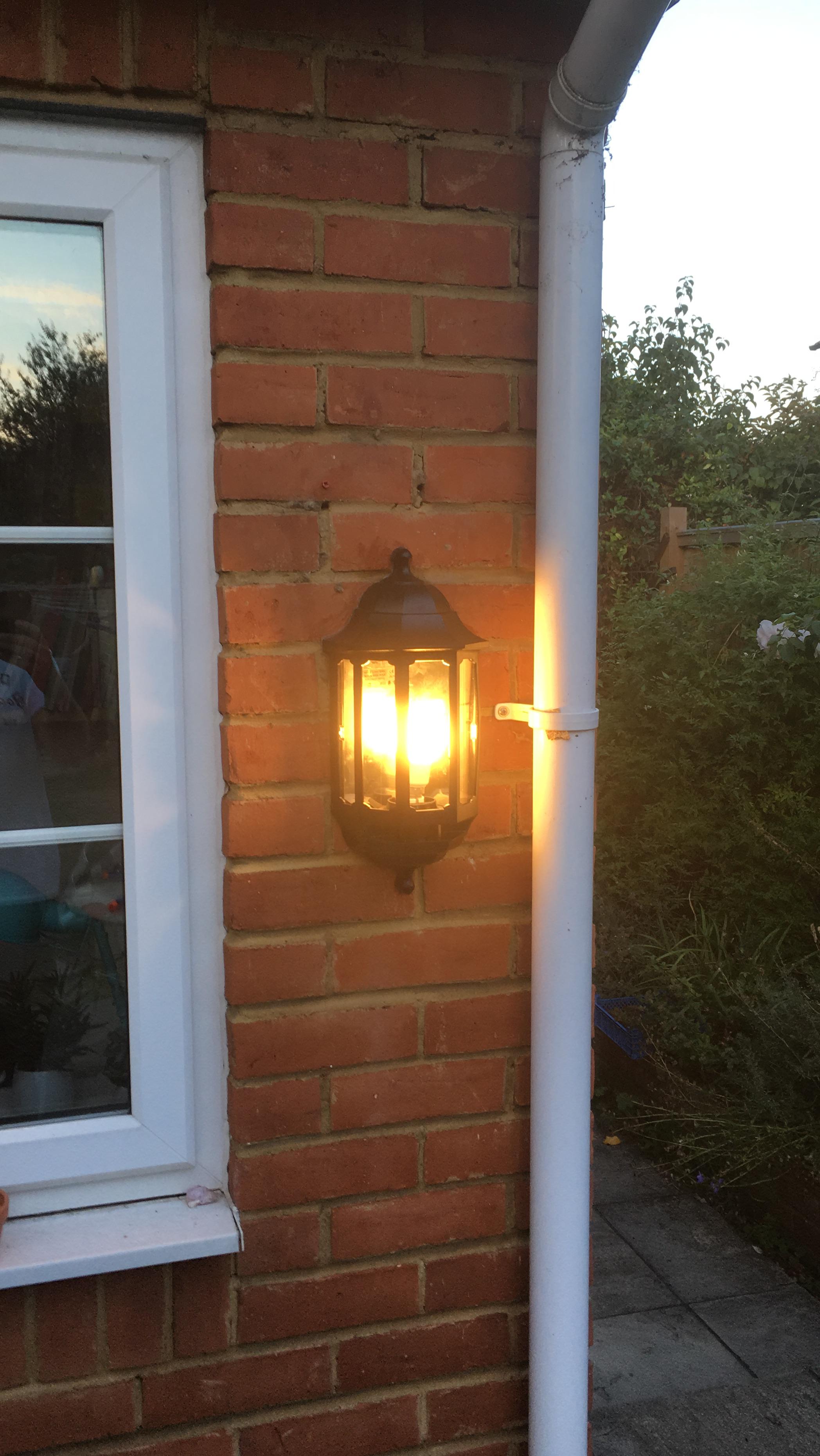

  8. Wes
    Light not working
    Apologies for the confusion ProDave - I posted that as it is the switch controlling the faulty light outside. Will take pics of the inside light and switch tonight.

  10. Wes
    Light not working
    Yes, that was the switch to the outside light. Looking at the indoor light where I believe the problem is, there used to be a ceiling fan and light there when we bought the house. There is a two switch unit where one switch works the light and the other used to control the fan...but now does nothing as fan is removed.
