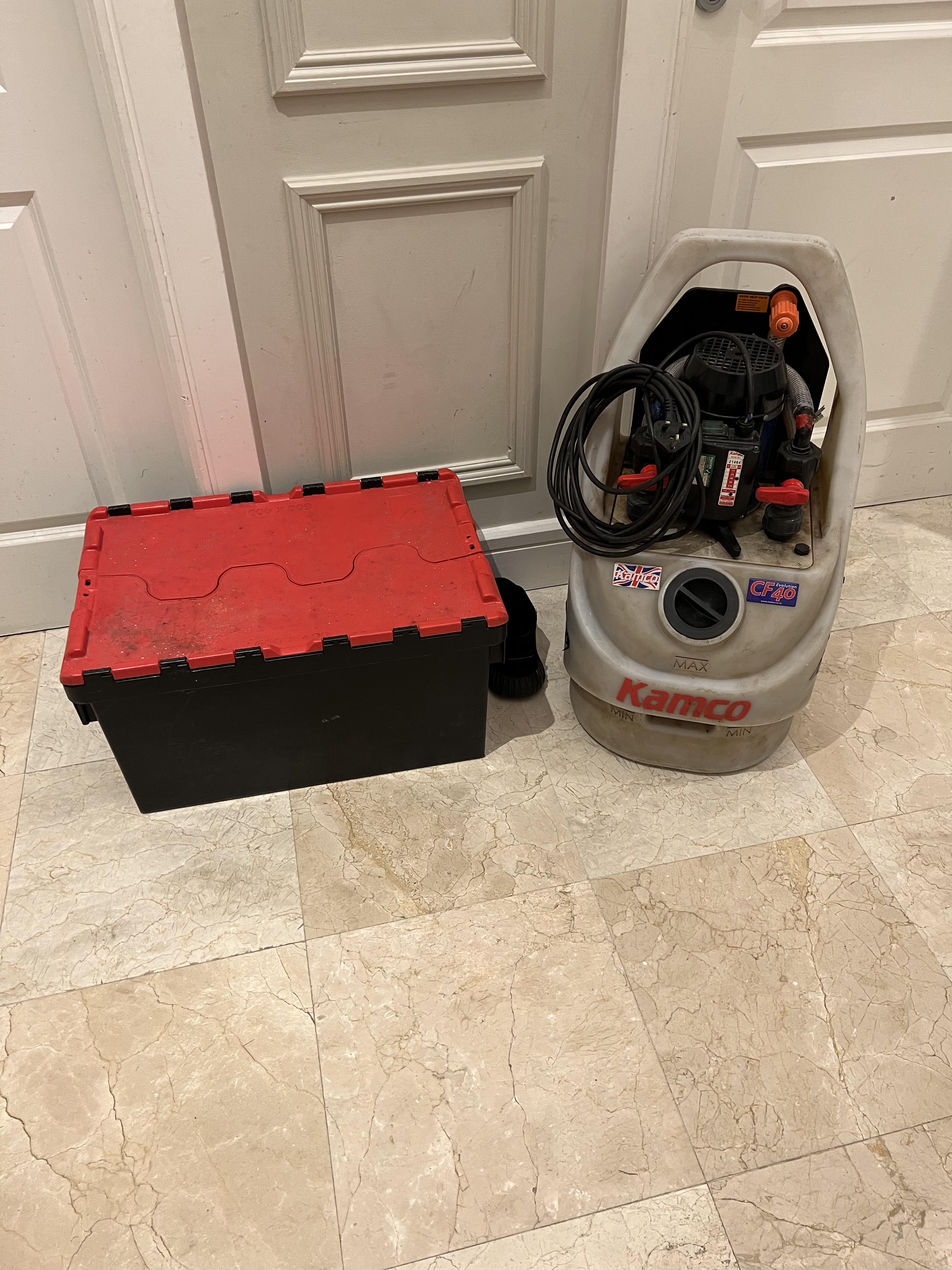

  1. Rented this for the weekend, €90 quid, it’s the same one Urban Plumber uses.
  2. I’m in a different country but I’ve watched a lot of his videos over the last two months. Impressive operator!
  3. Using Stelrad radiators, 17 years old. I know the answer as I type this.
  4. New boiler install, had a power flush two years back and had a Magna Clean installed. Rads heating well, does the system need to be flushed again before the new install?
