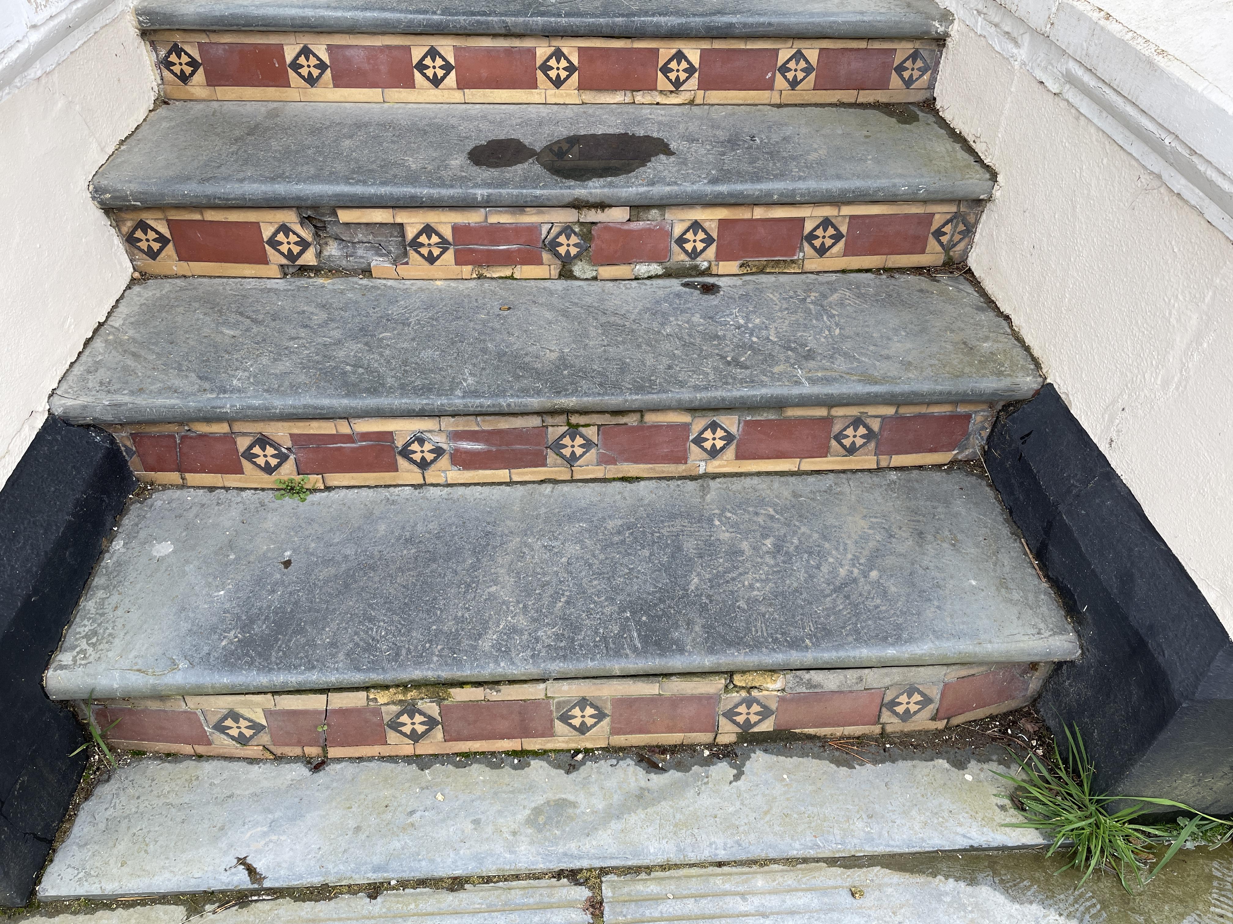

  1. The photo shows our front steps which are probably Victorian. The risers of the bottom three steps but not the top one have blown outwards cracking and loosening the tiles. A number of questions. Am I right in assuming this is due to water penetration causing expansion of the substrate below each step? How far back should I go excavating below each step before rebuilding the riser and laying the replacement tiles? I will probably leave the top step/riser undisturbed and just replace the two broken long yellow tiles. Should I assume I will not be able to recover any tiles intact from the bottom three risers when ordering replacements? Any further tips?
