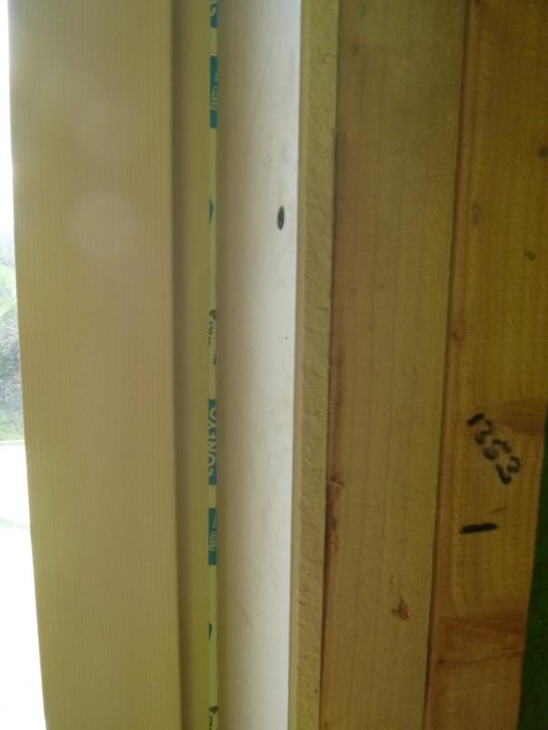

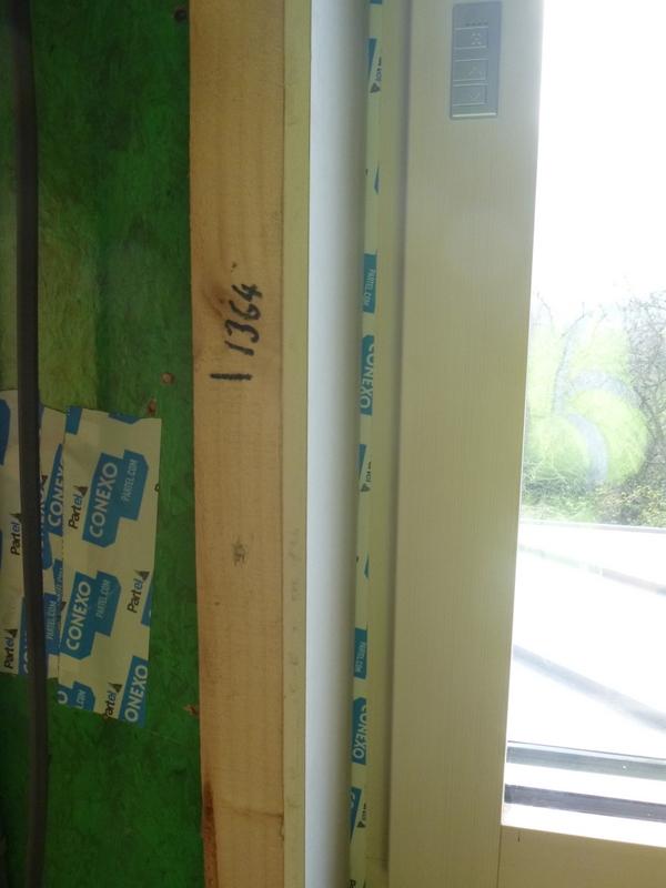

  16. Thanks all - a few things to try.... Sadly it's been on a good while for a variety of reasons that I won't go too far into. Attached a couple of pictures. We did try peeling it back and scraping off the glue - but it was such fun that is what sent me to the forum.... Windows are prefinished and it feels pretty vulnerable As an aside it's hard not to worry about relying on the tape - it's surprisingly easy to put holes in it - in particular where it's stretched across corners - I made the mistake of running my finger along one area and left a nice cut along the length with my nail (and the nail is more building site than catwalk).
  17. Hi there just in the process of putting plasterboard in the window reveals and finding that the taping is somewhat variable.... In some places the tape will be hidden by plasterboard but in most it sticks out well beyond the board. Some of it might disappear behind skim but I am not sure how well that would work on tape. We don't have the space to put another board on without fouling the window opening (inwards). Is there a foolproof technique to cut back the tape that's generously stuck to the wooden (pre-finished) window frames and clean away the very sticky residues? Appreciate any advice (other than make them more careful with the application of the tape which is true but redundant) Cheers
