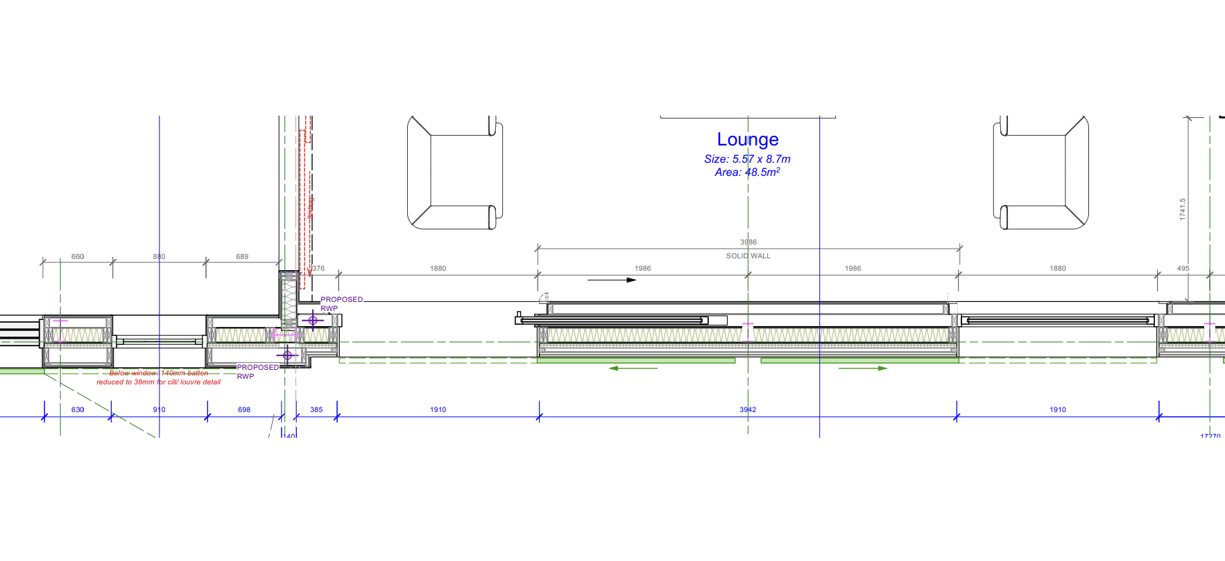

Hi all I the attached drawing, is it possible to reorgaise the wall buildup/insultaion in order to move the door/pocket, out one layer?
