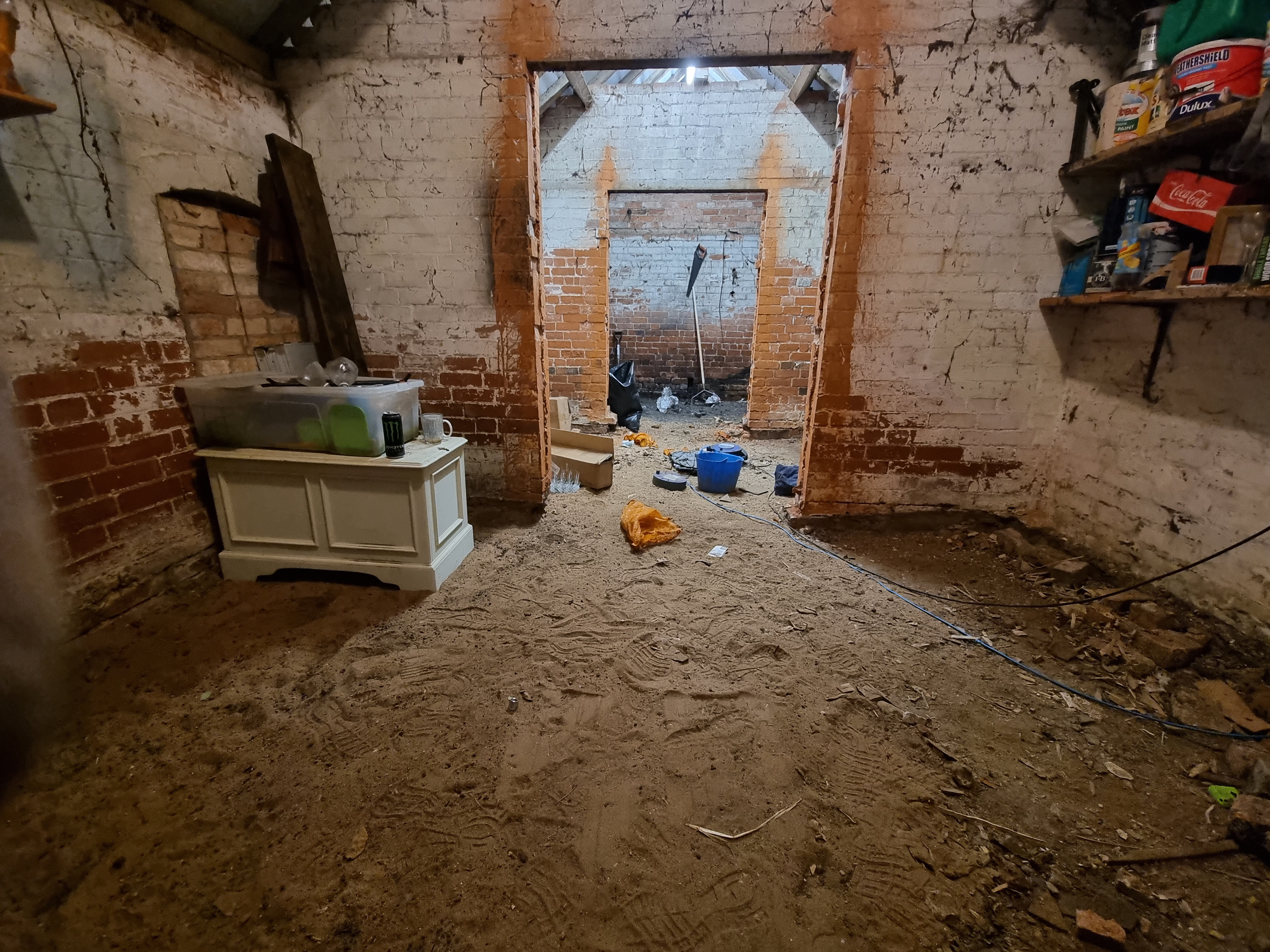

  4. I will take a look at the floor tonight and see if I have the height. I don't really need to keep the room warm as it is a gym and wont have any heating anyway. Its more about damp control. Ive been in there recently and everything was damp and the electrics had cut out because the moisture was so bad. I think it was due to a sudden change in temperature outside. There are no doors at the moment, we took them off as they are just thin wooden stable style doors where the top and bottom open independently on a gate latch. I also need to keep the sound down as we want to play music in the gym and at the moment you can hear music outside really clearly. I am hoping that with insulations and proper doors we can reduce the noise outside.
  5. This is the room today with the delivery or plasterboard in it.
  6. Damn, wish I had done that. The floor is down now.
  7. Thanks for the help. So with this I can get an R value but what about moisture and air flow between the insulation. I have read that air needs to get between the insulation and the roof tiles as that it vents. I am worried that if I get this wrong then I am creating a problem that can rot the structural wood.
