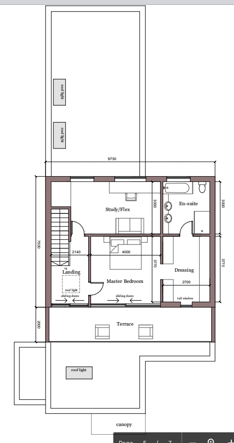

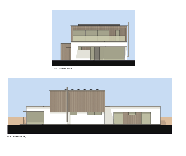

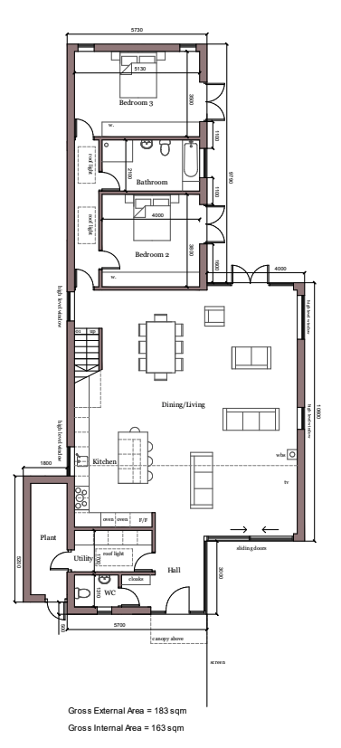

  3. Catching up on the comments. Firstly yes more than happy to take feedback, its good to get alternate views. Why glass at front? - Yes front area will be the useable garden - a courtyard garden south facing, so we want to make the most of the view from in the living area. Why so much on ground floor with limited upper floor? - A couple of reasons, 1. we dont want to overpower the existing property as we will be selling that once build is complete so key to have minimal impact (on reslae value whilst delivering what we want in new build). 2. We will move into the new build and expect it to be where we will live out our later years, so ensuring we will have all we need to be comfortable on the groundfloor should stairs become an issue. Large living space? - yes its big! Today we have Kitchen,+dining room plus a Living room which together make a similar size, We have big furniture! We are also doing more detail on how to best use the space and maximise Kitchen furniture. The planning pictures are for planning approval and dont reflect how the internal furniture will necessarily be placed Narrowness of corridor on bedroom block? - Good point I hadnt really considered it as narrow will revisit. Please keep the comments coming
  4. All thanks for the feedback. I do like the MBC approach I guess it will come down to cost, awaiting quotes.......... Wrt Solar and batteries, its early days im still investigating and no doubt will adjust as I learn more. Yes its a large open plan downstairs, primarily it will be just me and the missus so challenge on us to keep tidy and adapt appropriately. Re light there is a lot of glazing to front (south facing) and double aspect with large windows/doors to rear complimented by high level windows to right and left so fairly confident well be good!
  5. Thanks for feedback, Yes we engaged an Architect outlines of build below;
  6. We have decided on Flat Roof to keep house line below that of the existing house (ease of planning acceptance) and not to devalue existing house too much plus we like the contemporary design that it affords. Re Battery storage I was advised by large eco installation company that the ASHP would use the energy at a rate that meant the battery would generally not be efficient. No decision made yet, will continue investigation. Thanks
