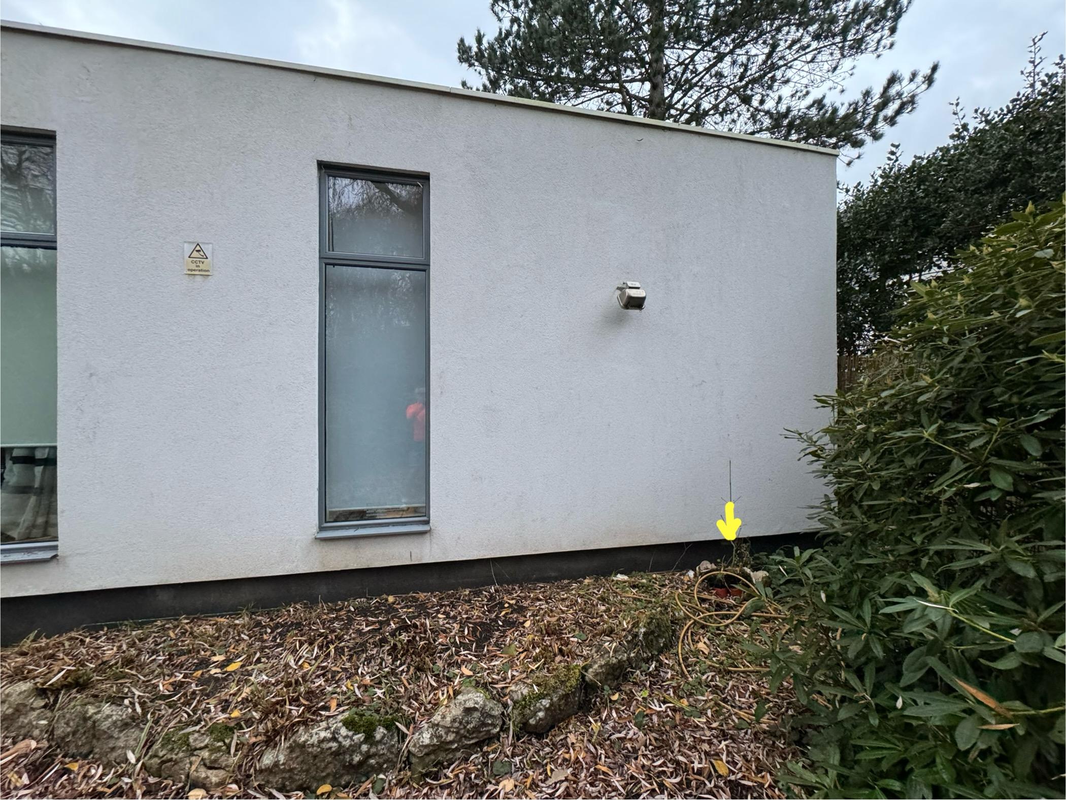

  2. I've no interest in an external but enclosed area, but put in the application with the handrail present because I've never seen "external but enclosed" being a criteria for anything. Do you have a source for that?

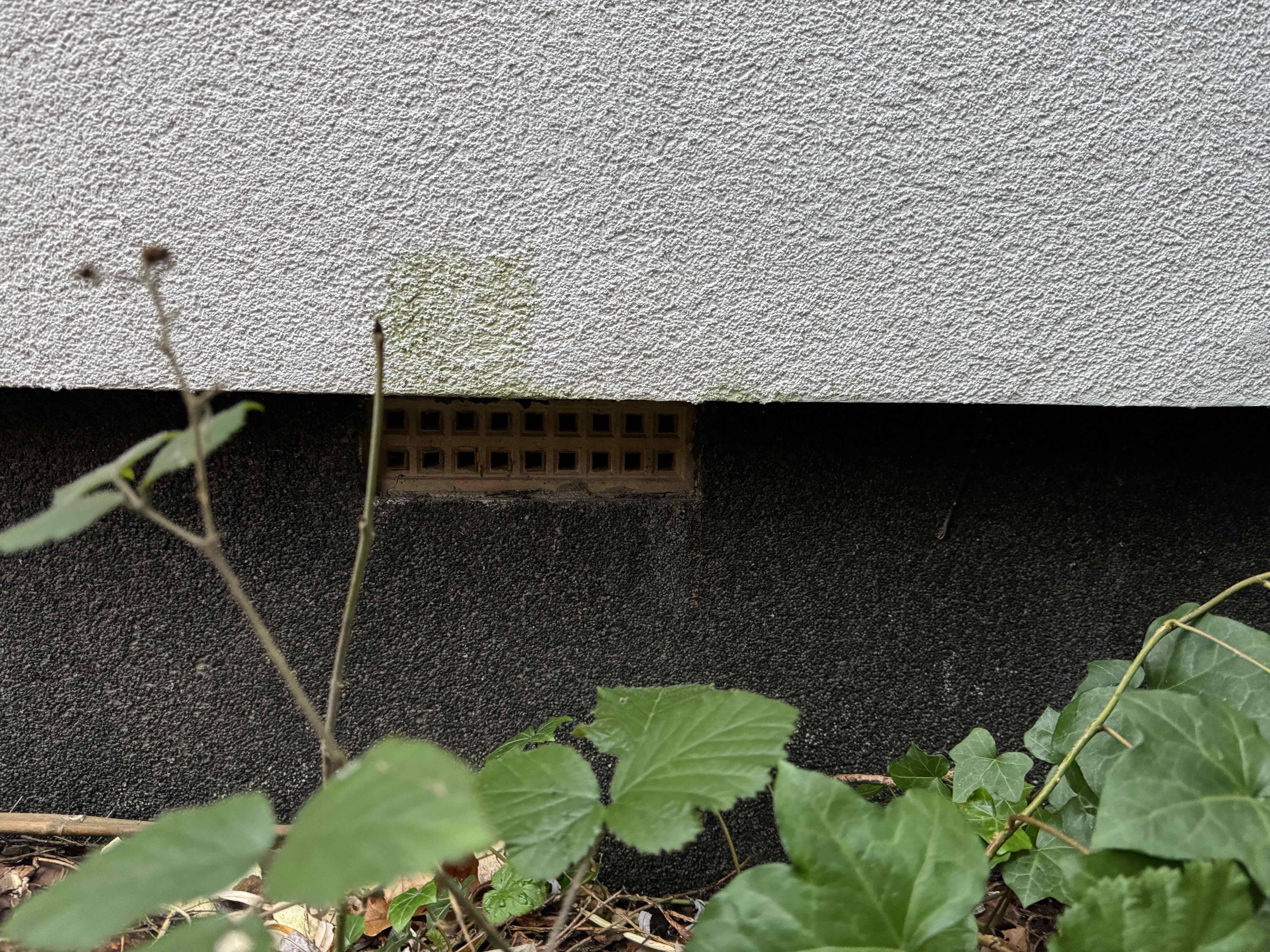

  4. Thanks again for the comments. I've found an old letter from during the build saying the building guarantee's surveyor insisted on "sub-floor ventilation" against the wishes of the builder and architect. Building control's project manager said "sub-floor venting can be omitted provided precautions have been taken to remove the possibility of organic matter being present" and it says this was done. So I'm going to block up these vents at least temporarily and see what effect it has on my problem.

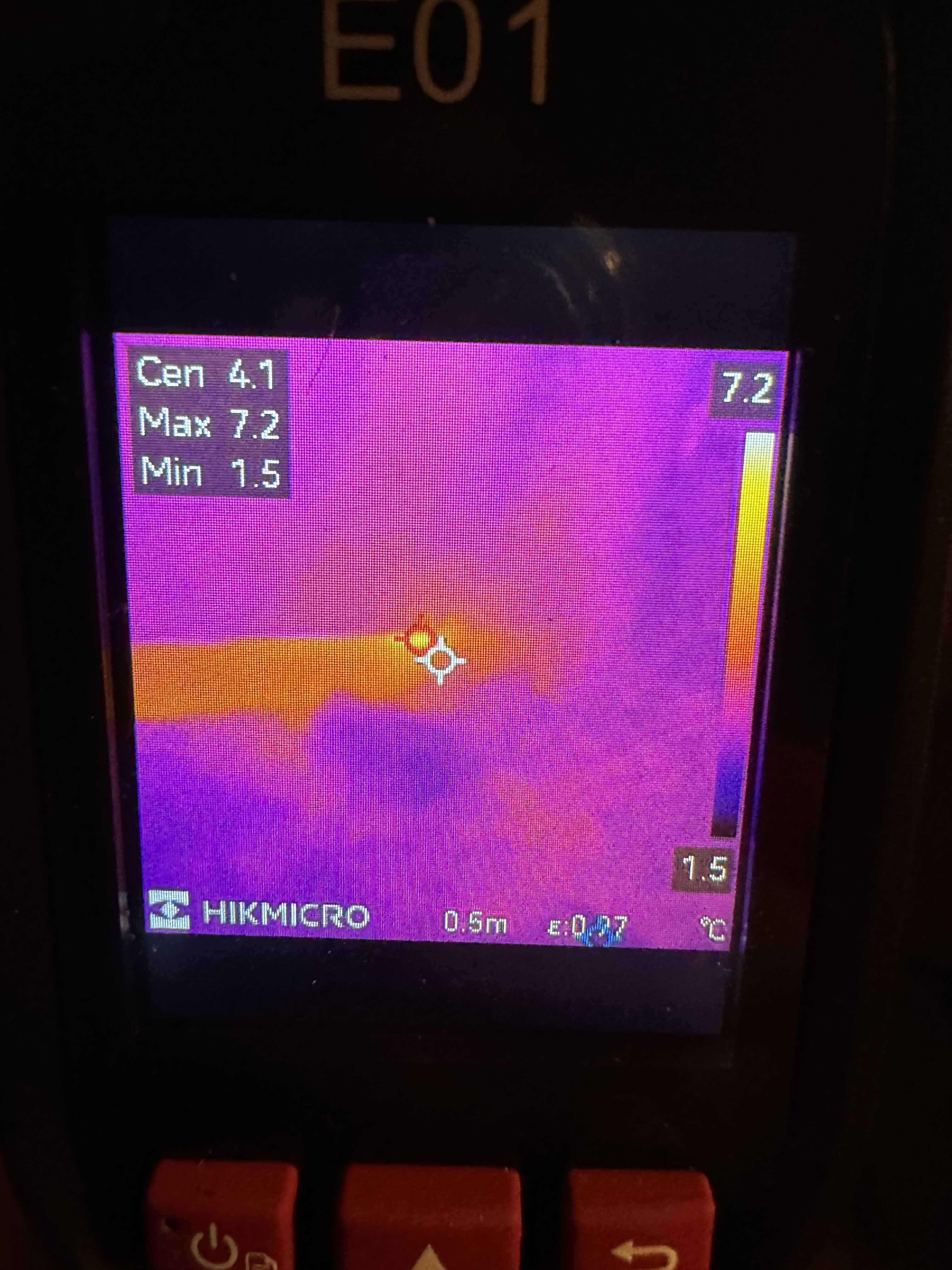

  5. No way for me to know unfortunately. They’re carrying 60 degree air at 1600m3/h so it’d be surprising if there wasn’t significant heat leaking out either way.
  6. I now realise I've omitted to mention an important piece of the jigsaw — the house is heated by hot air blown through metal ducts that run deep under the floor, about the level of the duvet. So that could explain the necessity of two insulation layers. Thanks both for emphasising the need to seal the inspection hole, which I will, but the cooling caused by the hole is nothing compared to whatever is cooling the bedroom at the other end of the house where the foundation is exposed.
  7. Can't find any pics so just opened up the little hole in the floor I made a few months back. Quite a breeze coming up through the hole but it's not cold. Can confirm there is insulation on top of the beam/block floor (like a Kingspan kind of foam), with 2" screed on top of that. The duvet I'm talking about is much lower down.
  8. It was built by the previous owner, whose wife was taken ill during the build and later the construction company went bankrupt. So although it's supposed to be a passivhouse (certification was refused only because the internal garage door isn't up to spec), the thermal performance is not great and there are problems of poor detailing in all aspects of the house that I'm slowly working through
  9. Right! This might be the nub of it. My floor is made of concrete beams; I had to break through one earlier in the year to look into a drain problem and about 1.0m under the beams is the insulation duvet (the drain under that). When you say cold side, that would be another layer of foundation under the duvet?
  10. Hello, My SIPs house is built on a slight slope, and end of the house where the foundations are exposed there are two air bricks, which I think are losing a lot of heat in today's weather. I'd forgotten they were there but the thermal camera shows them up. When I say foundations, I mean a space about 1.0m high which runs under the floor throughout the house, below SIPs level. It has a layer of thick insulation duvet at the bottom. I've attached a couple of pics. Can anyone more experienced with SIPs construction (or perhaps just construction generally) comment on why these air bricks are there, and whether I could block them up to keep the heat in? One of them is under an open-plan space, but the other under a bedroom and if you leave the bedroom door closed the room never warms up despite receiving the same flow of warm air as other rooms. There could be some other reason for the heat loss but the air brick seems the most likely cause. Thanks for any help!

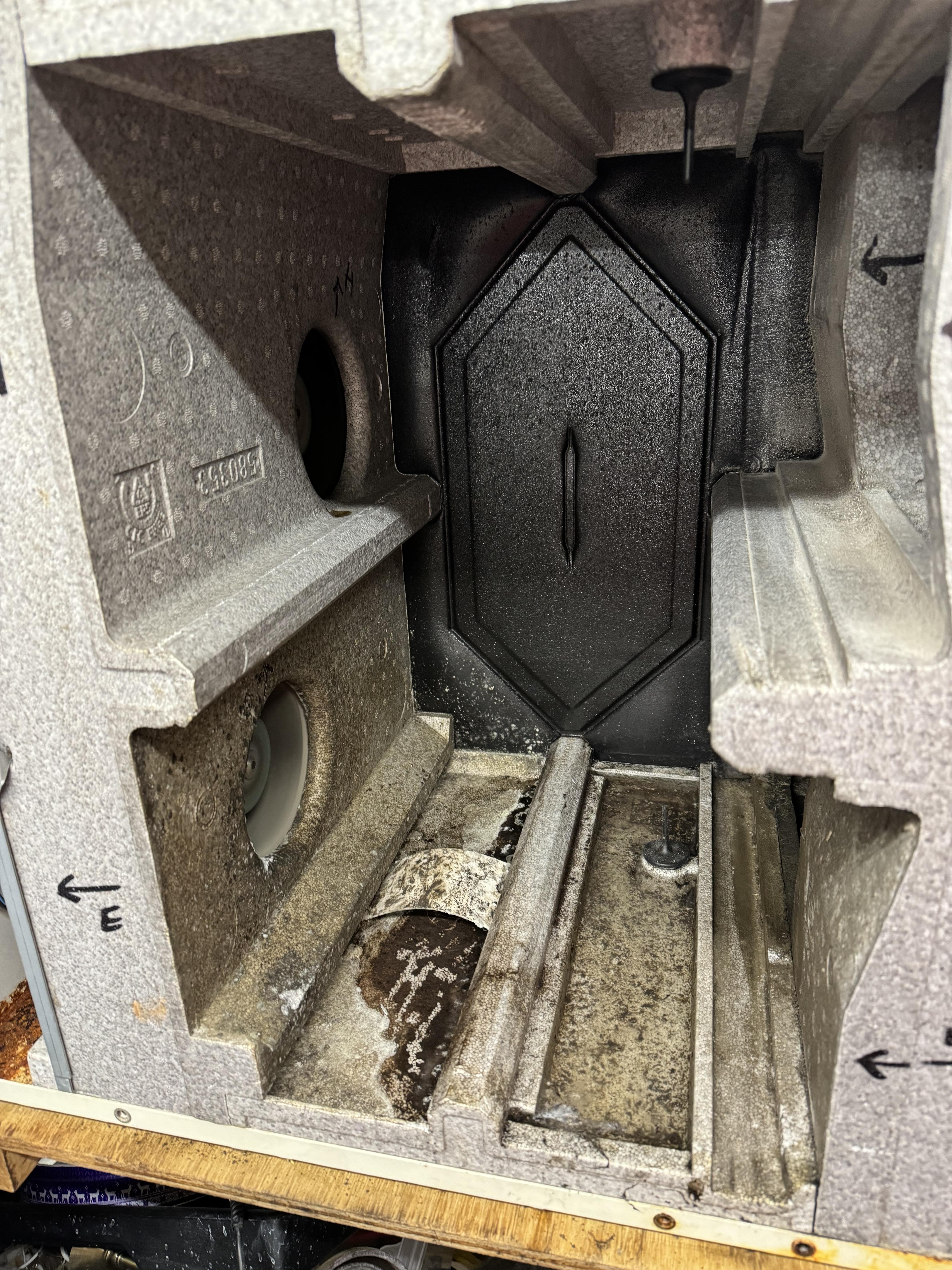

  11. This is terrifically helpful, thanks Jack. Was preparing to order a new unit but will get this sorted. In other news, this afternoon I’ve discovered that my MVHR barely works when the gas air heater fan is on. And that fan has been on for 15 years…
  12. (Apologies, looking through my posting history, I posted something very similar four years ago! At the time @jack mentioned a possible fix which Brink had applied.)
  13. Not a pretty sight is it? The exchanger is covered in mould on the same side as the condensate drain. It could be this has something to do with the house having combined MVHR and hot air central heating, which has been discussed a few times on here recently in less than glowing terms. The bottom right section is where the external air comes in and the bottom is full of water. That side doesn’t have a drain. Bottom left is where the air goes out to the outside. There’s a bit of water and mould there but the drain is working (I just poured 2L down). But lots of mould on the exchanger in that quadrant. I hadn’t looked inside for a year or two, when I fixed a problem with the condensate drain freezing up. That’s all fixed now and anyway it hasn’t approached zero this winter yet. Any pointers please? Just as a sanity check… it seems weird that the bottom two quadrants are external air and the top two are internal air, shouldn’t the air streams cross over in the exchanger? This is a Brink Renovent HR, paired with a Brink Allure gas air heater which blasts air around the house at 800-1,350m3/h even when the heating isn’t on. Obviously looking to get rid of the Allure and switch to some form of heat pump, probably an air to air one separate from the MVHR based on the comments on here. Thanks for any thoughts especially on the pooling water issue.
