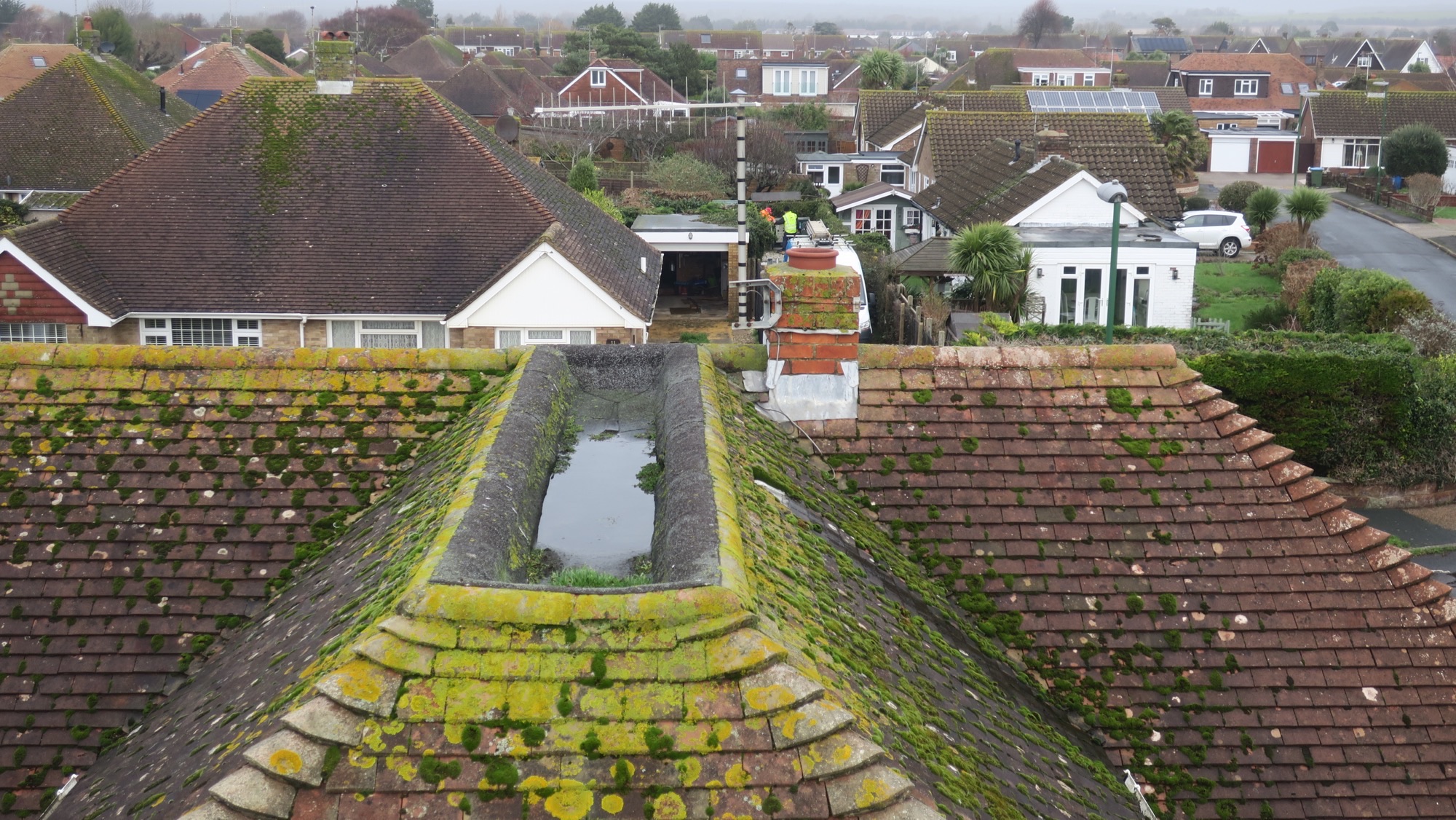

  1. Thanks for the feedback it’s much appreciated slap my wrists here for any typos/punctuation too 🤣 Good idea re requesting help in area as a new topic personally I’d love to sort it out with a proper apex but not moved in yet but get the impression there’s a few curtain twitchers and we’re planning an extension so I suspect we may not get away with that!!!
  2. Thank you from the internal pictures the timber that lay under the gully part are damp but none of the main roof beams that go up trusses not sure of correct term however planning won’t let the roof line go any higher and my thoughts were to push for or pay difference to have flat roof but agree I’ll ask for an independent quotes as were relocating down from Herts so I don’t have any contacts down there neither do my parents who live in the area
  3. Buying this property extension at back has this gully when built 77ish to enable headroom so survey done roof is leaking and beams under it are damp ones black. Owner now in home son has been made aware sending out roofer to look at it to quote for fix which I’ve requested prior to exchange surveyor told me to get gully replaced for flat roof rather than unblock/fix felt I’m keen for a proper fix would you say this best as I’ve never seen this type of roof before? Also this is on south coast about 0.5mile inland from sea and the forward view of other houses is north facing if this helps.
