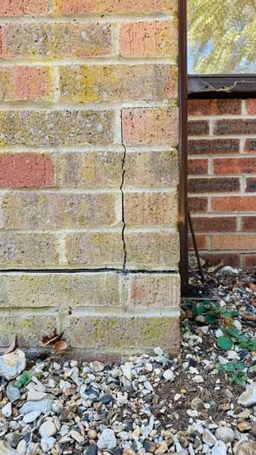

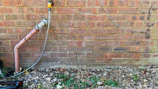

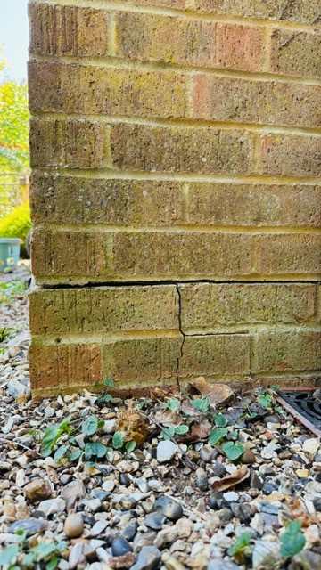

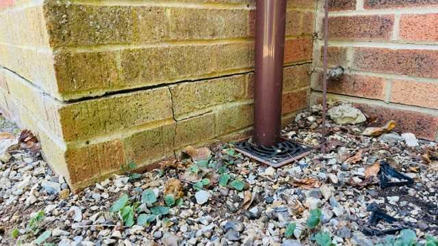

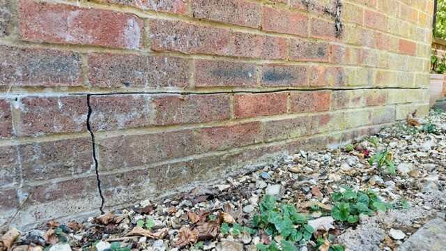

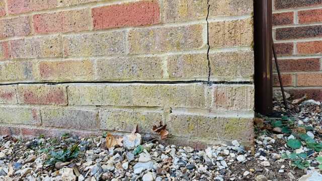

  3. Hello all, I'm looking for some advice and where available, professional opinion on right course of action. Some context - We bought our 1980s mock-Tudor house just over 3 years ago and since being here, have come to terms with the house having small seasonal movement with some small internal cracks around the house. Neighbours have also reported the same, with the cluster of houses having been built on the site of a long-standing mill, which we know is largely clay. Last summer, I noticed on one of the rear corners of the house some relatively fine vertical cracks in some bricks, when then ran horizontally along the damp proofing until it dropped down to ground level around 1-2 metres from the corner on either side. A conversation with a local SE suggested to monitor it over autumn/winter and come back where it worsens. Fast forward to now - where we've had a very warm spring/summer, as well as digging out a very mature hydrangea from the same area, the cracks have become considerably wider and in places and are really becoming a serious concern. I'll admit I'm a serial overthinker, but having browsed a number of threads on this topic, I'm pretty sure this is an issue which isn't typical of the build or weather... Worth noting here that on both sides of the area in question, there are drains. Coupled with the hydrangea planted where it was, part of me thinks that one or both drains have become damaged and what I might be dealing with is some significant erosion of soil. I'm not entirely sure where to begin however and would welcome suggestions from those who deal with these types of issues or have experienced similar. Photos included and any suggestions or initial thoughts would be helpful. Thanks in advance.
  4. Thanks for this Mark. IT does certainly look like there is a weakness in this corner. I've asked a couple of local chartered firms to confirm availability so I can get someone to look at it sooner rather than later. Appreciate the input.
  5. Good morning everyone, I have a number of cracks in an 80s mock-tudor house I purchased a few months ago. Those which were visible to us and the surveyor at the time of purchase were not of any major concern, but some which have been filled or previously repaired are returning (my assumption is due to construction type and age and some typical movement, but others are larger than I'm comfortable with) and I'm trying to ascertain the right professional to contact for a more detailed survey. My thoughts are initially a structural engineer or reputable firm, but I'd welcome others' thoughts as it could be that there is a better starting point. Photos of some of the worst offenders are attached which is on both sides of one corner of the house. I appreciate the support and as a newbie am turning to others for the help as this is way beyond my past experience! Craig
