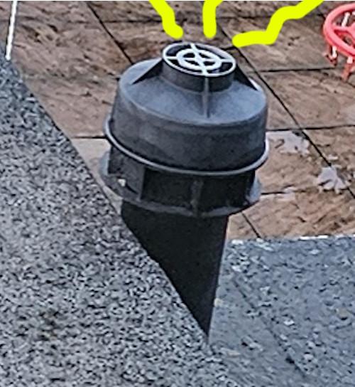

Rehan Saeed replied to Rehan Saeed's topic in Ventilation
Yes, this seems like the best solution. Replacing the vertical pipe for a longer one seems like it'd be a simple enough job. I'd probably also have to offer to get a professional tradesperson to do the work, what trade do extractor fan ventilation fit under? I've tried searching for these types of vent kits on screwfix or toolstation but can't seem to find them. What should I be searching for? -

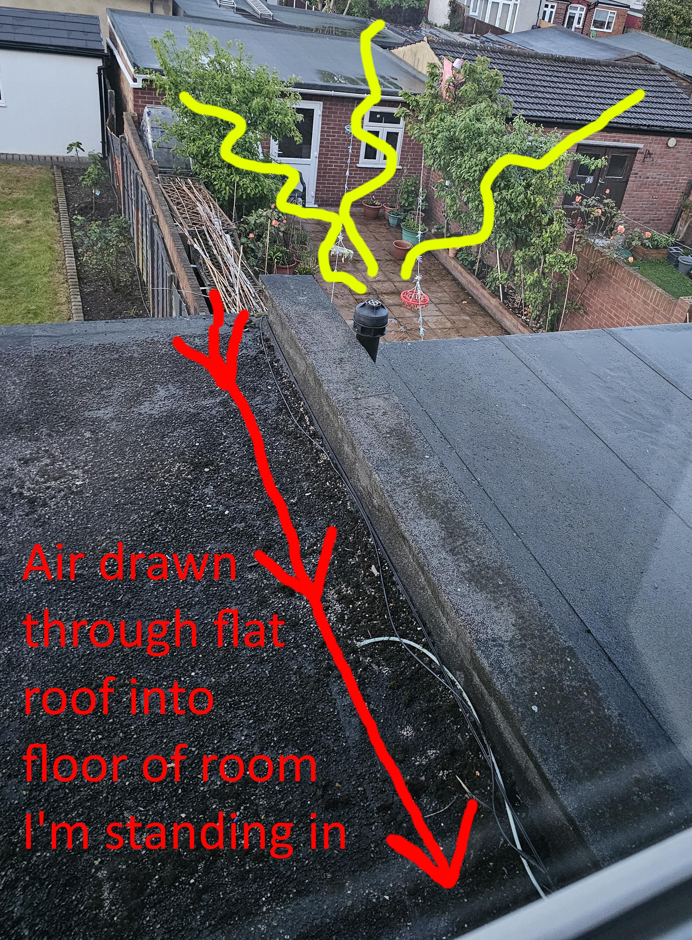

My neighbors kitchen extract vent is beside the flat roof of my ground floor extension and the smells can somehow be smelt inside one room of my house. I closed all windows and trickle vents but found that in one corner of the room the smell was literally coming up through the floor. I know that the space in my flat roof and the floor of the first floor bedroom are connected, so I think the smell is being sucked up through the flat roof, into the floor of the main house and up through the floor boards and into the bedroom. I can't see any vents in my roof or the overhang of the front of the flat roof, so I'm not sure where the air is getting in from. I need to have a word with my neighbor but what can I suggest to him as a solution?

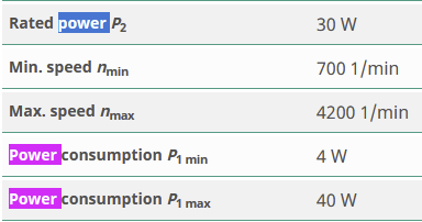

I have a Grundfos Alpha 3 pump in an underfloor heating manifold and Nest thermostat all connected up in a wiring centre. From what I understand the pump is wired with just a live and neutral. Is the pump supposed to turn off when there is no demand from the thermostat? I still hear it turning and see that its using around 4 watts of power. How is the pump supposed to know when to turn off?

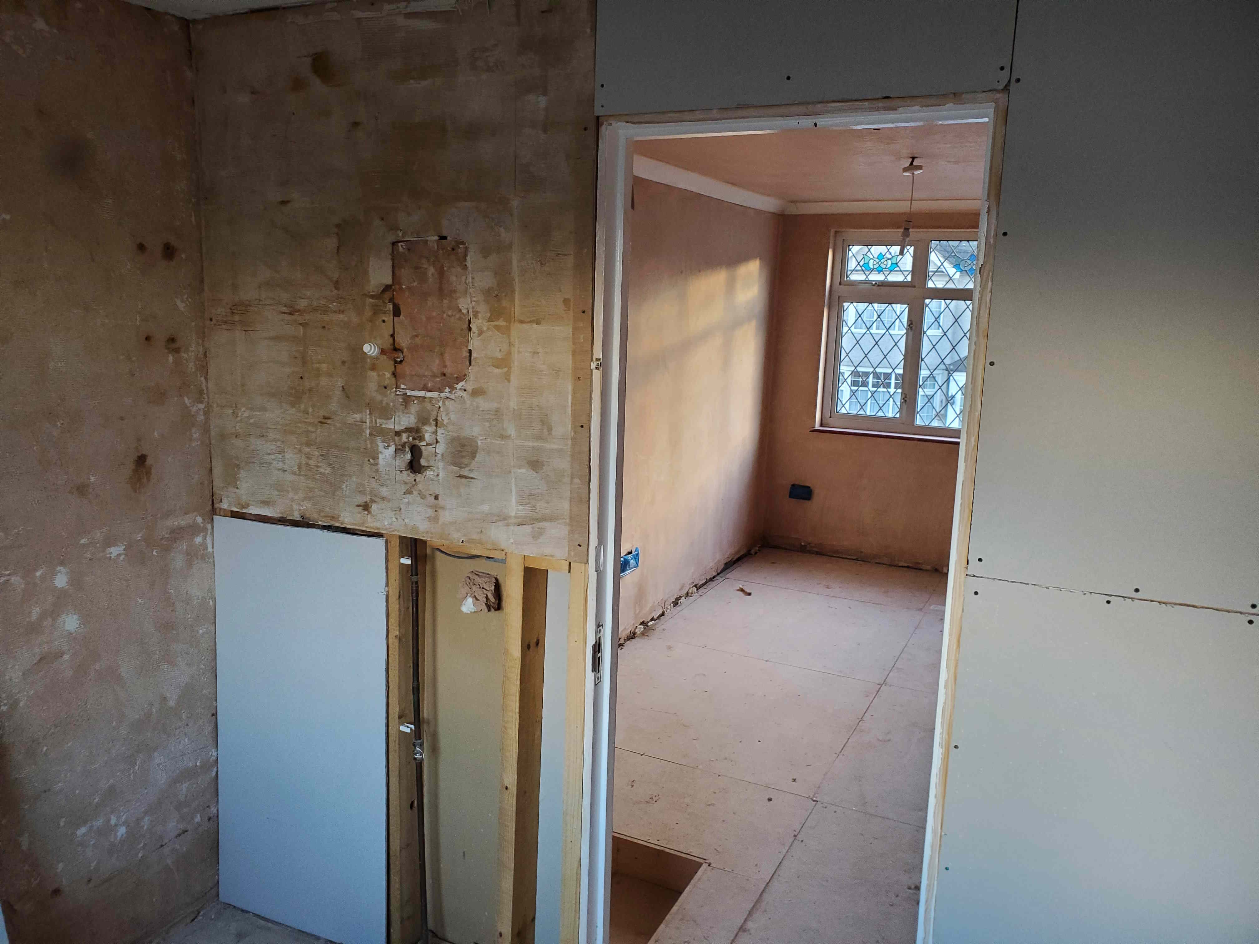

I plan to fit a new shower tray on the left and tile the whole bathroom. 1. Should I replace the plywood with tile backer board where the shower will go or will the old plywood be ok? 2. Should I cover the plastered wall on the left with tile backer board or can I tile straight onto the wall?

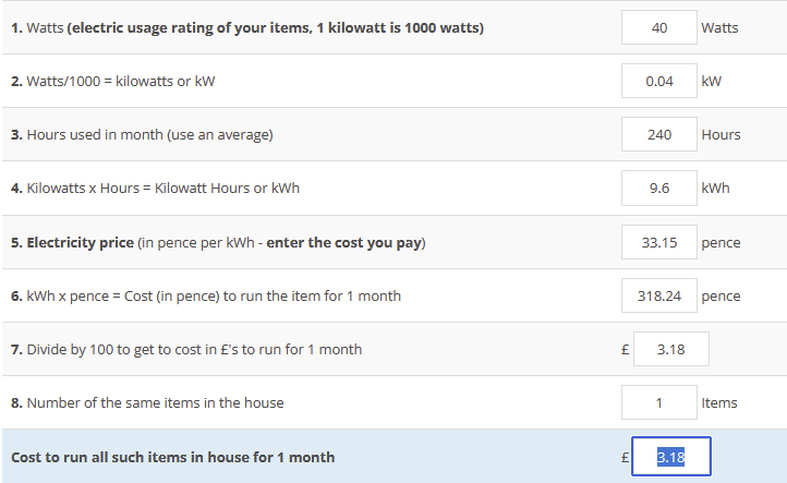

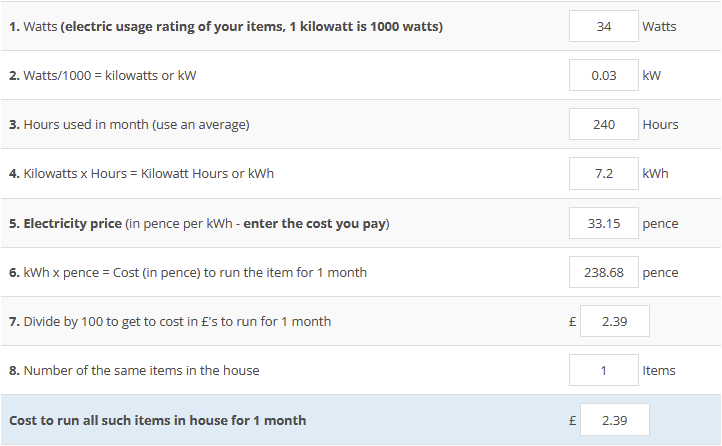

I found the details. A Wilo Pico power usage: The Grundfos in comparison: The Wilo cost assuming its always at max speed (not true but to get an idea) is £38.16: The Grundfos cost per year is £28.68: The Grundfos will save you £9.48 over a year or £94.80 over ten years by my calculations. Not a huge difference but worth spending £20-£50 extra on a better pump IMO.

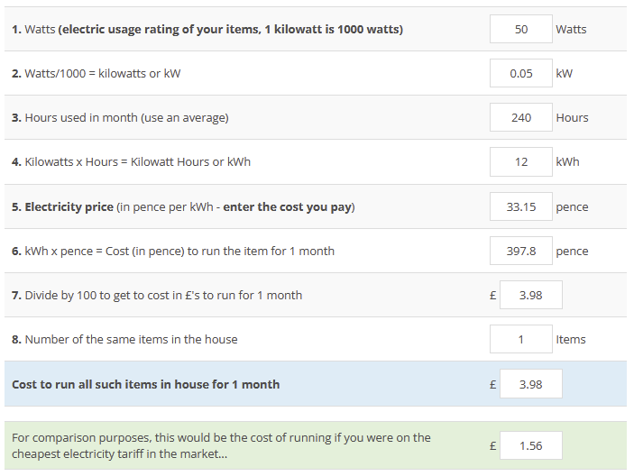

I found that a pump typically uses about 50W of energy, so I did a bit of rough math and found it costs about £4 per month to run (assuming its run for 8 hours a day, thats or £48 per year or £480 over a ten year lifetime). What I'm unsure of is how an energy efficiency index of 0.17 for a Grudfos or 0.2 for a Wilo affects those numbers.
