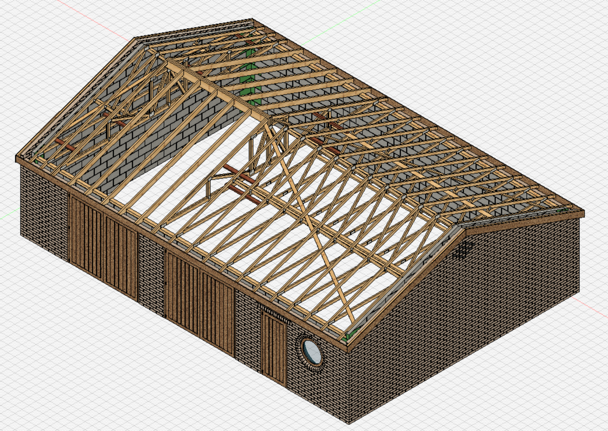

Hi all. we're ready to break ground on our new detached garage. It's a whopper: 11.7m x 8.2m. Steep learning curve - but the raft, the cavity walls and roof truss structure (19.88-degrees with a vaulted area for a car lift) have all been designed and quoted. But I'm completely stuck on the roof covering. it's over 100m2 so cost is a major problem and is keeping me up at night. I've considered natural slate to match the house, Brimet Liteslate (plastic slate effect tiles), Marley Edgemere Riven (concrete slate effect tiles) and lately old school roofing sheets. A second problem is finding a roofer - it's a struggle finding one with availability, let alone one with transparent pricing. Ideally I want a quote for all four roofing systems with material costs shown so I can make a decision, but it's not reasonable to ask a tradesperson to produce four quotes. I'll be using the garage as a workshop, with some high-end machine tools so condensation and noise escape is a big worry. Does anyone have any suggestions for a sensible roof choice? Rules of thumb on price comparison would be very welcome too. If its not insulted then I'd like the ability to add simple insulation (Rockwool or Kingspan) later - without spending a king's ransom on plywood sheets to support the insulation. Really welcome any pointers that could get me back towards budget. Image from design attached with visible trusses.

Thanks both - that's really helpful. So, going off @ETC's point then from the above if the building was just used for periodic storage then DPM may not apply. However in this case, the building will be used extensively (starting at 1000 hours a year and moving up towards 2000 hours as I hit retirement and contains a lot of expensive machinery. It really is an obsession of mine. As such I'd really like to have a good level of protection against moisture ingress so would stick with DPM. @Roger440. Mate, I owe you a pint. The lift manufacturer I had planned to use (TwinBusch) specified 200mm of C20/C25 concrete. However you are quite right, most alternative manufacturers specify 150mm (granted, as a minimum) even for higher capacity lifts. As such, you've just saved me a 25% of my concrete costs simply by picking another lift. Thank you! -

@markc I'm going off the specs for the 2-post lift. Some of my vehicles weight close to 3 tonnes. The lift manufacturer specs 200-250mm of reinforced C25/C30 concrete as a base. A failing 2-post lift is a scary thing. They do offer a drawing showing how to lay a H-pattern of thicker concrete in strategic areas as you suggest, but I haven't yet been able to compare the costs of the additional shuttering/layout for a deeper H shape vs just doing the whole slab in 200mm. @ETC I thought that was standard practice? Am I missing something obvious? -

Hi everyone. My head is spinning. I've just spent an hour on Google trying to find a detailed cross section of a suitable foundation for my new garage build. I've seen loads but can't seem to find one that is a close match for our build. The plan is attached. The only thing to add is that the floor slab will be quite thick at 200mm, reinforced (specific requirements for the vehicle lifts). Construction is 65mm Imperial Olde Shire facing brick with 7n dense blocks on the inner course with a 100mm cavity. SE has advised a depth of 1.3m based on findings from test holes. But frustratingly did not fully detail construction before we parted ways. It is quite a long length of foundations at 39m so I'd like to be able to draw and then cost up options for trench fill, trench blocks and dense block as a few pounds a metre could quickly add up. Does anyone have. nice, well proven cross section they could share? Ideally looking for one with detail on of block/brick types at each course and positioning of DPM/cavity tray. Any advice on how to keep the costs down given current concrete prices would be very welcome. I already know I'm going to feel silly when someone links to a blindingly obvious place, but I would really welcome the help as my Google and NHBC kung-fu is failing me.

SUMMARISED (thanks @DevilDamo): You are all quite right, that post was far too long - I do apologise. It looked smaller on the laptop but was a tome when I read it back on my phone. So, for brevity: Question 1: when designing a brick/block building, it it better to set building dimensions based on full bricks, full blocks or full trench blocks? Answer: From @Russell griffiths: Base it on full facing bricks and cut the blocks to suit. Supporting answer from @George: Use the Weinerberger chart for standard brick dimensions. Question 2: From my drawing, do I need internal piers, external piers or both? Answer: Inferred from @George, not on the outer skin. Possibly not needed at all due to cavity construction. Did the roof truss company specify a pier under the two girder trusses? (its actually four, each pair is of double truss construction). No they didn't the whole design was shown sitting on the timber wall plate. Outstanding question: are there any published standards for the size/frequency of piers on the internal leaf of a cavity wall? Sensible thought, based off feedback from @George: putting 2x piers on each 11.5m wall (4x piers in total) directly under the girder truss pairs might kill two concerns in one. Question 3: do I need movement joints as the specs seem to say every 12-15m? Answer: from @George, probably not. Suggestions from @George and @Russell griffiths: consider the type of mortar chosen and whether to include bed joint reinforcement.
Hi everyone. I'm in the process of redesigning a detached garage, which we're hoping to start building in the coming weeks. After a few poor experiences with an architect, we (builder and I) ended up taking on the planning process ourselves. I owe him a redraft. We'll obviously run the plans past our private building control inspector before starting, but its a bit of a chicken and egg scenario: I need to finalise the plans to agree a price so I know we can go ahead... and then keep a little back for the inevitable alterations BC require, I have three tasks: 1) Rescale the drawing to suit standard brick and block dimensions (i.e. make it slightly bigger where necessary to reduce the number of cut brick/blocks required. 2) Consider the inclusion of block piers on the internal skin. 3) identify expansion joints. The high-level draft plan is attached - currently at a nominal 11.5 x 8m footprint. Construction is cavity wall over trench-blocks/engineering brick, with a 65 x 215 x 102.5 mm facing bricks and 440 x 100 x 215mm dense concrete blocks on the inner course. 100mm (97.5) cavity. I've been redrawing the building in CAD (my happy place) - have modelled every brick and roof component so that I can accurately assemble it on the computer and produce accurate drawings and materials lists. I have a few questions if anyone would be good enough to answer?: 1) When I try to rescale the building according to the brick and block dimensions, there isn't an obvious size. If I scale it so that the bricks don't need to be cut, then the blocks do need to be cut (and vice versa) and when I lay out the trench-blocks in CAD (440mm tongue and groove) then they always need to be cut to suit the blockwork above (the tongue and groove means no 10mm mortar bond on the sides which throws the standard dimensions out). I believe it is not possible to have a size that will suit all three brick./block dimensions and that there is therefore a compromise needed. Would anyone be good enough to suggest a size I should aim for (at or above the 11.5m x 8m initial plan) that would minimise the bricklaying labour in terms of cuts and adjustments? 2) We did have a structural engineer involved. This was due to an initially complex inner roof structure. His suggestions were OTT - more steel than Wembley stadium, we quickly moved to a truss design to avoid his doubling the budget. However he did suggest that the building needed four 440 x 140mm block piers on the inner course, one each on the north, south, east and west walls. The pier on the south wall (the one with the doors) was located offcentre, between the vehicle doors and the one on the North wall was directly opposite, again offcentre. The main purpose of these piers was to support some massive steel beams, which have since been removed from the plan (part vaulted ceiling to allow for a car lift, our local truss company came up with a much cheaper and more elegant solution - see the attached image from our CAD model, you can see the part-vaulted section clearly). So, while the piers are no longer needed to support the steels, I'm sure they would still be necessary due to the length of the walls. Can anyone comment on whether we still need all four piers of would two on the long walls only suffice? We have no issue with the cost of the piers, more that it impacts floorspace. 3) Finally. The structural engineer did suggest movement joints would be needed due to the span of the walls, but these aren't included in his drawings. I have read the designing for movement in brickwork technical guide but this seems to suggest that expansion joins are only needed every 10-12m (15m max) horizontally and 9m vertically. As such, it doesn't seem like they are needed. Could anyone offer any guidance here? Again, cost isn't a factor, rather in this case it is aesthetics. The building is being put up using reclaimed-style brickwork (newly made from Imperial bricks) and the styling is intended to mirror the local barns so we don't want to have visible expansion joints if they aren't needed. Many thanks indeed for reading and thanks in advance for any help.
