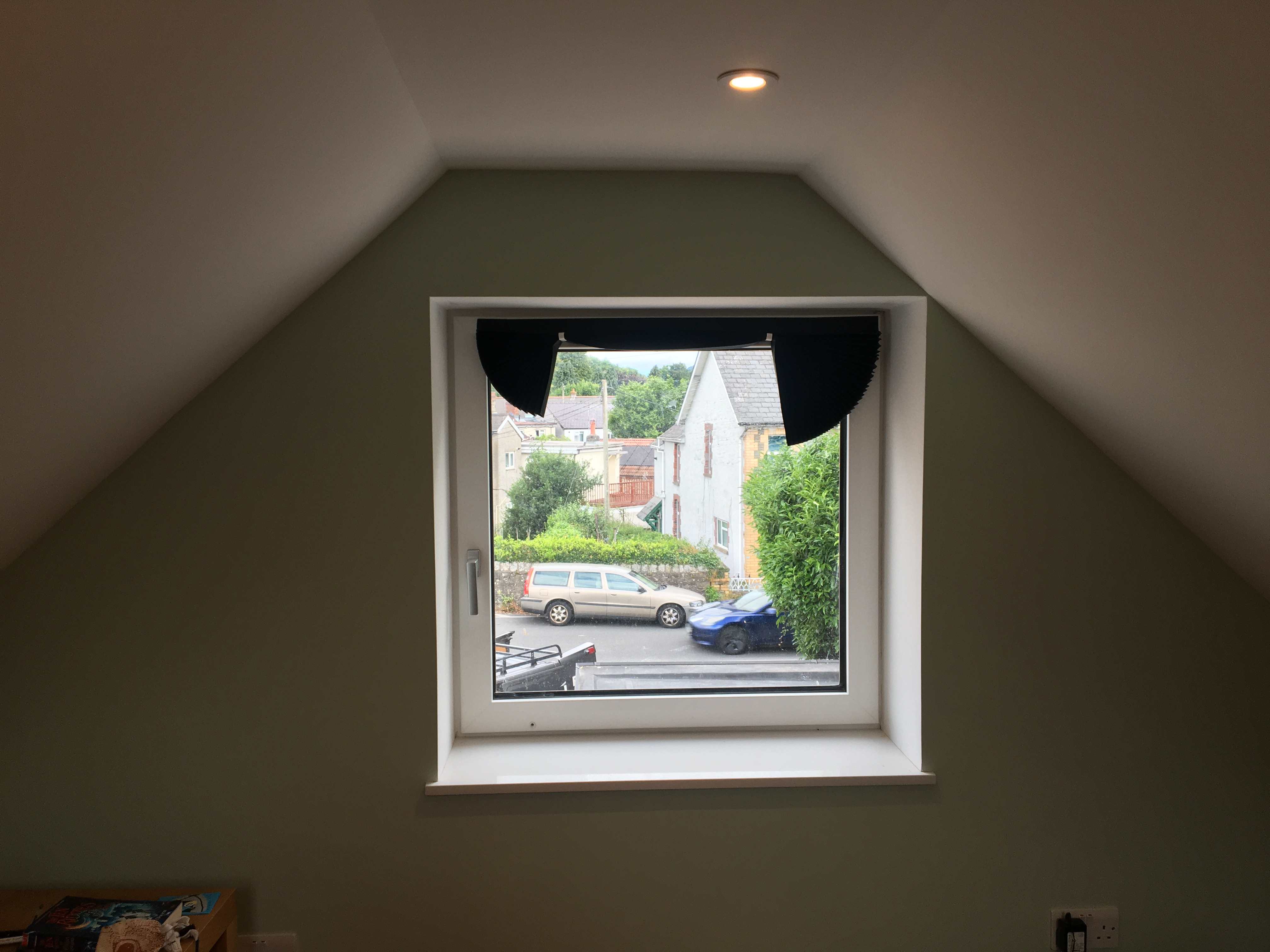

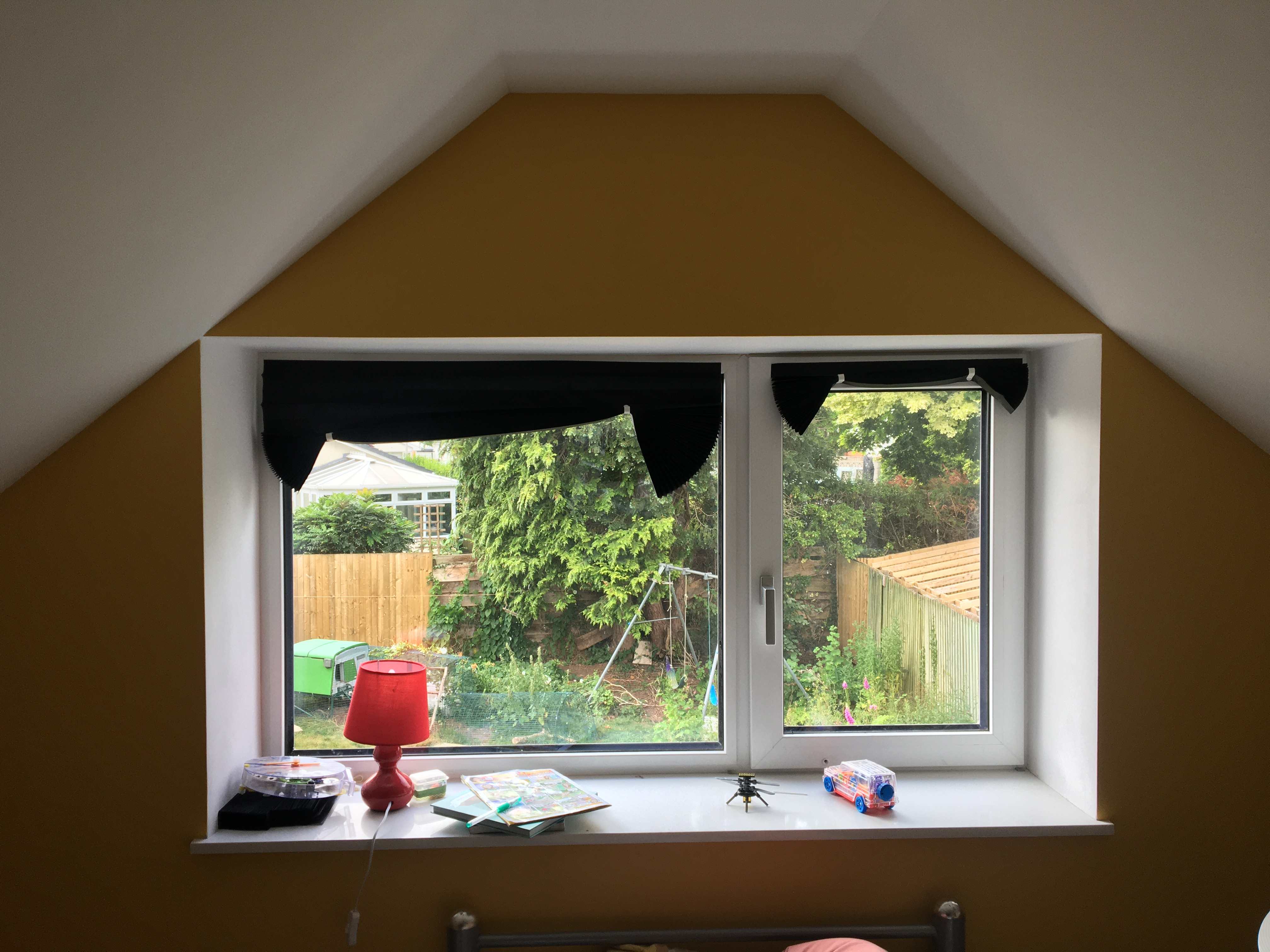

Hi, we have two gables ends where the vaulted ceilings are very close to the top corners of the windows (see photos - ignore the temporary paper blinds!). This means we are struggling to see how to achieve a full blackout using a standard curtain track or rail. Blinds would have been a good option but our windows open inwards and the sash is very tight to the reveals. Can anyone suggest a product that would blackout the windows at night but allow full daylight during the day? Thanks in advance for any help
