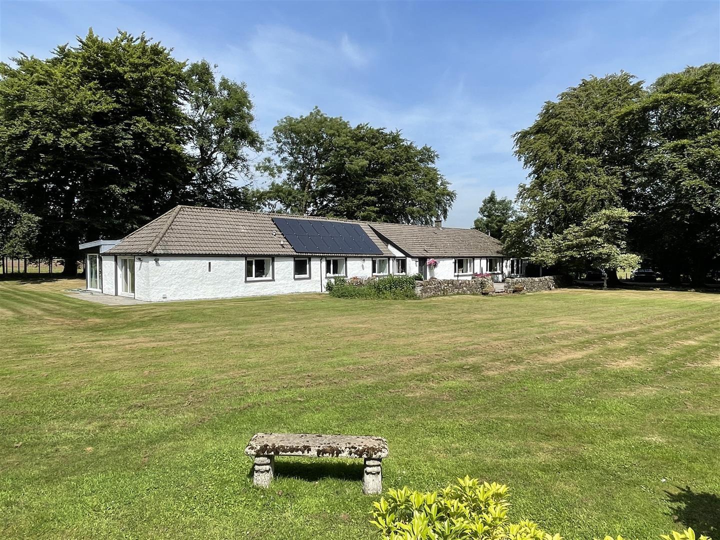

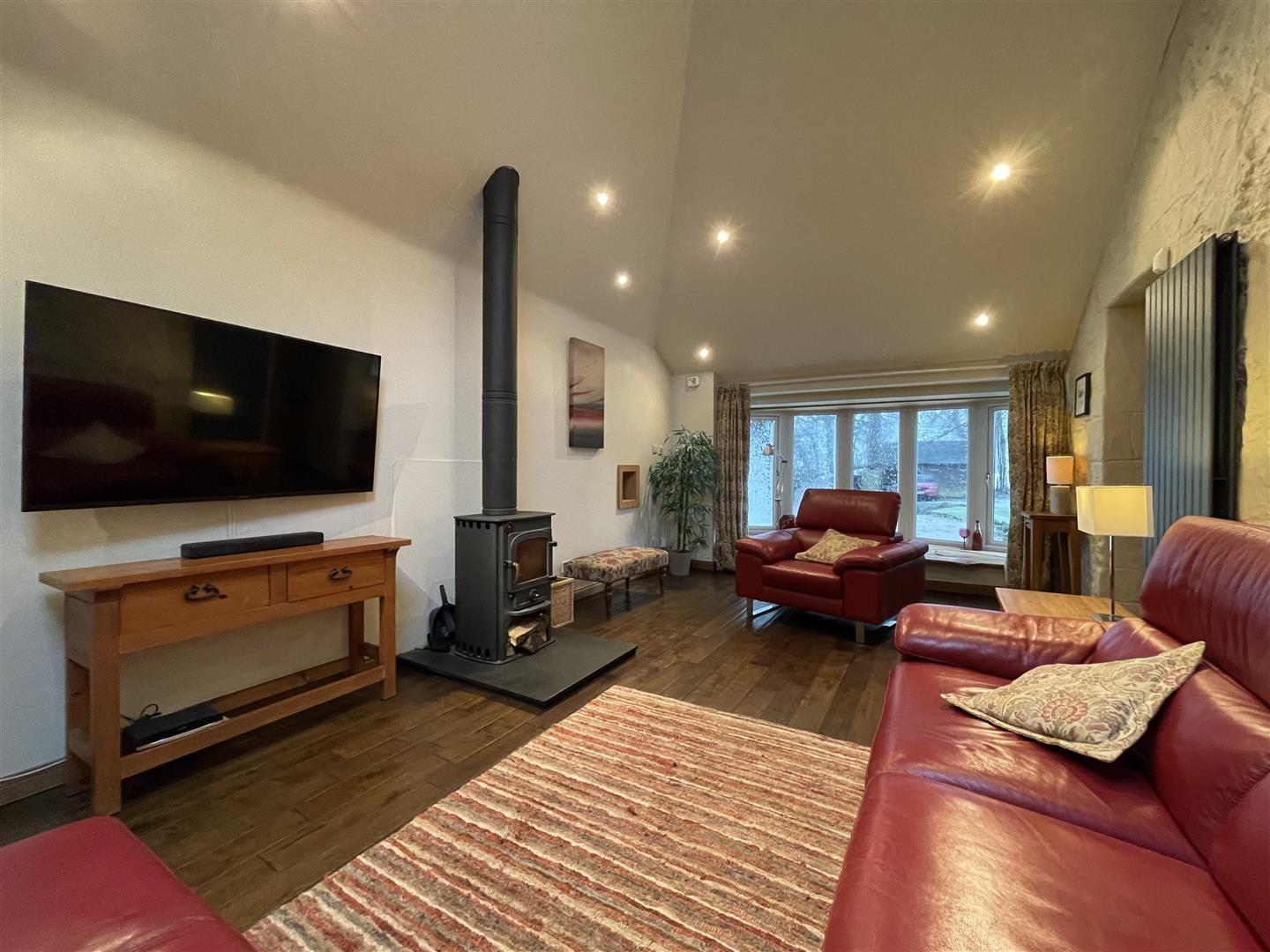

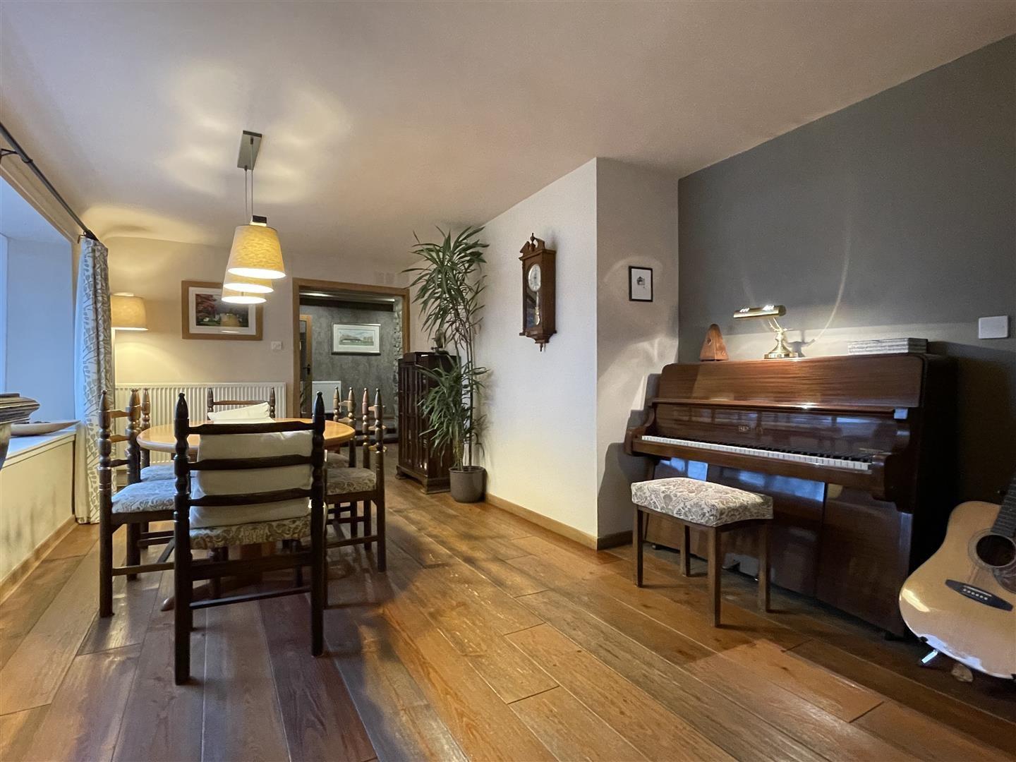

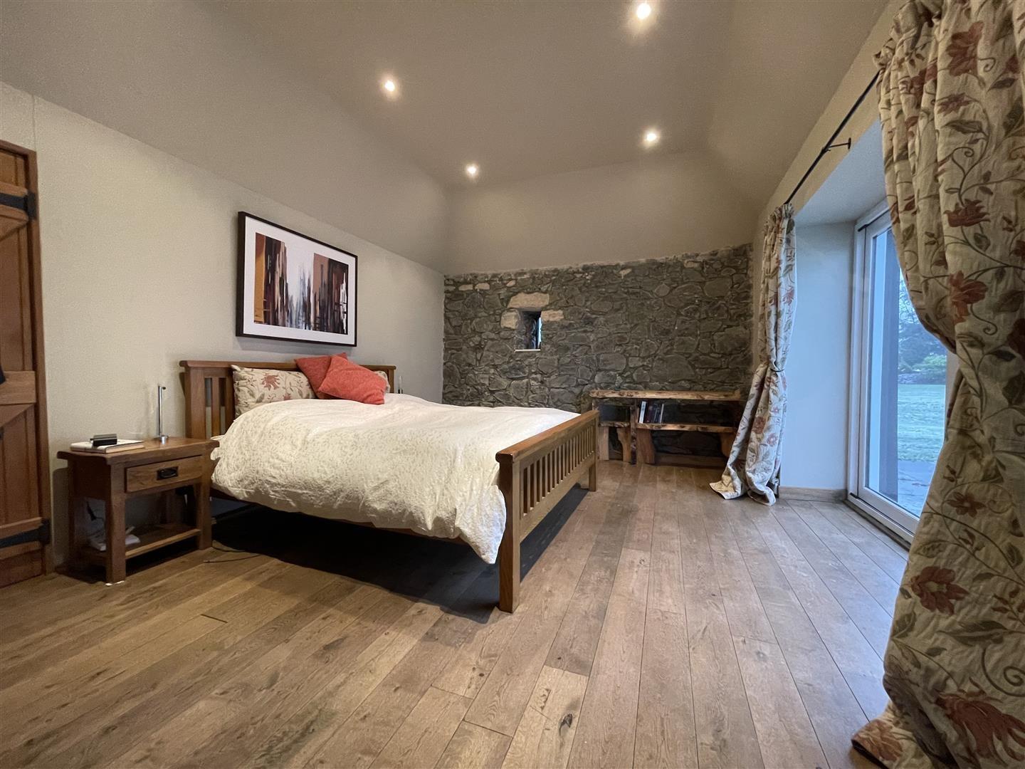

So External wall insulation would mean redoing the lower half of the roof and as it is a stone built property, I guess it would not do any good for the stone work. The cement render certainly doesn't. There is next to no overhang of the roof to the walls. Ive put in some interior pictures. the main hall way is north facing and bloody cold. 80mm air gap behind the plaster and no insulation. not lathing as the internal walls have been done in the past 20 years. added in bedrooms as there is not a huge space for internal wall to external wall . there are portions which have old glass fibre behind the plaster, but not everywhere. @Redbeard I have done this type of install on an old cottage before with my cousin, Internally I would love too but the hall way would encroach too much. the rest of the building could potentially be OK as there is large space to do so, The bedrooms again I think it would encroach too much, but a suggestion on what thickness would be helpful as I am not an expert in this.
HI All, I am having some bother finding a reputable installer of insulation that wont just offer up any old solution... I have a limestone built house. which has been cement rendered and painted. I know not good. Plan is to remove it long term. Right now I'm trying to insulate the house, Now I know a fibreboard method and lime plaster will work. but disrupting the house for many many weeks. What the current interior build is made up of a non foil backer 12mm plasterboard and plaster onto a wooden framework that sits about 80mm from the main house wall. Roof is a cold system so there is airflow behind the plaster walls which makes them very cold. Roof has 400mm wool insulation Solutions I have been offered are Kingspan bonded to plasterboard and placed on the existing wooden frome work (removal of old plaster) Blown Bead insulation between the existing plasterboard and limestone wall Can any one advise as, mostly the companies that are accredited insulation installers want to build a frame on existing walls with 30mm gap and 60mm insulation and plaster. This would be fine but intrusive on the room sizes.. Can anyone advise or provide any information as I am trying to get grants to do the work and without quotes and correctly done I'm lost

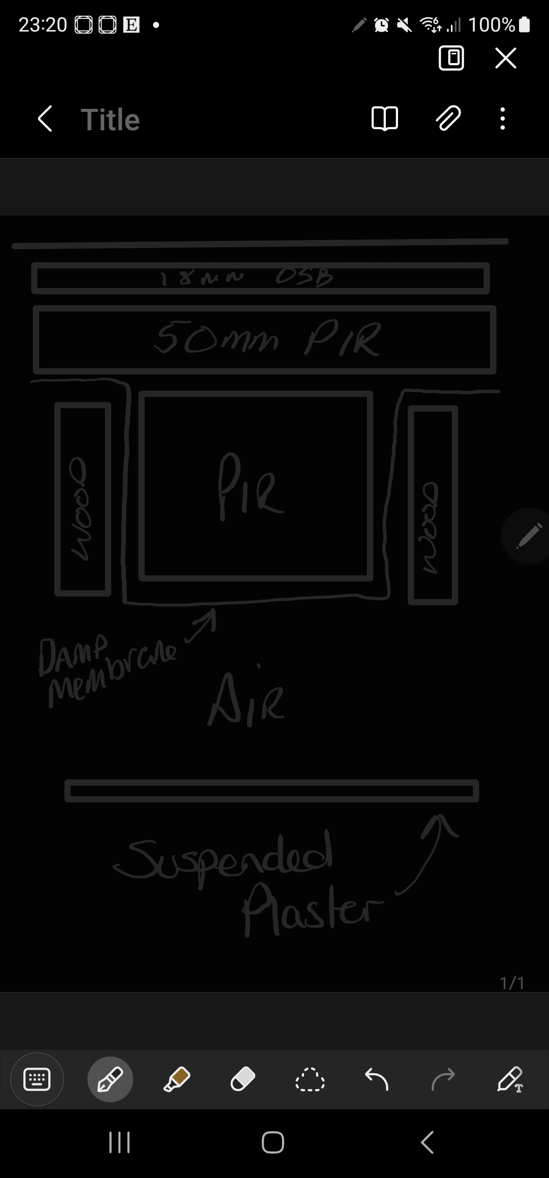

I think I'm understanding now. Thank you. No matter what we do here with such a small insulation is going to be poor. Absolute out the box thinking here. If I place the osb to the underside of the structural beams... damp membrane over and in-between completely sealed off. insulate between rafter and 50mm on top. 18mm ply and Firestone rubber. Leave the gap below the rafter essentialy not Insulated but make a sandwich of insulation in the roof as such... Whats the thoughts here. Stupid idea? -

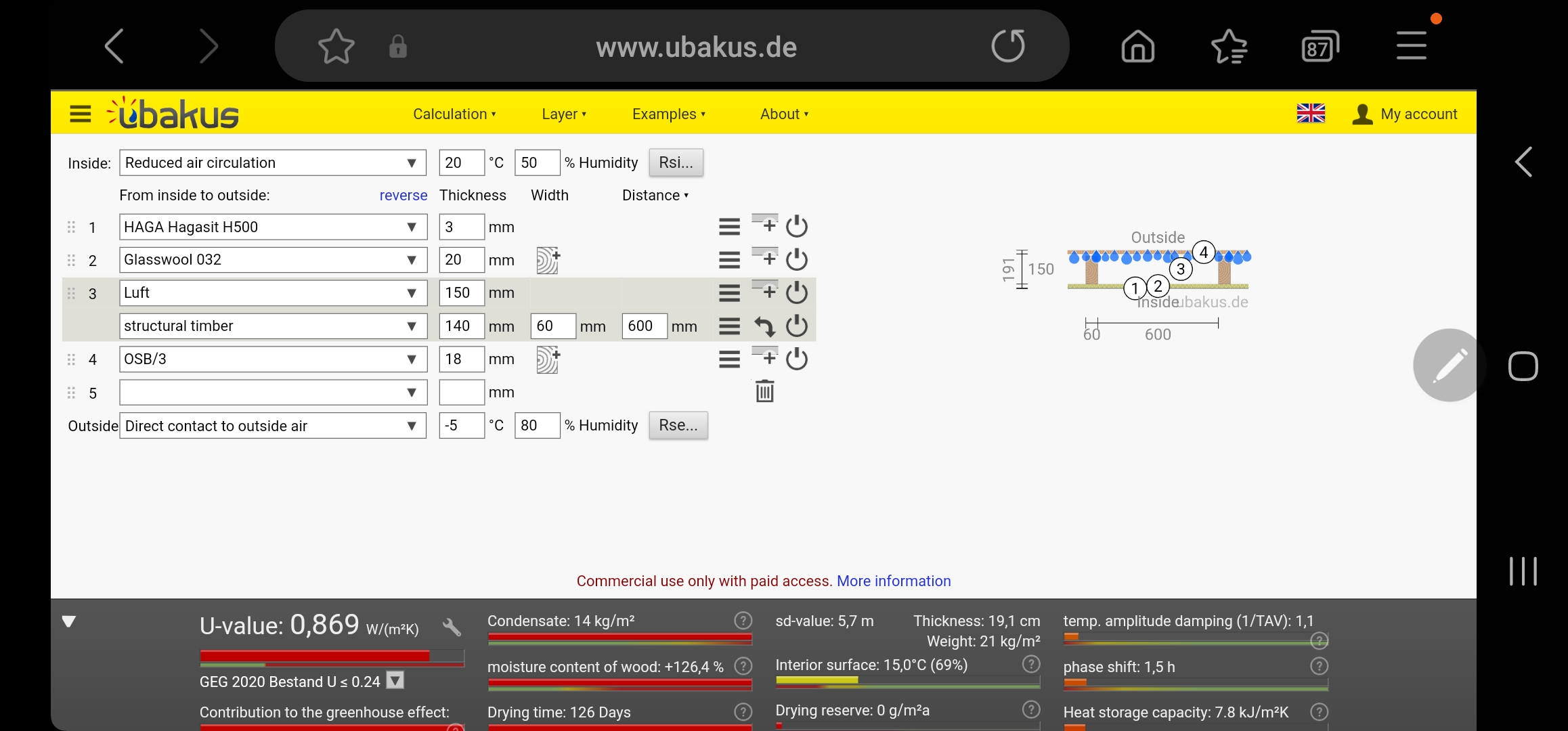

Ok so I have had a look at this and I'm not 100% what I'm reading. What I have tried to put in from unknown plasterboard there is about 200mm air before the structural timbers and osb on top. Max osb I could build a warm roof with would be 50mm as the build would be Plasterboard , structural rafters ,18mm osb, membrane, 50mm PIR boars insulation, 12mm osb3 and then rubber. Giving me about 10mm clearance from the tiles on the main roof. In theory I could reduce tge slope of the last tiles so as to Rais the bottom edge or would cutting them be an option? Would rather not.... If I some how raised them then I could get 100mm insulation in there.... -

@Iceverge thank you for this. Will look at those sites. When you say combination of warm and between the beams. Do you mean with an airgap below the osb or direct onto osb when you have a thin warm roof? How do you know how much is too much to avoid a dampness with the dew point. Are there calculations for this or experiences you can relate to? Thanks fella -

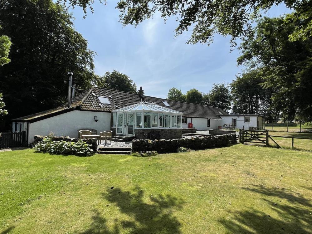

So the main bedroom has an open roof space into the eves of the roof, meaning changing the hip slope would have to change the inside of the house as well... I know the overall look would be far better but I feel with a 4 month old its going to be too much of a change and unfortunately cost at this stage. (pending lottery results tonight I guess.. ) If I could do the work myself it would be great, but I think we are quickly getting into more than a one man job. @Radian any idea on what is required to make this type of change. planning, structural engineer sign off etc? Will get photos.. -

@Radian thats great, i actually had to double take and spot the difference there. it would be far more fitting with the house I agree. only issue i see is without changing the pitch angle of the roof over the bedroom we would have to alter the bedroom roof as well on the main house. great idea though. We could of course have a different pitch on the back of the house to that on the gable end of the house. not sure how that would work. what do you mean regarding the wording of the house and shallow pitched roof. -

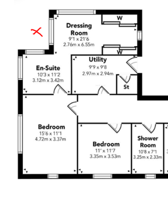

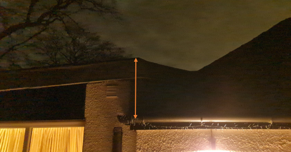

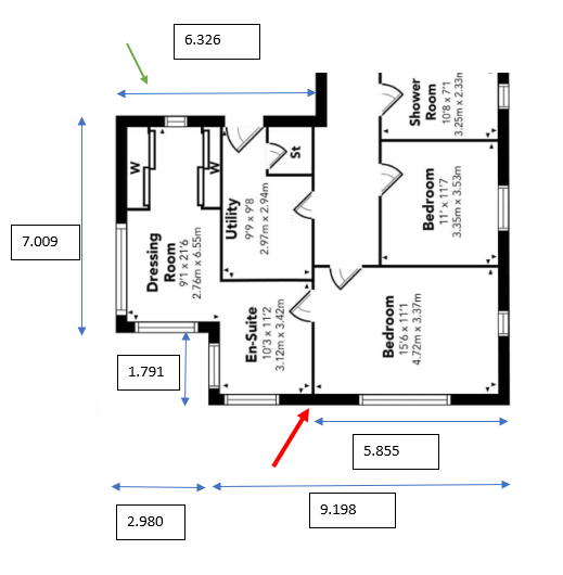

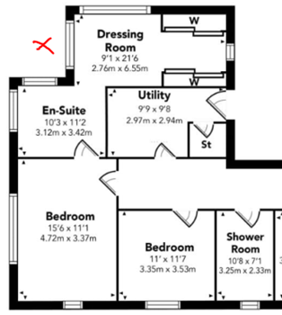

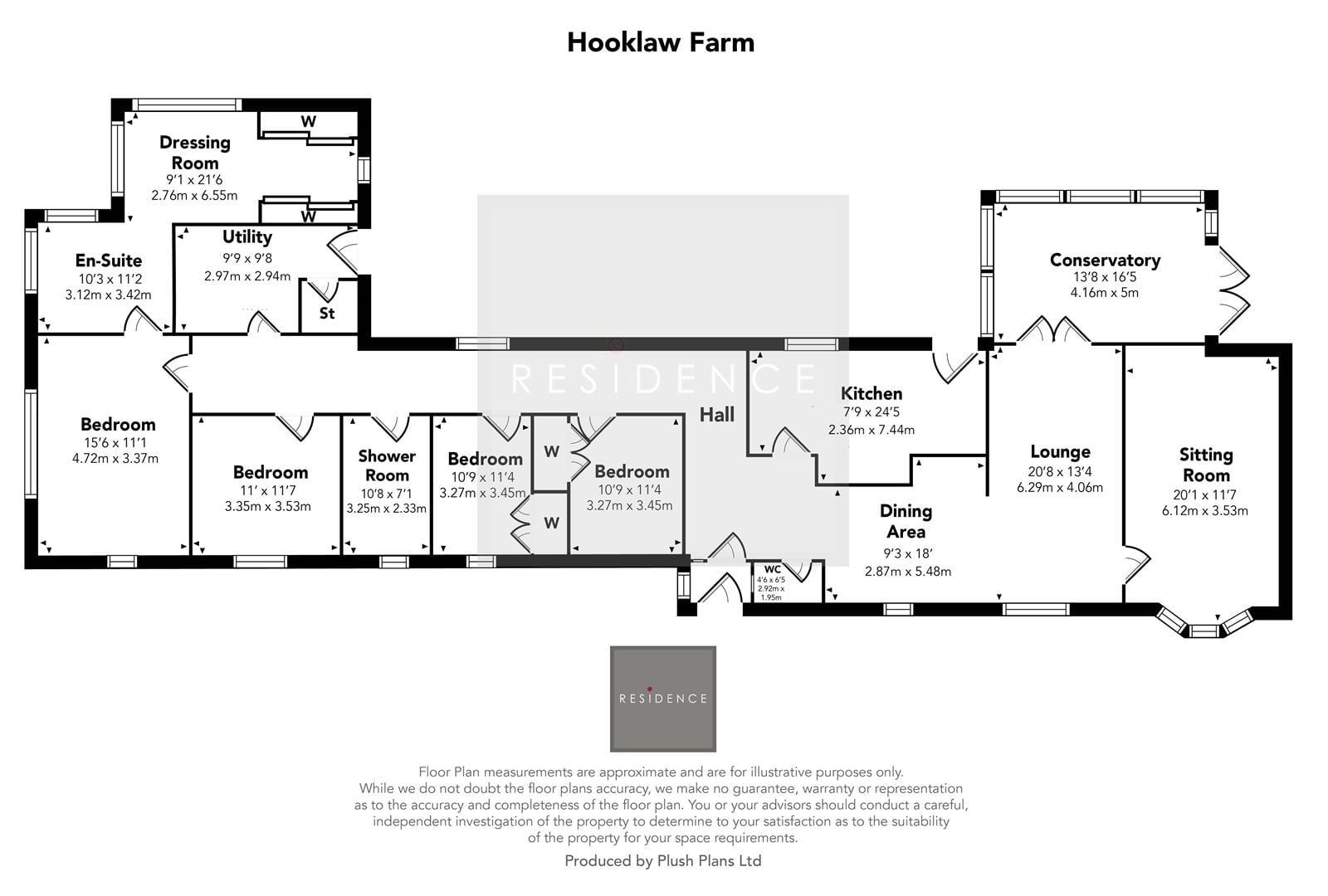

So these are the wall dimensions, there is a 250 overhang of the roof on all sides apart from the side with the green arrow, it is only about 100mm Where the red arrow is there is a step out for the main bedroom wall approx. 100mm , but I thought that i could use this space for external insulation and render. taking it out to the main body of the house. the height of the roof along the bedroom wall is lower than that of the flat roof as there is a slope in that see attached photo. this difference is about 680mm. the gable end of the main house (bedroom wall) has a triangular sloped roof, sorry I don't know the correct name for this. I know this is vague, but to do an apex roof, what would you expect the cost to be? Any idea on what planning would be required? or would it just be a building warrant. Remember we are in Scotland. Anyone wanting to come give me a hand , free bed and board and i might even open a special whisky for you! -
