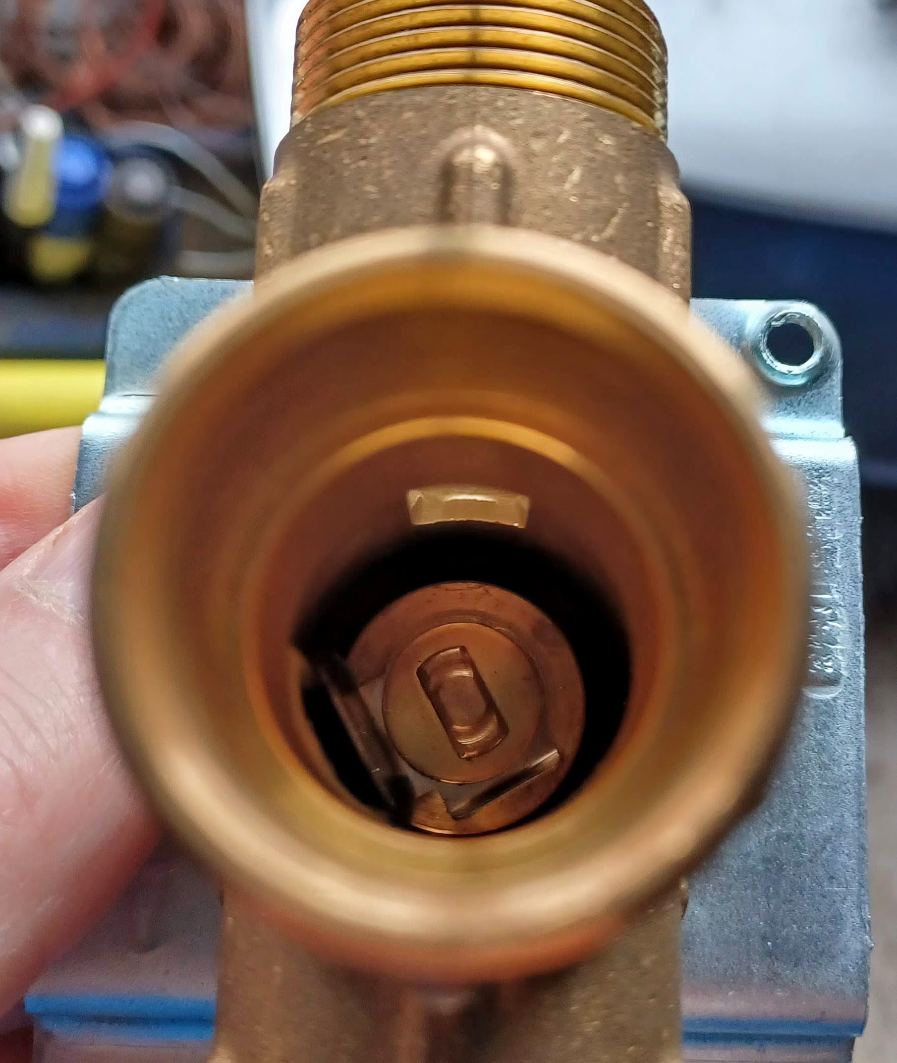

  1. Yes that's right just one shoe in the valve, so it needs a half turn. Therefore i don't see how the Danfoss is compatible unless the one I have is faulty..?
  2. Can you explain what you mean by image implies 90 deg side to side? The spindle needs to turn 180 degrees (12 o clock to 6 o clock) to go from port A to port B - therefore turning the valve won't help as the actuator still won't rotate the spindle enough to move the valve between A and B. The Sunvic actuator had already been replaced in the past and an identical valve is still in the old box as only the actuator part was replaced so I am able to see inside the valve and it needs a 180 deg half turn to switch from port A to B. thanks
