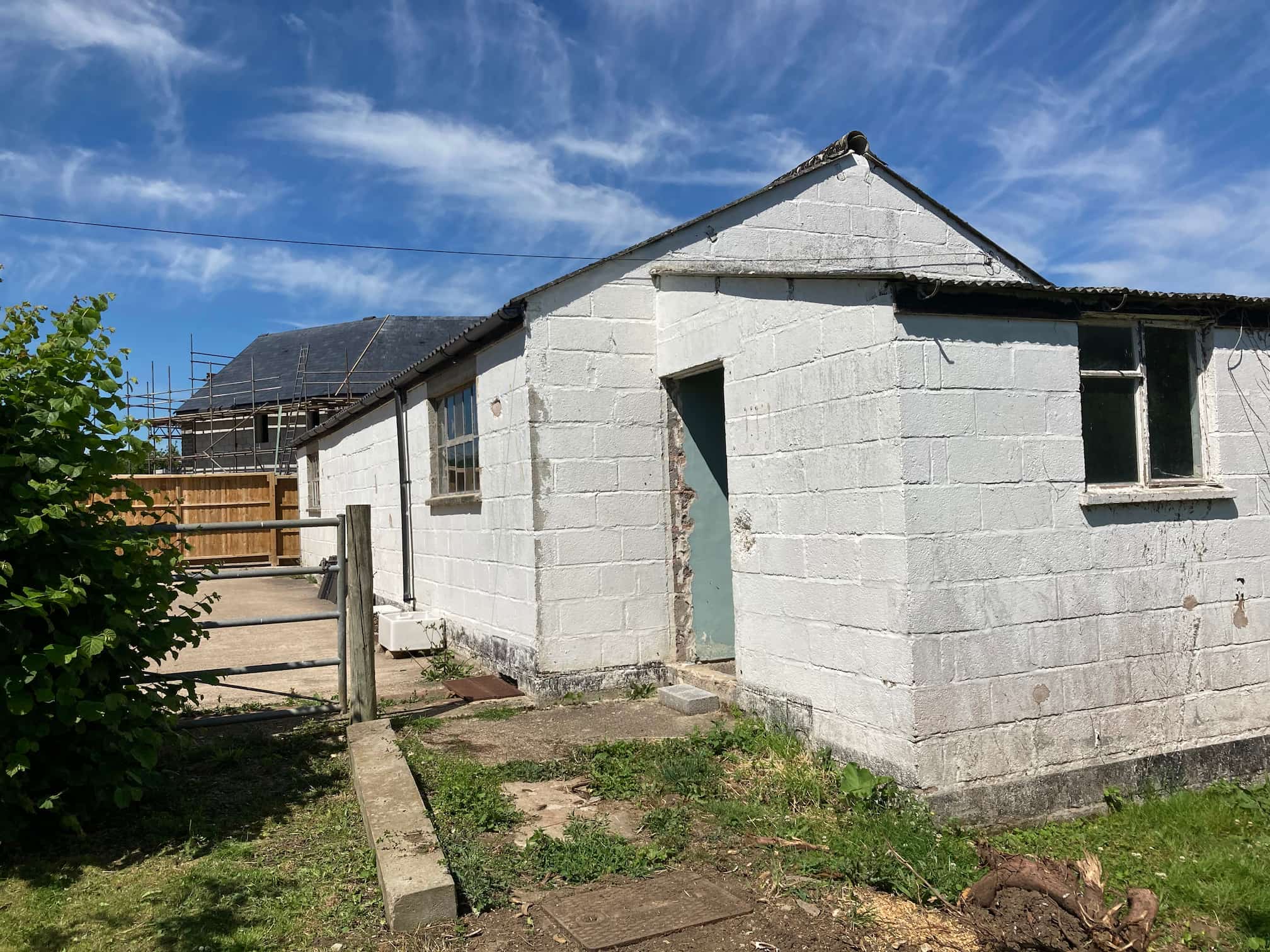

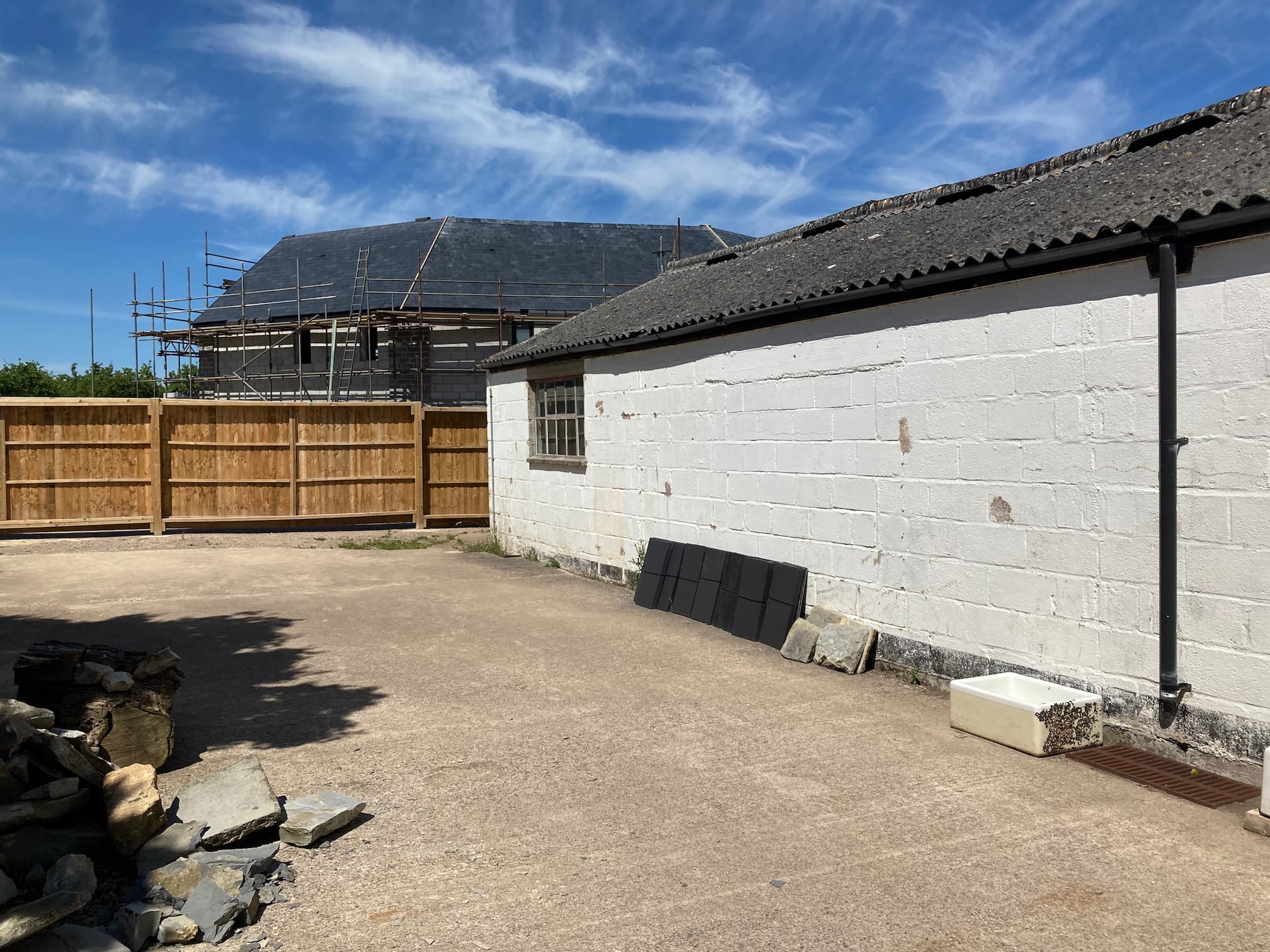

To add as well I believe there still is scope for another large home as the other 2 my neighbours owns were smaller sized the cumulative floor space has been merged and this has been developed into a large new build. Much larger than the agreed planning so I think they are trying to get it through retrospectively! I’ve added a photo gives a bit of a better overview of the site some of the garden in the picture is parents and is yet to be separated properly. -

thanks everyone for their replies this is the reply i got back following a pre app site visit for the new build, i have since gone back to him with the above designs just awaiting their reply. Firstly apologies for the delay in responding to your enquiry. I have been looking back over the previous applications and subsequently discussed with senior officers given the complexity of the landownership etc. It is noted that there is no ‘fall-back’ position following the refusal of the previous Class Q application, the approved Class Q has also now expired. I also note that the neighbouring property currently under construction which was permitted under the approved Class Q application has ‘landlocked’ the application site. Therefore, without access over agricultural land the proposal represents a new dwelling in the open countryside which unfortunately would not be supported by local planning policies. However, you may wish to explore a full planning application under Para 80 of the NPPF, although this would only allow the ‘conversion of redundant and disused buildings’ in the countryside. This would also be subject to the Phospahte issue and would need to be resolved prior to having a legible fall-back which would allow the demolition and erection of a new dwelling as proposed here. A new class Q application could be submitted utilising the neighbours access, as this would still be recognised as an agricultural access given that it was used this way in 2013. If you could secure access over the site and therefore a subsequent Class Q approval, you would have a solid ‘fall-back’ position and therefore the LPA would have no objection then to the demolition of the building and erection of a new dwelling and associated access through residential land. You may wish to revisit your ownership documents following the purchase of the land as this might show a right of access through the site? As we discussed on site, the design of the proposed property in terms of design is attractive and considered acceptable, it would have little bearing on the enjoyment of neighbouring properties and the proposed access through the residential curtilage would raise no concerns on highways safety grounds; however, in terms of local and national planning policy if the application was to be submitted in its current form due to the rural nature of the site without an established fall-back I do not believe that this is something we would be able to support. You may wish to explore the possibility of converting the existing structure in to additional ancillary accommodation rather than a separate residential unit. Alternatively, you may wish to proceed with an application regardless of this advice. Planning is a democratic process and any eventual application could be overturned by a planning committee should there be local support for the proposal, including from the local elected councillor. I appreciate this is disappointing news. Should you have any further queries or wish to discuss other means of access to the site, such as via the neighbouring site please do contact me and I will endeavour to help. RE class Q Thats quite interesting with access originally we were thinking to be able to do something similar. potentially splitting up the application so my parents would put in for permission to put an access across their land as a householder application then maybe use that in conjunction with a class q. the buildings were last used in 2018 for agriculture and have stood empty since then theyve been in agricultural use from at least the 60s within the local plan (south somerset) they have this about rural housing POLICY SS2: DEVELOPMENT IN RURAL SETTLEMENTS Development in Rural Settlements (not Market Towns or Rural Centres) will be strictly controlled and limited to that which: Provides employment opportunities appropriate to the scale of the settlement; and/or Creates or enhances community facilities and services to serve the settlement; and/or Meets identified housing need, particularly for affordable housing. Development will be permitted where it is commensurate with the scale and character of the settlement, provides for one or more of the types of development above, and increases the sustainability of a settlement in general. Proposals should be consistent with relevant community led plans, and should generally have the support of the local community following robust engagement and consultation. Proposals for housing development should only be permitted in Rural Settlements that have access to two or more key services listed at Paragraph 5.41. -

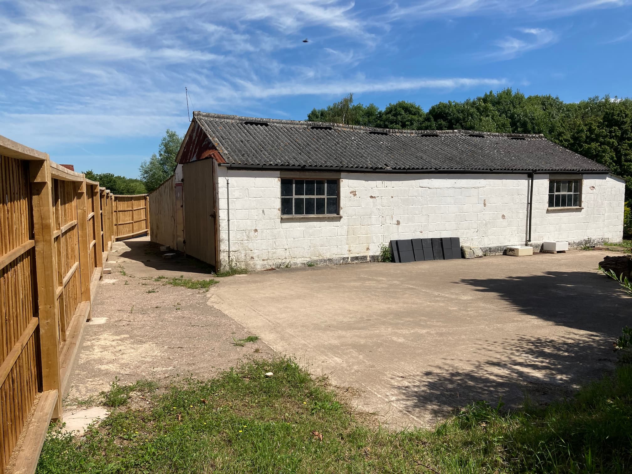

hi all just wondered if anyone had any experiences of planning under section 80 "the development would re-use redundant or disused buildings and enhance its immediate setting" we have barns 1&2 with a lean to that joins them together (pics and drawings attached). we would like to convert to a 2 bedroom house unfortunately we cant use class q as there isn't an existing agricultural access anymore as the neighboring site has been developed. so a new access needs to be formed and this will be over residential land (part of my parents garden goes over the front). Originally we wanted to demolish and put a new build there during pre planning even though the design was well received and the access isn't an issue the officer has said this wouldn't be supported by local and national planning policy as its classed as open countryside and we haven't got a fall back position. i think now i potentially wouldnt be able to get enough funds together to go the new build route so im looking to do a smaller single story build. ive come up with 2 designs 1 which uses the buildings in entirety ideally i dont want to do this as the leanto and workshop are poorly built and would need significant works to bring up to required standard. the second is my preferred option and puts an new build element in place of the leanto that wouldnt be seen from the roadside and would be a more compact site with a smaller footprint but is a paragraph 80 application allowed to have a new build element? i would still be reusing the main barn which is a significant portion of the site. elevations and floor plan.pdf floorplan and elevations with new build element.pdf survey of existing site plan.pdf survey of existing building.pdf
