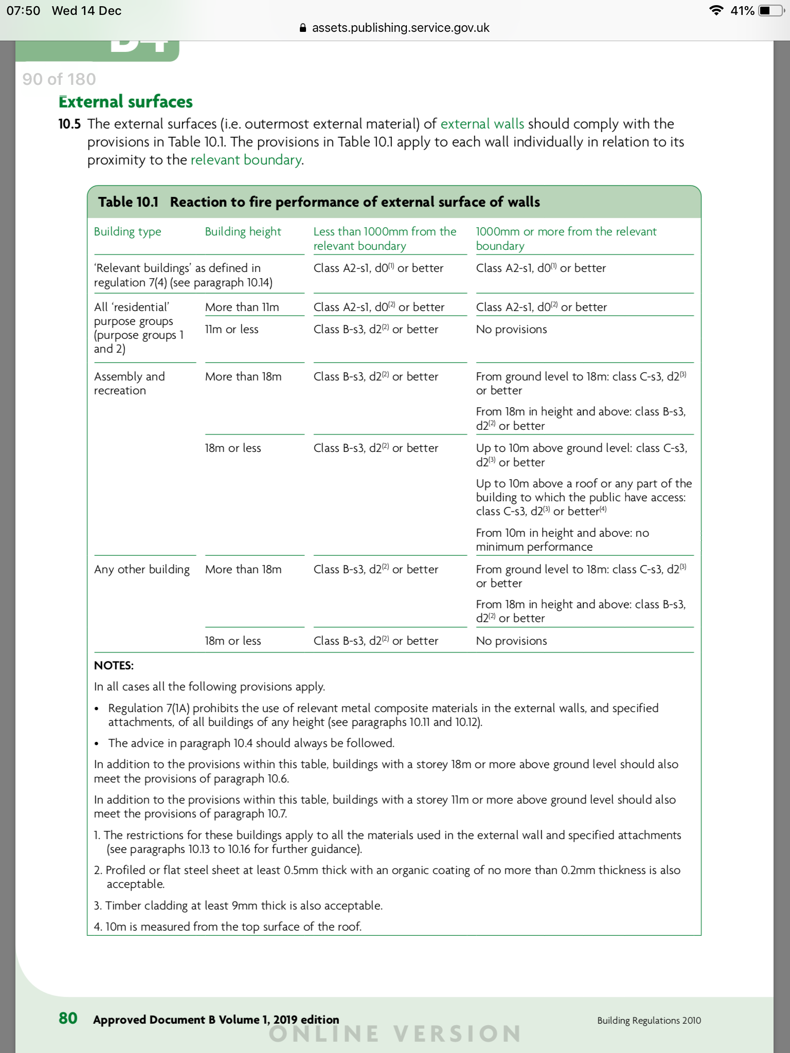

New Member

  1. Sorry to hear you had to experience that , its just concerning that it hasn't been made law yet that only A1 and A2 products being the only acceptable standard to be used. Still , sadly i guess money talks to those at the top..

  4. Yes according to the table there are no provisions of a certified product being used on buildings 11m or lower ?
  5. Hi guys thanks for the replies. It just seems crazy to me as class F euroclass products like polystyrene are still being sold as insulation and they either have failed the tests or NOT been tested. So technically if a product has not been tested what would stop me using something untested I've made myself ? Certainly feeling it this time if year brrrrrrrr
  6. Anyway i mainly do traditional building work, where would i stand in terms of legality in making my own insulation i.e pure sheeps wool with no plastic additives/chemicals as i know lots of farmers or small straw blocks to put between beams etc. Surely this is no different than if i was to use a product that has not even been tested even though sheeps wool and straw are known to be very fire retardant. Cheers guys

  8. So just wondering if anybody here can shed some light on this. So to my knowledge there are many companies selling Euro class F insulation ( which means it either failed the necessary tests or it hasn't been tested. Building regs banned these to be used above 11m due to the risk. How on earth are they allowed to sell a product which hasn't been tested ? Anyway i mainly do traditional building work, where would i stand in terms of legality in making my own insulation i.e pure sheeps wool as i know lots of farmers or small straw blocks to put between beams etc. Surely this is no different than if i was to use a product that has not even been tested even though sheeps wool and straw are known to be very fire retardant. Cheers guys.
