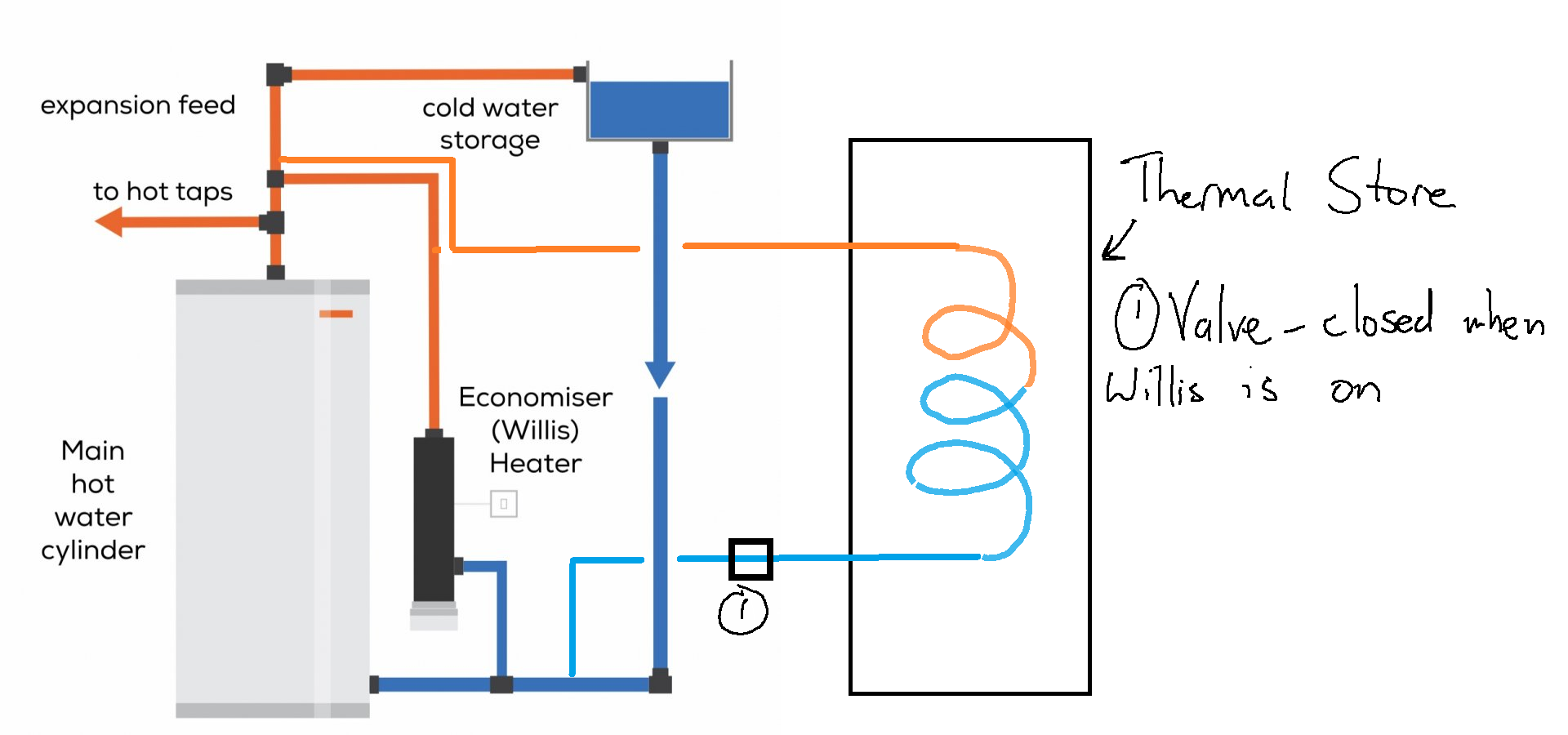

Willis Heater Integration with a Thermal Store
JamesDRG replied to JamesDRG's topic in Other Heating Systems
The Willis heater heats the very top of the tank with hot water and is more efficient than an immersion near the top, which is invariably heating a larger volume of water and promotes more blending of water. As I understand it, you cannot have E7 meters installed anymore. -
Thanks @JohnMo Hmmm interesting idea. I'll sketch that out in a bit and see what that could look like. Yes, agree with the above. We have a pump already fitted for the showers and this is more than fine. Filling a bath takes a bit longer but again we don't mind this really. What I am not sure with a DHW from a TS is how much of a temp drop you would get from the TS vs DHW out? Ie what is the minimum TS temp you could get away with to still have a hot shower. -
Defo agree with this point. But in our design we are not looking for instant hot water - we would run the Willis just ahead of when we need it. So for a shower, should take 10-15 minutes of heating. We can have this linked to Alexa via Shelly relays so it's not too much of a pain to just give a bit of notice before a shower (or time it of you shower more or less at the same time). -
I could add a valve as shown in the third picture that will close whilst the Willis is on?
