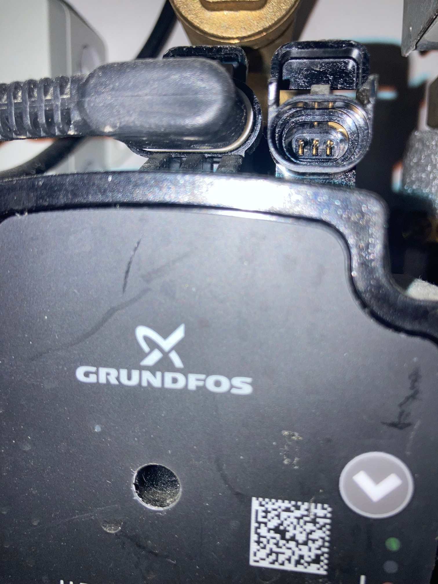

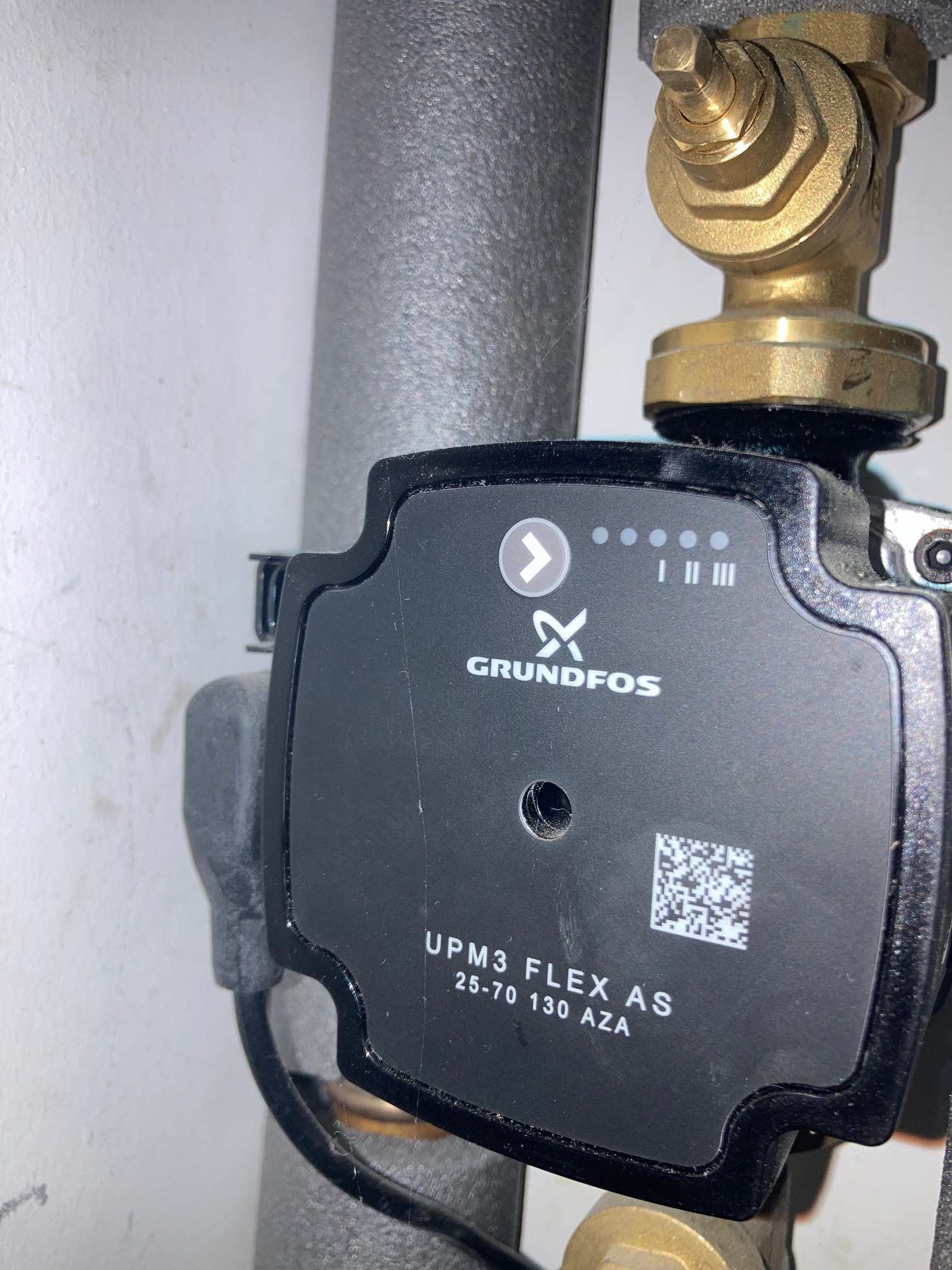

ok… turns out only one pump feeds both the ufh and radiators.. just had this email from the installer; The system has two pumps, one of the pumps feeds the hot water to the low-loss or the hot water tank. The second pump is after the low loss which feeds both the radiators and the UFH. This pump feeding the UFH and the radiators is on its highest setting -

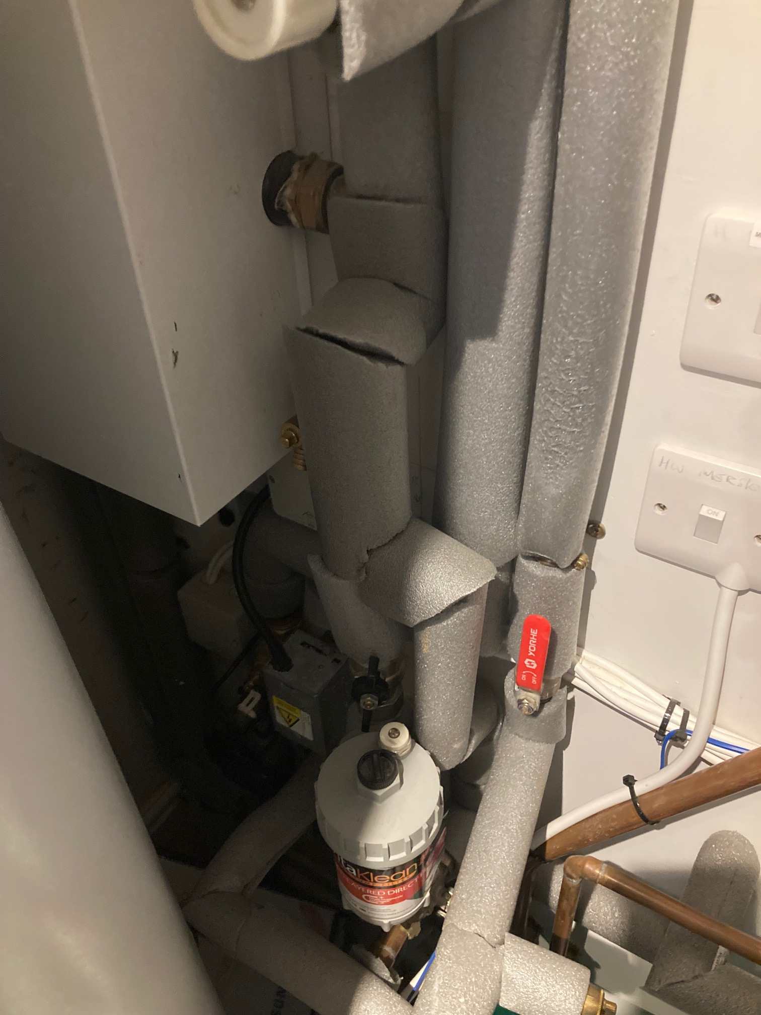

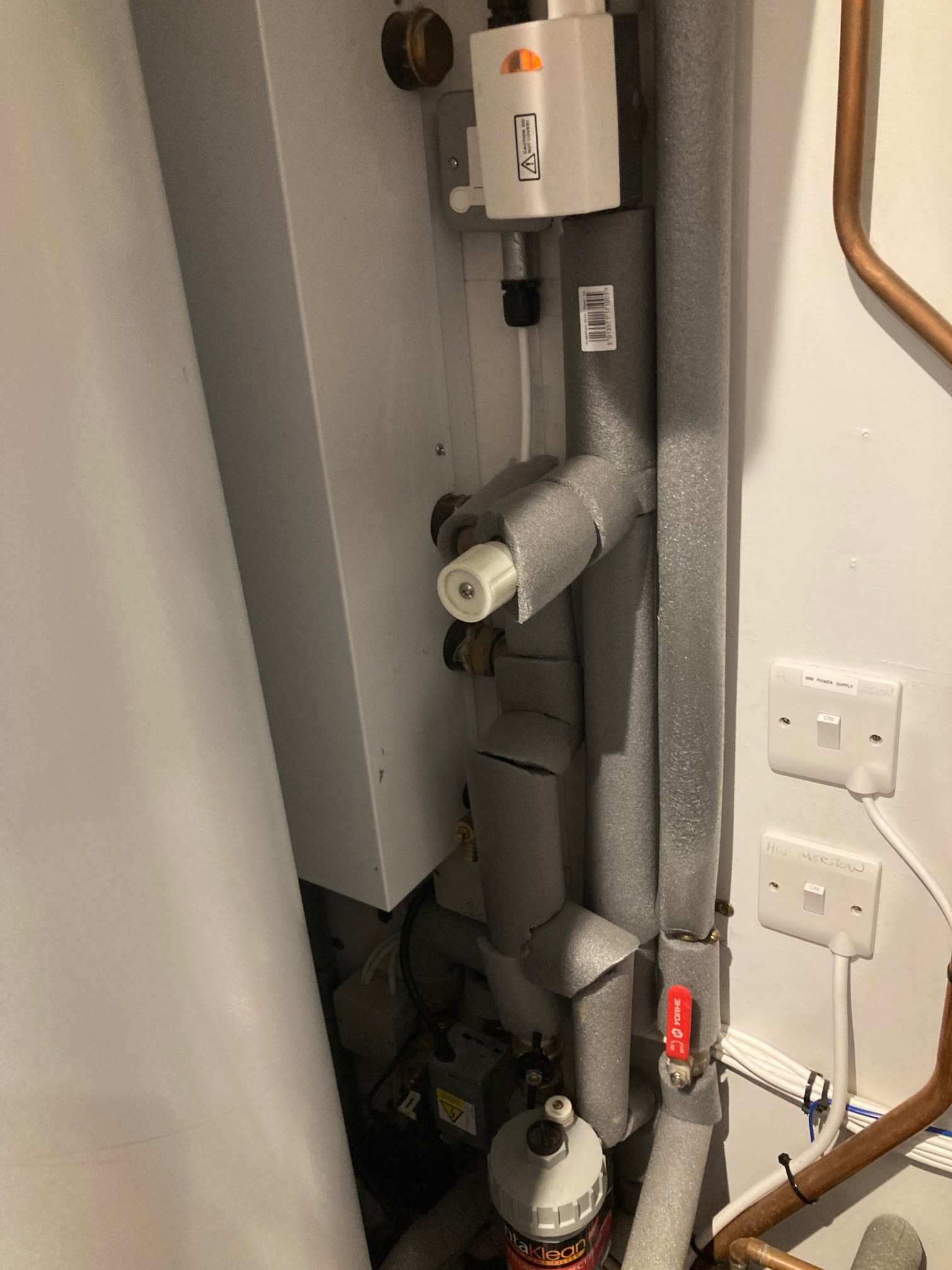

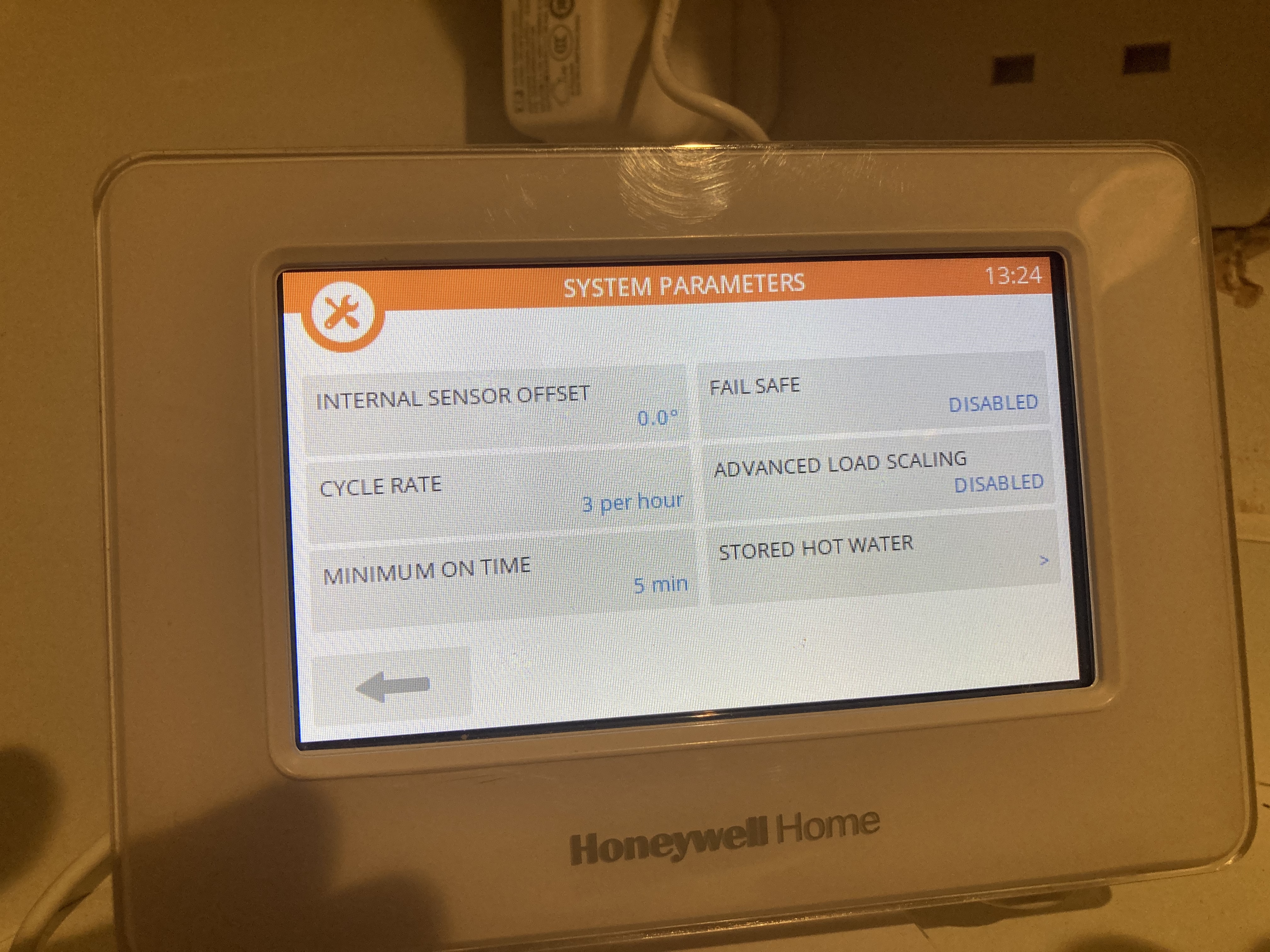

Thanks for the reply. Sorry, but a lot of this I don't understand so I apologise if I give the wrong terminology or ask a silly question. I attach pictures and can provide more. We have Evohome with four zones; Downstairs three zones for the UFH. Upstairs one zone which controls all the upstairs radiators which all have TRVs. It is difficult to tell but I would say that when it is only upstairs calling for heat the noise is worse yes. I understand that there is one pump for the UFH and one pump for the radiators - both Grundfos. -

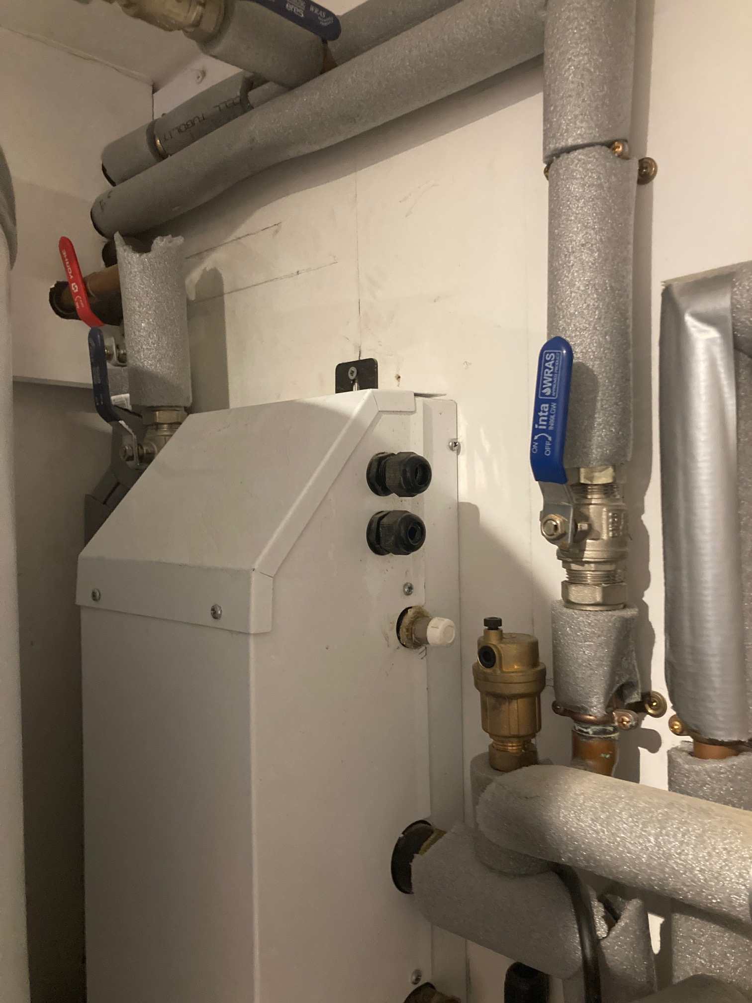

I am hoping someone can help as no plumber has been yet. We have a Samsung 12KW ASHP (no issues with it) We have UFH downstairs (no issues) We have radiators upstairs. When the radiators come on they cause significant noise and I cannot sleep. We have had people look at it, balancing, draining etc. Still the noise. We have 7 radiators upstairs. The noise is worst in the master bedroom and I think this is the first radiator. It is hardly anything in the further bedrooms. The pipework is all the correct size. I know very little but it sounds like it must be the water pressure / amount of water trying to get through? Many thanks. noisy radiator 2.mp4
The radiators seem to get warm enough at 35 degrees flow rate. The UFH is celotex, spreader plates, chipboard, tiles or carpet.
no appears same flow rate for radiators and ufh

I think I have a combination of issues and not sure where to start first. think my Honeywell Evohome talking to the grant heat pump controller may be causing the pump to operate more than necessary

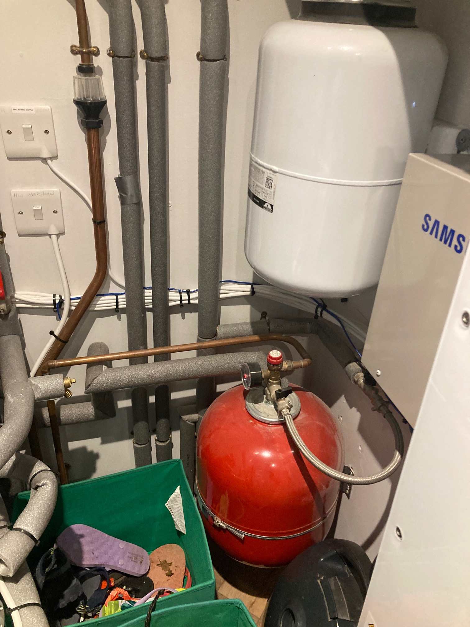

@JohnMo Some more pictures. I believe we have a buffer. We have three zones downstairs - hallway, lounge, kitchen/diner Each room upstairs is a zone. It is getting downstairs to the required temperature is the issue.
