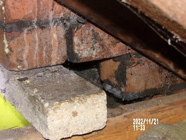

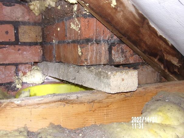

We're in the process of buying a house in the Bristol area and the survey has just come back with a poorly supported chimney stack on the party wall from previous chimney breat removal. With a bucket to boot from leaks around the stack. I'm trying to get some quotes together to negotiate this cost off our purchase price but am struggling to get any interest in quoting. I've emailed a range of local roofing firms that also do chimney removals and repairs, but as of yet have not heard back from anyone. The other option is I get a structural engineer to inspect and produce a report, but that could cost betwen £300-800. I understand that as it's a party wall gallows brackets cannot be used and it likely needs a steel. Plus it may require a party wall notice. Any advice would be greatly appreciated!
